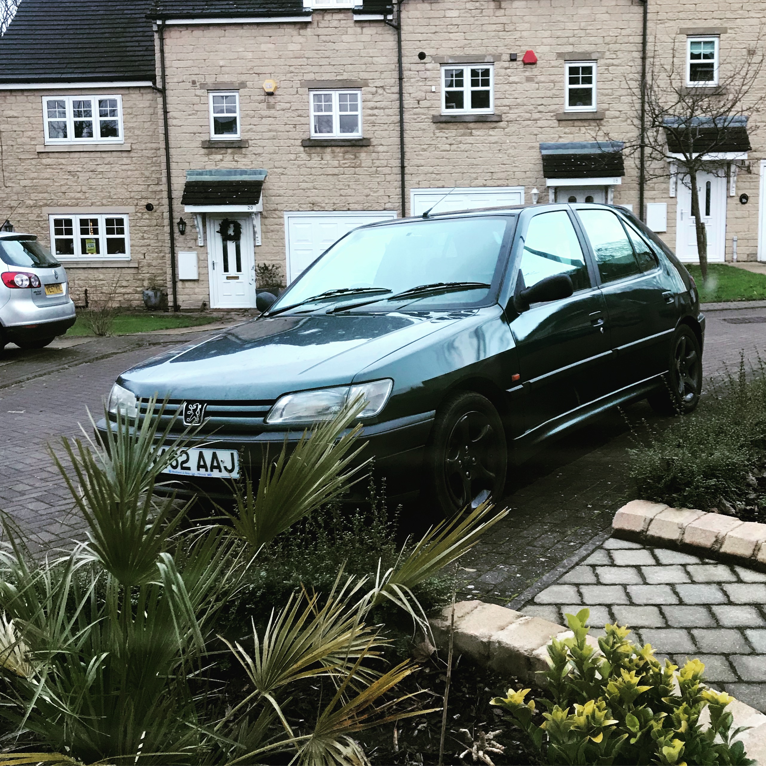

SamKidney Posted December 14, 2017 Report Share Posted December 14, 2017 I’ve just had a read up on what sort of a job the heater matrix is on a 306. Quote Link to comment Share on other sites More sharing options...

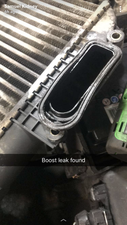

SamKidney Posted December 17, 2017 Report Share Posted December 17, 2017 (edited) D-Turbo daily is awesome. Already fiddled with the wastegate and fuel pump and it goes well, but now it boosts properly it’s made a boost leak aparrent that needs fixing. Otherwise I love it. Edited December 18, 2017 by SamKidney Quote Link to comment Share on other sites More sharing options...

SamKidney Posted December 18, 2017 Report Share Posted December 18, 2017 I absolutely love it. £250.00 and it’s in great shape, the list of what it’s had done over the years is massive. It’s had anything it’s ever needed. I fixed the boost leak tonight: Proper bodged, factors don’t list that seal. Chopped a bit out, filled groove with silicone, replace cut seal shortened to suit, smear sealant round inlet, fit. 100% leak free haha. Twiddled with the rpm limit in an effort to make it less restricted by lack of fuel up top, and wound the boost fuel compensator valve out a turn too. It really takes off now! Hilariously fun for an old diesel. Need to pop in a boost gauge to make sure I’m below 20psi, anything above and things start breaking. Already looking at different turbos and a Bosch pump for more boosts Powerflow rear box is coming out in favour of the 2.5” stainless tube I’ve found to fill the gap for more turbo diesel whistles 2 Quote Link to comment Share on other sites More sharing options...

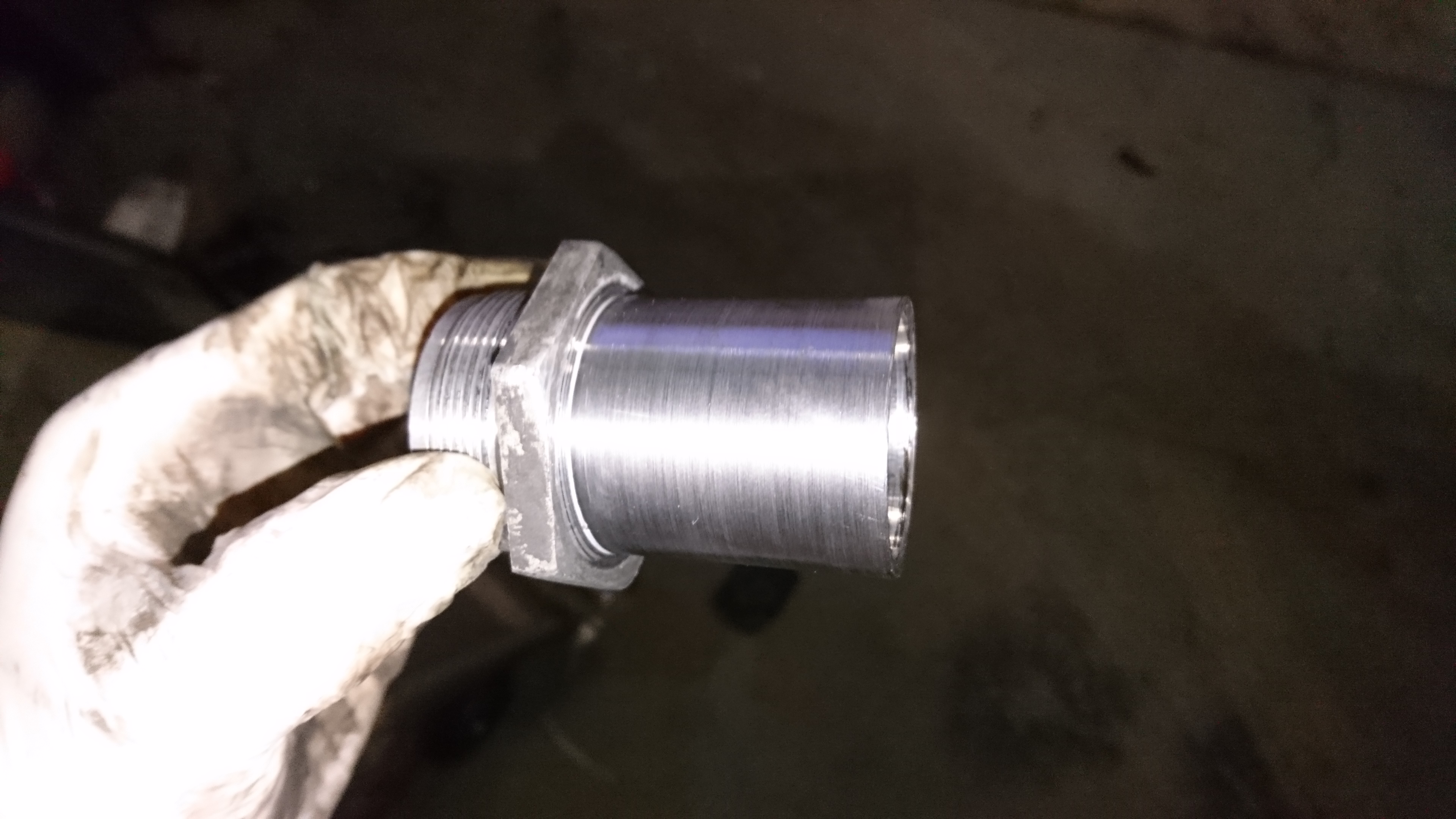

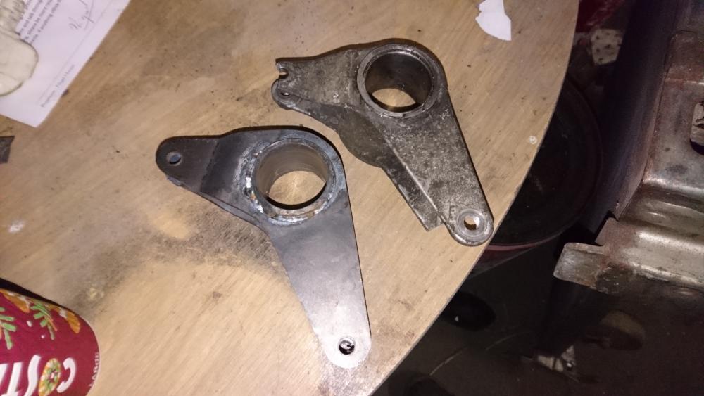

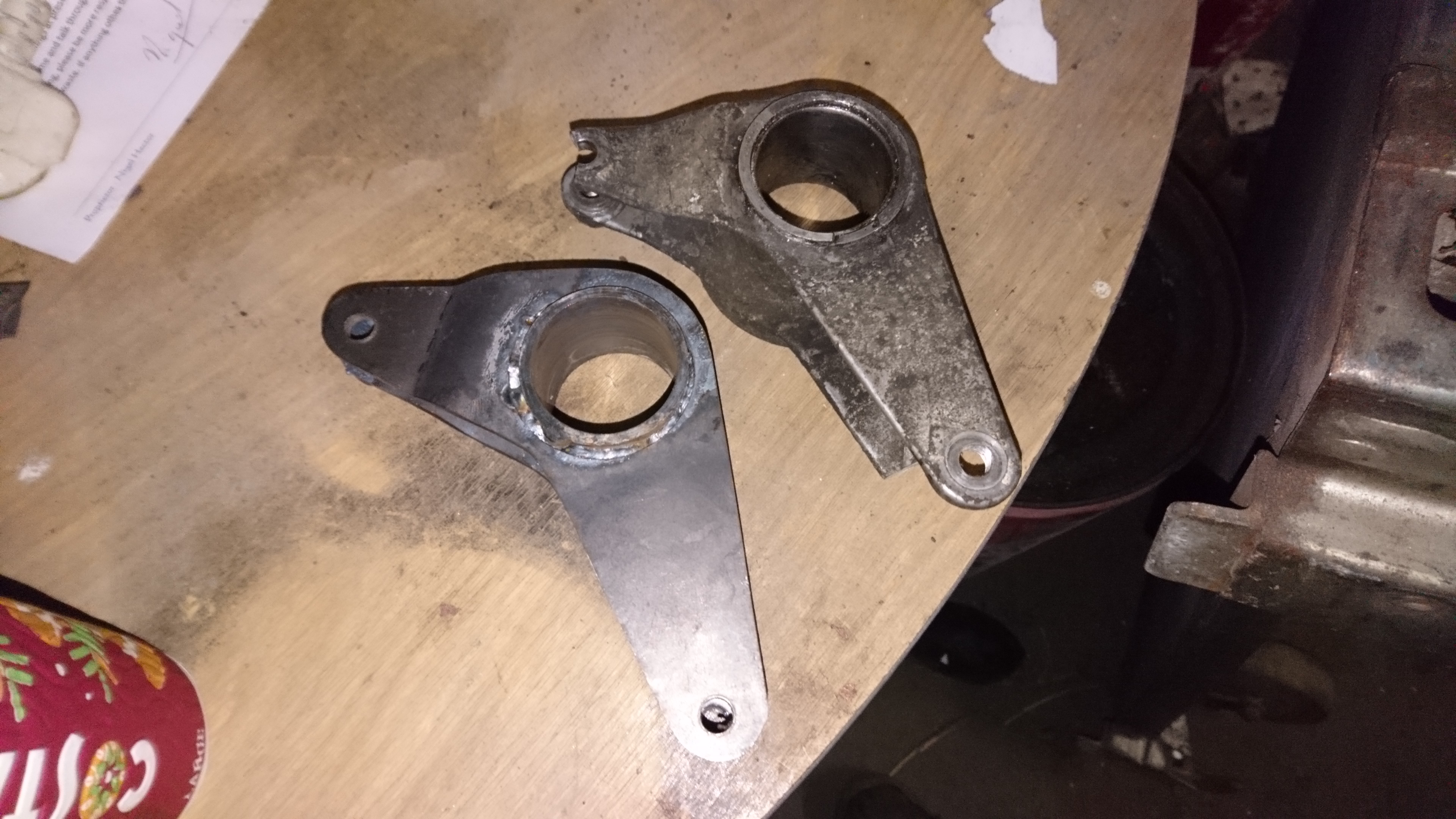

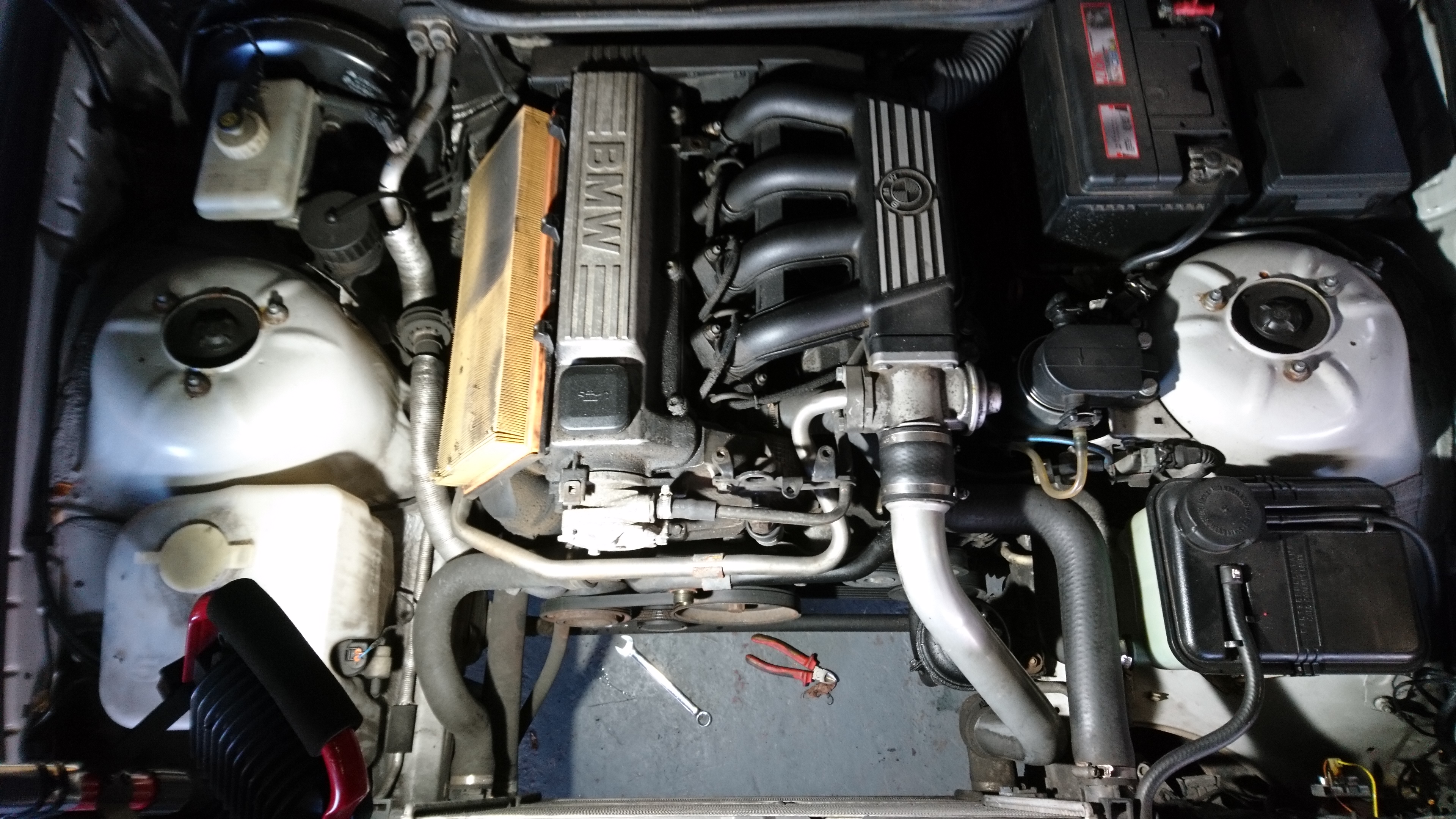

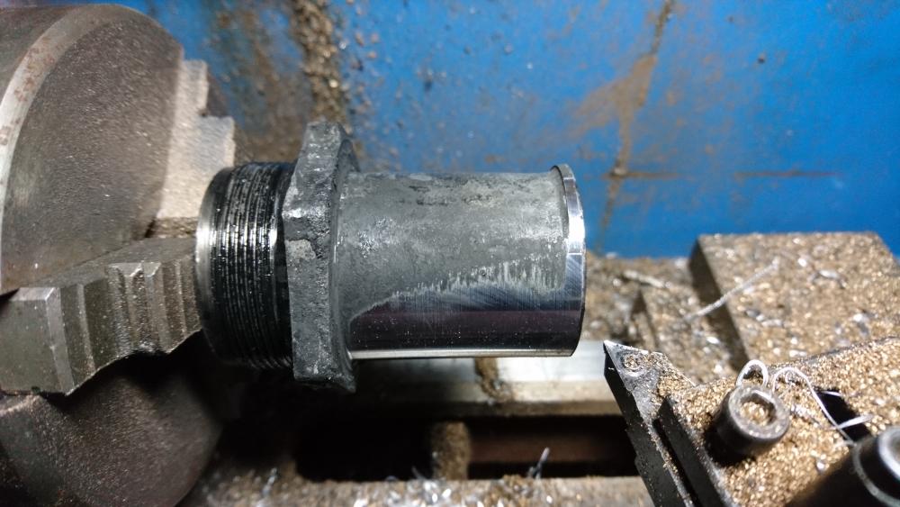

RobinJI Posted December 19, 2017 Report Share Posted December 19, 2017 Just got home from a 12 hour aux-belt change on the e36 On the bright side, it's successfully fixed the horrible rattle/sqeak the car had at low revs, on the down side.. 12 hours!!! Everything came apart fine, besides the fan removal tool I'd bought being a 36mm, when it needed to be 32mm, but a quick chop and weld and it became 32mm anyway. Oh, and the tensioner needed a 'tool' making to release it, in the form of a 1.5m length of box with 2 old head-bolts in it. Once the fan' off, there's no shortage of space at the front of the engine in 4-pot BMW's Once the belts were off, it was clear what was making all the noise, the belt tensioners pivot had warn to the point that the tensioners idler wheel was skimming the back plate of the crank pully. The tensioner needed a 17mm allen key to remove it, which I don't have, so I welded a 17mm bolt to the handle end of the fan removal tool which did the trick nicely. Removing the tensioner showed why it was sitting so out of line; the peg it rotates on was badly warn at an angle. Oh yeah, getting this peg out of the tensioners arm needed a 50mm socket, I don't have one, so some time with the welder and some 3mm plate later I did have one. A quick check on real OEM and the new part's £120 and wouldn't be here until January. Sod that! I threw the peg in the lathe, skimmed a couple of mm off it then bored out some tube to a snug fit and chemical metalled it on. I let it cure while I changed the oil, then chucked it back in the lathe and turned the O.D. back down to the right size. Job done, time to throw it back together. Before (well, after a 1st pass in the lathe, excuse the embarrassing state of the lathe!) After: I got as far as having the belt back on with all the bolts in, then when I tried to torque the bolt that holds the tensioners idler pully to the arm, it just span. Balls, off it comes again, luckily I had helicoils to hand, so it was easily sorted. I assembled things to exactly the same point I got to before, then as I torqued up that same bolt, a loud crack preceded a chunk of aluminium hitting the floor. The end of the arm had split off around the bolt hole! As I removed it to inspect the damage another chunk fell off the other end of the arm! Lots of swearing later and wondering how the hell it was going to get home (my unit/workshop's about 7 miles from home), I decided the best option I had was to remake the whole bloody arm in steel. I dug a length of an old baluster out of my off-cuts pile, which almost had the right I.D. for the pivot 'pin' I'd already fixed. It was close, but still needed slitting, squeezing smaller, welding closed again, then boring out in the lathe to get it to the right size. Then after some time cutting and bending 3mm steel plate, I welded it up and had a new tensioner arm! It took a couple of test fits to get the pully sitting spot on, but luckily from that point on everything actually went smoothly, and the arm seems to work well. I'm bloody knackered, but it's so nice to finally not have any dodgy noises coming from it! The rattle had been there for a while, slowly getting worse while I struggled to work out where it was coming from. I was worried it could be the DMF, so I'm relieved not to be forking out ~£200 for a new one! 10 Quote Link to comment Share on other sites More sharing options...
Danny Posted December 19, 2017 Report Share Posted December 19, 2017 Lathes ***. I wish I had one and knew how to use one. Quote Link to comment Share on other sites More sharing options...
RobinJI Posted December 19, 2017 Report Share Posted December 19, 2017 They are ridiculously useful, I'd have been completely screwed without the lathe and welder yesterday. I'd have needed to get a friend to come and get me, get a dealership to order the part next day for God knows how much money, then get a lift or dig out the road bike to collect the part and go fit it. Not to mention leaving my car in the way of the guys I share the unit with. Quote Link to comment Share on other sites More sharing options...
