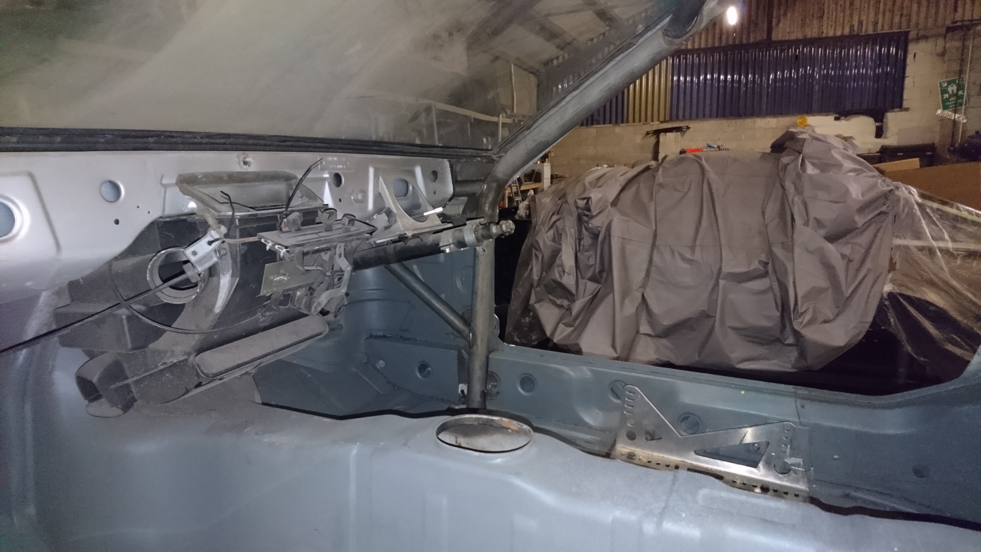

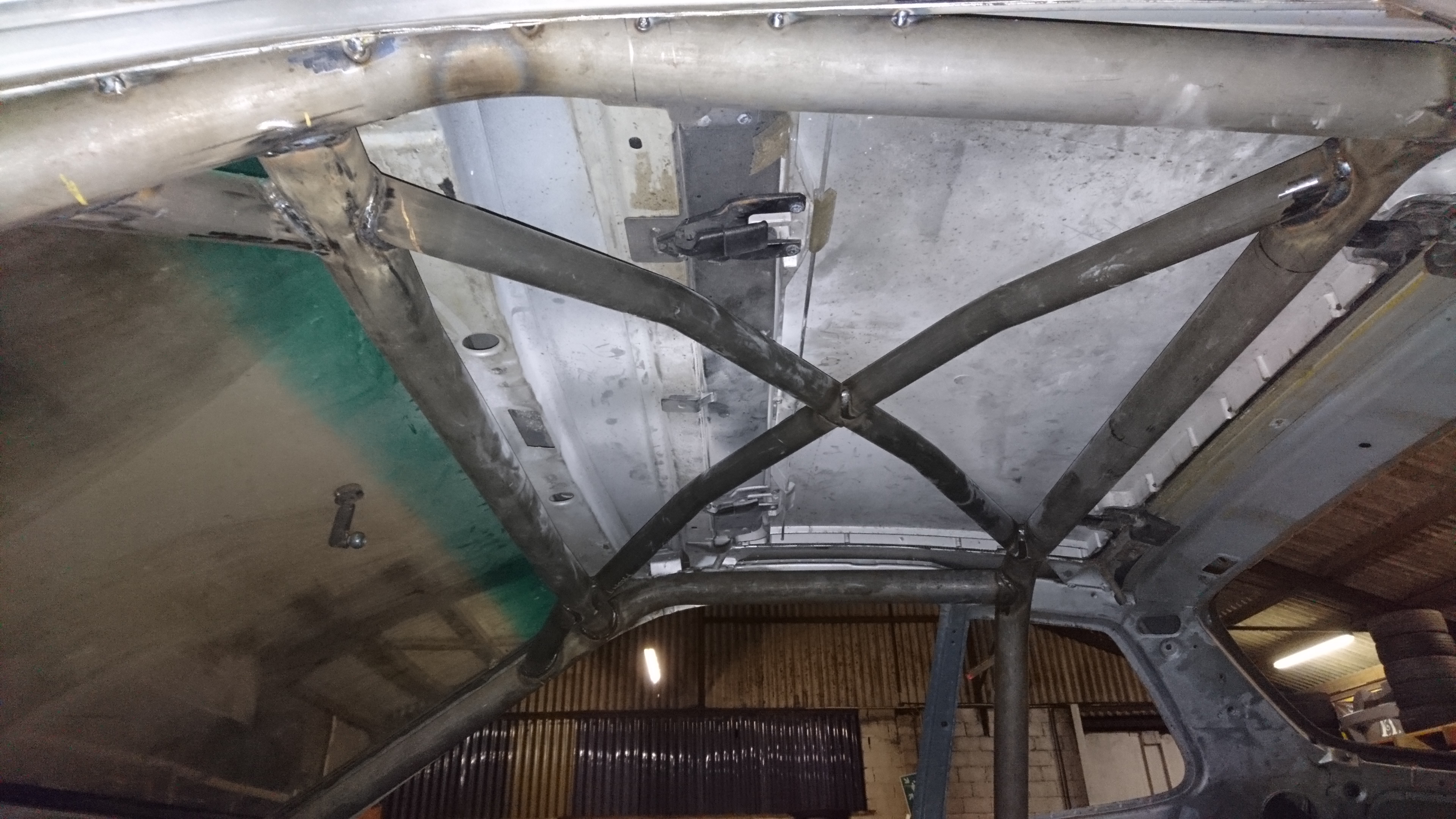

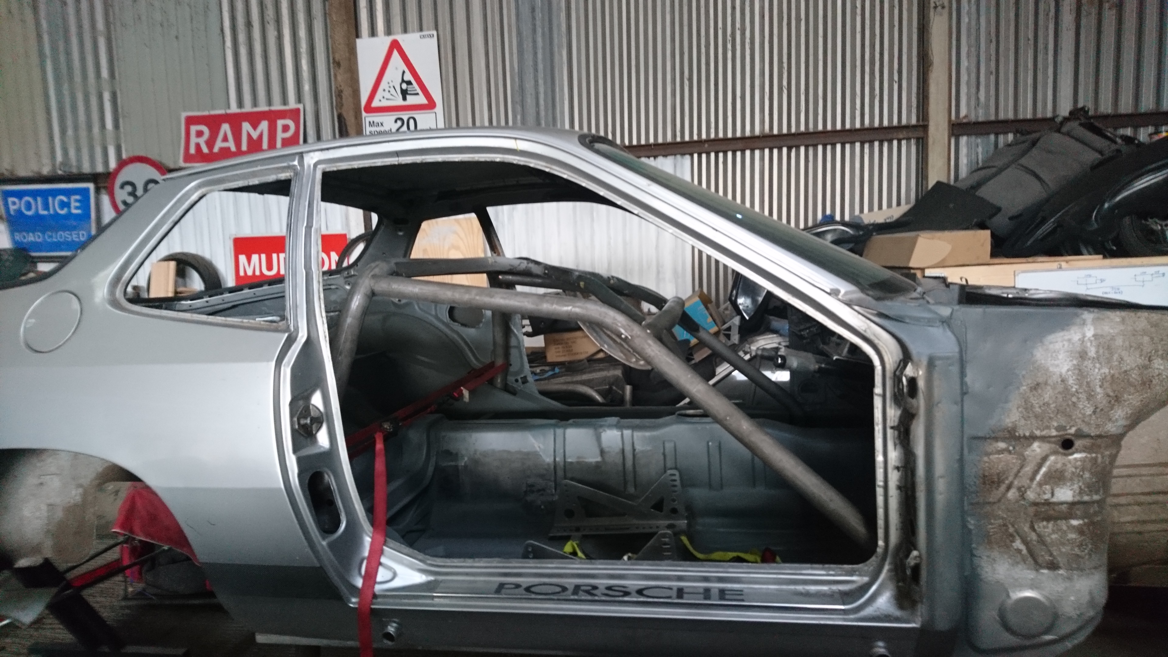

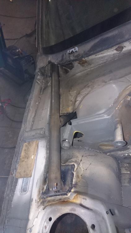

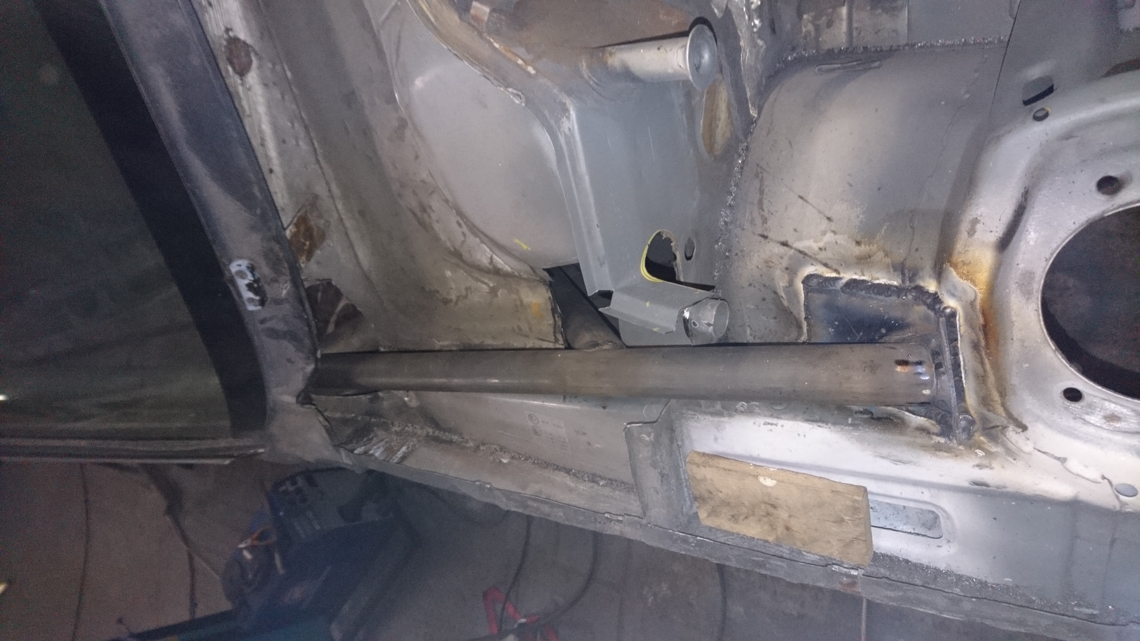

RobinJI Posted October 29, 2017 Report Share Posted October 29, 2017 The 1.8t's are a rat's nest of pipework and wiring aren't they? My cage is coming along well. I've welded up all the roof level stuff, raised the cage back up into place and done the front strut-tower bracing on one side. Dropped down to weld round the top: All welded up: And the farward bracing: Once the front bracing's done it's time for door bars, then welding the feet into place, then the main hoop cross, then the rear legs, then gussets on the crosses and door bars. 3 Quote Link to comment Share on other sites More sharing options...

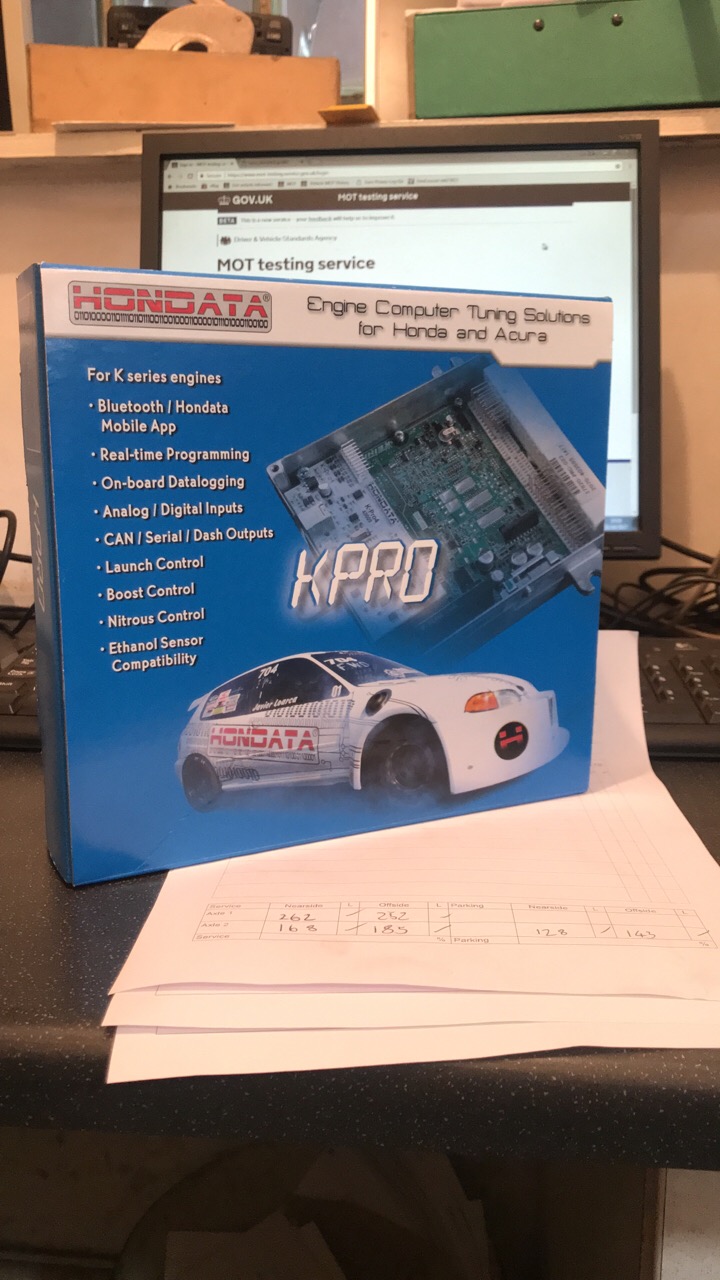

SamKidney Posted October 31, 2017 Report Share Posted October 31, 2017 Hondata K Pro fitted this afternoon. The inner geek in me loves it. A friend has sent me a map that works nicely enough for my current set up. Had a little drive this even and it’s so much smoother! 9k rpm rev limit sounded awesome but I’ve got too much mechanical sympathy so I’ve knocked it down to 8300 haha. Bluetooth feature for real time data on my iPhone is a nice feature too, handy way to keep an eye on temps. 1 Quote Link to comment Share on other sites More sharing options...
