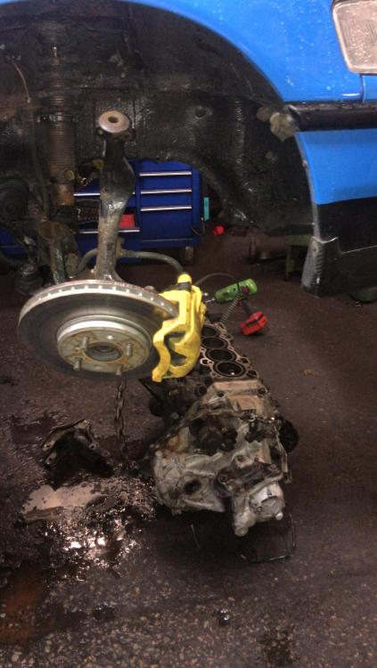

Sam, that blows man. Gutting for the guy. Have you dropped the original lump back in, or are you going to be working on the rattly block trying to put things right?

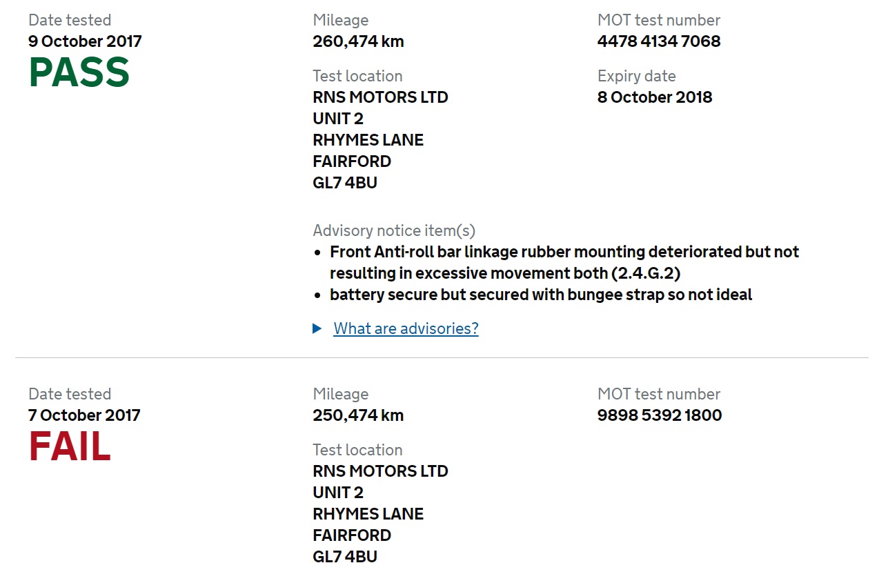

On 10/11/2017 at 9:13 PM, MadManMike said:
Just realised I posted on FB, but not here, so some of you will already know...
Anyway, I got a call to say my car is ready. It failed on nothing this time and nothing needed fixing, lol. Scamming twats basically realised I knew what I was on about and decided that all the problems were no longer problems.
Obviously good news, but annoying that I've had so much hassle. I could have collected it last week if they weren't trying to con me.
Interesting that they managed to put 10,000km on it between the second fail and the pass test...

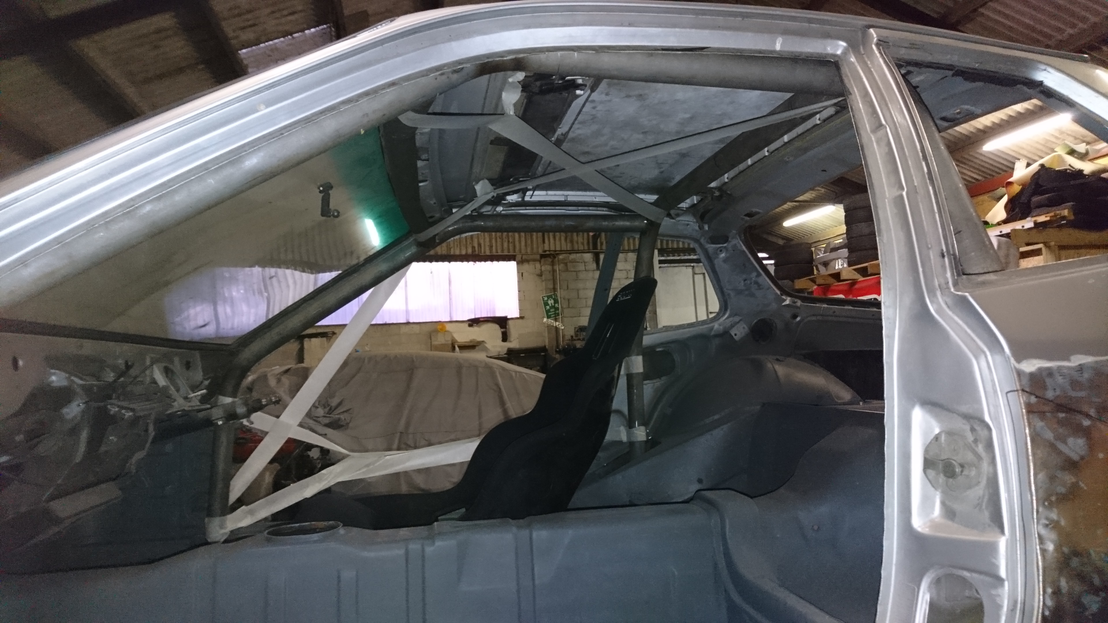

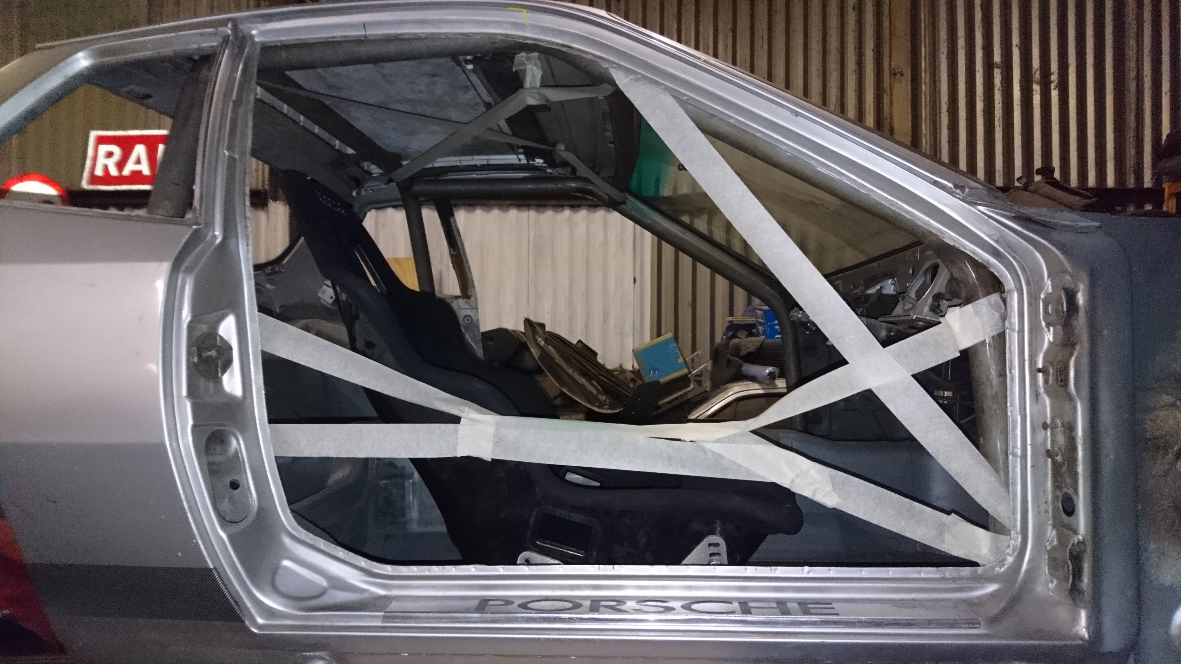

My cage is coming along, I've got the main hoop, front legs and windscreen bar tacked into their final place, dropped the roof X bracing off to be bent, and cut and marked up the door bars and a-pillar supports ready to drop them off for bending.
Once the roof bracing's back from bending (it should be done tomorrow) I can drop the cage through the holes in the floor and fully weld all the joints at roof-level.
The tape's to work out the tube position/routing.

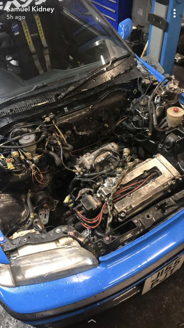

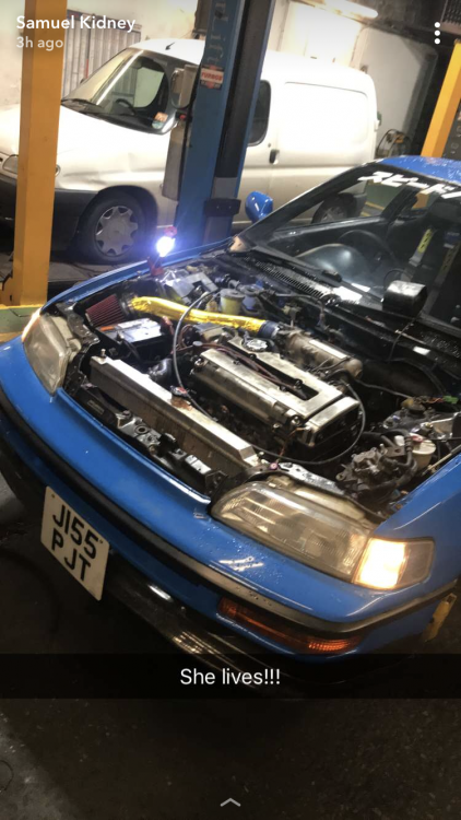

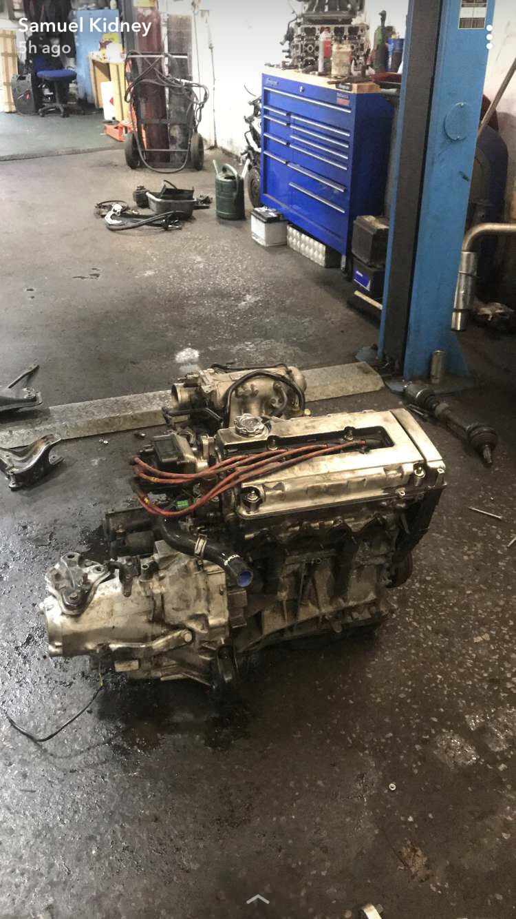

I fixed the unsuccessful fix I attempted on the CRX this evening.
45 mins or so saw the engine removed, head already removed and fit onto what is the cars original bottom end.
Said new engine assembled, new timing belt and water pump, head gasket, RPC carbon Kevlar clutch, Y2 short ratio box.
Engine will all ancillaries on its way in. Really smooth swap with no hassle.
And finally complete. Quick turn over without the injectors plugged in got some oil round the motor before first start. Plugged them in, started first turn of the key. Dizzy timing set after it came off fast idle, runs spot on and sounds beautifully smooth as Honda motors should. Great fun playing with the old B series engines again :)
