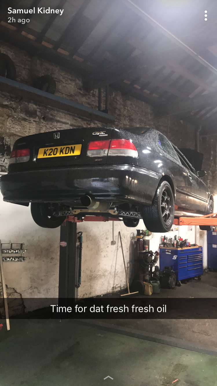

SamKidney Posted October 4, 2017 Report Share Posted October 4, 2017 5 hours ago, Greetings said: A girl who can identify Hammerite just through smell must be pretty special! She just identified it as very "painty", I think the word was. In Civic news. Its been through 3 track days and daily duties on the same oil from around June so I figured it was due a change. New filter and some lovely fully synthetic 5w40. Id opt for 10w50 if it was solely used on track but the former gives me nice cold protection for the daily job. Ive also been meaning to do the valve clearances for a long time now (since I bought the engine a year ago this day..), so I got those done while the oil drained entirely. Sounds much better and feels much smoother too. Also noticed that using these PBS brake pads on the road is killing my brake discs to a quicker extent than the pads themselves. May pop some new ones on after Cadwell later this month. Need to order some fresh Torco gear oil and some friction modifier for the differential. I feel I may have to remove the diff to be serviced in the near future, a lot less clunky than it has been but I've not been loading it up at all recently. Hopefully fresh oil and less modifier sees it return to its more aggressive setting. 1 Quote Link to comment Share on other sites More sharing options...

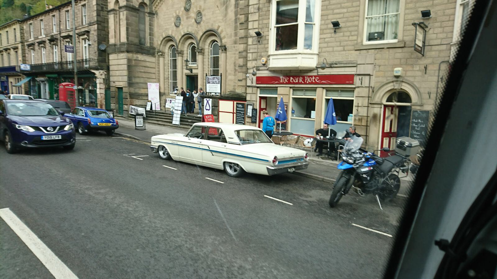

Tom Booth Posted October 8, 2017 Report Share Posted October 8, 2017 I got spotted at matlock this morning.. Some mong came to tell me how he loves muscle cars and yank cars. There's nothing he didn't know about them. He ended with.. ' So what year mustang is it then?' Face with palm. 1 Quote Link to comment Share on other sites More sharing options...

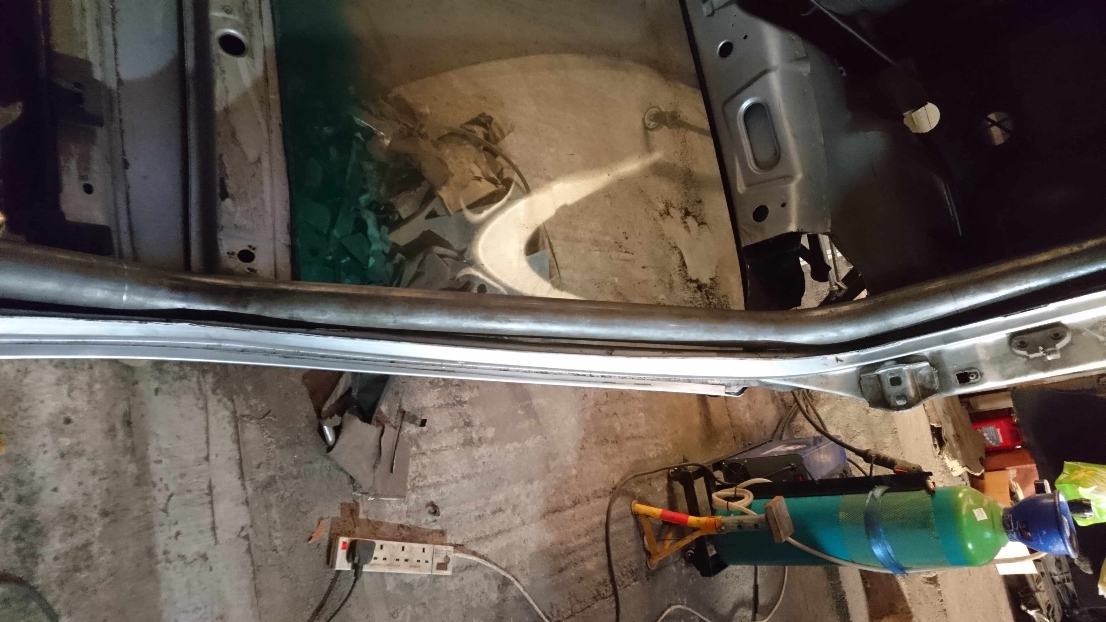

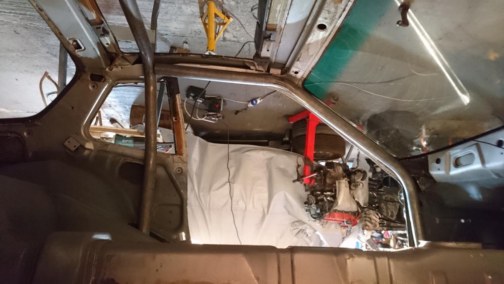

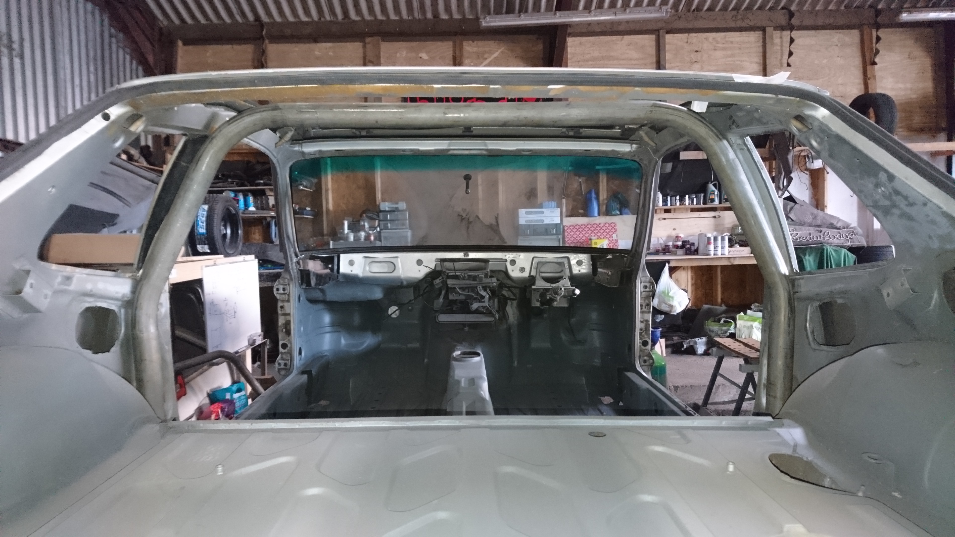

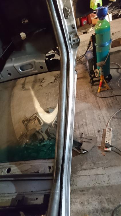

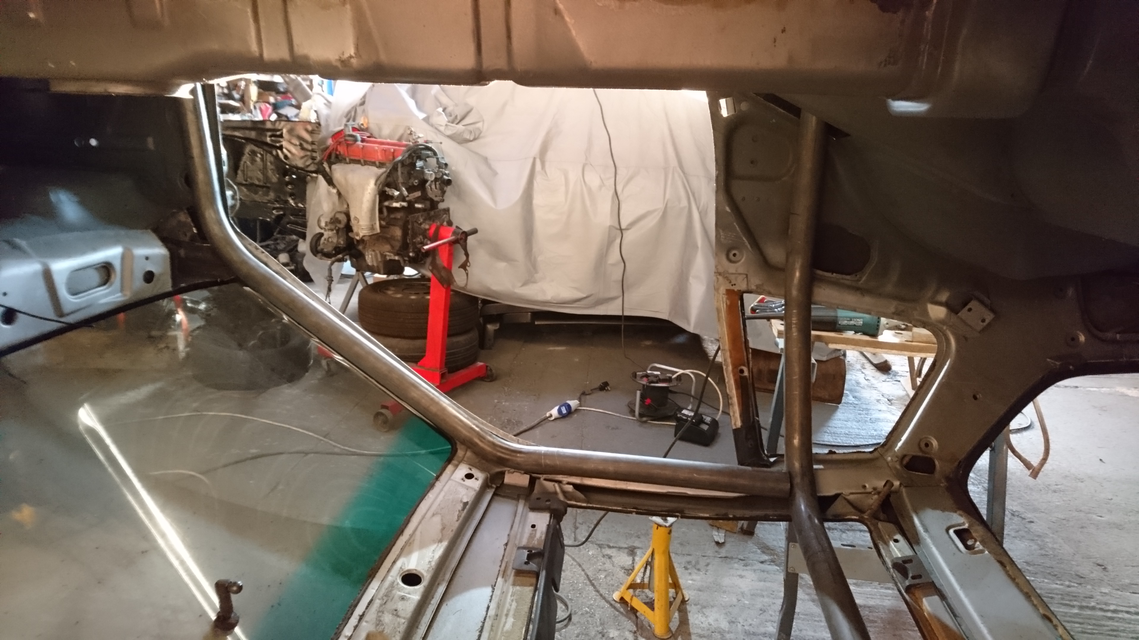

RobinJI Posted October 8, 2017 Report Share Posted October 8, 2017 Haha! 'experts' like that can be hilarious sometimes. The car's looking good Tom! I finished welding up the last of the rust in the 924 a week or 2 ago, so I finally pulled my finger out and got the tubes for the cage ordered, then got the guy in the next unit to stick some bends in them for me. I'm really happy with the fit so far: I've got a couple of bits in the post to finish a tube notcher I'm making, then I can get really stuck in putting a whole lot more tube in there! 4 Quote Link to comment Share on other sites More sharing options...
Tom Booth Posted October 8, 2017 Report Share Posted October 8, 2017 That's a good looking cage Robin, that's shaping up to be a cracking car! Quote Link to comment Share on other sites More sharing options...
Luke Rainbird Posted October 8, 2017 Report Share Posted October 8, 2017 Looks fantastic Robin. Nice tight fit from the looks of things Quote Link to comment Share on other sites More sharing options...
MadManMike Posted October 9, 2017 Author Report Share Posted October 9, 2017 Yeah but seriously, what year is that Mustang? 1 Quote Link to comment Share on other sites More sharing options...

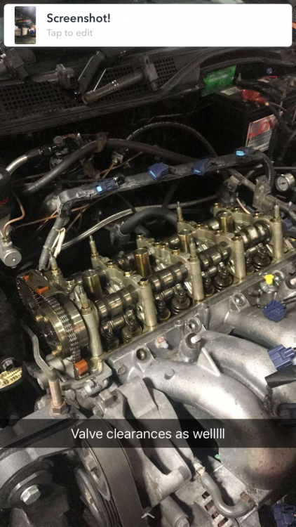

Luke Rainbird Posted October 9, 2017 Report Share Posted October 9, 2017 Bit of a catchup of the last few days. In the end I didn’t do a huge amount this weekend as I wanted a change of scene so spent time with family instead. Here’s what did go down: Messed about for a bit trying to get logging working properly. Starting to figure it out/work out a few kinks. Had a bit of help. Figured out where I’m losing some coolant. Flange isn’t sealing properly. Will get another one sorted - not sure if it’s the plastic housing or the o-ring that’s giving me trouble but they’re cheap enough I can just replace the lot. Picked up some larger spline bits - only really needed M16 for the gearbox but worked out just as cheap to buy a set, so I did. Note that for the drain/fill plugs on an 02m box you’ll typically need an M16H (hollow) rather than flat bit. Some were just a large allen head IIRC. I’d only lost a small amount of oil when moving the box about with no drive cup, so at this stage I just wanted to top it back up. The box itself is making a bit of noise so I’ll be giving it a complete oil change at some point, but this stuff isn’t overly cheap so I’d rather not use 2.5l of it just to drop again in a couple of weeks if needs be! Pr0tipz: A length of common or garden hose on the nozzle saves a whole world of mess - allows you to feed the new oil straight into the box without having to pull anything off the car at all (other than the fill plug, of course…) The fill and drain plugs on the box are found on the front and bottom respectively. Black caps seen here Fill until fluid starts to drip from the fill hole on level ground. Don’t forget there’s oil in the hose as it takes a while to flow down. I used ~300ml to top this one up, of which ~50ml or so ended up on the drive. Rookie error. Box topped up to the right level, I took the car for a quick drive to see if it’d helped quiet things down. It hadn’t. I’ve got a rattle which disappears as soon as you depress the clutch pedal at all, and a similar noise on overrun. As much as I don’t want to replace the CSC again, it’d be a darn sight cheaper than having to split the box and rebuild for a worn/dead input shaft bearing which symptoms point to. I’ve ordered a shim kit to see if it rectifies things from externally, but if that doesn’t help I’ll have to drop the box AGAIN and rethink. May throw stock box back in for a while, may transfer LSD across to the currently stock box instead. Car is filthy, but until it’s running right it’ll probably stay that way. Turns out being too lazy to reconnect your arch liners doesn’t pay. Oops… VCDS was reporting a misfire on cyl 1, so I’ve swapped coils between #1 and #2 to see if it’s just a coilpack issue. Not yet driven since to check. Have a fresh set of 4 en route but this’ll help diagnose for now. Not going to drive the car again until the box is shimmed to try and minimise any harm done. Very slight amount of oil in #1, but don’t think this is the cause. No major leak evident so likely just a touch through valve cover gasket, will keep an eye on it. Top of the plug itself is mostly clean, so may just have been a dab of oil on the coilpack when fitted that I missed. Despite running on actuator pressure (n75 unplugged) I’m currently seeing measured boost exceeding requested considerably. Need to get to the bottom of that - could be incorrectly plumbed (don’t think so!), maybe a dead n75 hose (potentially), could be an incorrectly set actuator (not sure) so more investigation needed. I may also have pre-emptively picked up another part to fit in that area, but that’s for another day. Quote Link to comment Share on other sites More sharing options...
