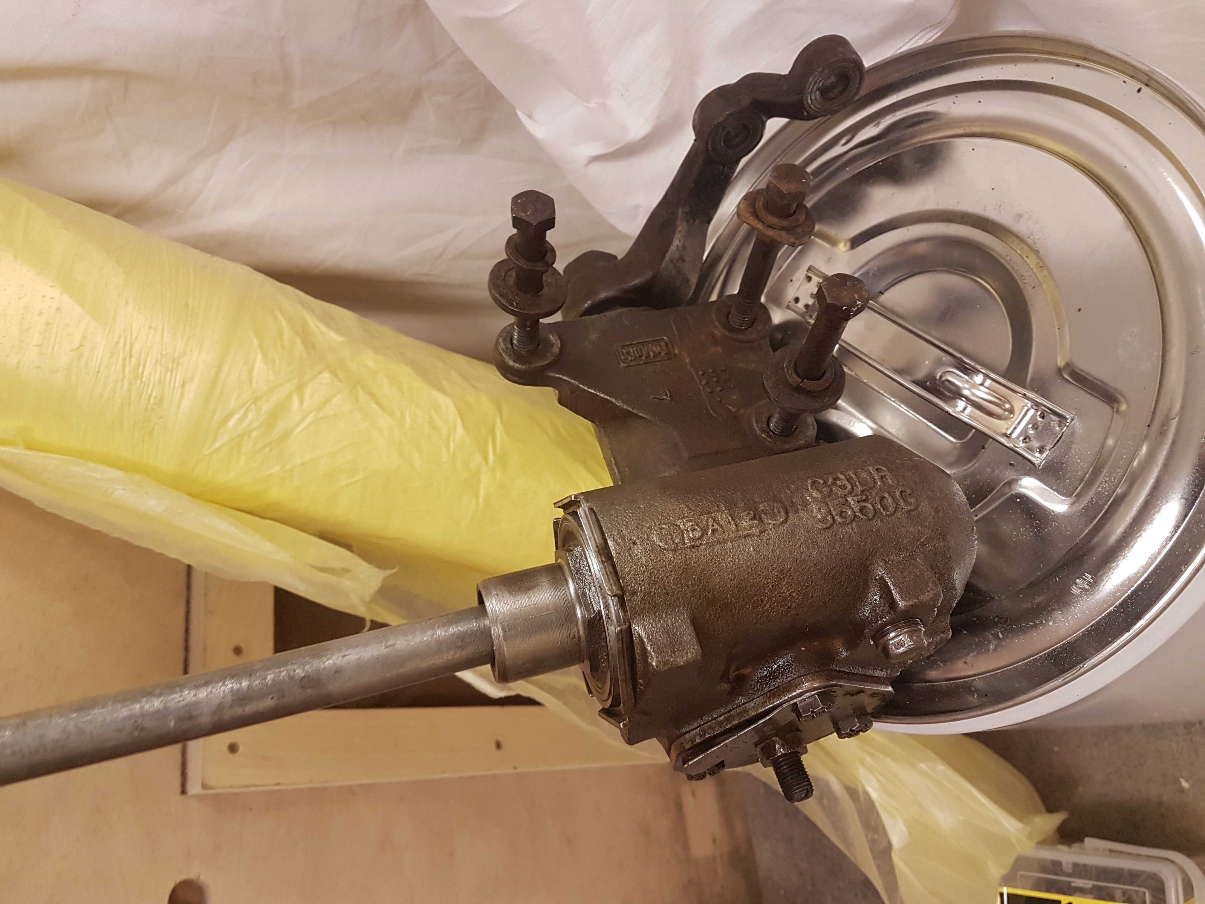

Tom Booth Posted September 22, 2017 Report Share Posted September 22, 2017 Mustang steering box is here... It feels brand new! Nice and free with no slack. Bolt pattern looks perfect to bolt straight up so rather then being a donor it might go straight on. Where the steering shaft comes out the top and goes through that top hat bush kinda setup, mines missing that totally. Looks like some hack has removed it for whatever reason and it's not supporting the bearing properly hence the failures. I'm missing the huge washers on the bolts too so I figure it's had a quick knob up job some point in its life and this is the result. I just gave it a washdown and if it looks like it'll fit I'll slap a coat of paint on there. Excited to work on cars again suddenly which is nice, I love jukeboxes but it's fun to be doing something different again. 2 Quote Link to comment Share on other sites More sharing options...
Luke Rainbird Posted September 22, 2017 Report Share Posted September 22, 2017 Sounds like a winner TB. I've missed/forgotten the discussion around this - assuming this is a pretty early Mustang box? That said, the evolution of things is quite handy for parts bin raiding! Get it sorted and clear a few jukes so I can visit and you can paint my car yeah? 1 Quote Link to comment Share on other sites More sharing options...
Tom Booth Posted September 22, 2017 Report Share Posted September 22, 2017 It's a 1964.5(mk1) mustang box, they ran them in mustangs for 3 years before they swapped out for a tilt steering column that splits about 2 inch after the box, whereas this one when you crash has a 48" steering shaft that harpoons you straight in the face. Safety, yo. The bolt pattern looks about bang on from memory but the actual shape is slightly different so might not be too successful but we can try. Strangely though they only used this setup in fairlanes for 6 months-ish, which means its an absolute twat to find replacements and stuff for them hence my steering rack conversion ideas. Hopefully even if this doesnt bolt straight in itll beva great donor for my box and keep it on the road till I sus out/can be bothered to convert. If your car fits through a 3ft wide door bring it whenever dude 1 Quote Link to comment Share on other sites More sharing options...

Tom Booth Posted September 23, 2017 Report Share Posted September 23, 2017 Mustang box isn't a direct fit, it's out one 1 bolt out of 3 by about 10mm. The steering shaft is about 2cm longer then the fairlane and the pitman arm is a touch shorter but that's not too crucial. I really want to use the mustang box as it looks brand new and feels 'Proper. Do I chance it and drill the chassis to accept it?! I can get the shaft shortened no trouble. Quote Link to comment Share on other sites More sharing options...

Luke Rainbird Posted September 23, 2017 Report Share Posted September 23, 2017 3 hours ago, Tom Booth said: Mustang box isn't a direct fit, it's out one 1 bolt out of 3 by about 10mm. The steering shaft is about 2cm longer then the fairlane and the pitman arm is a touch shorter but that's not too crucial. I really want to use the mustang box as it looks brand new and feels 'Proper. Do I chance it and drill the chassis to accept it?! I can get the shaft shortened no trouble. If the shortening is a cheap and painless exercise and the only niggle is the new hole, then provided there's decent meat there to take it get that b*****d drilled, painted and rivnutted already. 1 Quote Link to comment Share on other sites More sharing options...
Tom Booth Posted September 23, 2017 Report Share Posted September 23, 2017 The steering box bolts through the chassis rail with some gnarly m12 bolts, so my plan of attack is.. Fit mustang box using 1 bolt to mock up. I can measure the length of the column then and get that sat right. Make 2 spreader plates from 2mm mild steel, one either side the chassis rail so when I drill it's got good support around it. Fit everything up.. Profit. My thinking is Fairlanes are a right twat to sort the obscure parts for such as steering box bearings, they're either the later mustang bearings, earlier falcon or non of the above and parts bin specials. If I fit a 64 mustang box I know from then on any parts I need I know what it is. Seems abit of a major attack but makes my life abit easier. Plus if it all goes titties to the sky I've still got the option to steering rack it. Quote Link to comment Share on other sites More sharing options...

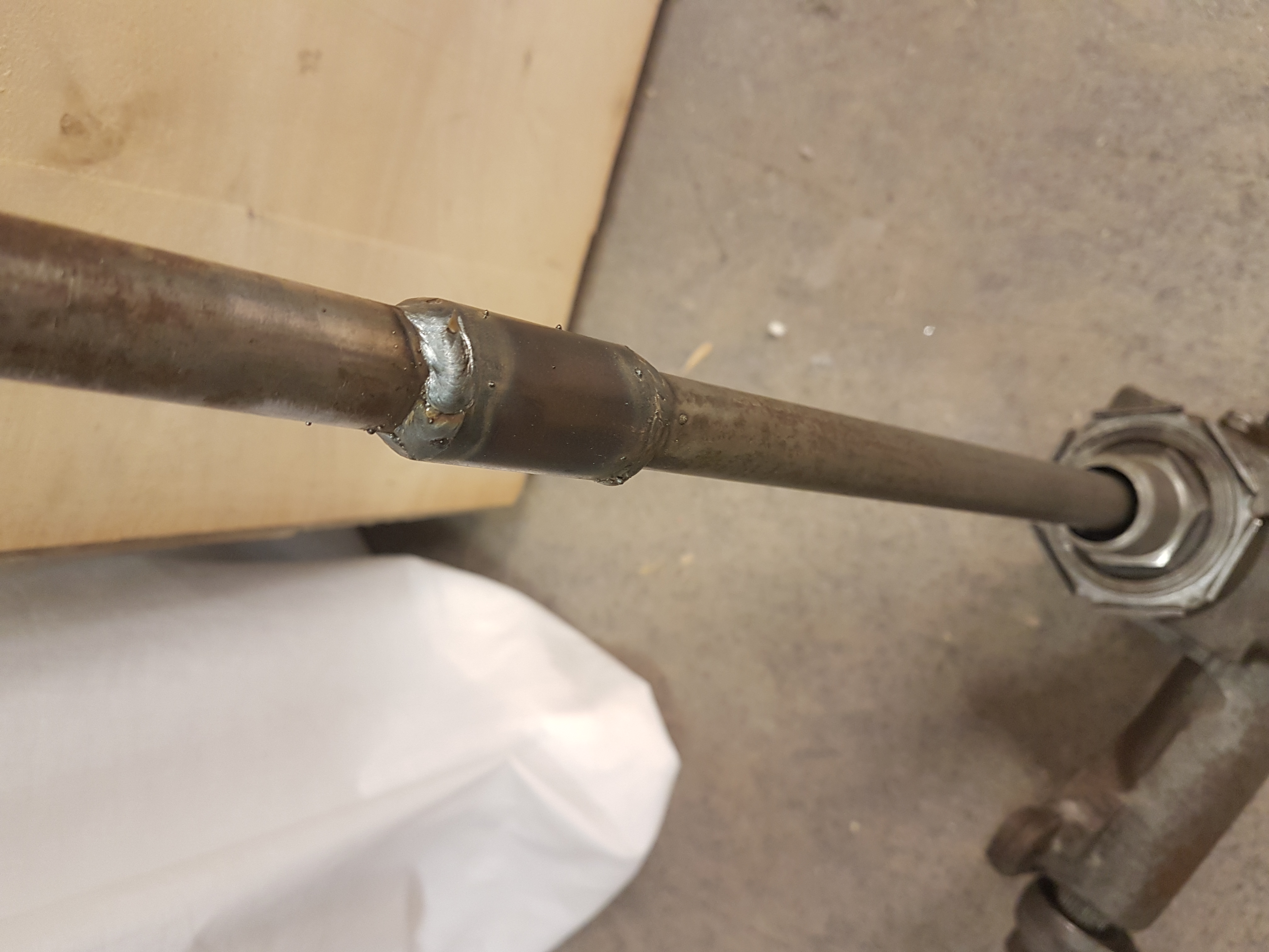

Tom Booth Posted September 25, 2017 Report Share Posted September 25, 2017 Job 1, shorten the column. Pitman arm is next... Edit.. It is straight, the shaft was weld in a channel then the sleeve over the top. It's the sleeve that's on the squonk Quote Link to comment Share on other sites More sharing options...
Tom Booth Posted September 26, 2017 Report Share Posted September 26, 2017 Pitman arm shortened and plated up for strength. Just bought another mustang steering box though for spares that looks like it should come with the correct arm. Gonna get it all fitted back in tomorow and get it back on the road for the rest of the season! Quote Link to comment Share on other sites More sharing options...

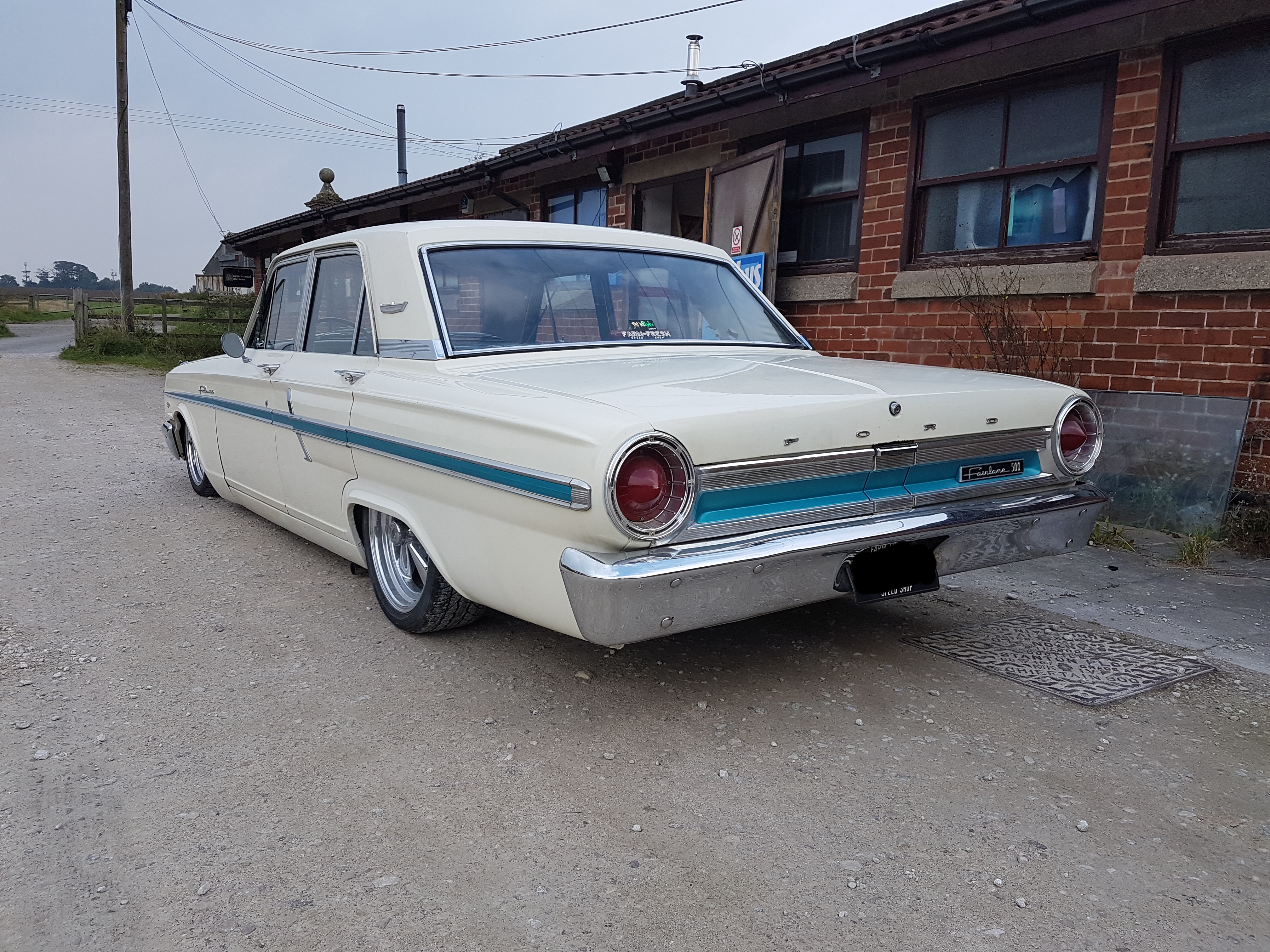

Tom Booth Posted September 27, 2017 Report Share Posted September 27, 2017 It's had a few parts just to keep it going... exhaust, brakes, trans.. 6 pot wilwoods I think they're fantastic cars. Mustang power, full size car comfort and ride, 4 doors for whores, built like a tank and just look awesome. There's a guy on the fairlane pages in Lancaster somewhere with a 67 on air ride. Looks pretty similar to a early fastback mustang but huge. It's an awesome car! If love to supercharge mine in the future, drop a 351 Windsor in there and a big blower just for 4 door stealth .. Quote Link to comment Share on other sites More sharing options...
Tom Booth Posted September 27, 2017 Report Share Posted September 27, 2017 Speaking of Fairlanes... Mustang steering box got me to work and back! Steering felt best it ever has too so hopefully it's the end of that saga. 2 Quote Link to comment Share on other sites More sharing options...

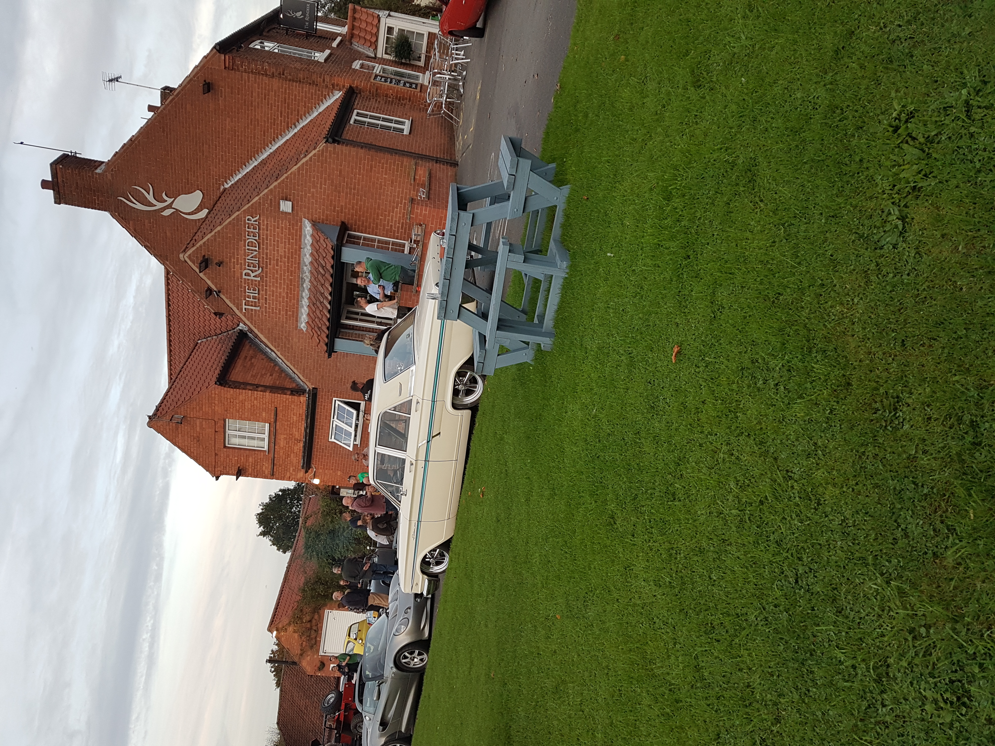

Tom Booth Posted September 28, 2017 Report Share Posted September 28, 2017 Got me to work this morning too, what is happening? There's a car meet about 30 miles away from me, the first time the steering box broke was outside the meet at the pub hosting, second time was the morning of the last meet. I'm gonna go for it today, will I make it?! Tune in later... Quote Link to comment Share on other sites More sharing options...
Tom Booth Posted September 28, 2017 Report Share Posted September 28, 2017 Made it like a champ! Quote Link to comment Share on other sites More sharing options...
