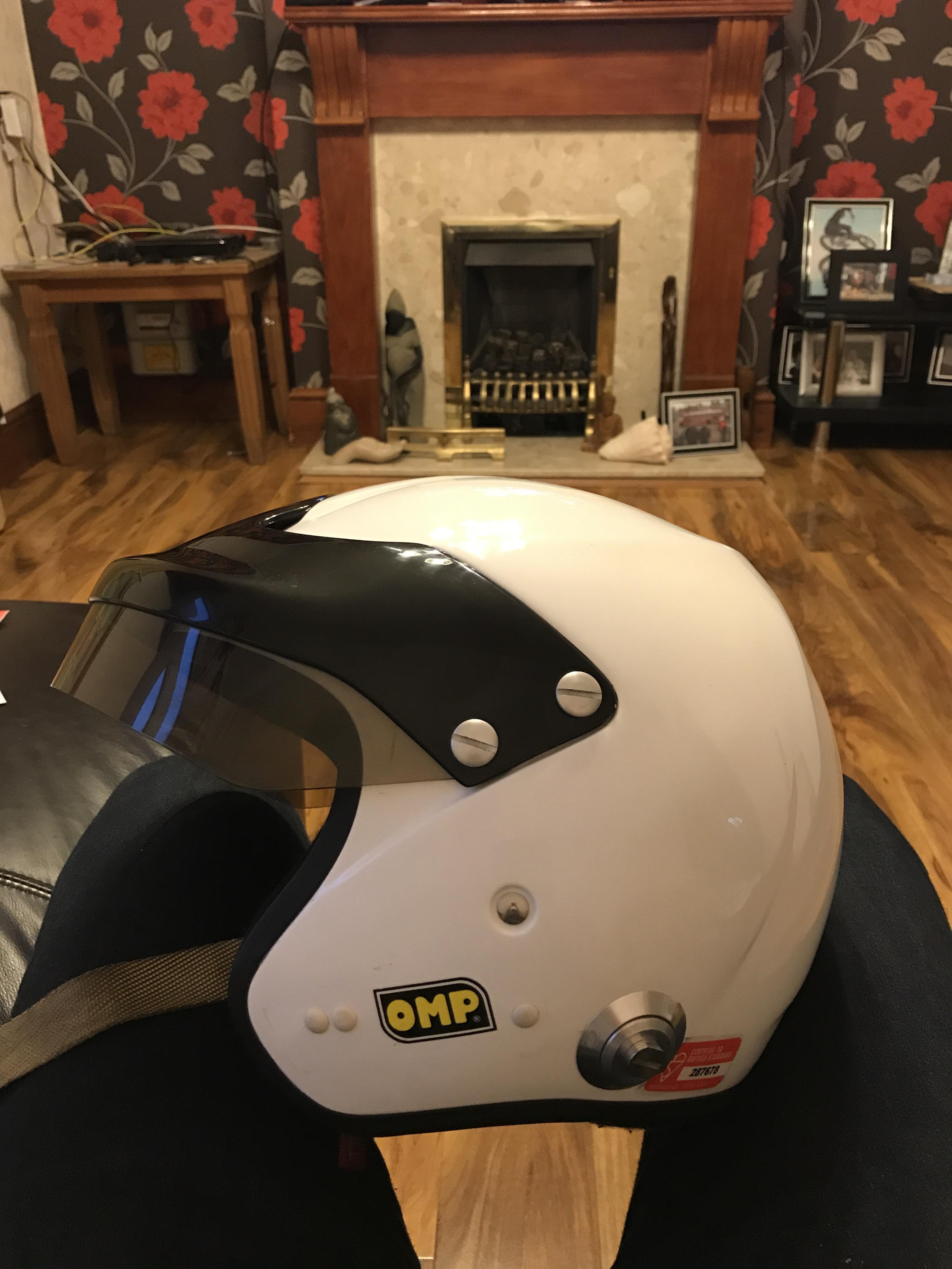

SamKidney Posted June 10, 2017 Report Share Posted June 10, 2017 £50.00! Came in the box and has the bag too! HANs compatable. Barely a mark on it, good find. 1 Quote Link to comment Share on other sites More sharing options...
dann2707 Posted June 10, 2017 Report Share Posted June 10, 2017 49 minutes ago, SamKidney said: £50.00! Came in the box and has the bag too! HANs compatable. Barely a mark on it, good find. I need! Where from matey? Quote Link to comment Share on other sites More sharing options...
SamKidney Posted June 10, 2017 Report Share Posted June 10, 2017 10 minutes ago, dann2707 said: I need! Where from matey? Purchased from a bloke I've sold Honda parts to in the past mate, just a case of right place right time! Super cheap, I'm well made up with it Quote Link to comment Share on other sites More sharing options...

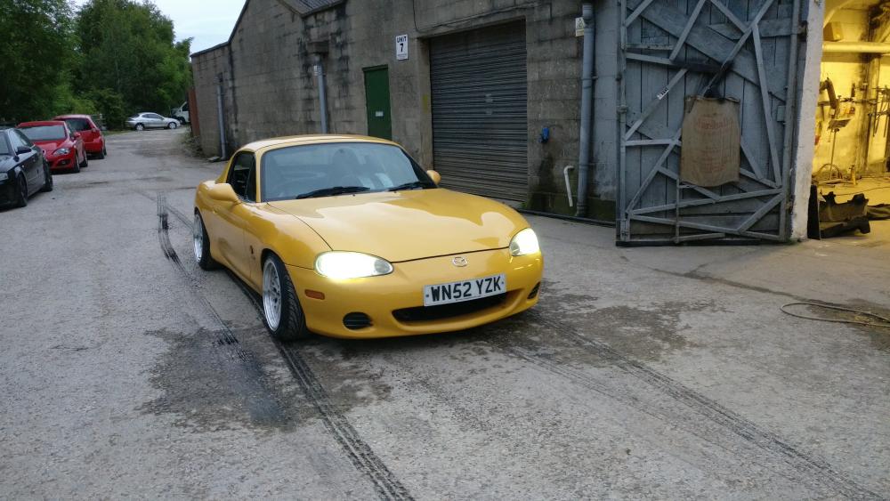

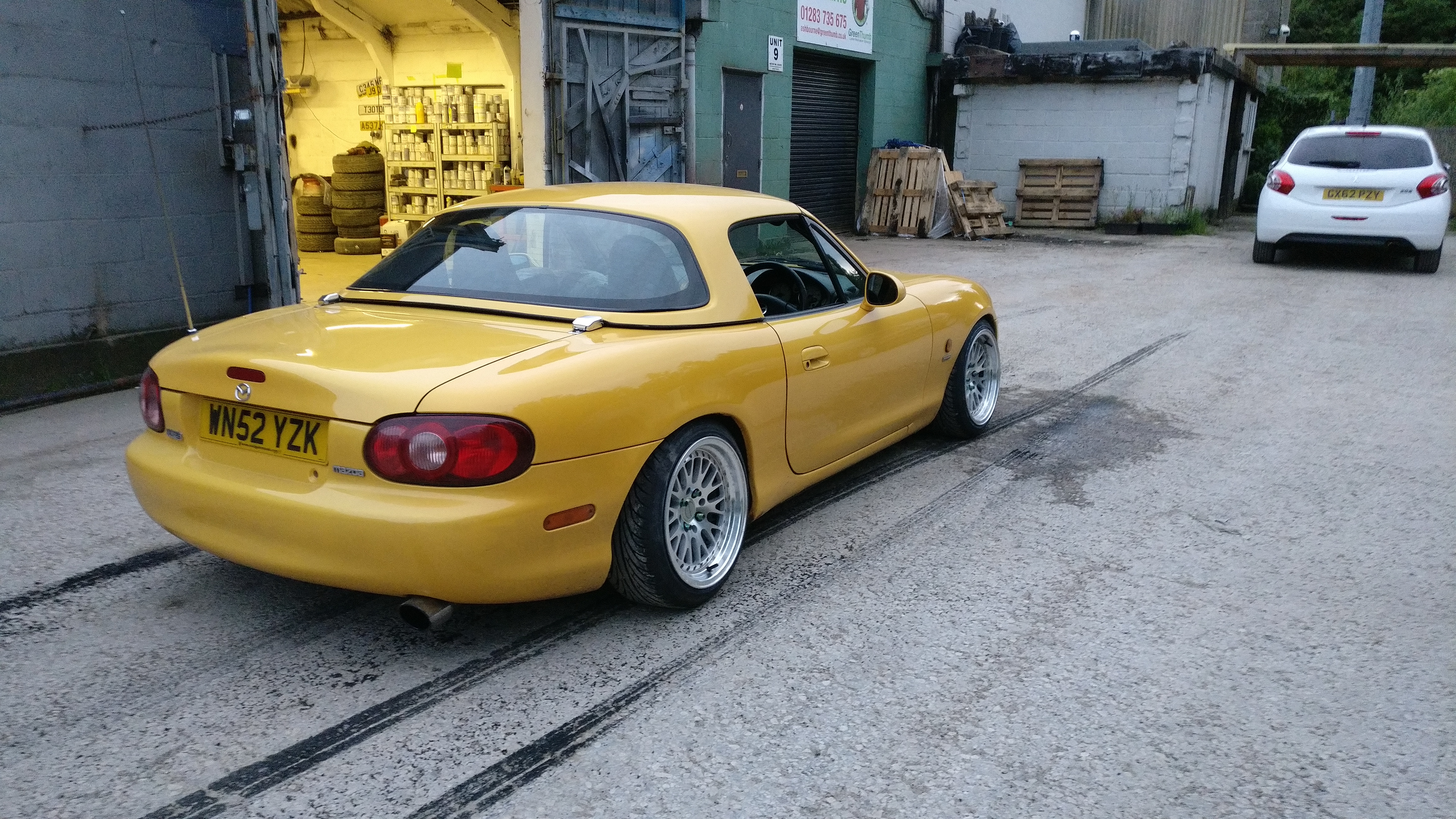

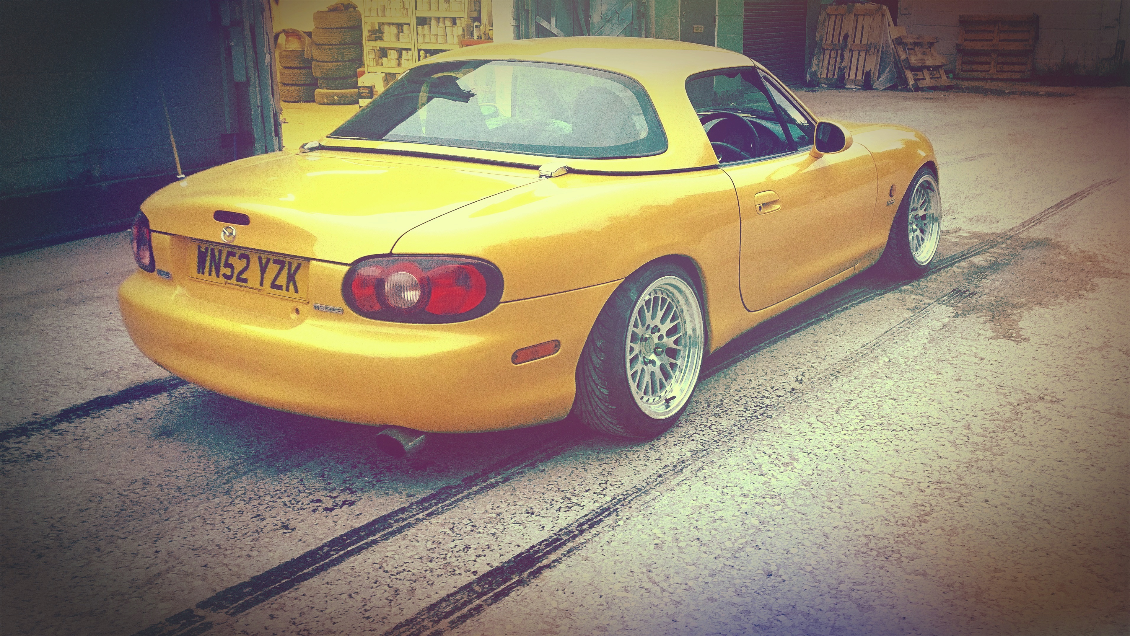

TROYston Posted June 13, 2017 Report Share Posted June 13, 2017 (edited) Things have happened, fitted the exhaust properly, welded the centre pipe onto the downpipe after making a section of exhaust. Learning experience and would of just rather paid for it to be done. But it's all sealed well and kept the cat and all the lambdas now. 165/50s come, all the garages in burton couldn't get the shits on, so tried myself with the fire method, to no avail. I know they'll fit on 8j, but the ultralites being single lipped would of been overly bad and potholes probably would of blew the tyres off the bead, so phoned my tyres and sending them back for a refund. Phoned a few place's in burton and got some 185/45 nankang ns2 fitted, not much stretch, but enough to clear everything. Lowered it more, waiting a few days for it to settle and then probably wind it down a little more, but I'll have to take the rear diff / chassis strengthening brace off before it grabs something and launches me into the windscreen. Still need to adjust the camber and play with spacers Quite potentially getting a fast back hardtop prototype at the end of the month, or a custom roof spoiler. Edited June 13, 2017 by TROYston 1 Quote Link to comment Share on other sites More sharing options...
