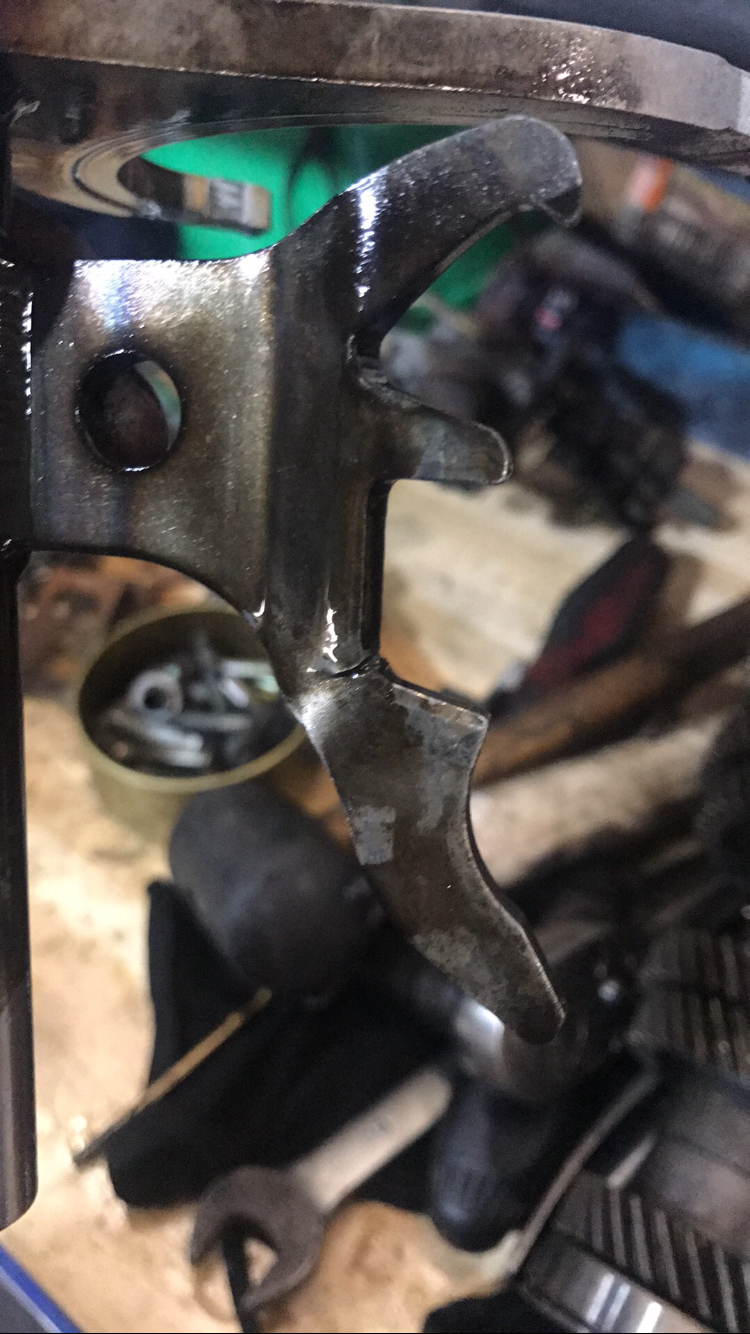

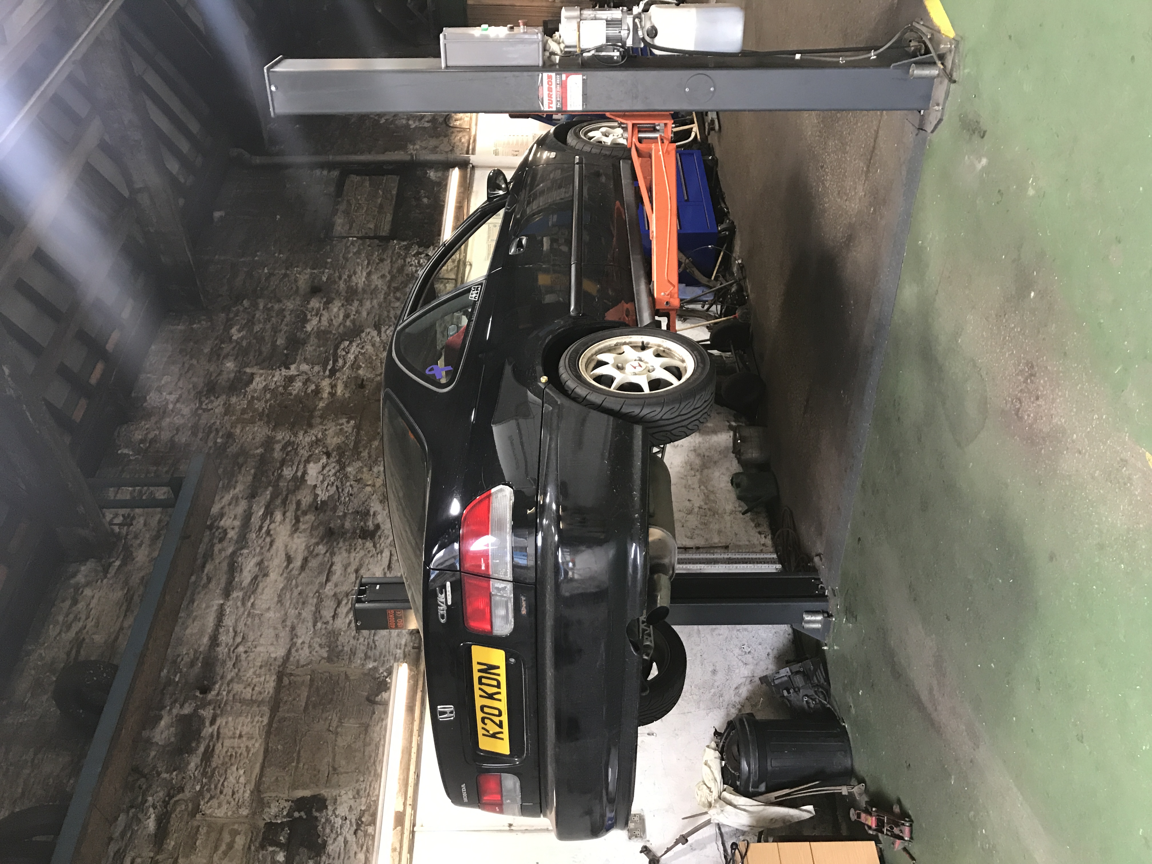

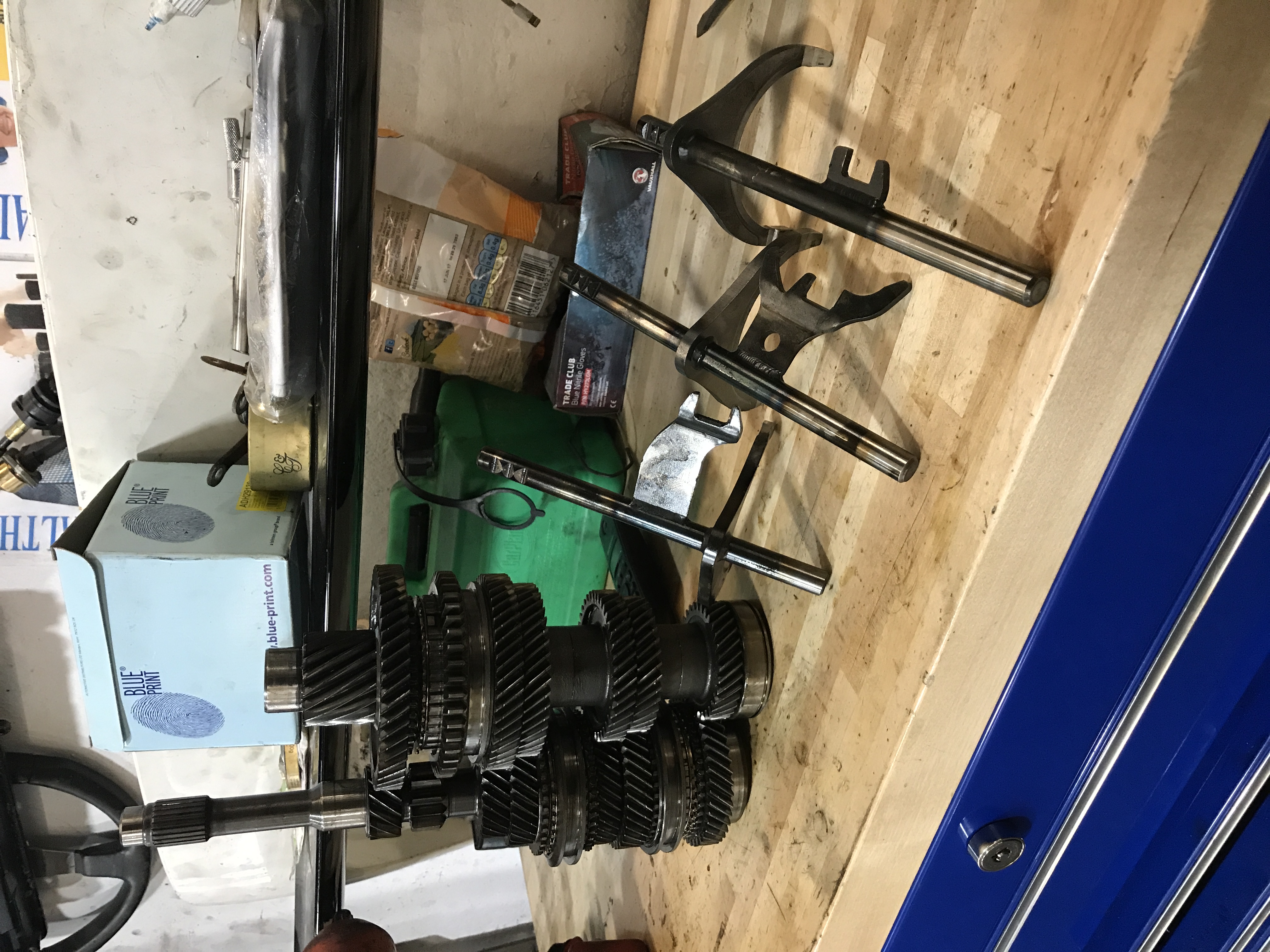

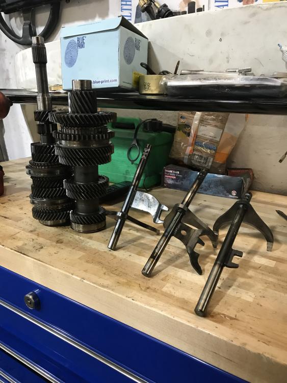

SamKidney Posted April 9, 2017 Report Share Posted April 9, 2017 Put the MX5 on a track and you'll realllllyyyy see the appeal. I wasn't sold on them at all until Alex took me out in his! Coupe news. I repaired the gearbox Saturday evening after work. Opened it up and as expected, I found the offending gear selector fork bent. Could have been a simple replacement but unfortunately the snap ring around the 3rd gear syncro had been chewed up beyond recognition and needed replacing. I've used the gearset from the donor gearbox with all said syncros and forks. Works a dream! Took the chance to get my tyres swapped across onto my DC2 wheels, so as to return the wheels I'd been lent by Hayden. 300 miles done over this weekend and it's working flawlessly. I've got my B series box now with the LSD so next time the box/engine has to come out I'll get the diff fitted too. 2 Quote Link to comment Share on other sites More sharing options...
