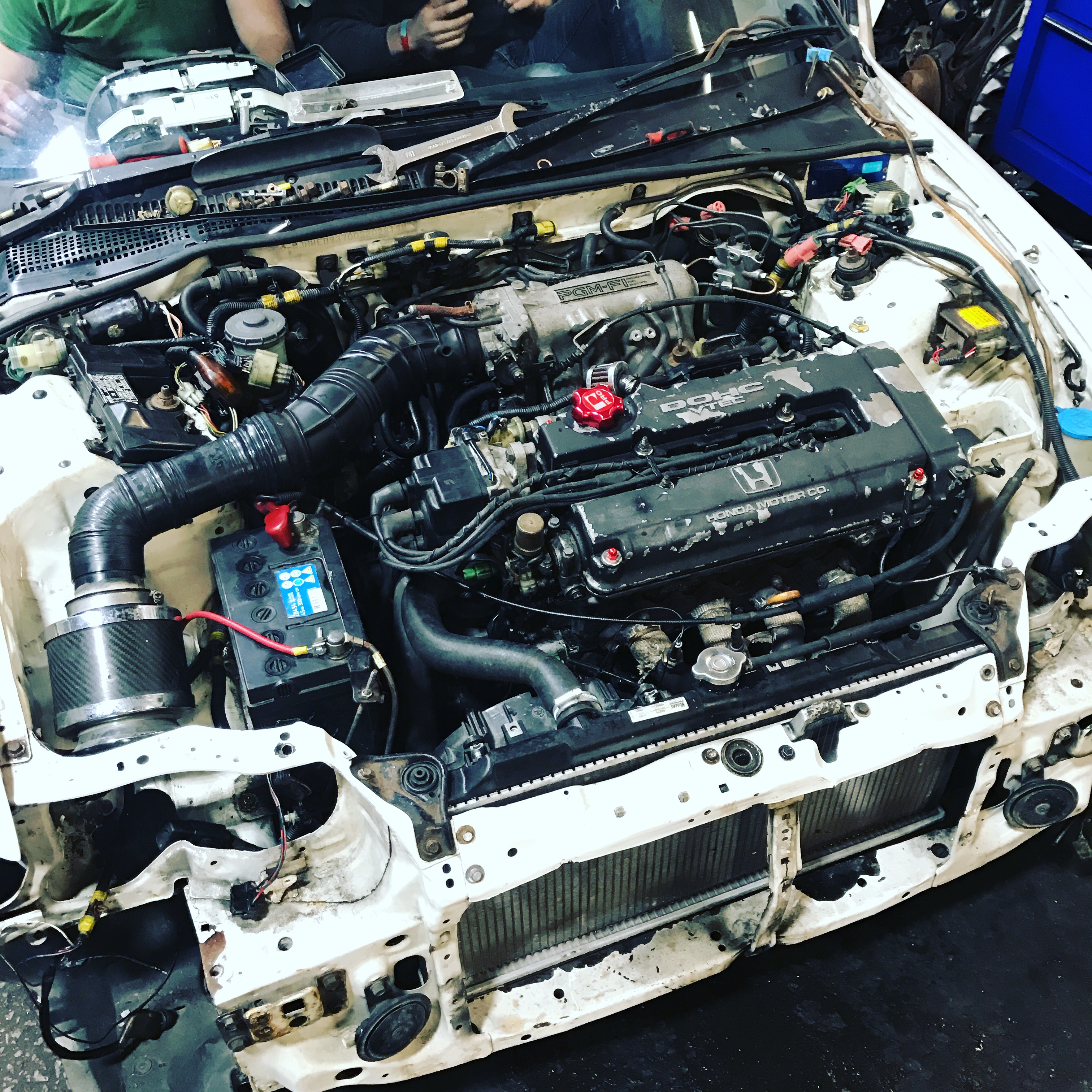

Bought this, you've never seen 2 young lads act so f**king twitchy about selling a car, turns out that is largely because the head gasket is blown but it takes a good long while to start overheating.
$300 though, the snow chains in the boot and scrap will cover most of that if K-seal doesn't sort it :P
What was that saying?
Buy cheap buy once? No? Twice? Yes.

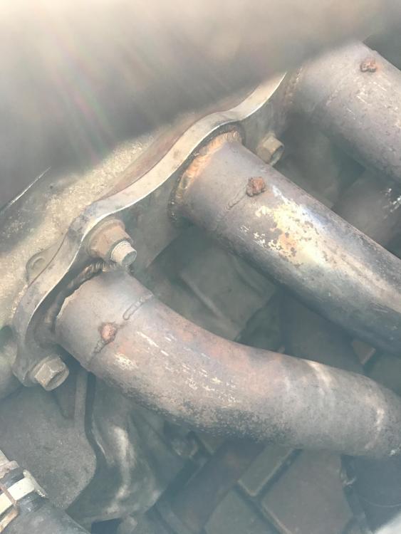

Exhaust manifold is cracked :(
Coming off the road tomorrow anyway so no great problem. Think I'm taking the opportunity to cut down on some cars and shell this into my green hatchback now I know it all works. My Dads just given me his Renault Laguna 1.9DCi so I need to find room for that too :lol:
