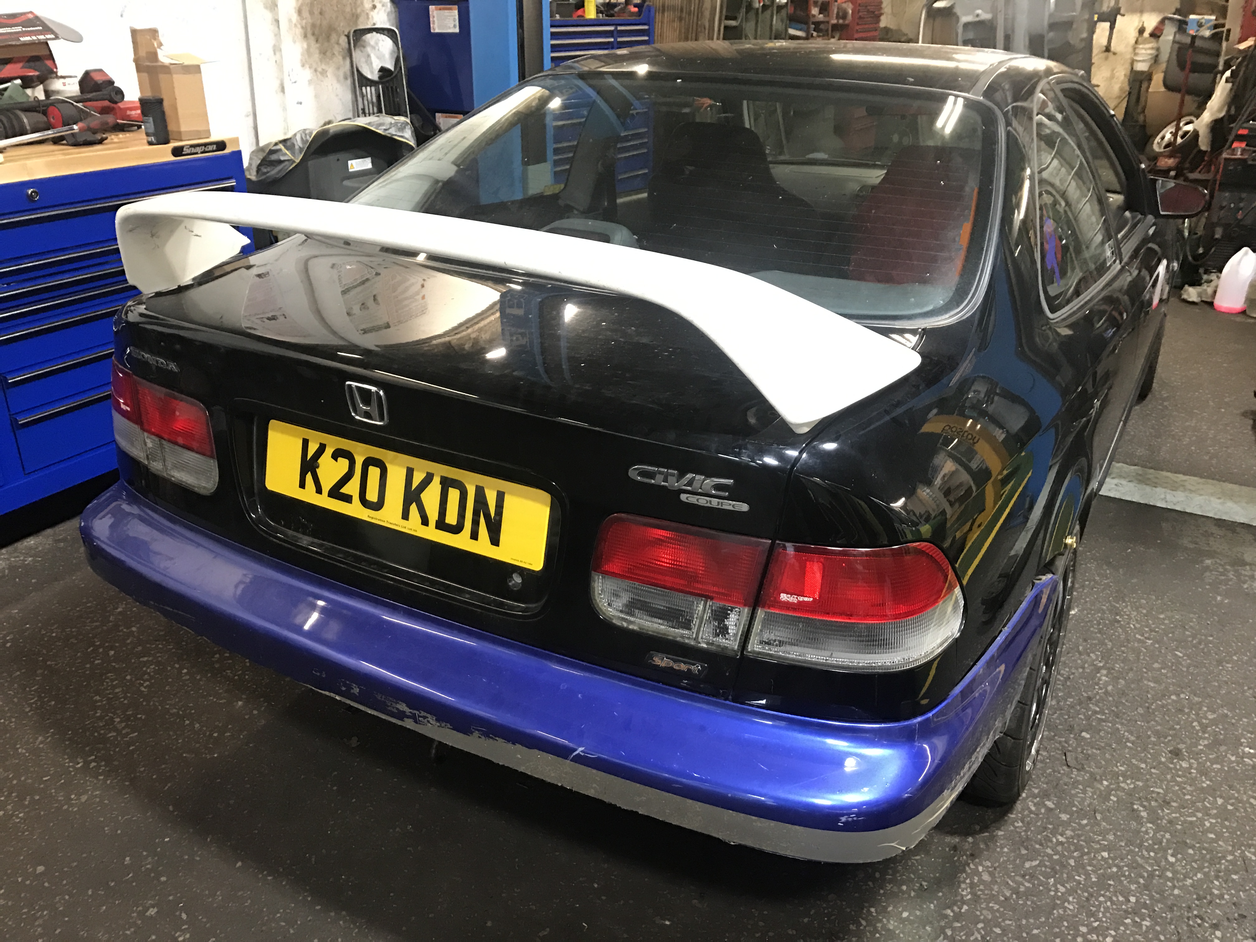

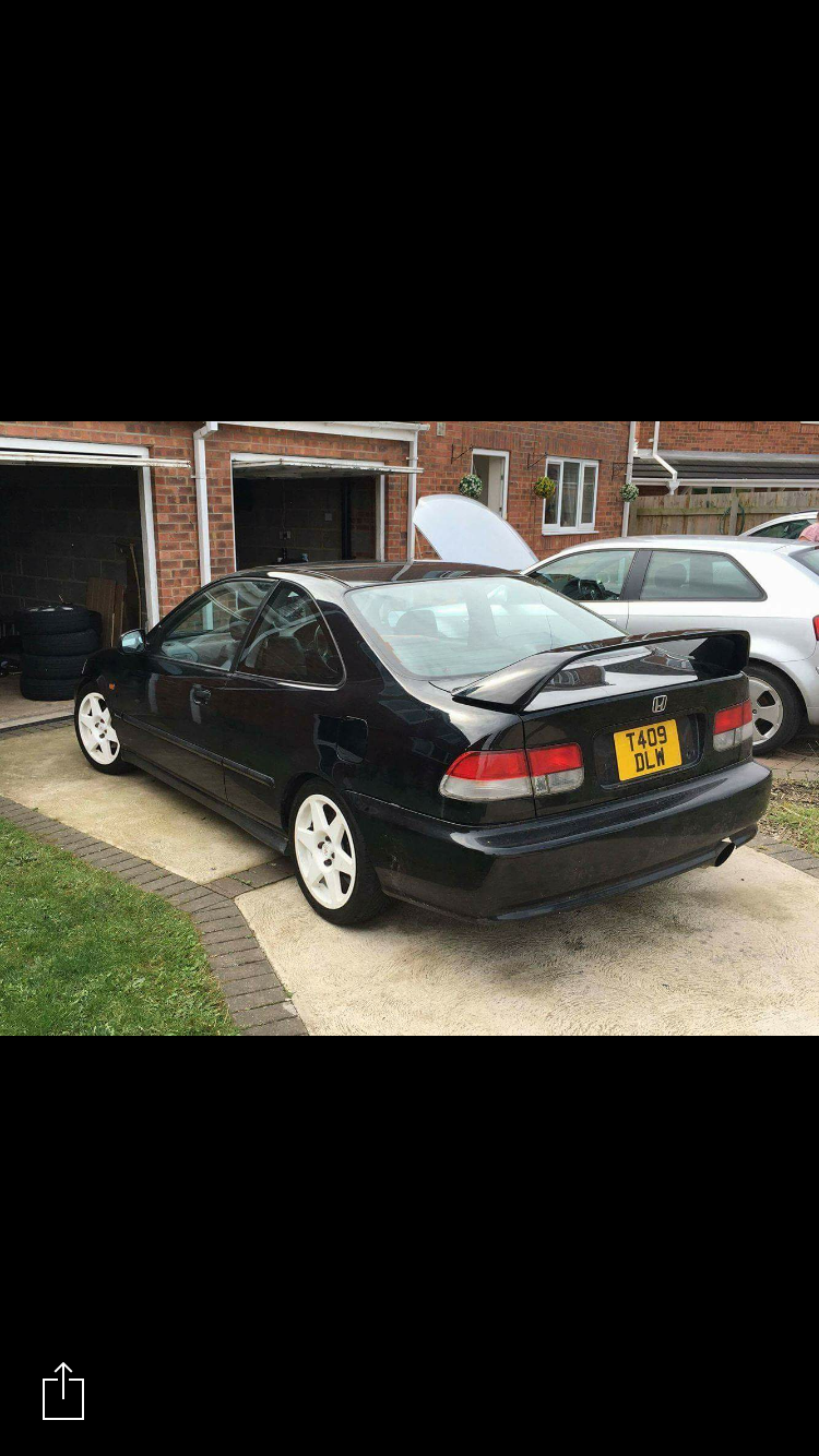

SamKidney Posted February 19, 2017 Report Share Posted February 19, 2017 Undecided on the DC2 spoiler. Quote Link to comment Share on other sites More sharing options...
dann2707 Posted February 19, 2017 Report Share Posted February 19, 2017 Definitely not imo. Looks way too London bad manzzzzz Quote Link to comment Share on other sites More sharing options...
MadManMike Posted February 19, 2017 Author Report Share Posted February 19, 2017 Hmm, I'm not sure. I'm 50/50 on it. If the whole car was the same colour and it was properly fitted I think it would look OK. Quote Link to comment Share on other sites More sharing options...
SamKidney Posted February 19, 2017 Report Share Posted February 19, 2017 Yeah i think once it's all black it'll suit. Im not a fan of a spoilerless coupe as it looks like they're missing something. It's more subtle than the other BGW it came with. Quote Link to comment Share on other sites More sharing options...
JD™ Posted February 19, 2017 Report Share Posted February 19, 2017 It's a definite yes from me. I agree it looks naked without, and the BGW is completely wrong. Quote Link to comment Share on other sites More sharing options...

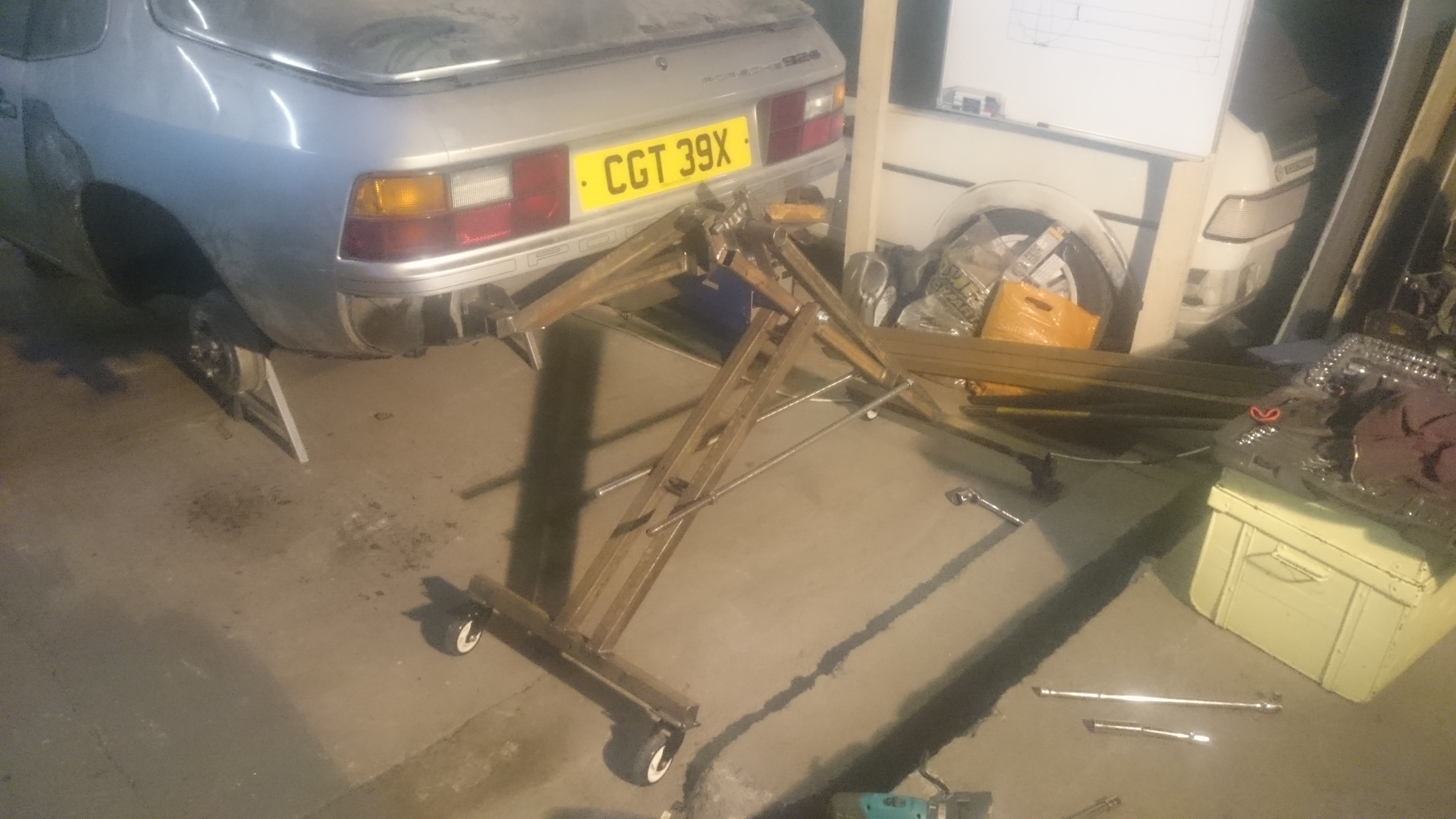

RobinJI Posted February 19, 2017 Report Share Posted February 19, 2017 6 hours ago, forteh said: It would make it a little more complicated with a couple of extra pivots but no more castors. Side loading on castors bends the vertical axle (assuming they're not fixed castors) which typically spews the thrust ball bearings all over the floor. ... Helpful things... Ahh, cheers, yeah I get you. I had considered something similar, but I was thinking more along the lines of building a tray of ~60xó0x6 RSA with a caster on each corner, to place what I've made in (whole but minus the casters.) the deciding factor was that I don't have ant 60x60x6 RSA lying around, and I'm being cheap/impatient, so I thought I'd see how the casters did as it is! The bearings seem pretty chunky, so I think there's some hope they'll last. If they don't I'll do something along the lines of your idea though, thanks for the suggestion. I went out earlier and made up the bracket to go on the front of the car, then tested the jig on it. It worked perfectly, with barely any torque needed on the threaded rod. Then I realised that thanks to where the tressel the back end's sat on is placed, I could pick the front of the car up quite comfortably, so it wasn't surprising I shuffled things around and tried it on the back, which is essentially complete other than the exhaust, gearbox and bumper. It picked it up no real issue, but due to the threaded bar being offset to the side from the pivot, the frame was trying to twist, which I wasn't keen on, so I ended up adding a second threaded bar to the other side to balance out the loading, and provide some added safety. With the second threaded rod on there it's rock solid, and the casters don't seem to be complaining at all, so I'm pretty happy to call it finished for now, but I will be keeping an eye on the casters. I may add a strap with some holes to lock it up, but with 2 m20 rods, either of which can lift the car on its own with a sensible amount of torque, I feel it's pretty safe as it is. The car will be stripped of at least the boot and doors before its mounted up too. 1 Quote Link to comment Share on other sites More sharing options...

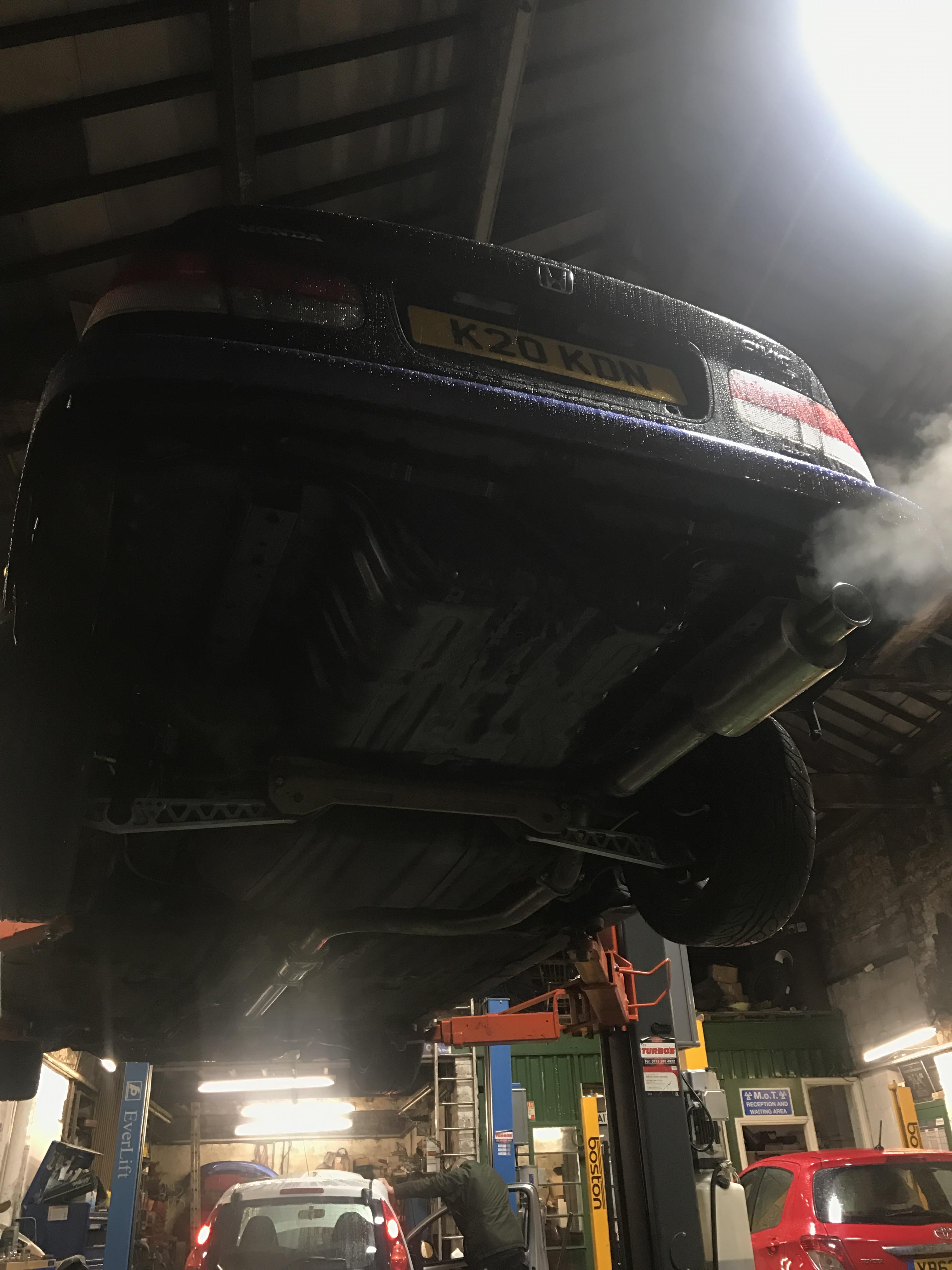

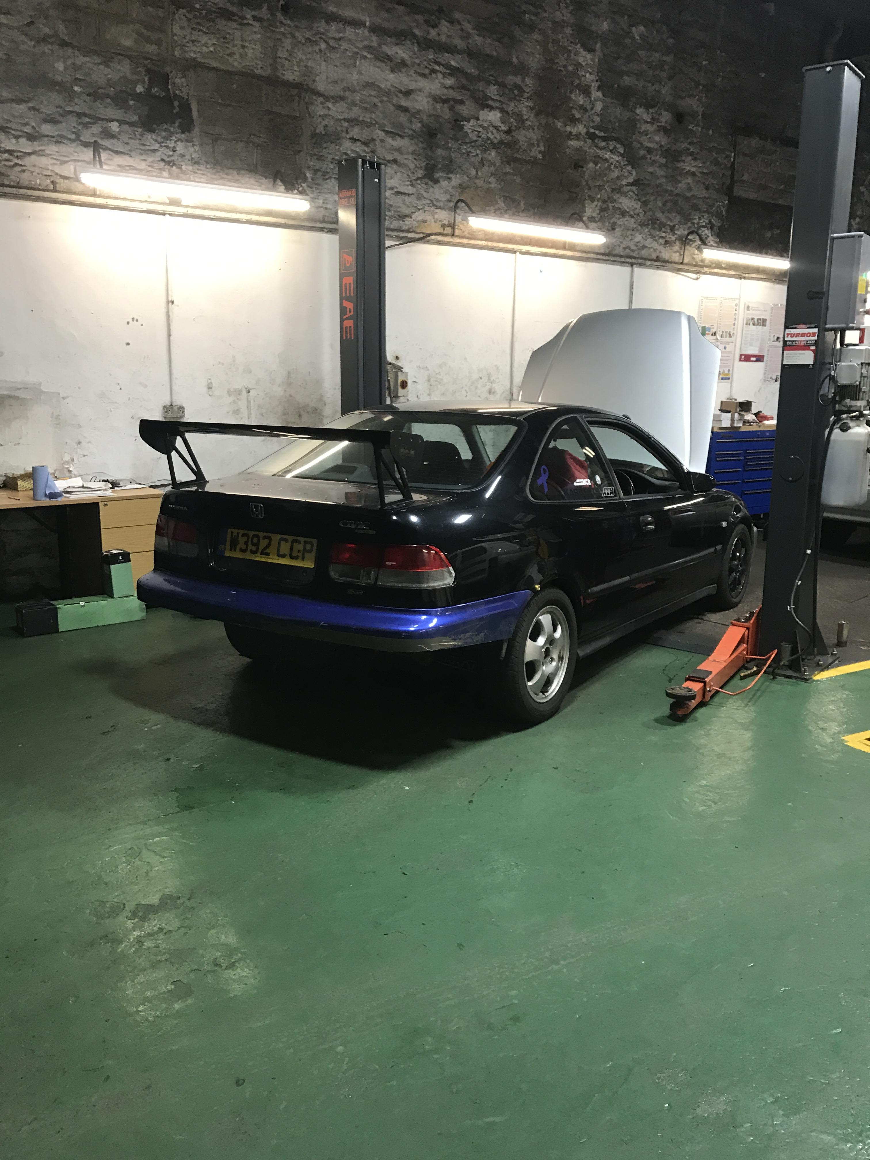

SamKidney Posted February 20, 2017 Report Share Posted February 20, 2017 (edited) I finally have a complete exhaust on the coupe! Still too loud. Will do for the moment, I've ordered another larger centre silencer. Edited February 21, 2017 by SamKidney Quote Link to comment Share on other sites More sharing options...
Luke Rainbird Posted February 20, 2017 Report Share Posted February 20, 2017 Looks good. 5 Quote Link to comment Share on other sites More sharing options...

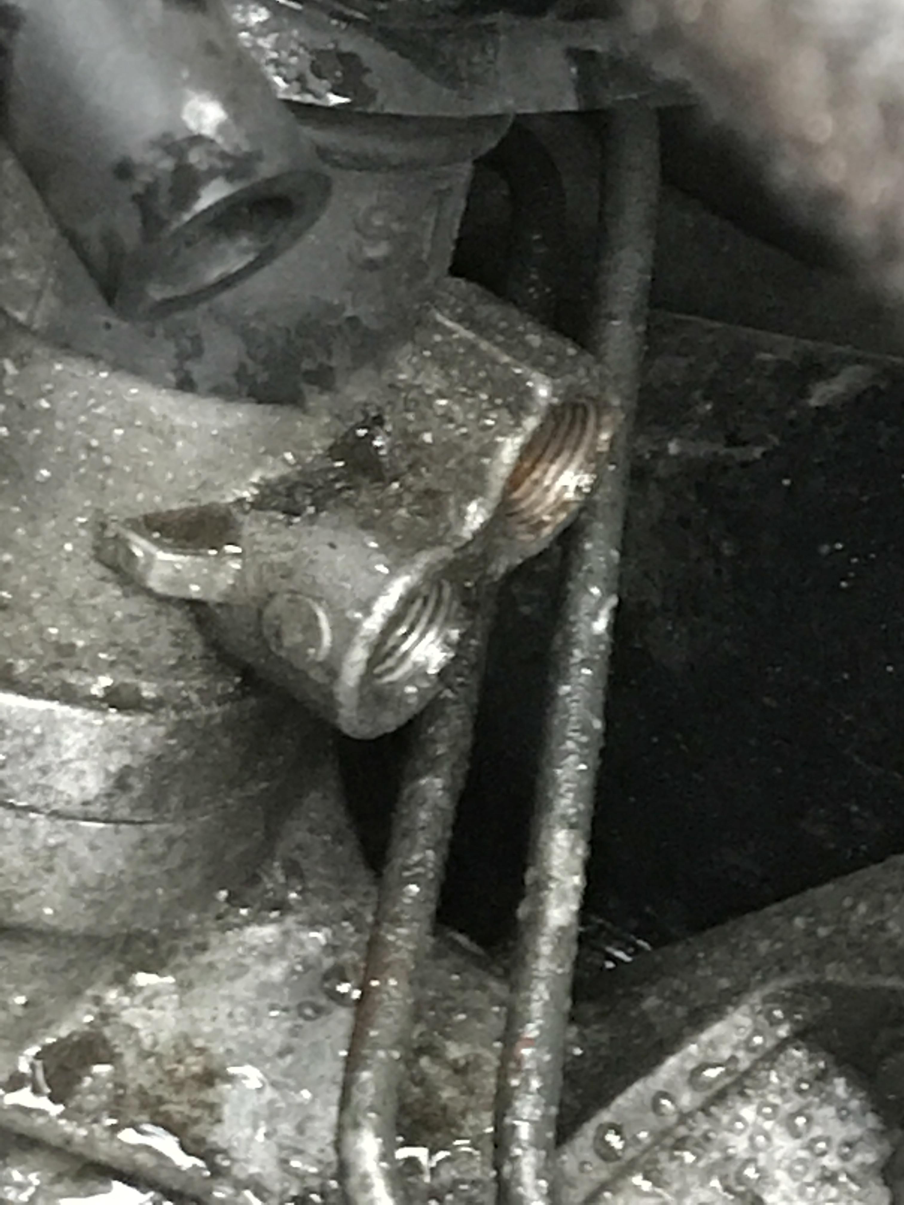

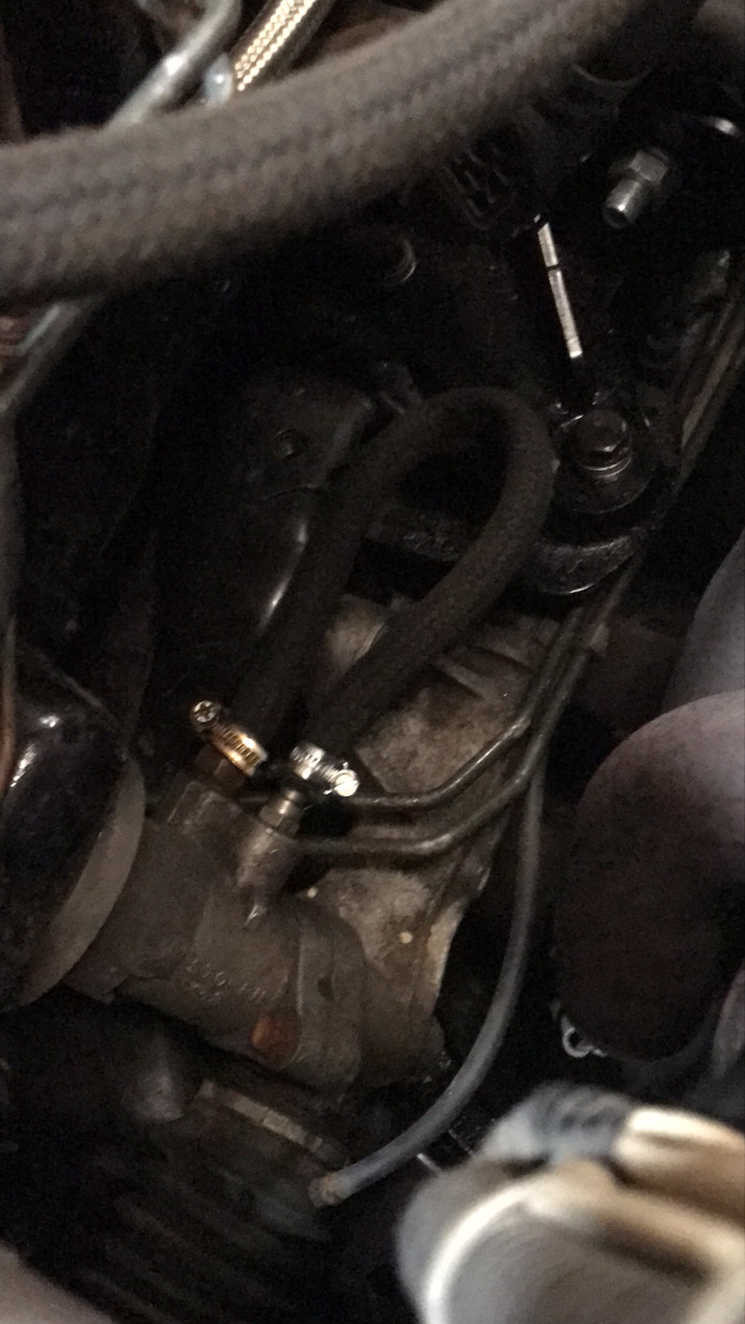

SamKidney Posted February 22, 2017 Report Share Posted February 22, 2017 (edited) More Civic stuff. It turns out airline fittings are the perfect thread size/pitch for a DC2 steering rack lower union.. I'm running no power steering with what was originally a power steering rack so I needed to loop it out to allow the pressure from either side of the piston to be transferred to the opposing side while keeping out the rain/dirt and generally preventing making my steering feel crap. I had the DC2 upper union so that was no problem. Was finishing up re-sealing one of my wheels/tyres, and thought the airline end of the inflated looked very close to that of the rack... it fits. Add a little ATF for lubrication, two jubilees, a length of hose and the jobs done. I plan to source another rack to fully dismantle in order to remove all internal components related to making it a power steering rack for a more perminent solution: i.e. Remove rack piston, diverter valves/unions, pack with grease and rebuild. My bonnet and bumpers should be here tomorrow.. the only remaining pieces left! Edited February 22, 2017 by SamKidney 5 Quote Link to comment Share on other sites More sharing options...
