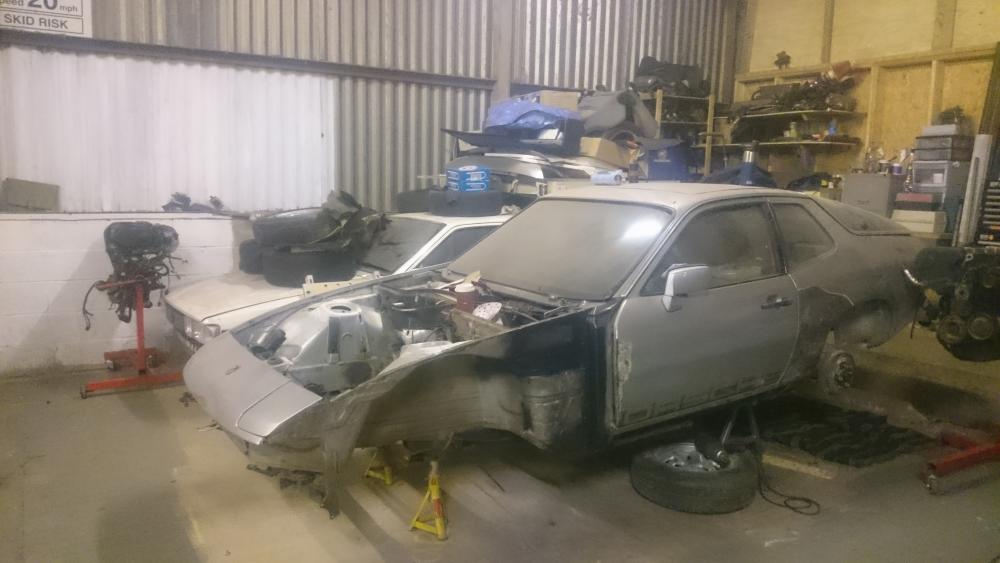

RobinJI Posted February 18, 2017 Report Share Posted February 18, 2017 All looking good Dan. It's a shame no one wanted the shell. I just finished making the first end of a rollover jig for the 924. Hopefully this thing will make sorting out the rust and remaking the suspension a lot easier. I've made it height adjustable so I don't have to jack the car up to a dodgy height to get it onto it, as well as to allow me to drop it down low enough to test fit the engine, as an engine crane won't lift nearly heigh enough to get into the bay with the jig at full height. Once I'm done with it on the 924 a couple of my friends will probably use it, then I'll use it on the scirocco, so although its probably more effort than its worth for the relatively small amount of welding the Porsche needs, it should more than justify it's self in the long run. Plus, I really hate welding upside down. Sadly the car its self still looks like this, hopefully not for much longer though! 1 Quote Link to comment Share on other sites More sharing options...
forteh Posted February 19, 2017 Report Share Posted February 19, 2017 Looks good As per comments on Facebook I would also be concerned with the casters canted over on the dropped position. My experience of castors is that any side load destroys them very quickly, last thing you want to do is to have to try to change a castor with the shell attached. I would mount the castors on a couple of sliding bogies that holds them perpendicular to the floor. You could then very easily fit a number of locking pins at various positions to take the load off the m20 all thread. I'm sure you are able to interpret my poor explanation but yell if not and I'll knock a solidworks model up to demonstrate Quote Link to comment Share on other sites More sharing options...
RobinJI Posted February 19, 2017 Report Share Posted February 19, 2017 Thanks. With the casters I do know what you mean, but I can't see any way of keeping them upright without either adding another 4 casters or a lot of extra complication? It'll never be moved while down, and will spend 90% of its time at full height. The casters are rated to almost twice the load that will be on them, so I'll more than likely see how they go as they are. Replacing them would only involve sticking my jack under that side of the frame, or lifting up that end of the car with the engine crane. If you've got an easy(ish) idea for keeping them level that I haven't thought up I'm all ears though? Quote Link to comment Share on other sites More sharing options...
forteh Posted February 19, 2017 Report Share Posted February 19, 2017 It would make it a little more complicated with a couple of extra pivots but no more castors. Side loading on castors bends the vertical axle (assuming they're not fixed castors) which typically spews the thrust ball bearings all over the floor. See attached sketch, not quite as nice as solidworks but quicker and easier to manage whilst also colouring in Thomas the Tank Engine with a toddler Plummer block bearings for the bottom pivots would be smoothest but a plain bolt through would suffice. Quote Link to comment Share on other sites More sharing options...
