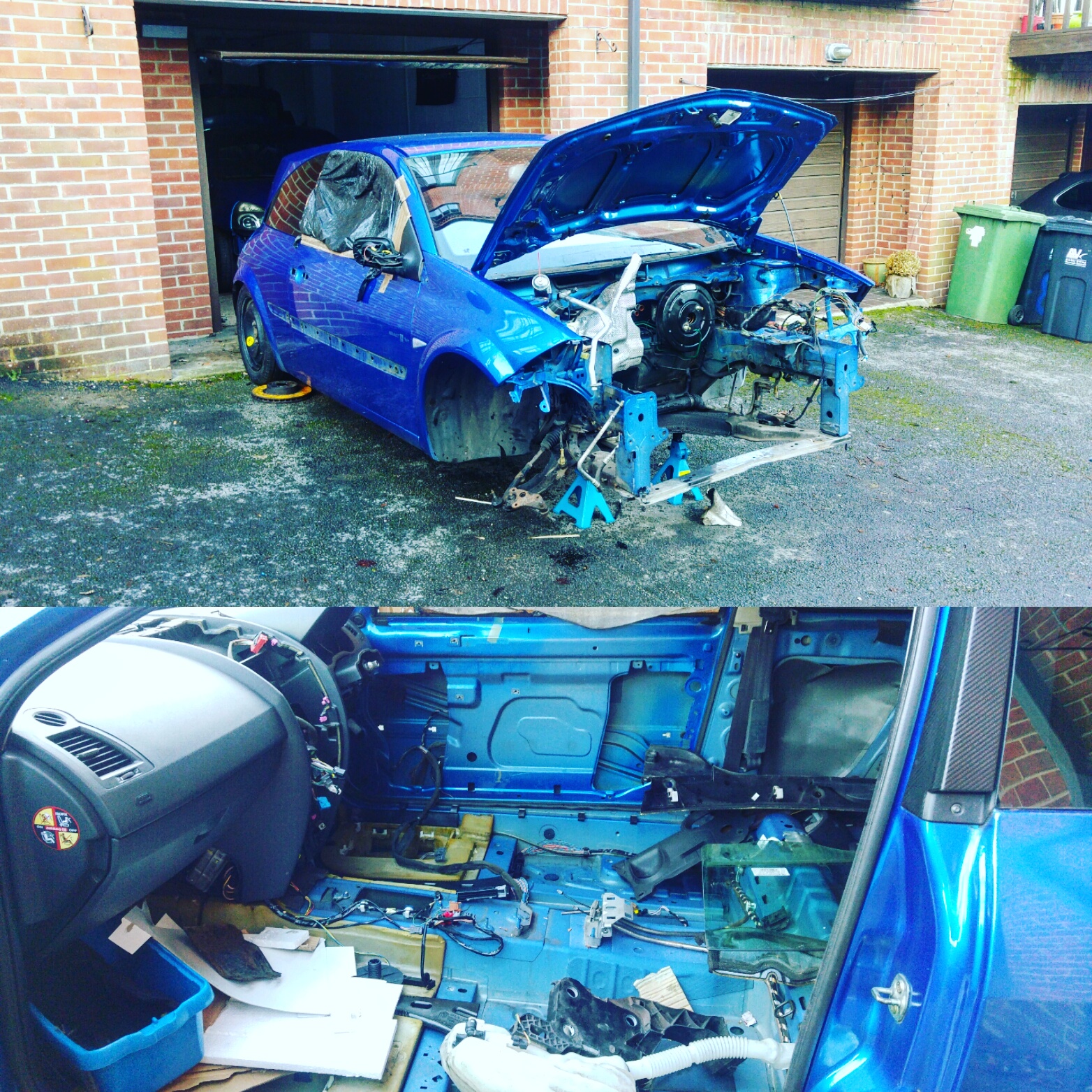

Is the new owner a scrap yard or have you got a decent price for everything that's left on it?
Yeah managed to sell the shell to someone for £250 which is decent I think.  Made a right profit on the car as a whole with me obviously keeping the engine box and loads of other bits and bobs. Received my parts today. Gf messaged me saying "you've received a casual 11 items today" hahahaha
