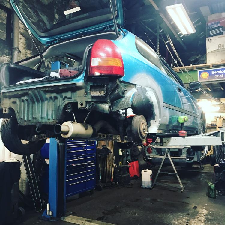

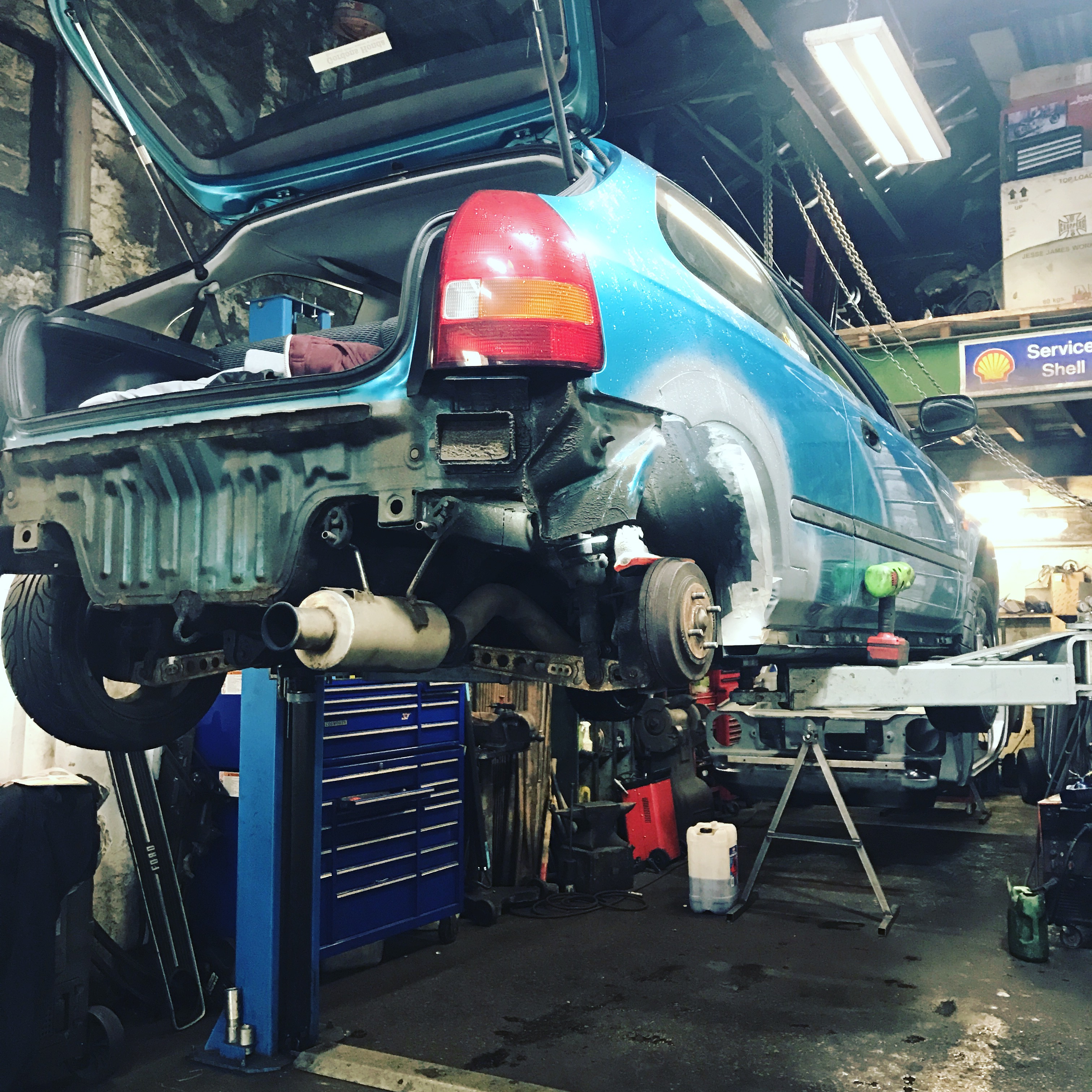

Another weekend at the welder..
Inner arch this time. Useful CAD technology in use to form the templates I need... cheers binky!

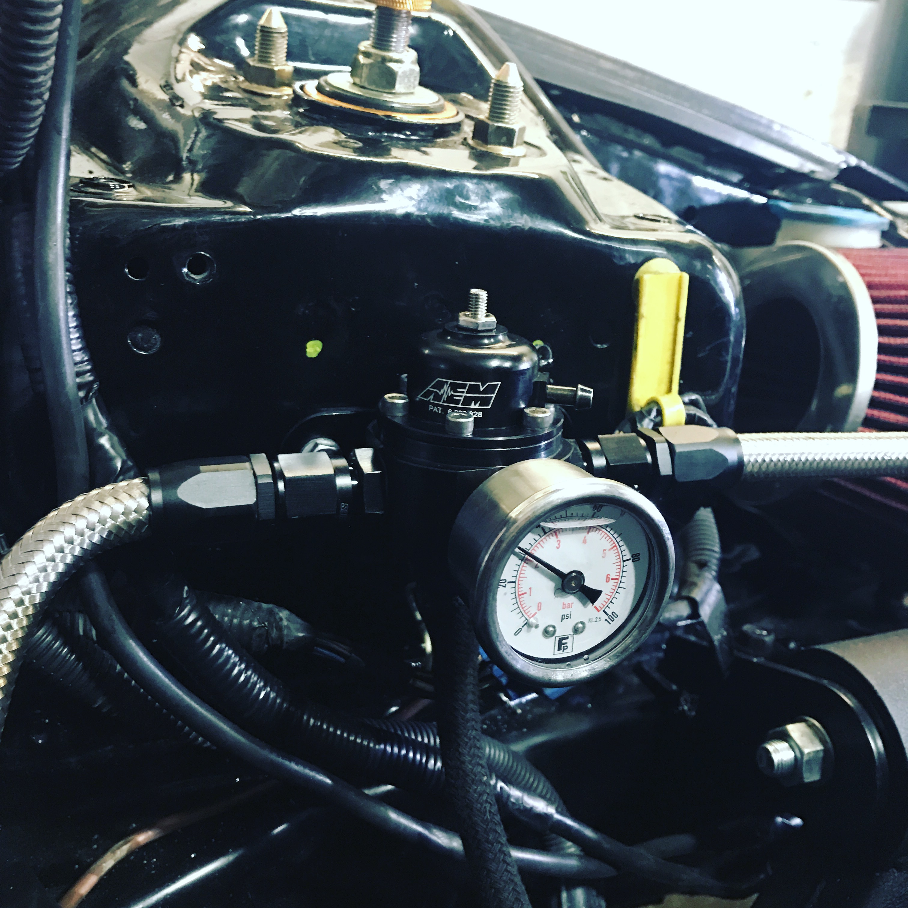

As I'm sure Jolfa will be eagerly awaiting an update, here we go...
Fuel set up is now complete! Engine can be safely run at a rail pressure of 60psi (OE specified fuel pressure for an Ep3).
(image shows pressure after it's been switched off)
AEM universal fuel pressure regulator, with self assembled braided lines and AN-6 fittings throughout. As simple as drilling and tapping two holes in the N/S shock tower and bolting it down. Lovely. I'm going to buy a 90deg fitting for the left hand port as the line sits snug to the battery and I'd rather it didn't.
