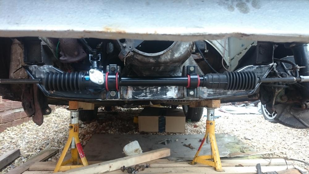

Anyway, the front suspension's been cut up to move the mounting points upwards a load, as well as adapting it to take a mk2 escort steering rack for some cheep quick-rack fitting. I still need to make the replacement wishbones.

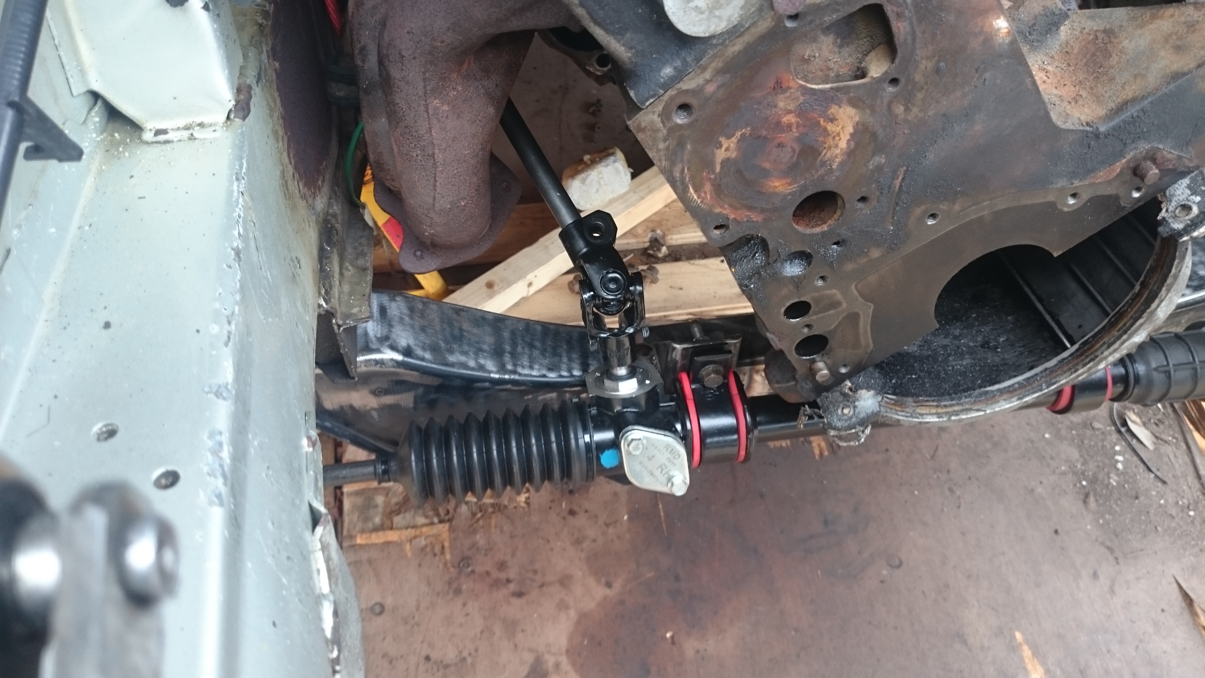

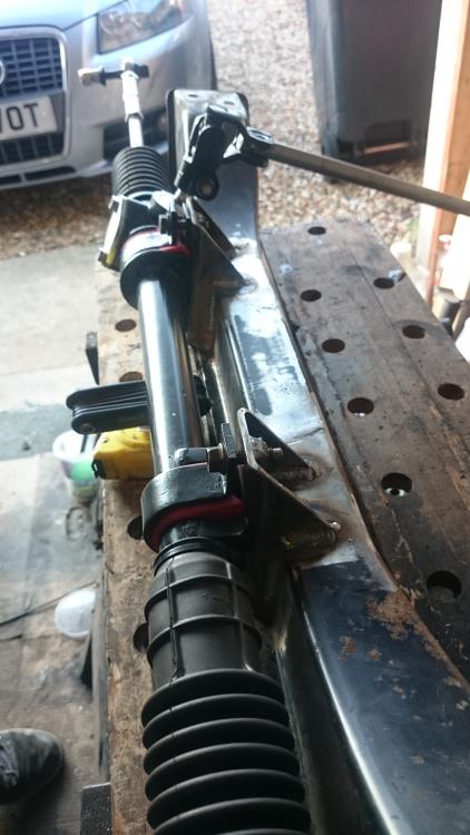

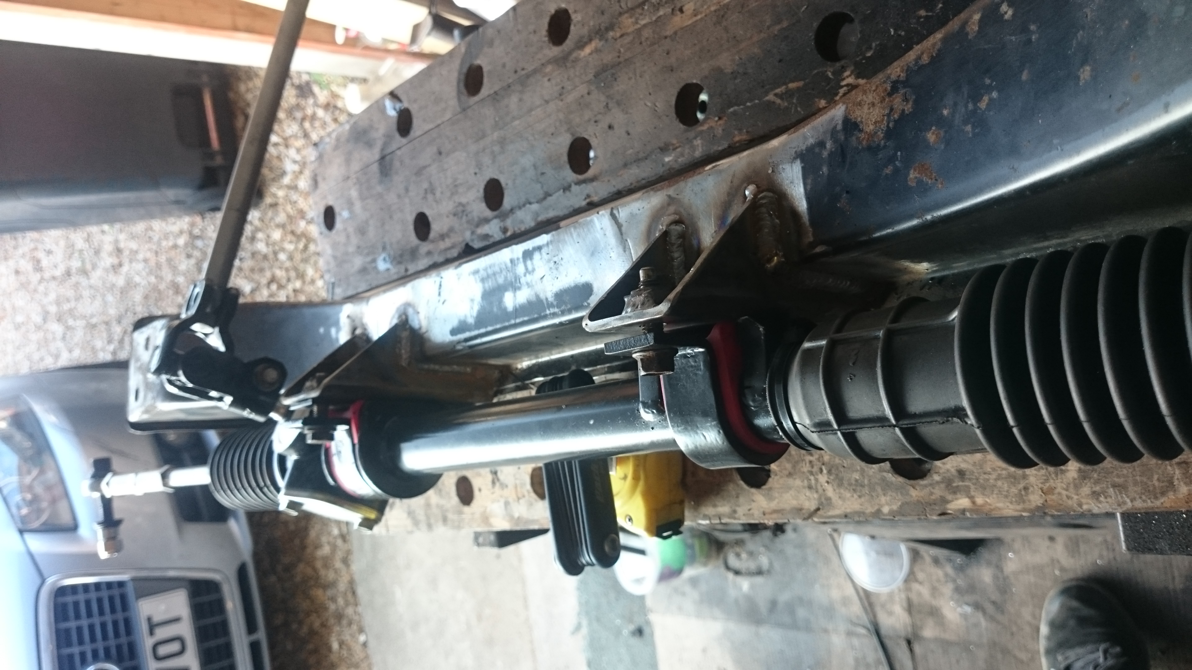

If it's been done before I've not seen it. I have a habit of seeing if commonly avalible Motorsport parts are anywhere near fitting to save some cash. A quick measure showed that an escort rack has a nearly identical joint-joint width to the Porsche, it's general layout's the same and a heavy duty rally 2.4 turn quick-rack new with track-rods is cheaper than a 'quick-rack kit' (that requires a good or referbed rack to built it into) for the Porsche. A bit of welding and turning later and the escort one fits. The slight difference in length of the escort rack will actually give less bump steer.
Brackets on the crossmember:
Assembled with rack and track-rod extension/adaptors:
And test fitted:
