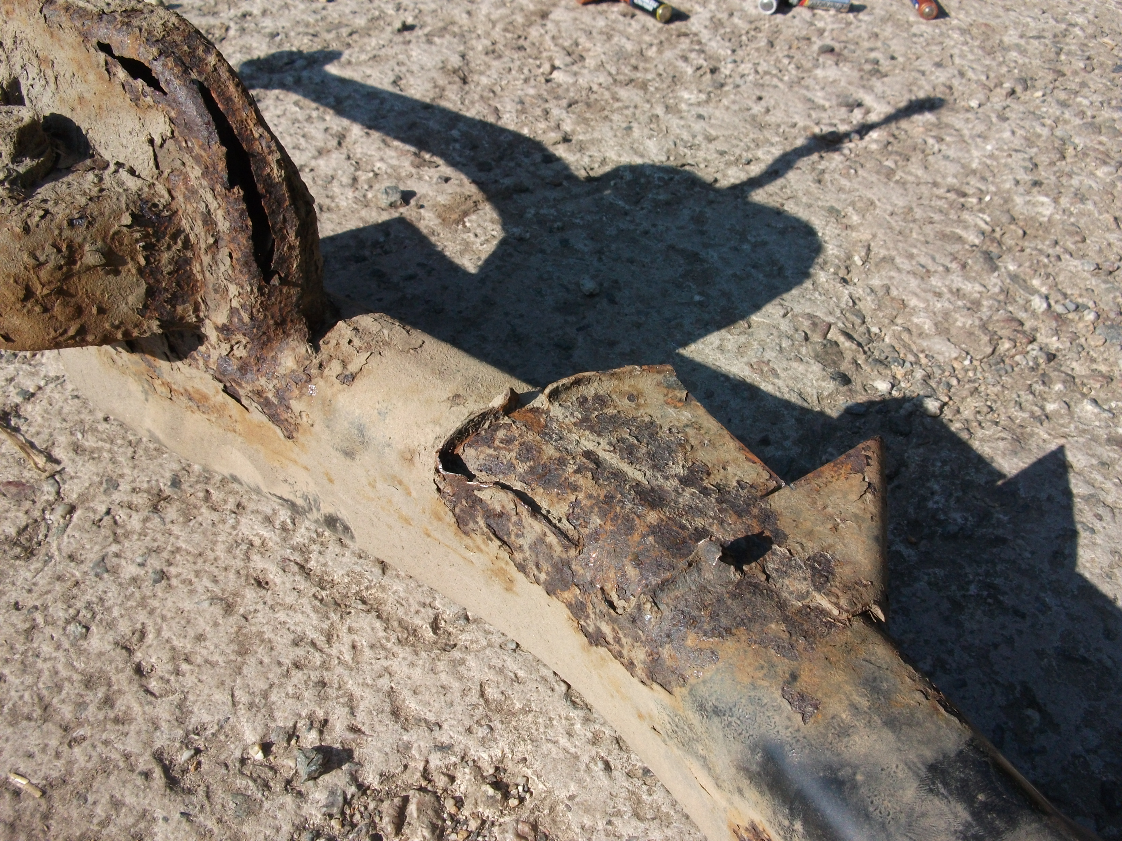

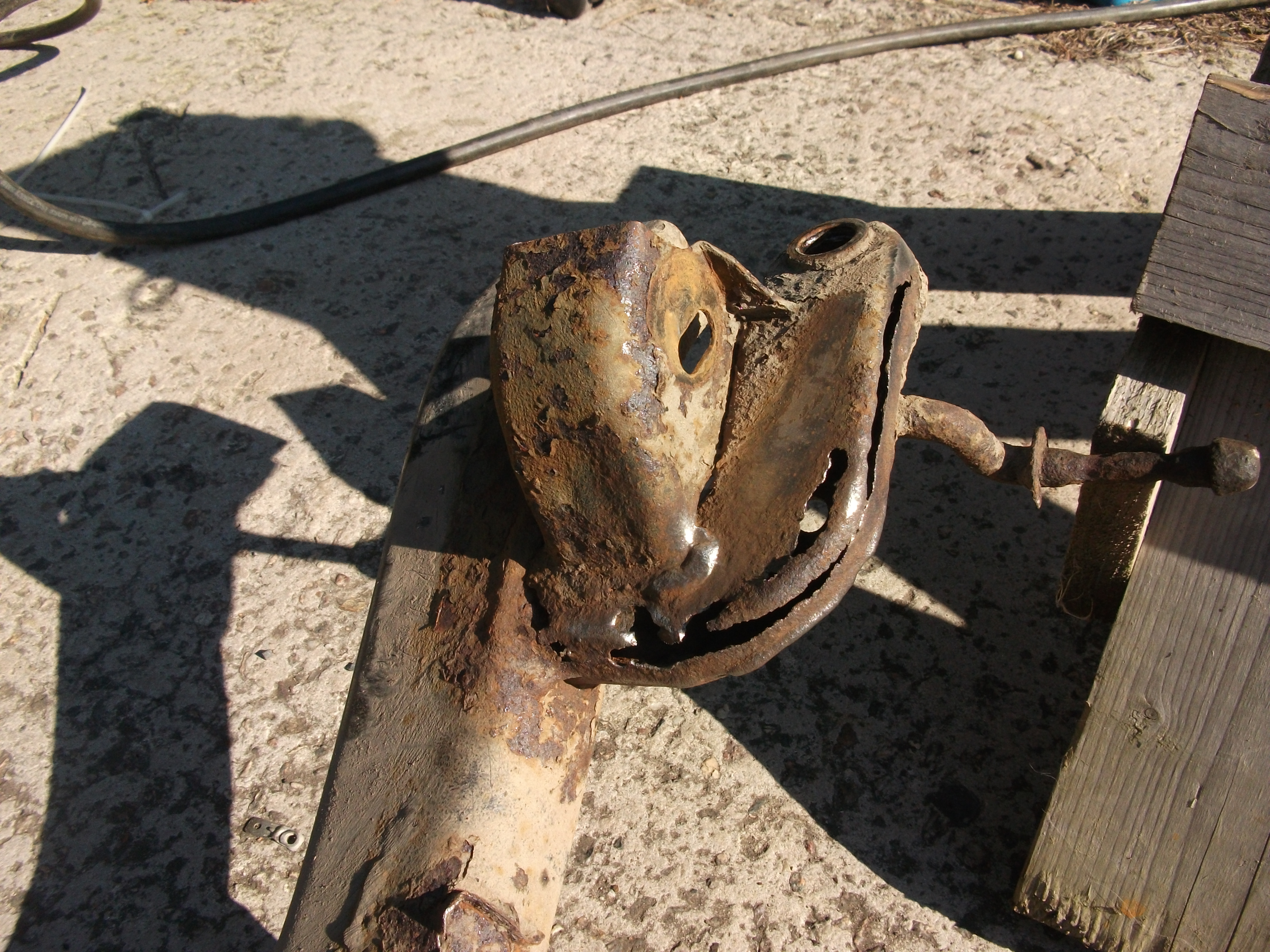

MartMini Posted October 14, 2016 Report Share Posted October 14, 2016 Rear Subframes out! Was actually quite an easy job, no snapped bolts, and only an issue with one bolt seized into the bush sleeve. Attacked the subframe with a wire brush to see how bad it actually was: f**kkkkk! Quote Link to comment Share on other sites More sharing options...
MadManMike Posted October 14, 2016 Author Report Share Posted October 14, 2016 Holy shit! Remind me what car that's from?! 1 Quote Link to comment Share on other sites More sharing options...
MartMini Posted October 14, 2016 Report Share Posted October 14, 2016 Toyota celica, Gen 7, passed mot 6 months ago Quote Link to comment Share on other sites More sharing options...

MadManMike Posted October 14, 2016 Author Report Share Posted October 14, 2016 20 minutes ago, MartMini said: Toyota celica, Gen 7, passed mot 6 months ago Christ, pretty in depth inspection then, clearly! Quote Link to comment Share on other sites More sharing options...

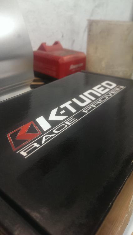

SamKidney Posted October 16, 2016 Report Share Posted October 16, 2016 I got some more goodies. Manifold. Going to have it welded all up to remove clamps. And my K swap wiring harness. I like. 2 Quote Link to comment Share on other sites More sharing options...

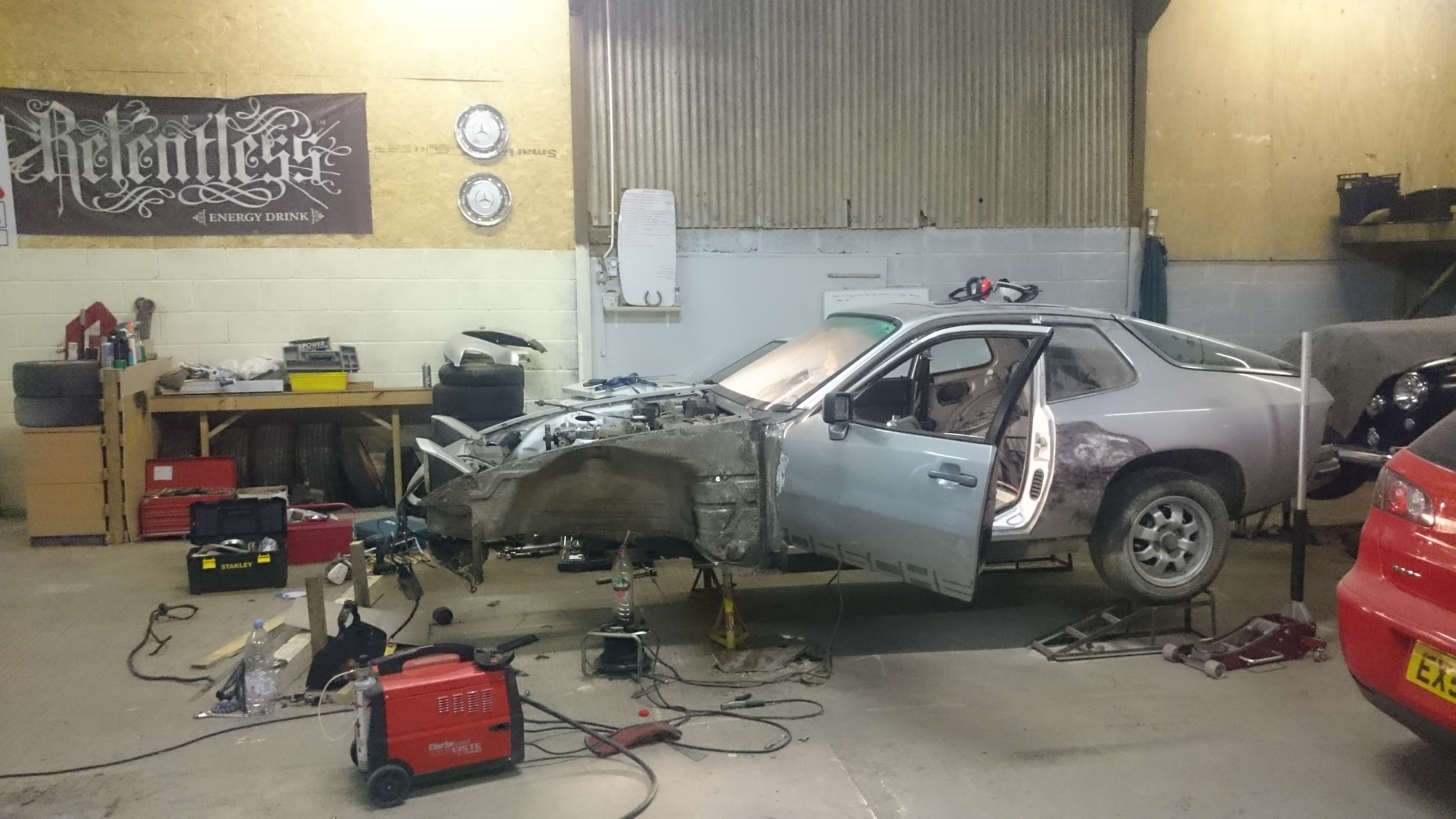

RobinJI Posted October 18, 2016 Report Share Posted October 18, 2016 It's been a while since I've posted in here besides the odd comment on what you guys are doing. The Porsche hasn't really been the 'rolling project' I'd hoped it would be and has now been off the road for over a year. On the bright side, I've finally found a place in some shared workshop space, so can crack on and hopefully get it going again for spring. There's not much in the way of firm plans, but it'll be far from standard when it hits the road. Torn apart: 4 Quote Link to comment Share on other sites More sharing options...

RobinJI Posted October 18, 2016 Report Share Posted October 18, 2016 Haha, I genuinely hadn't noticed the pager number! I really am unsure what the plan is with it in a lot of respects. It's getting made into a track orientated car though, stripped interior, cage etc. I'm definitely remaking most of the suspension and steering stuff. It's lost most of its wiring loom and I'm in the middle of repairing some poor previous rust repairs. Im really on the fence with what to do about the engine. On the one hand, I want to have some fun with a standard, underpowered engine getting to know the cars handling and improve my driving. On the otherhand, my standard engine's broken, and it'll probably be cheaper to swap in something more modern while its apart. Quote Link to comment Share on other sites More sharing options...

RobinJI Posted October 19, 2016 Report Share Posted October 19, 2016 Laurel for sure. Way more interesting, and although you say it's the less sensible option, it'll probably be more trouble free than the Audi. Plus, you won't have to buy new wheel immediately Now I'm on a computer (not my phone) I'll add a little more detail to what's going on with the 924 in case anyone's reading. Basically, since I decided I wasn't happy with the noises the engine's been making I've stripped it down a fair bit and found loads wrong with it. God knows how it was working. Anyway, the front suspension's been cut up to move the mounting points upwards a load, as well as adapting it to take a mk2 escort steering rack for some cheep quick-rack fitting. I still need to make the replacement wishbones. Since getting it down to the unit I've been able to start tackling stuff on the shell, (I couldn't really work on it much on the drive, so had been pottering at suspension/engine stuff that I could unbolt and take into the garage to work on.) There was evidence of a load of filler in the rear quarter, which I've removed to find a very wobbly but solid panel. I'm hoping to get someone to cut that section out of a car they're breaking so I can replace it, as I'll never get it straight. The bottom of the passenger-side a-post was rotten and had been previously repaired badly, which I've cut out and put new metal in. I need to do the same on the drivers-side, but thankfully it's a smaller area and hasn't got a crap repair in the way. I've bought a pair of new sills, as the passenger-side one's clearly been replaced, and with the quality of the work I've found so-far I don't trust it to have been done well at all! So they need to go on at some point. The main bit I've been tackling's been the battery tray area of the scuttle, which had clogged it's drain and gone rotten at some point, along with all the seams around it. Thankfully that's most of the way back together now. I'll grab some photos when I'm at the unit next. The plan's essentially to get it solid, finish the front suspension, do something as-yet unknown but hopefully clever to the rear suspension, throw in a cage, dash and pair of seats and I guess put an engine of some sort in there at some point. I'm going to need to get a lot of time down at the unit as I'm hoping to do a track-day in it with my house-mate in the spring 4 Quote Link to comment Share on other sites More sharing options...

J.KYDD Posted October 20, 2016 Report Share Posted October 20, 2016 16 hours ago, RobinJI said: Unit looks awesome Robin, so when are we building the training board?! Quote Link to comment Share on other sites More sharing options...
