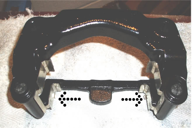

So the squeal from these brakes hasnt gone away, So decided to film it and thus present to you the most windy film including 2 breaking points.
The first is soft to medium breaking, the second noise is the only one that remains unless they're pushed hard.
The second is light breaking, the most common noise.
Maybe ive not fitted something correctly, maybe its just because of what they are for.
Once hot the 'initial squeal' goes away a bit.
Ive bedded them in using the mintex's recommendation and also tried Adams 70 down to nearly nothing hard avoiding abs.
Is it fine or have i got something wrong, i didnt think enthusiast road/light track use pads would be this noisy, not that i care about that, im just fed up of no car people saying i need to fix it...
15ish second's and 28ish seconds in to avoid your ears bleeding.
Edited by TROYston
6 minutes ago, forteh said:
Really, really daft question, have you copaslipped the back of the pads?
Yup, i might get them off weather depending this weekend and plaster the backings in copperslip. I might of been to light with the application after getting fed up of wiping it off the backings when i realise i havent filed enough backplate off.
All the shims and bits still in between the pads and calipers?

no shims come out, nor did any go in....? EDIT: no wait, the FRONT1.jpg shims did go in.

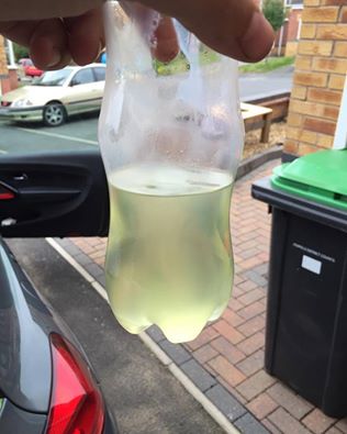

My car decided it hates cheap shit fuel. And runs like wank, so draining the tank, changing fuel filter and running bp ultimate or shell v-power(if the knobs dont rip me off for fuel again £35 of normal fuel for half a tank on the Up!).
This is the state of tescos fuel nowadays

Shims might be then wrong description, but there's little stainless bits that sit at the tops and bottoms of the front calipers and hold the pads.
Doubt it's the filter, as it runs perfectly when it did start, always run it on vpower.
