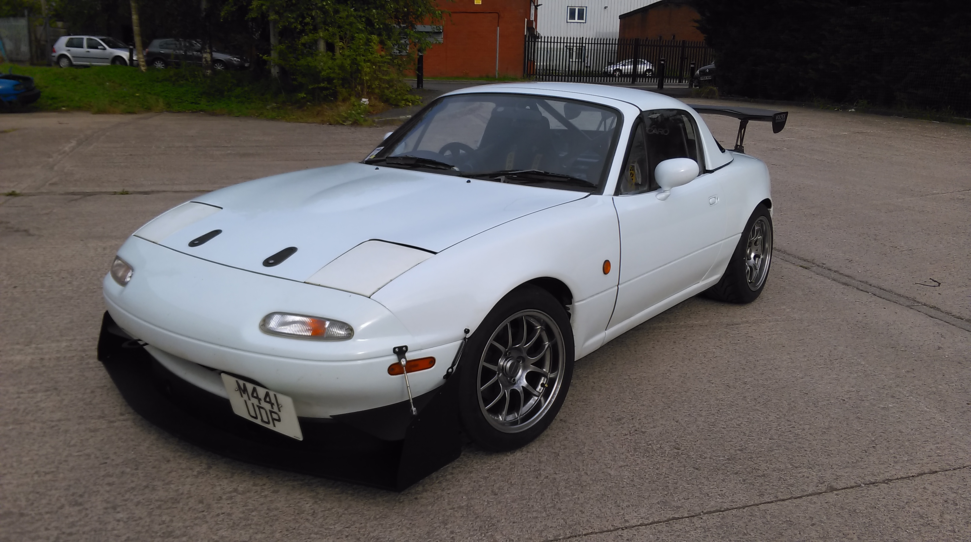

In MX-5 related news, finally got this on the road last night... Runs about 300bhp at the hubs (370ish at the fly according to the dyno operator), when it isn't misfiring, grrrrr....
  • Like 1
