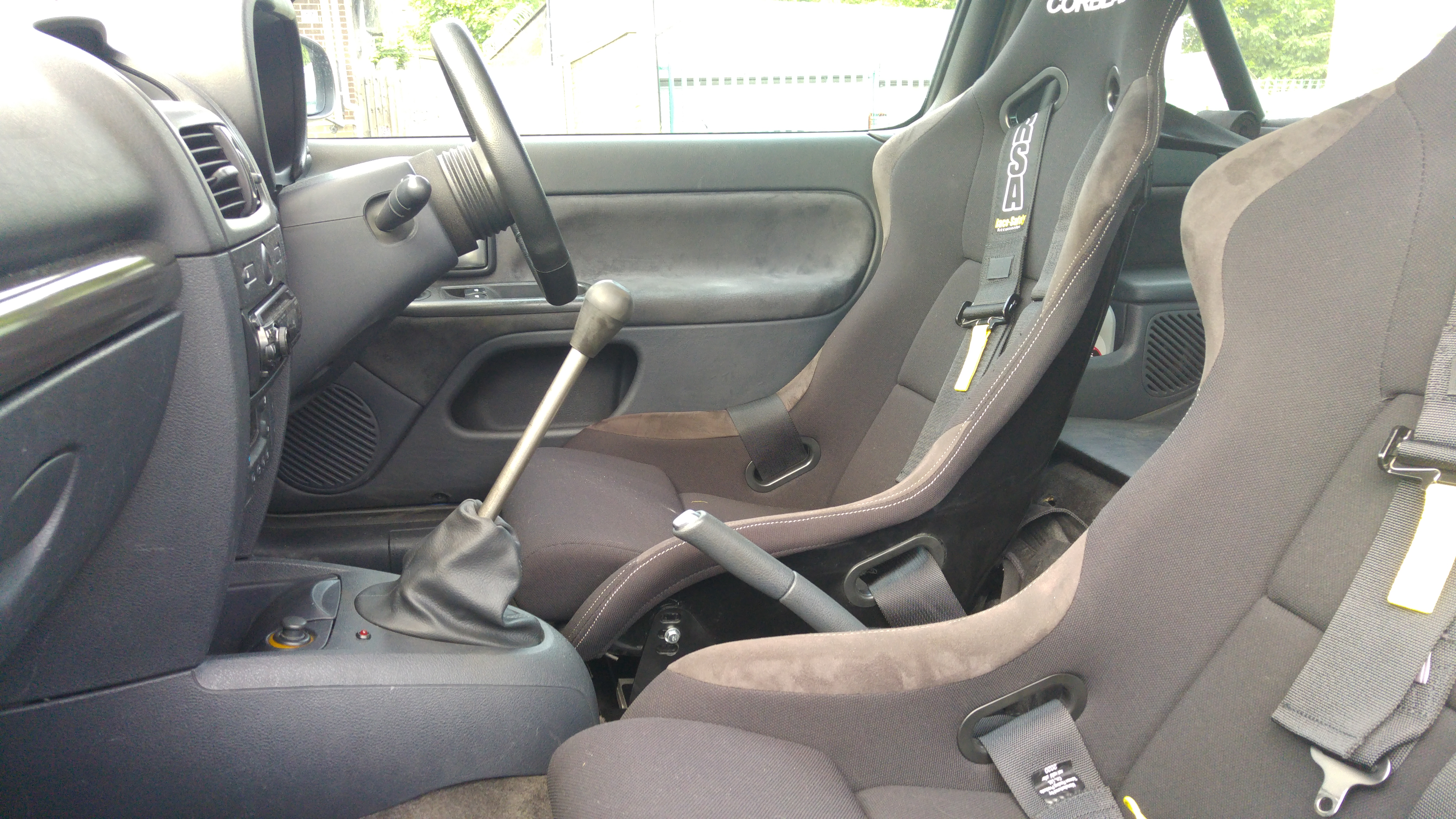

Busy busy tonight and it's finally there. I wasn't fully happy with the angle of the stick and I could have lived with it but as you know it's me and it's gotta be right or I get annoyed.
So I took it off and bent it some more.
27801868355_1c71a35cbc_b.jpg20160620_201745 by dann2707, on Flickr
This is it now in neutral
27801870425_39e49fdecf_b.jpg20160620_205436 by dann2707, on Flickr
First
27189980464_06c140495f_b.jpg20160620_205442 by dann2707, on Flickr
And fourth
27190591003_34fa97394b_b.jpg20160620_205450 by dann2707, on Flickr
I haven't been for a blast yet but after sitting in and changing gear it feels so much better. Can't wait to test it on track!
