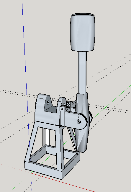

On topic - In this week's edition of "things Luke looks into to pass the time but will never actually get around to fabricating":
Excuse the appalling CAD work - having never really used it before this is all a bit new to me so things are a bit rough, thrown together and no doubt technically awful but enough to give an idea of whether my thinking is along the right lines!

Applaud away, but I have no idea what First Angle is, Ed!
Very quick Google seems to point to the little triple-2d sketch (front, side, top view) layout. Kinda get what you mean now. Unaware that was the name for it though aware it exists :P
The words you're looking for are orthographic projection ;)
99%* of the engineering world seems to use 3rd angle, that is where the projected elevation is displayed on the same side that the projection is taken from (as opposed to 1st angle where it is displayed on the opposite side), only a few places use 1st angle these days (us included because we're an old company and stuck in our ways!).
Quite astonished that you actually drew it in 1st though, 3rd is a more natural (and currently taught) method of draughting.  Even after 25+ years of creating technical drawings, 16 of which have been in a 1st angle only environment I still occasionally slip back to training and start drawing in 3rd :)
*statistics brought to you today by onehundredandthirtypercentaccuratestatistics.com
Yeah, that'll be the one :P
Not sure why, but that way just seemed far more natural to me. I suppose it doesn't make a huge amount of difference if you were to hand the drawings over to a company to produce provided things were labeled up well (unlike mine) and accompanied by a rough 3d sketch/explanation, though as you say it makes sense a firm would stick to one method when producing their own drawings.

A rather crude version of a VWMS shifter like this. Few little tweaks and changes but functionally this is what I'm working around:
Whether or not I ever actually make it is another matter entirely, but quite enjoying figuring it all out and playing with some CAD software, even if it is only SketchUp :)

BUT WHAT ISSSSSSS ITTTTTTT
Edit; It's all gone to shit trying to use volumes of rotation etc. Need to play more to get things right but here's a slightly more complete setup using some NastyAsFunk lever/knob models thrown together to show you how it actually works (few minor components still not on there until I work the software out a little more)
