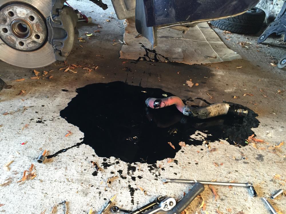

george_seamons Posted March 4, 2016 Report Share Posted March 4, 2016 I've fitted 5 PD turbos to various cars...all of them have snapped shafts. THey must be seriously wank turbos. They all end up with litres of oil in the intercooler pipework...very messy! Quote Link to comment Share on other sites More sharing options...

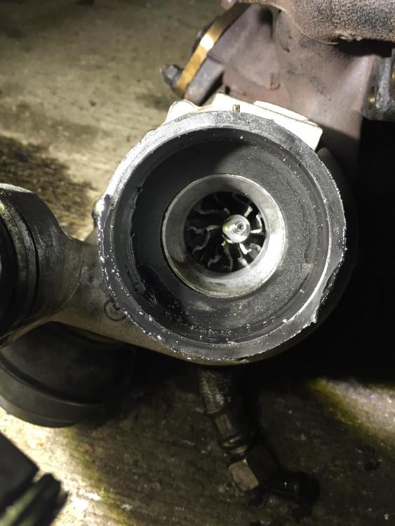

CurtisRider Posted March 4, 2016 Report Share Posted March 4, 2016 Excellent, thanks chaps! I will do the mentioned tests first, see if it's just a silly loose pipe issue and if not then i'll get looking for another turbo for him. There was an excessive amount of oil near one of the recently replaced boost pipes, so that's not a great sign. I will whip off the intake pipe work and see how much play the turbo shaft has too. Fingers crossed it's not the turbo as the poor fella doesn't have much money (he is a TA at my school so crap pay) and considering life has been a shit to him he somehow is still one of the nicest people you have ever met so I want to help him where I can. Quote Link to comment Share on other sites More sharing options...

george_seamons Posted March 4, 2016 Report Share Posted March 4, 2016 Yeah, looks like dead turbo Quote Link to comment Share on other sites More sharing options...

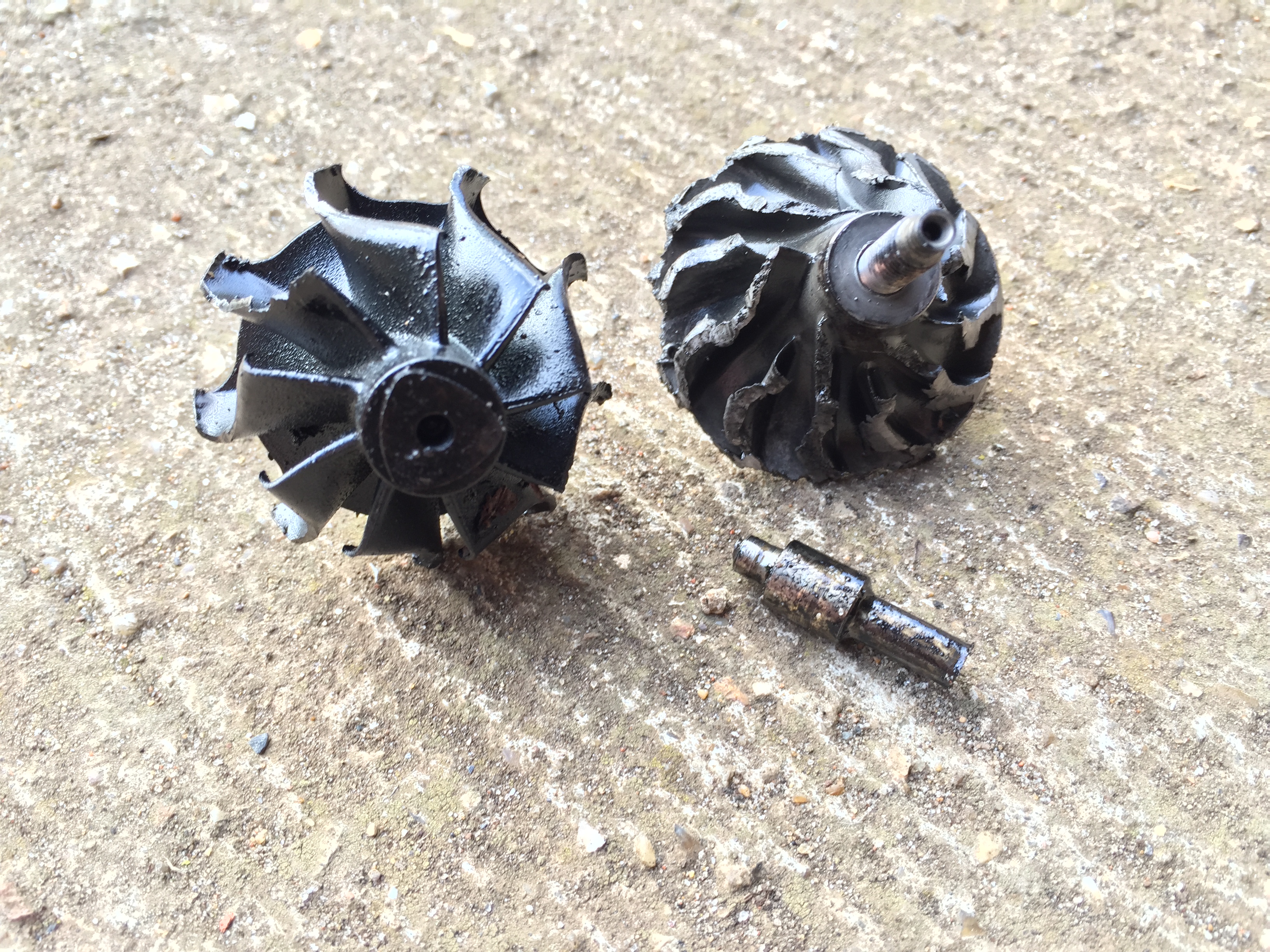

george_seamons Posted March 4, 2016 Report Share Posted March 4, 2016 Last one I did looked like this: Wasn't a very happy motor! After it shat itself all over my floor, I wasn't very happy either! If you've caught it in time before its damaged the casings, you should be able to just fit a replacement CHRA. Quote Link to comment Share on other sites More sharing options...
CurtisRider Posted March 5, 2016 Report Share Posted March 5, 2016 Excellent, so they are a reasonably easy fit I take it? I'll be checking the car on Wednesday, sounds like i'm best off just whipping the air intake hose to the turbo and checking for wobble straight away? Quote Link to comment Share on other sites More sharing options...
