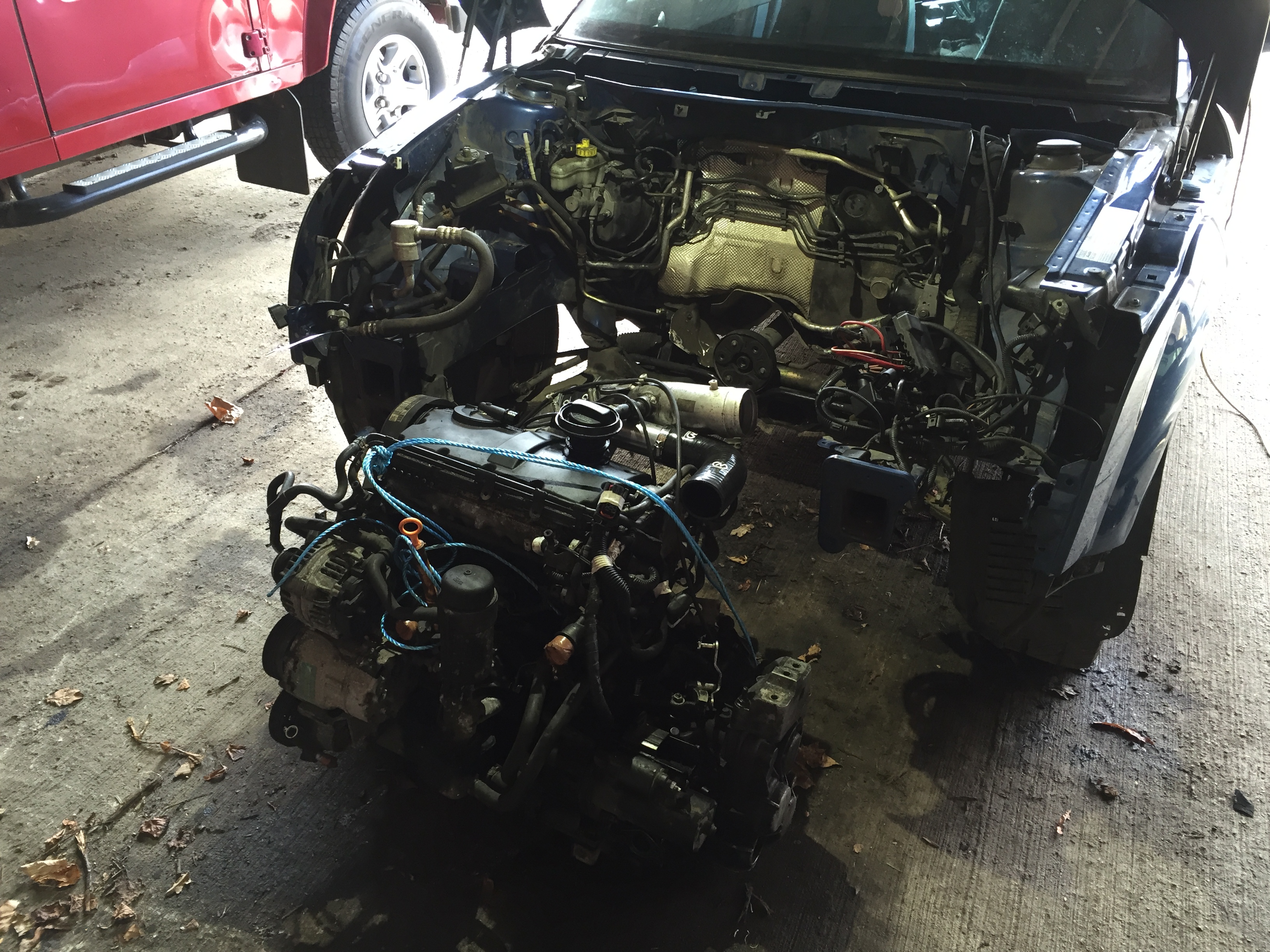

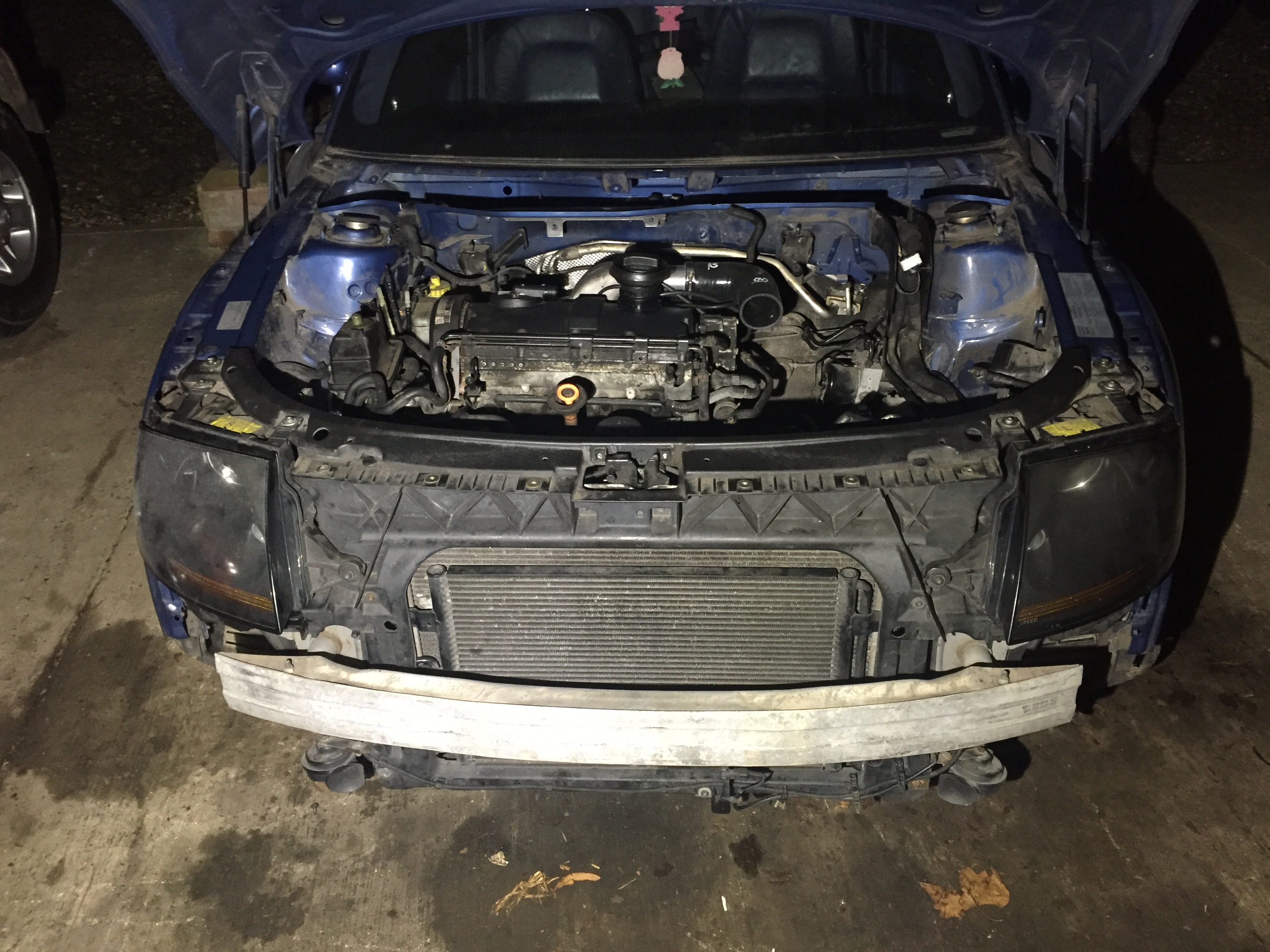

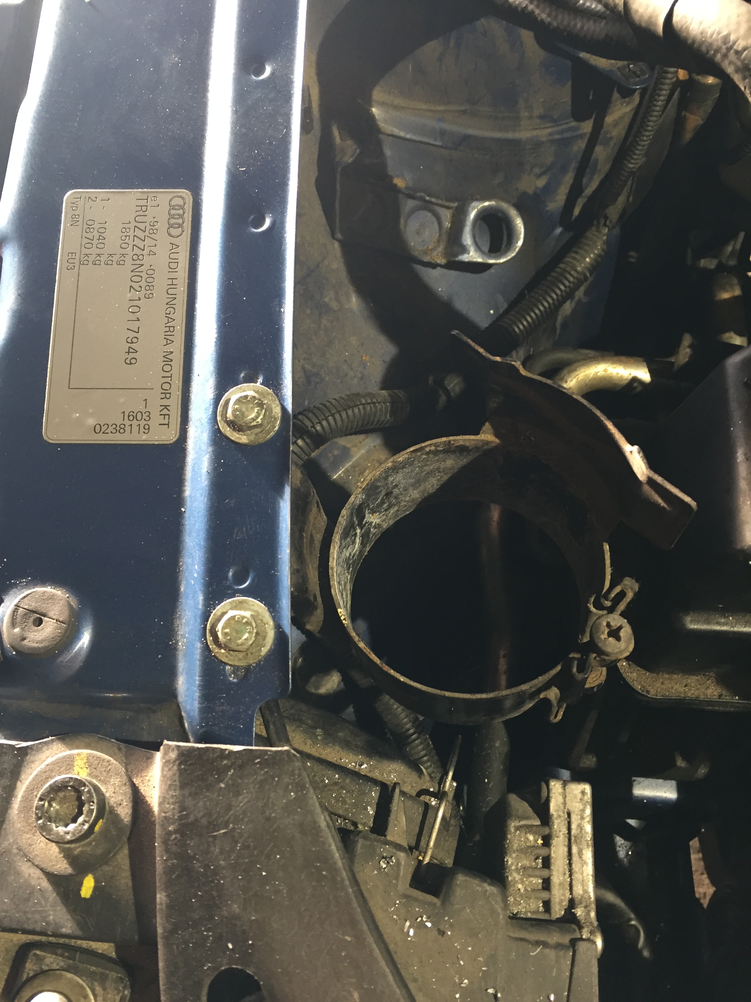

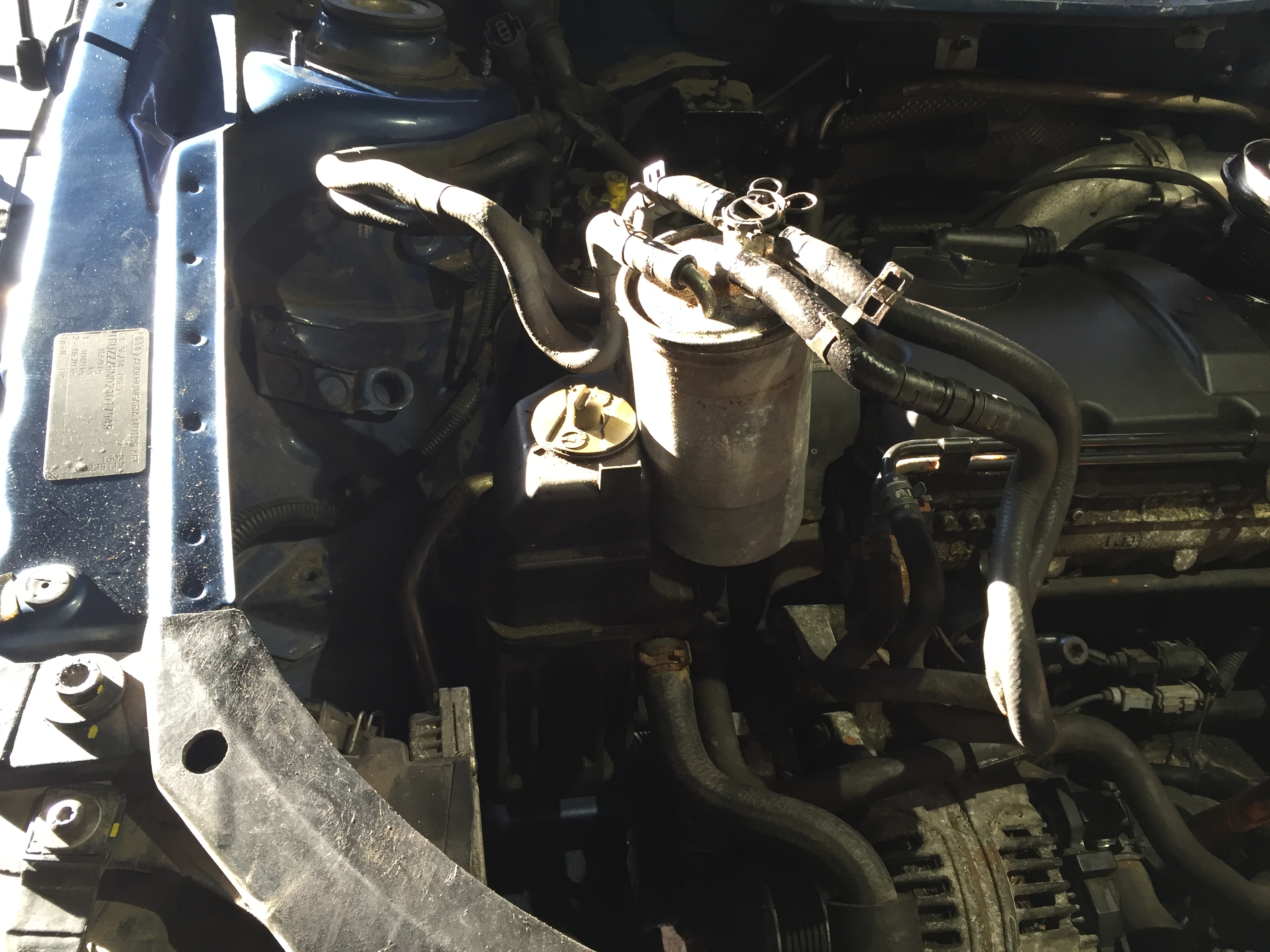

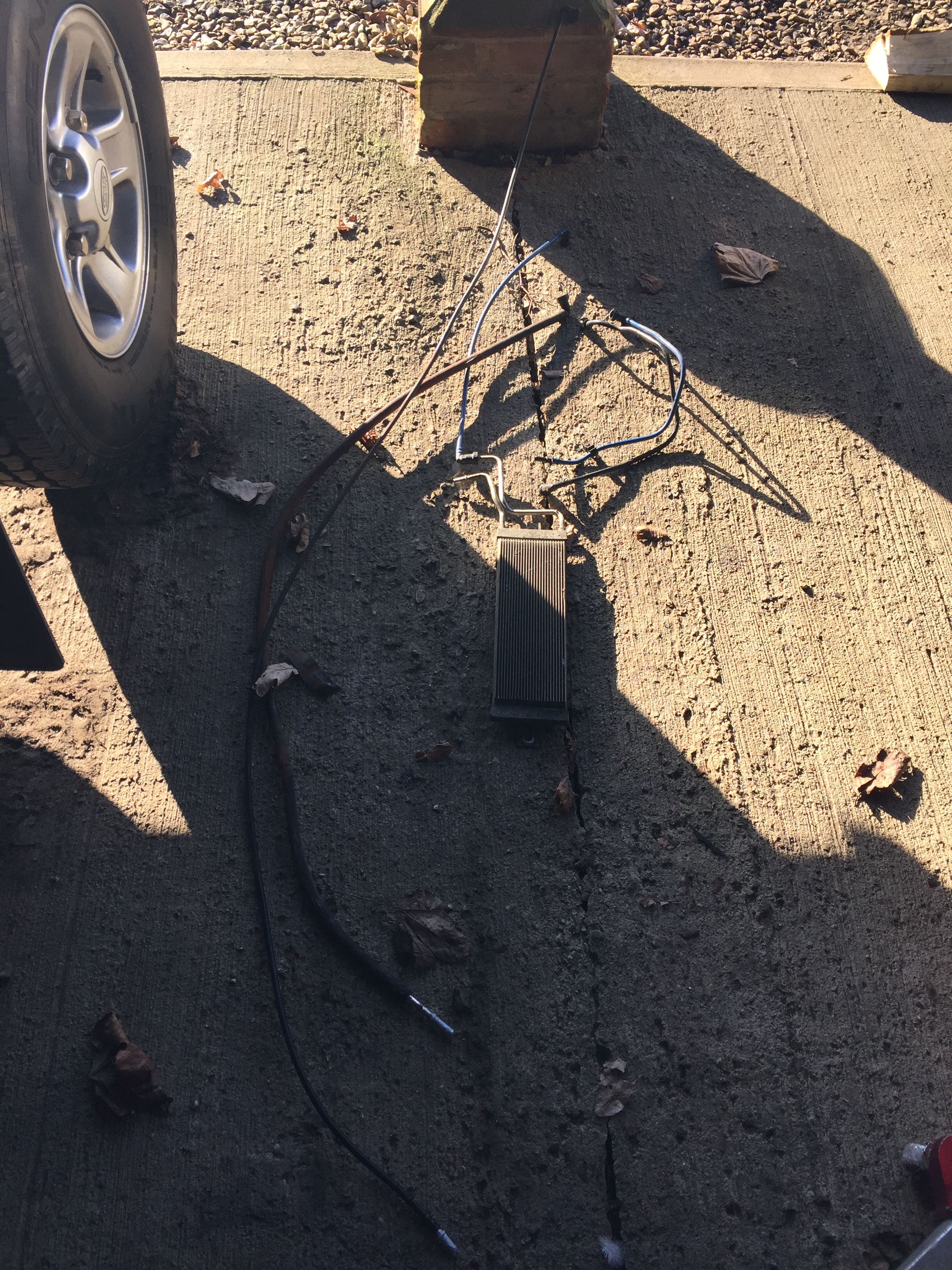

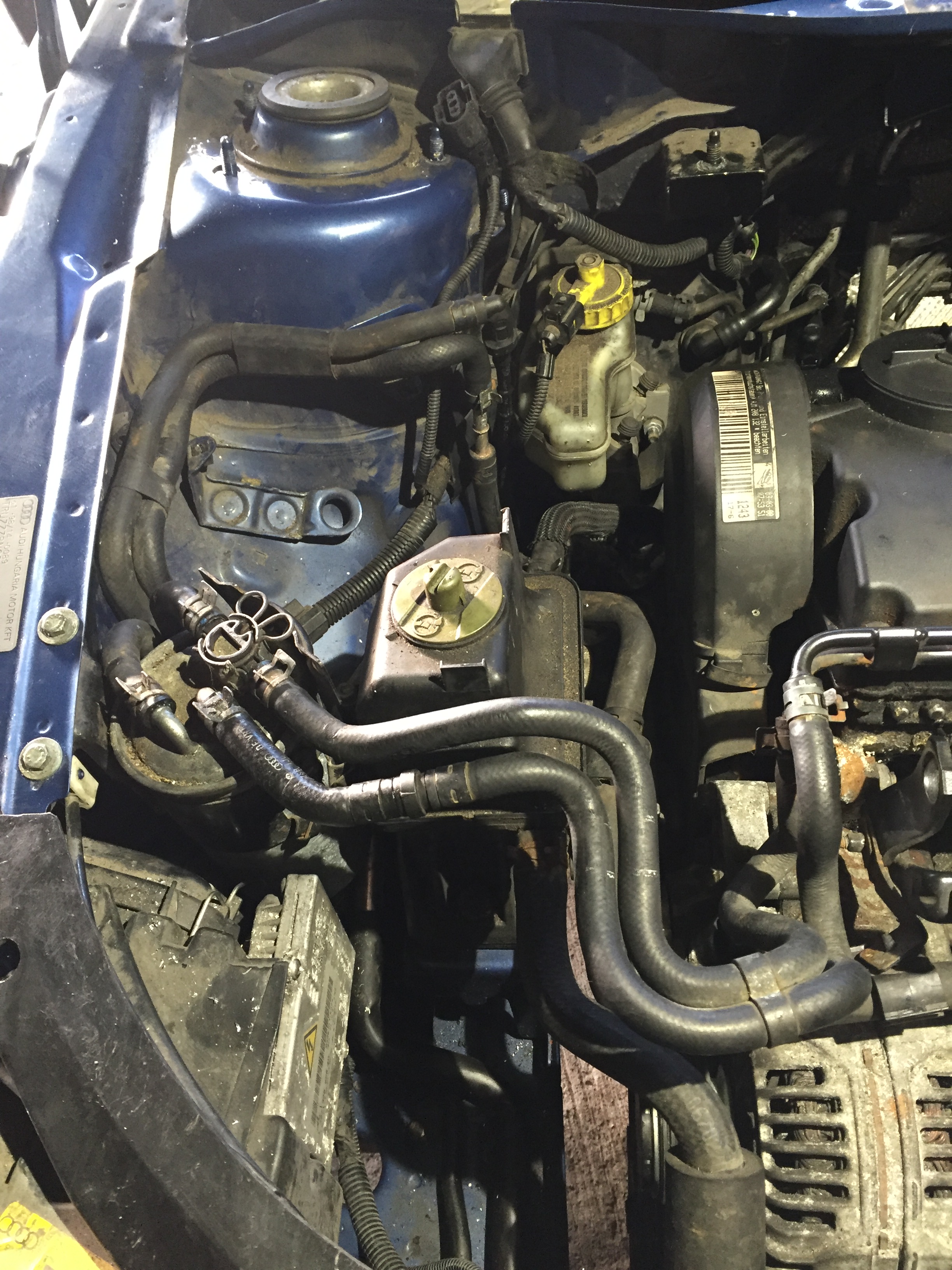

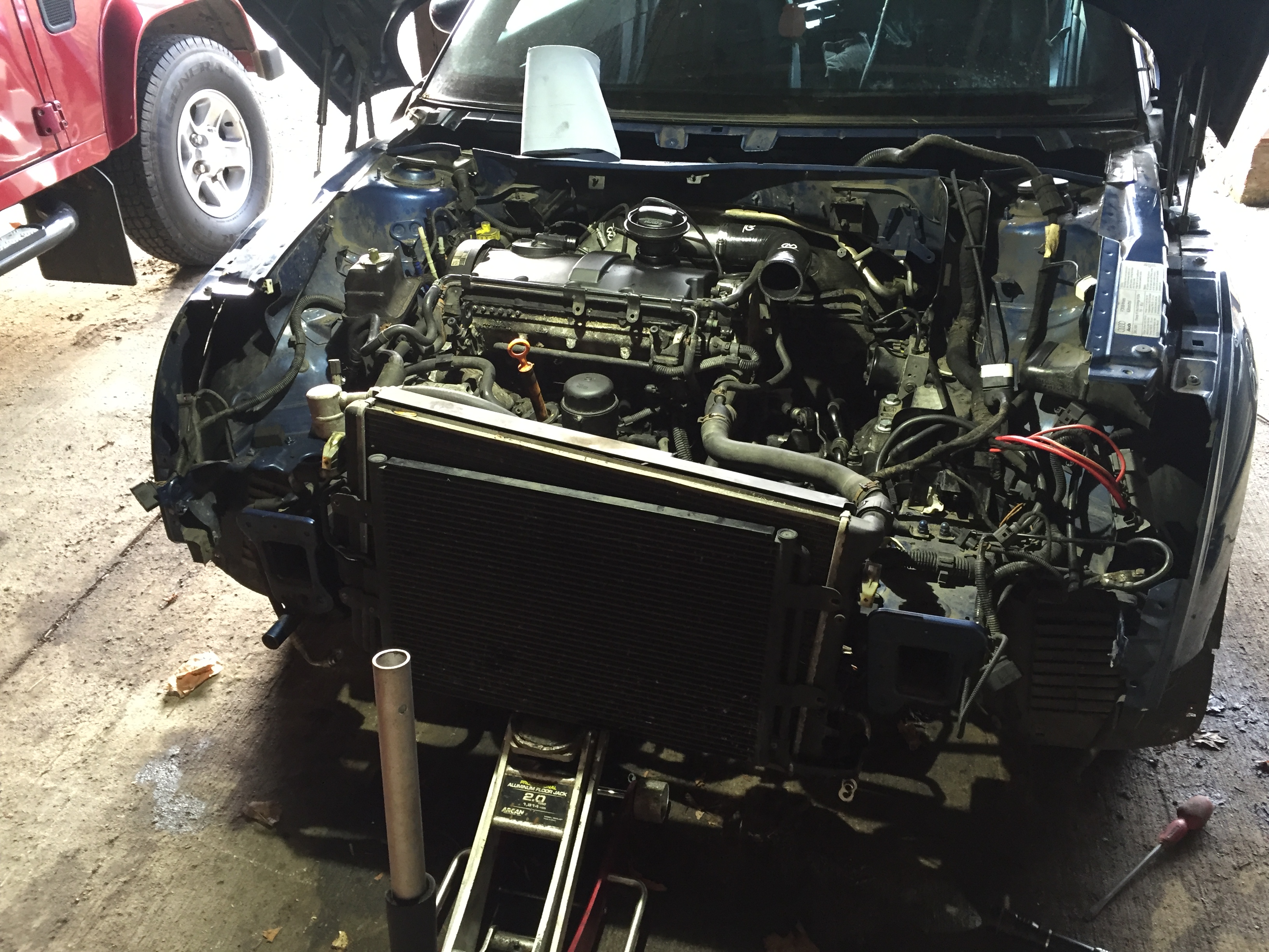

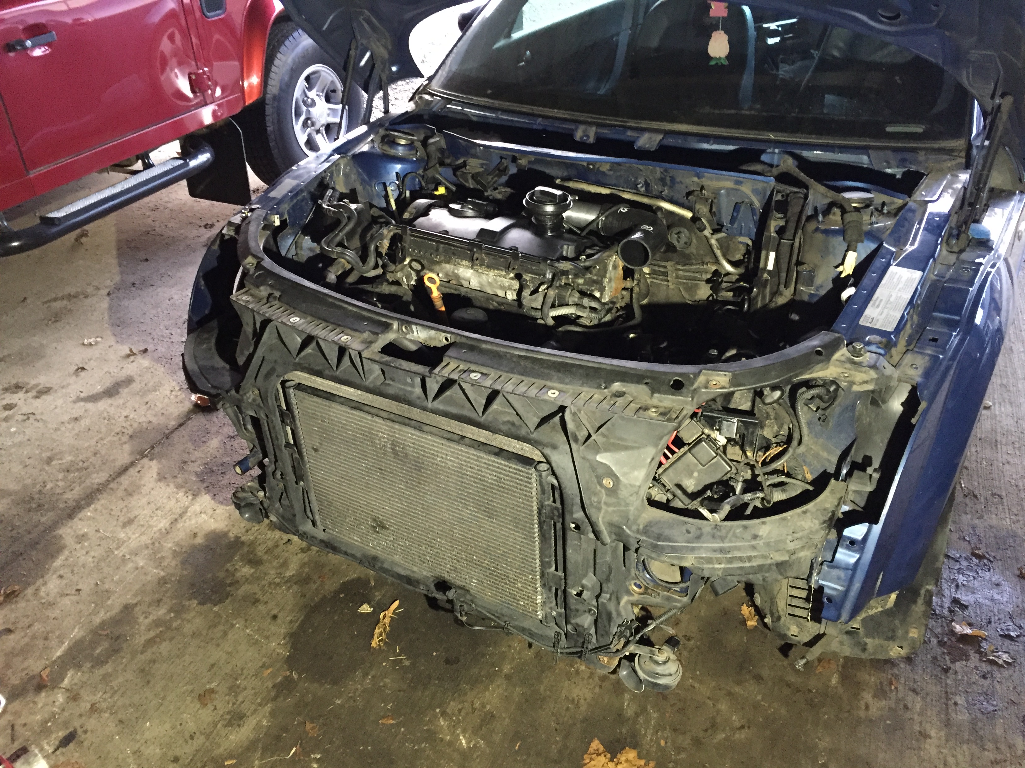

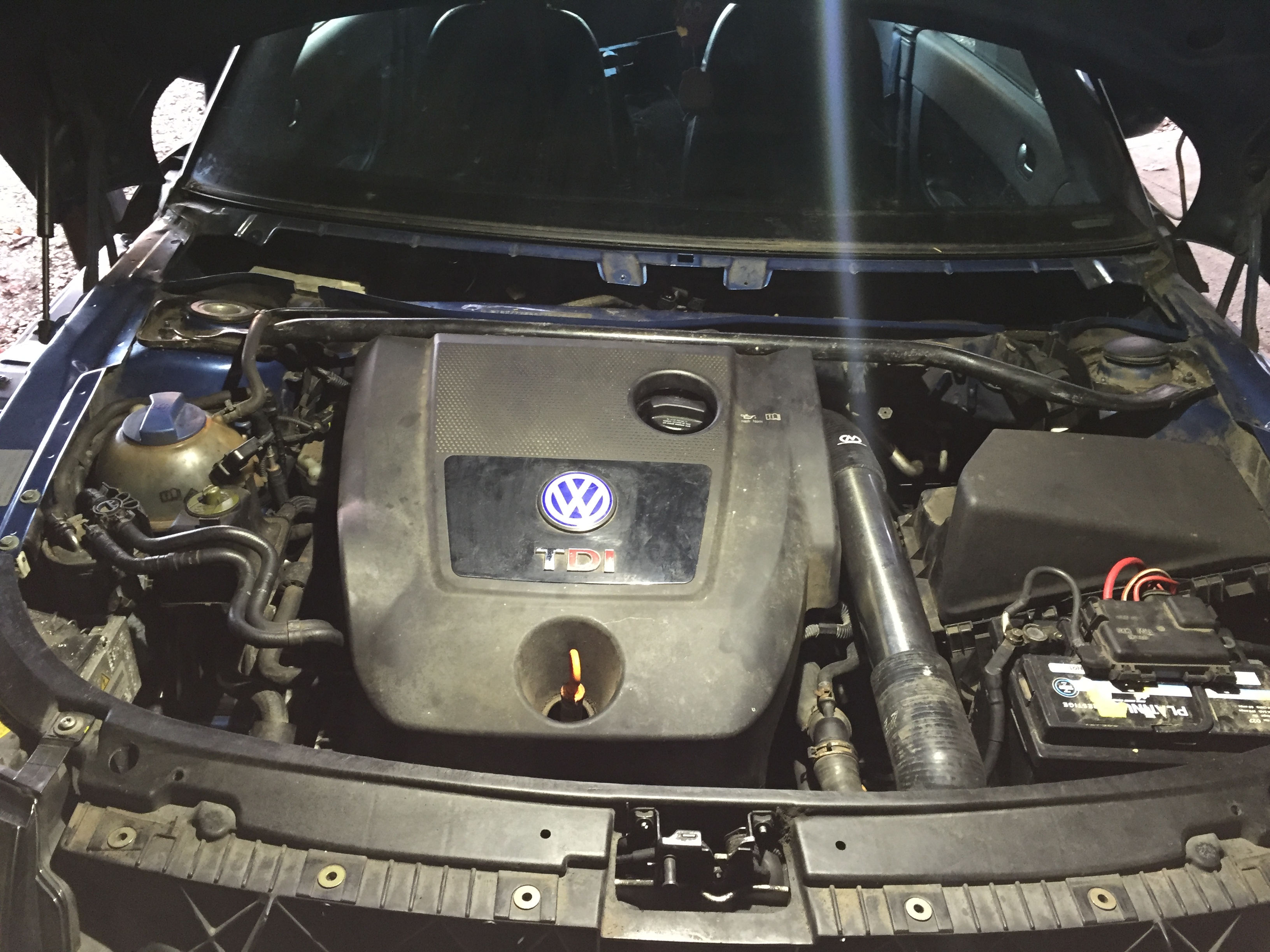

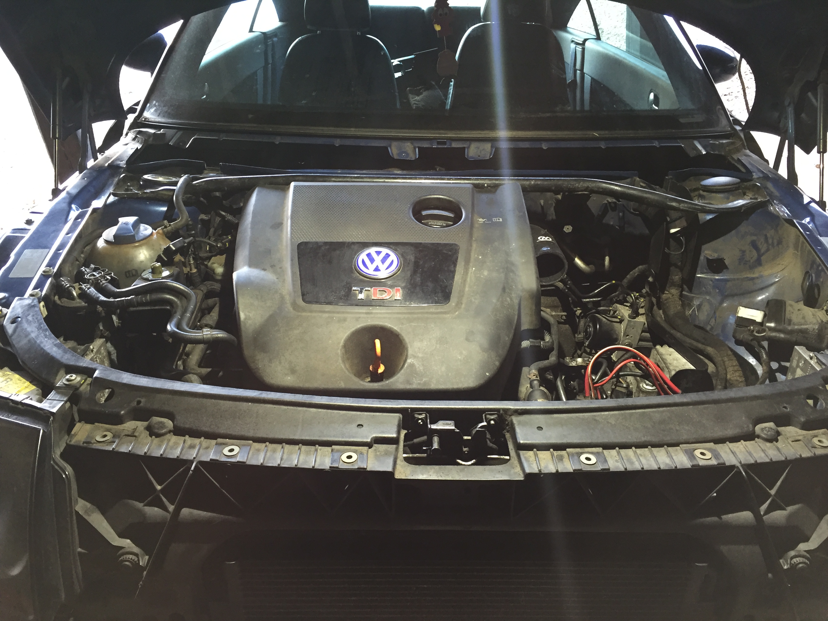

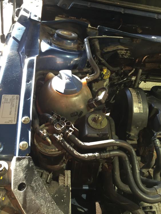

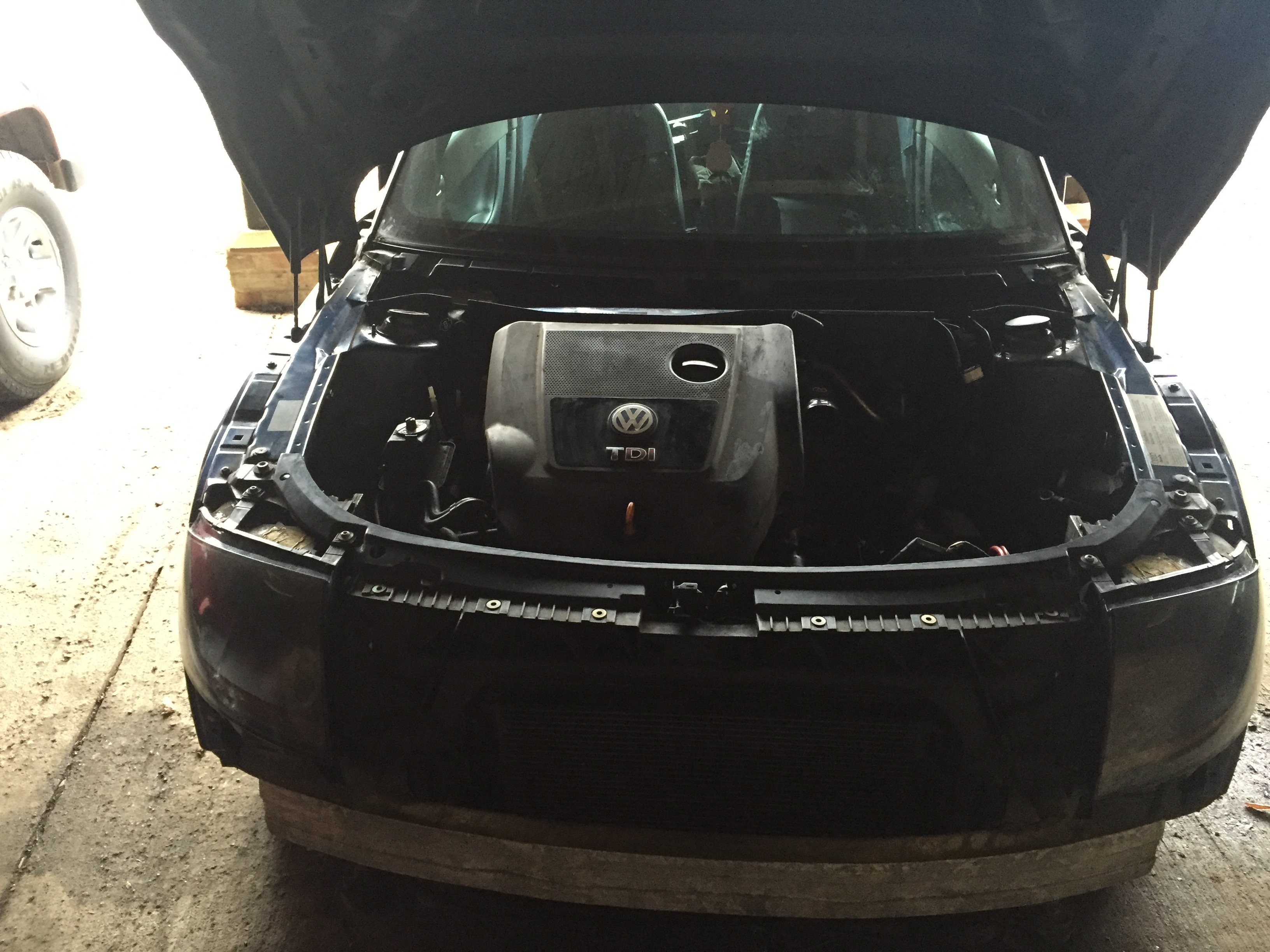

george_seamons Posted February 29, 2016 Report Share Posted February 29, 2016 Good day Saturday on the TTTdi. Had to go bedroom furniture shopping (yawn) on the Sunday, but still managed to sneak a couple of hours in afterwards. There are some big gaps in the timeline of pictures because I got so involved I forgot to take any haha! Started off with lining up the engine with all the bolted up new bits ready to go in the bay: Engine in and bolted up with new bolts and mounts etc. Propshaft connected to transfer box, clutch line plumbed in, coolant lines etc piped up, chucked the coolant radiator and a/c radiator on, ready to fit the front panel: Then mounted the front panel, which supports the coolant radiator and a/c radiator: Then chucked the crash bar and headlights on: Chucked the engine cover on to see how it looked: The petrol fuel lines were then pulled out, and the diesel ones put in place, along with the fuel cooler, which sits under the drivers seat on the bottom of the car: Next up was the diesel fuel filter housing and bracket. Obviously the TT doesn't have this as stock, so needed to be drilled and mounted, as per the Golf. Fuel filter pipe up and resting in position ready for the bracket: Marking the holes ready to be drilled: Holes drilled, bolts tightened, and bracket mounted: Fuel filter housing sitting in its new home, looking like stock: Then the coolant expansion bottle was fitted (this will be replaced with a new clean one once the engine is ready to be filled with coolant): I then fitted the stock strut brace in place, and offered the engine cover up to see what it looked like. Needed a bit of trimming to get it to sit properly (the Golf doesn't have a strut brace): Then couldn't help myself but to fit the airbox, battery and a mock intercooler charge pipe. Needs a good scrub, but really like how it looks neat and OEM, like it belongs there. Still need to put the battery box cover on, which should tidy that area: Getting closer now. Still got the wiring etc to finish altering inside, but getting the engine in and the front back on felt like a big hurdle was jumped, and made the project feel like it moved forwards a lot. 9 Quote Link to comment Share on other sites More sharing options...
Luke Rainbird Posted February 29, 2016 Report Share Posted February 29, 2016 Decent progress there mate, looks good. This is all still on stock turbo etc at the mo IIRC? Still planning to run it like that for a little while until funds are saved for a bigger blower or just going to try and do it in one hit? Quote Link to comment Share on other sites More sharing options...
george_seamons Posted February 29, 2016 Report Share Posted February 29, 2016 Just on a stock PD130 turbo for now, then give it a bit of ashake down to check its all pukka. Once its done a few thousand (and the owner has saved up the money), the new turbo, the diesel gearbox internals, and the new intake) can all go on when the engine is back out 1 Quote Link to comment Share on other sites More sharing options...

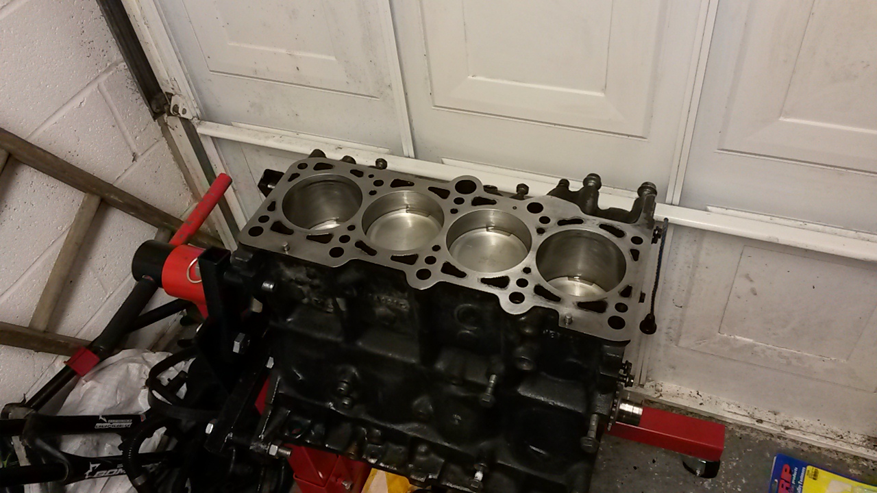

Luke Rainbird Posted February 29, 2016 Report Share Posted February 29, 2016 1 hour ago, SamKidney said: That's a really anal reason to fail a car. For starters the exhaust hangars are generally designed to adequately support the exhaust if one or more hangars fail. If one was insecure id have argued against that. Failing it on wiring secured by a cable tie is also pretty rediculous. It's on the database as having failed now so not really much I can do. Will Make it incredibly clear that the guy's a fanny when I pick it up though. In other news: Not torqued up yet etc but connecting rods now connect things. 1 Quote Link to comment Share on other sites More sharing options...
