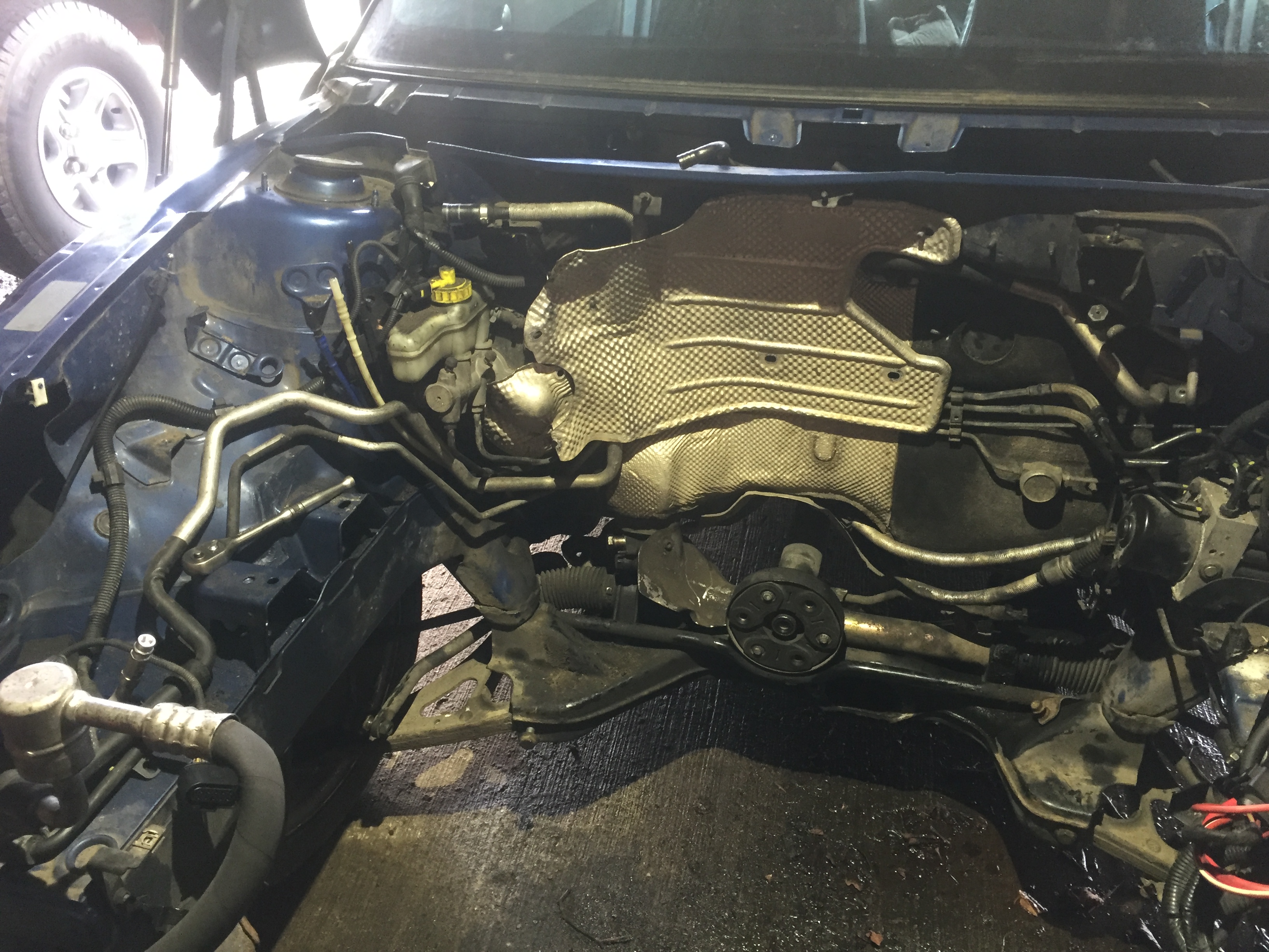

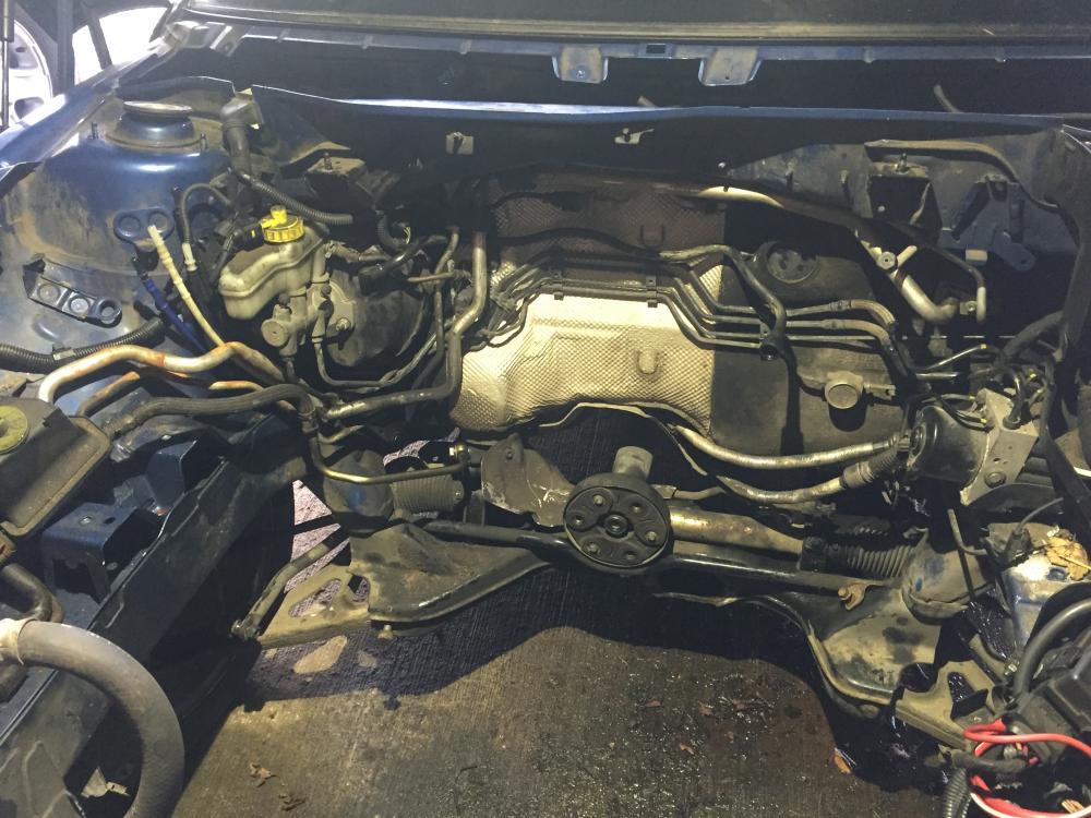

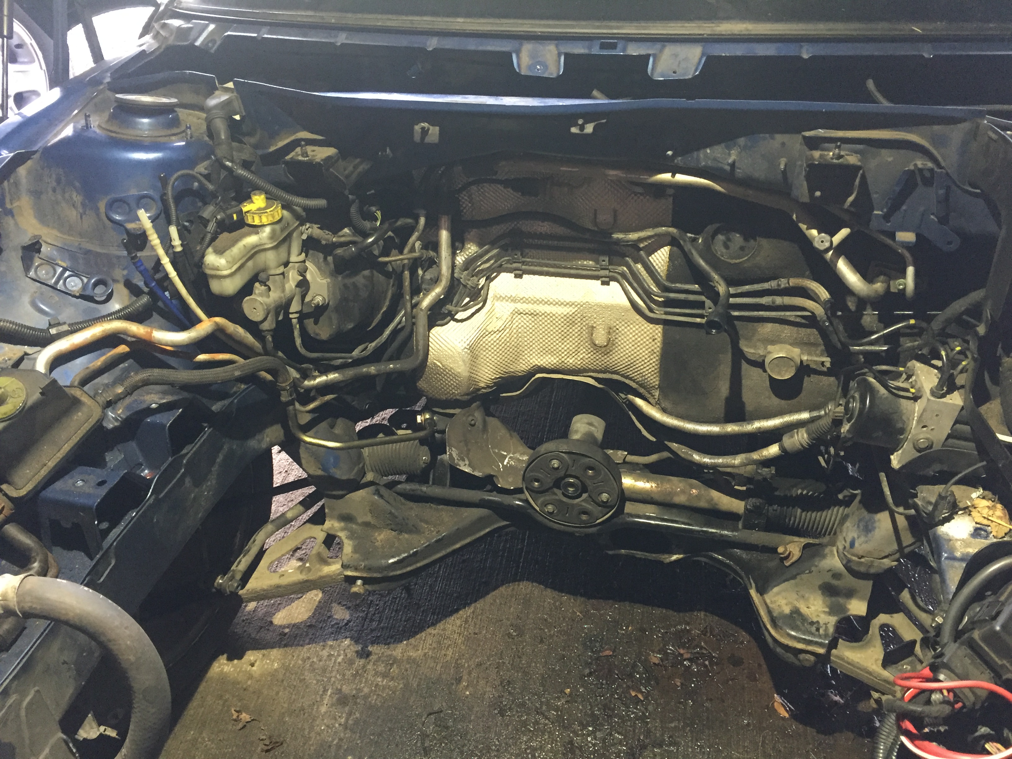

Managed a little bit of TT work between private jobs this weekend.
After test fitting the engine, I found the stock TT heatshielding was going to interfere with the turbo coldside and intake pipe.
The turbo position on the 1.8t points the turbo hotside to the driver side, hence all the heatshielding. The tdi turbo points the opposite way, with the hotside to the passenger side, so the heatshielding isn't needed. This is the before picture:

And this is the after. The eagl-eyed amonst you will also notice the power steering line on the driver side has also been fitted, the brake servo vacuum pipe fitted, and the A/C lines swapped (see below):
IMG_1189.thumb.JPG.4a437face095165e76076

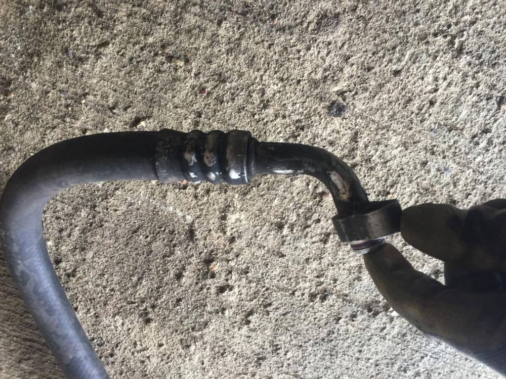

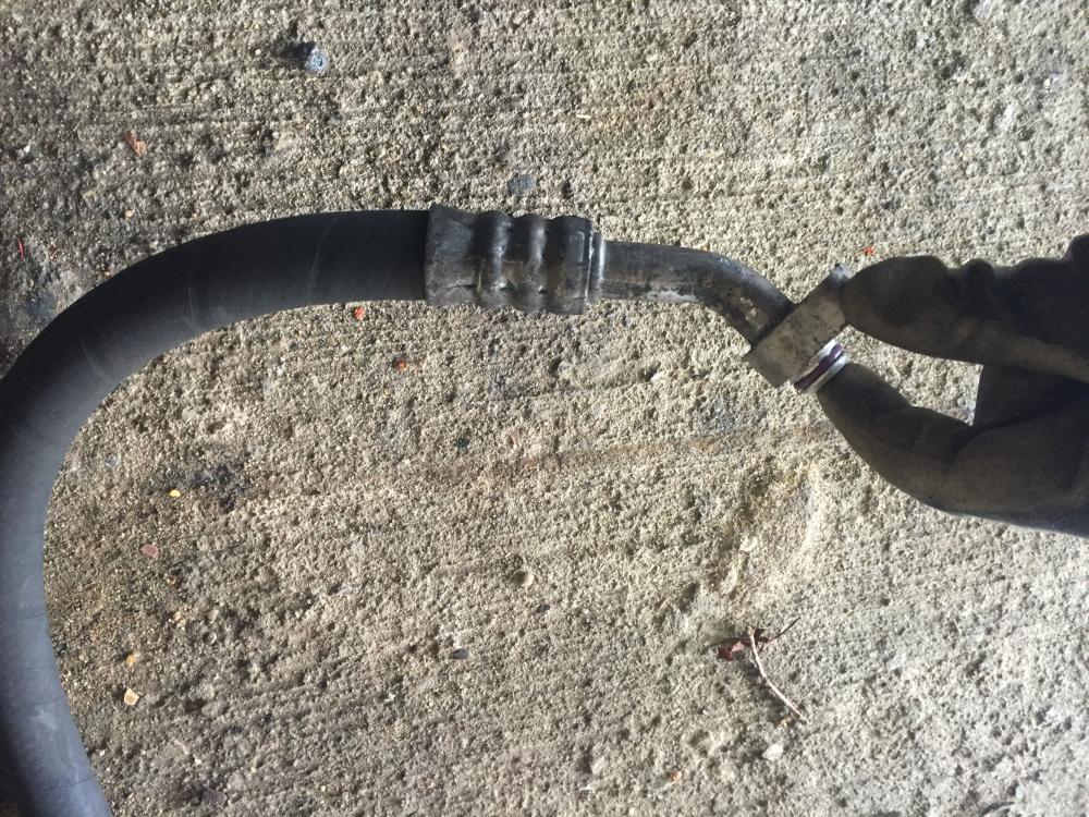

The petrol and tdi A/c lines are very slightly different at the ends. This meant the original TT lines don't fit the tdi engine because the angle of the end stops it bolting up. This meant the entire A/C line setup needed to be swapped over.
Tdi A/C pipe connection to engine:
IMG_1178.thumb.JPG.2ab88cfb1dd417243ed56
TT A/C pipe connection to engine:
IMG_1179.thumb.JPG.46a89aff3f69a3a61661c
As you can see, not much of a difference, but it was enough to stop it bolting up.

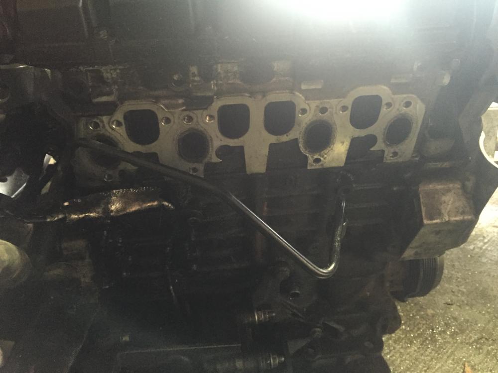

Whipped the old dead turbo off, and gave the gasket faces a clean up:
IMG_1190.thumb.JPG.f32ee7df429be4e402b22
