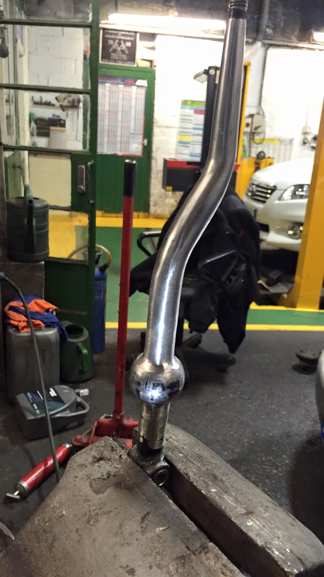

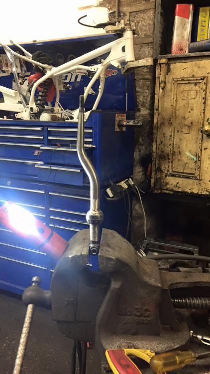

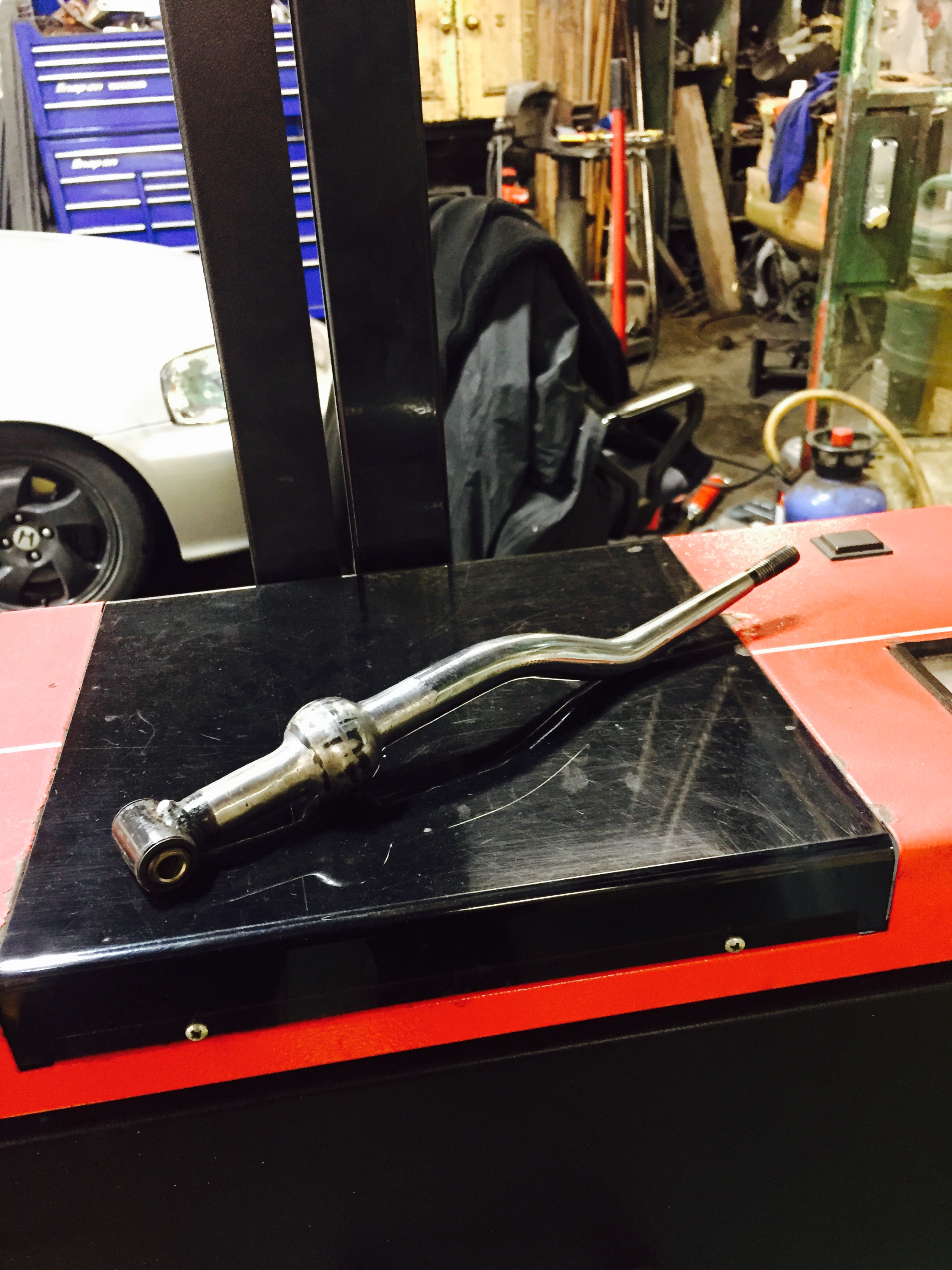

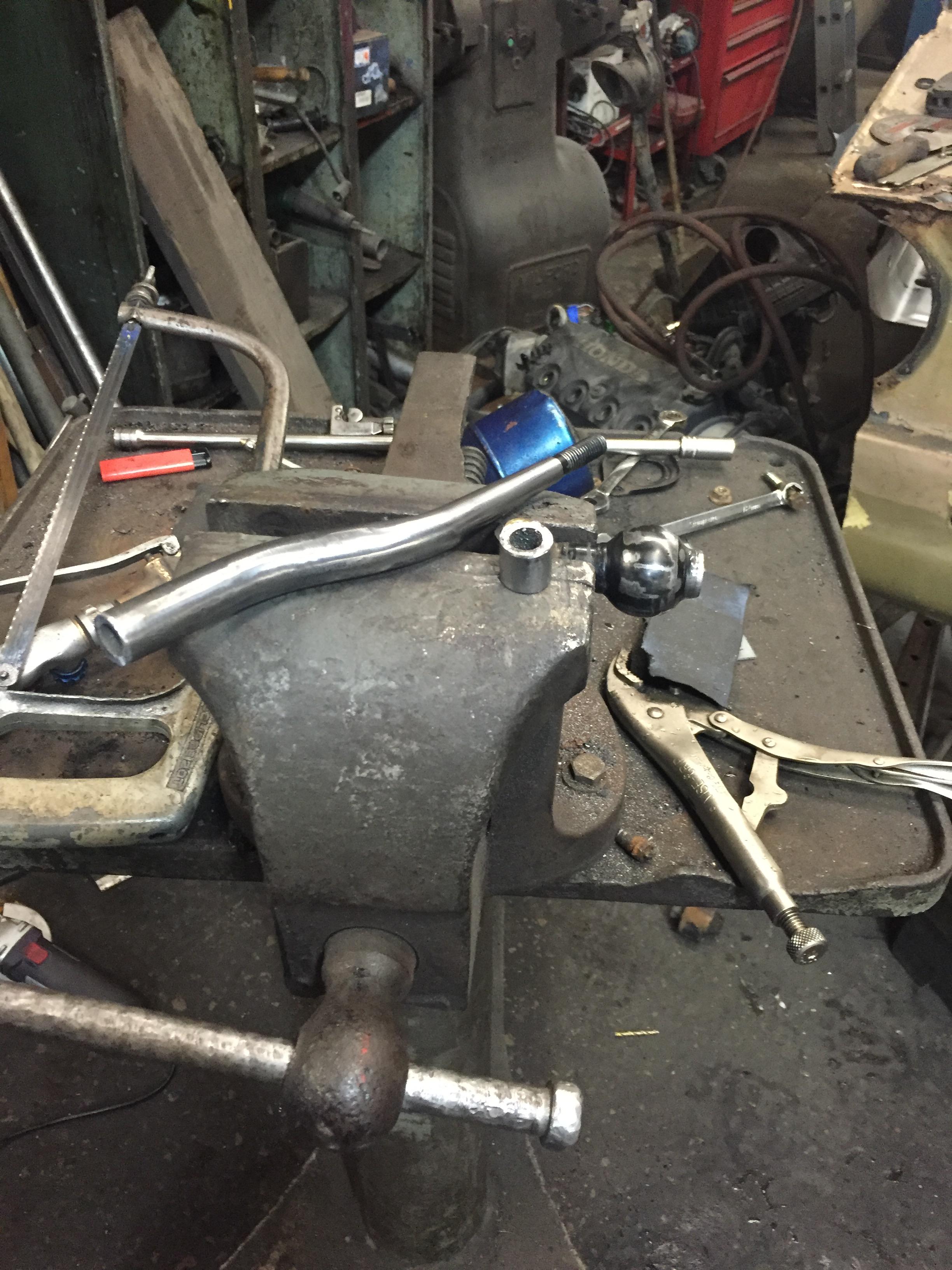

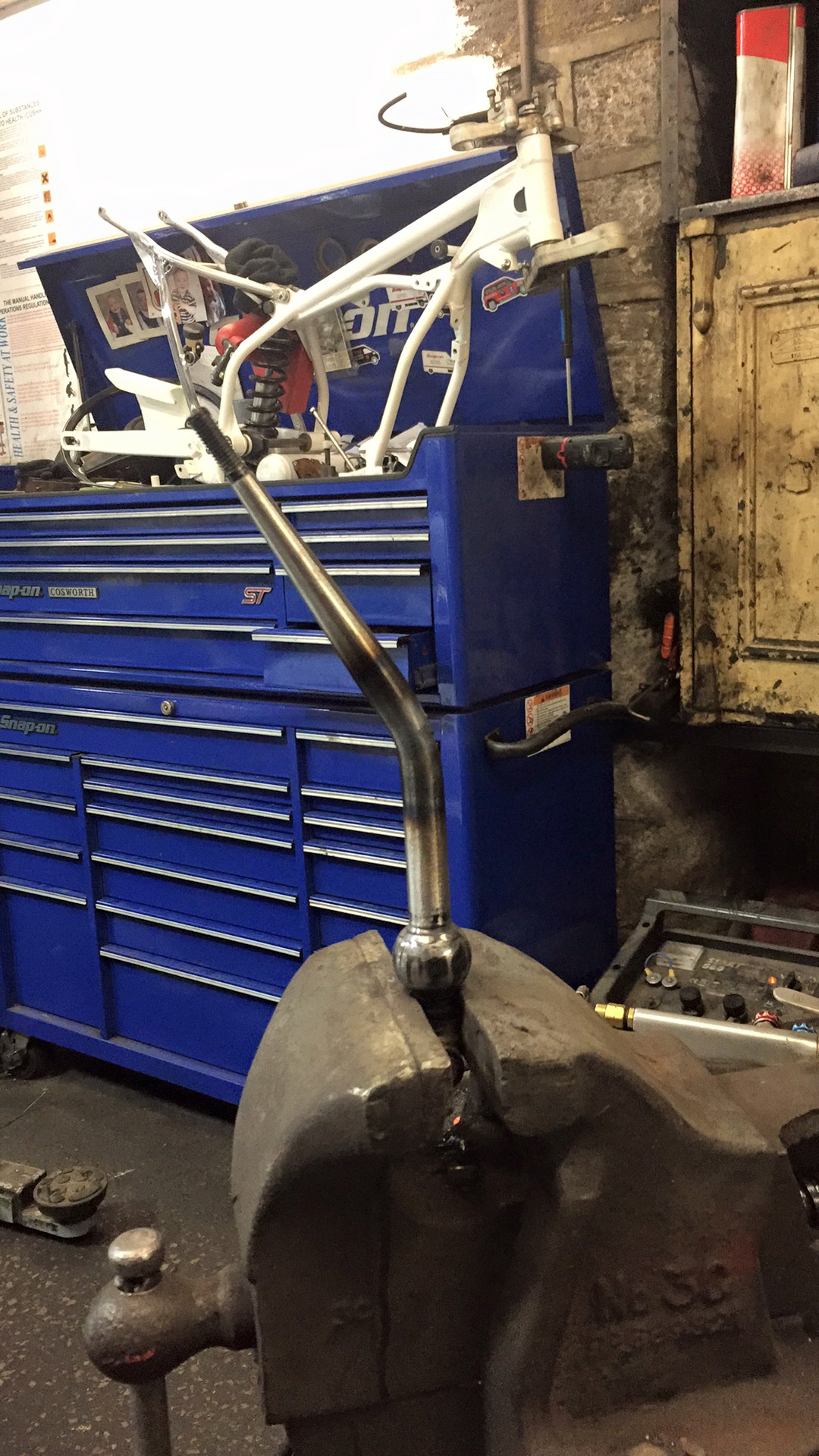

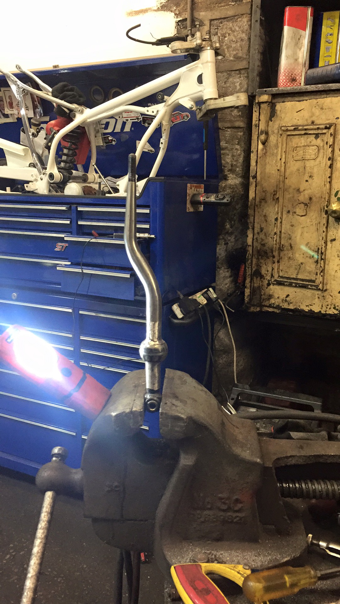

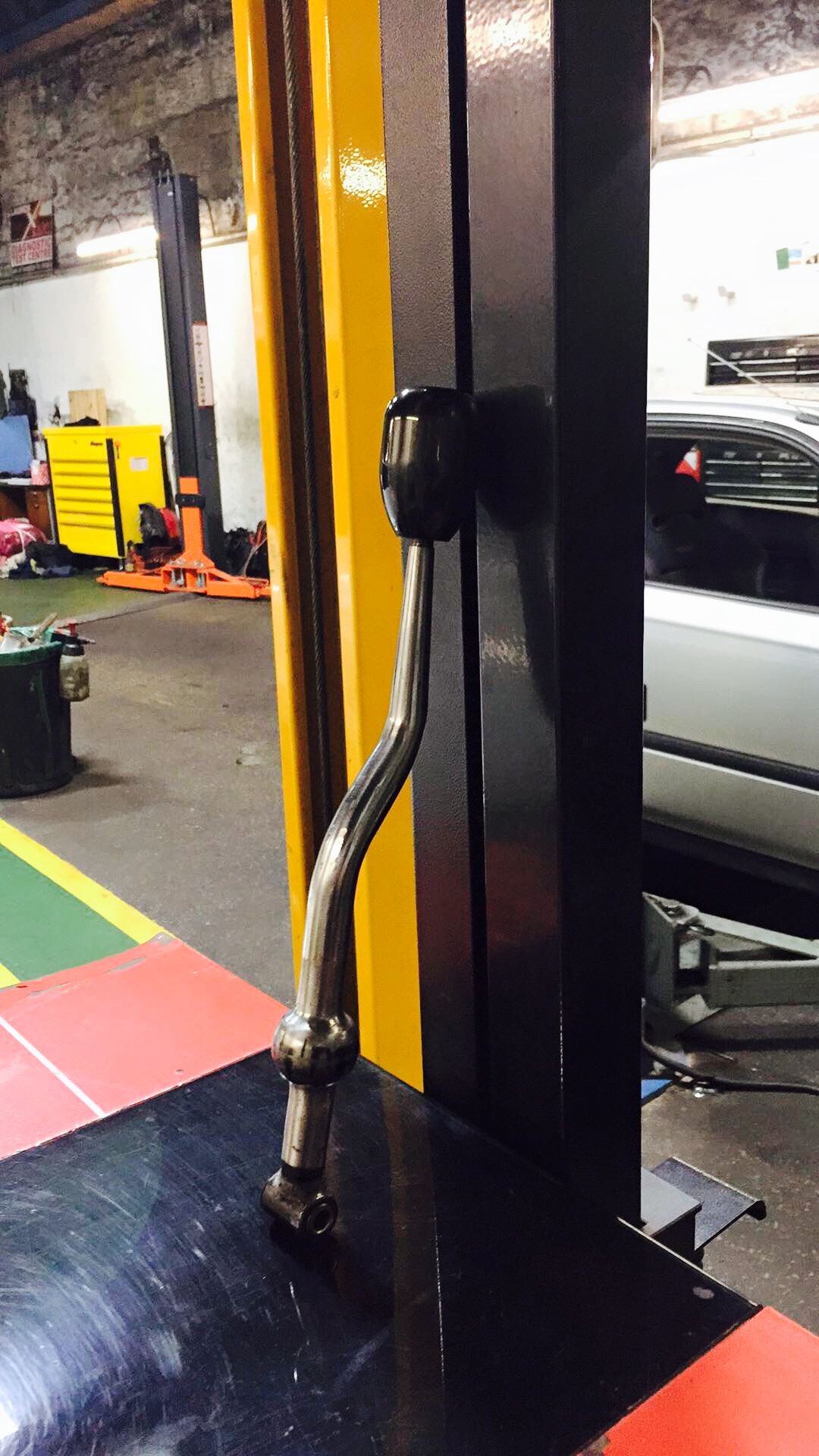

SamKidney Posted February 20, 2016 Report Share Posted February 20, 2016 (edited) On 2/20/2016 at 7:23 PM, Adam@TartyBikes said: You didn't change it while the 'box was out? Lesson learned for next time... Expand It's a new clutch and bearing, fit when I popped the engine in. All sorted! Turns out the clutch cover I have is for a b18 and was sitting too proud and just caught the bell housing. Box back off and a tickle with the flap wheel on the offending area and it's sorted. My k tuned shifter has gone tits up too, so I've spent the evening knocking this up. Improved the feel massively, and the new gearbox is a mile better than the old one! Edited February 20, 2016 by SamKidney 3 Quote Link to comment Share on other sites More sharing options...
CurtisRider Posted February 21, 2016 Report Share Posted February 21, 2016 Nice one, that looks good! I quickly sprayed the centre of one wheel yesterday, then forgot to put the wheels back indoors overnight and they got a little wet which has ruined the finish. Much to Jolfas delight I am now bored of prepping and painting so I'll just run them over with some 'black' hammer finish paint (more like gunmetal) and be done with it, i'm 3D printing some centre caps currently, this should make them look a little more finished Quote Link to comment Share on other sites More sharing options...
