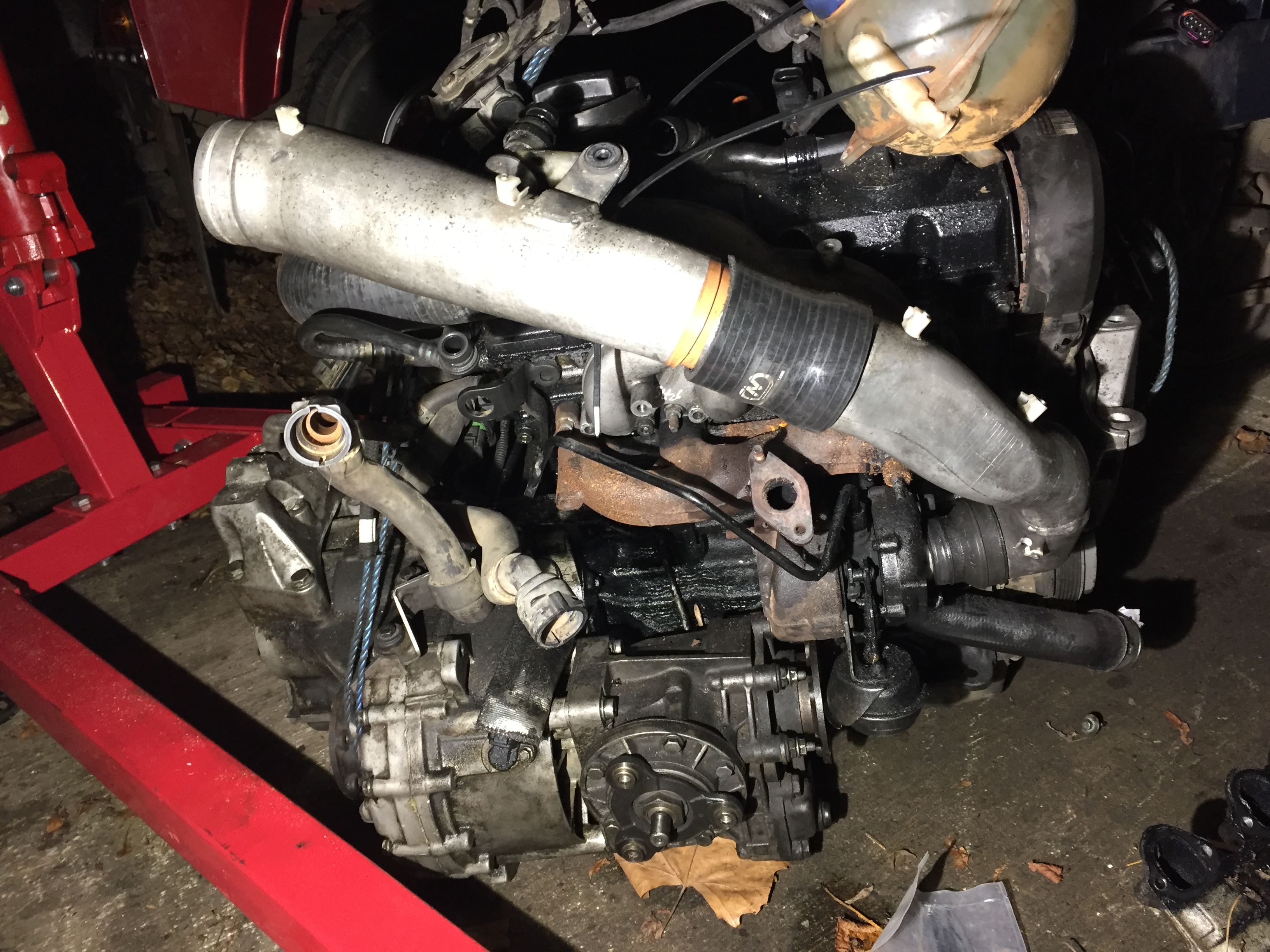

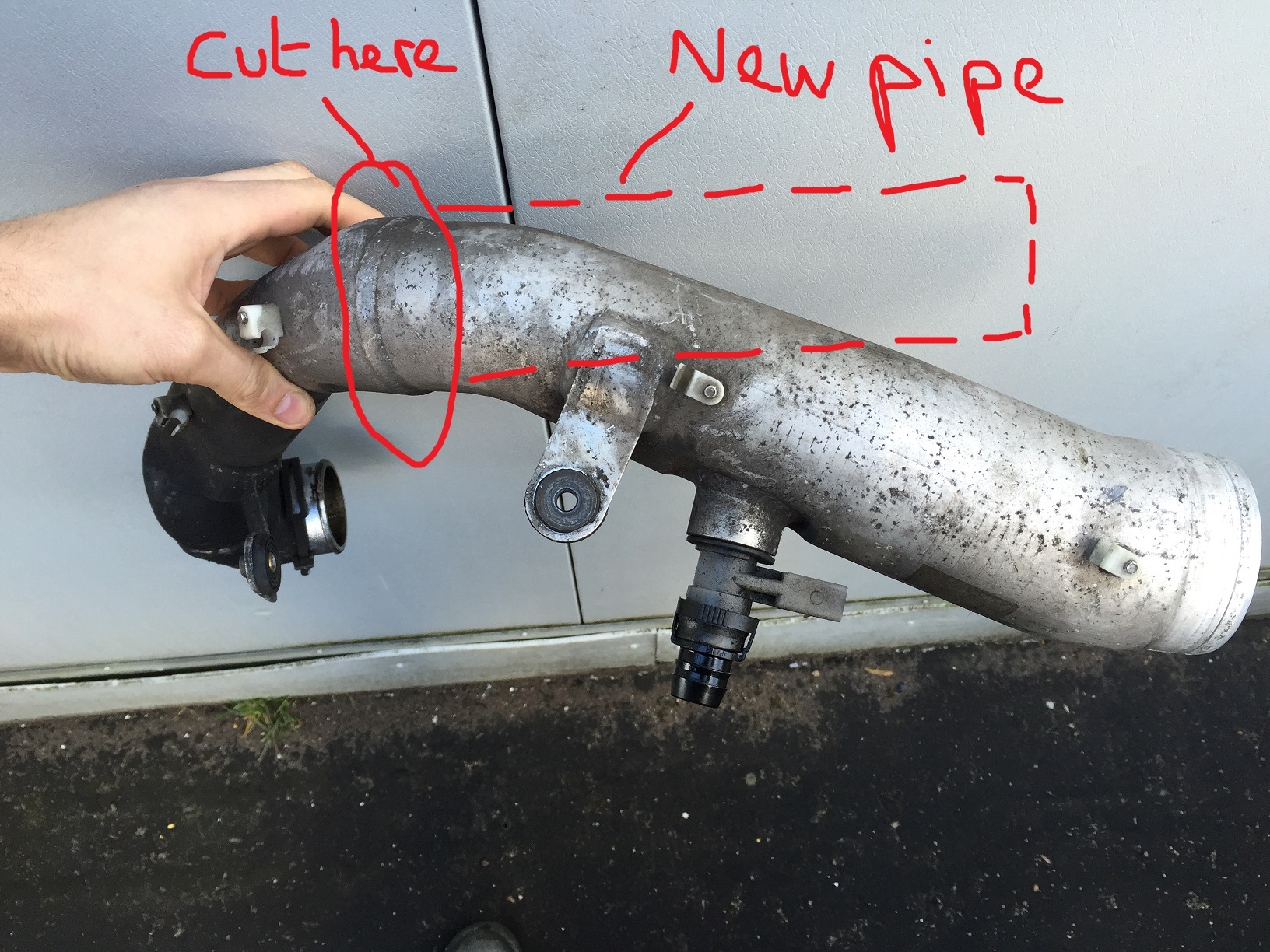

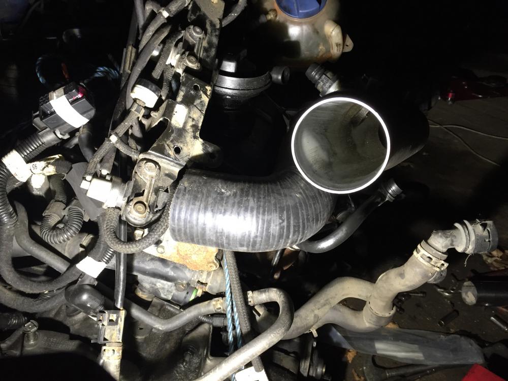

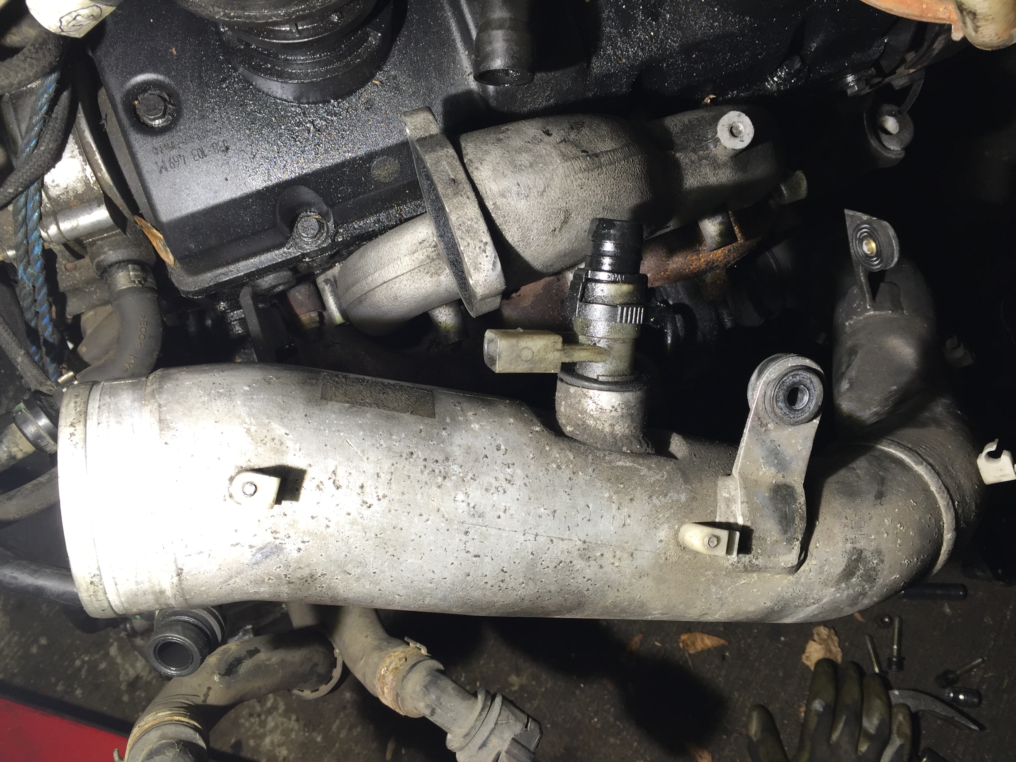

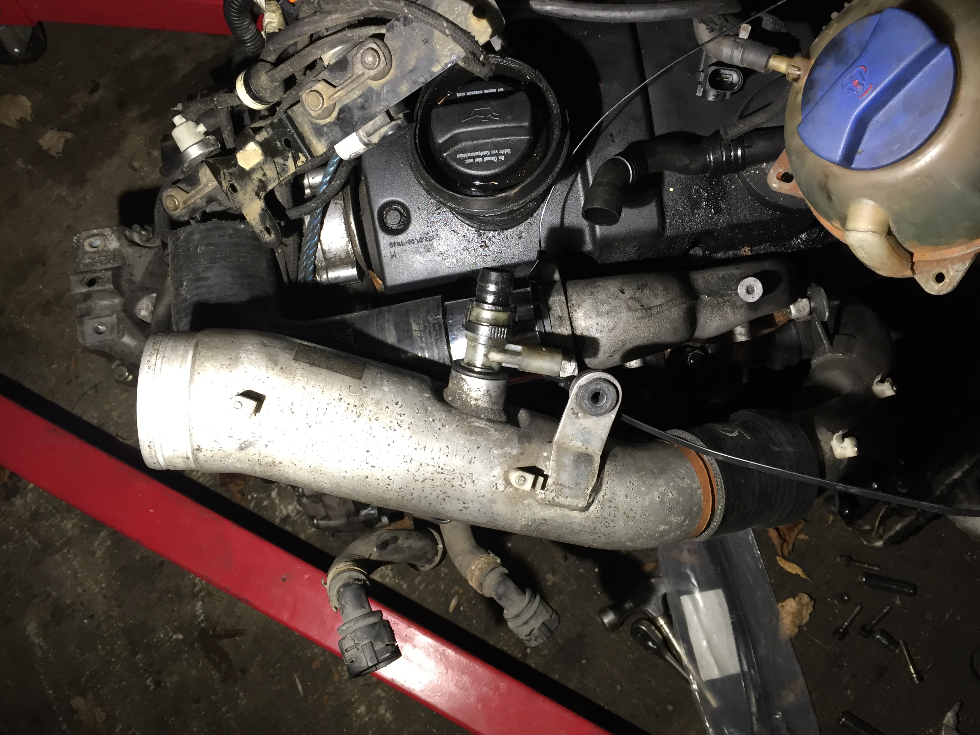

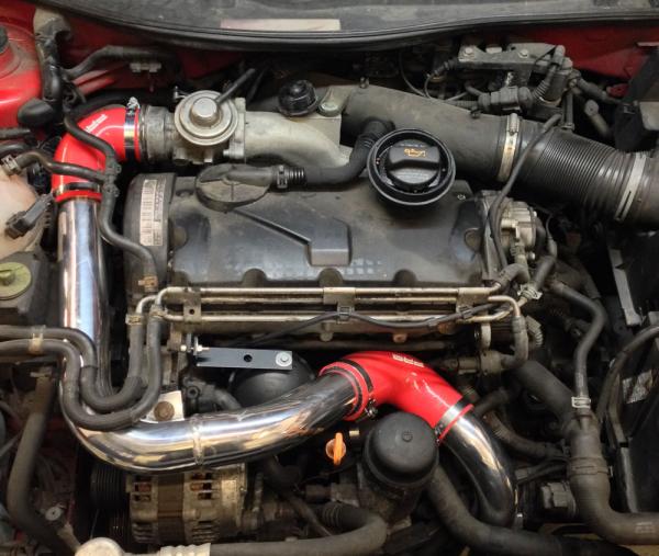

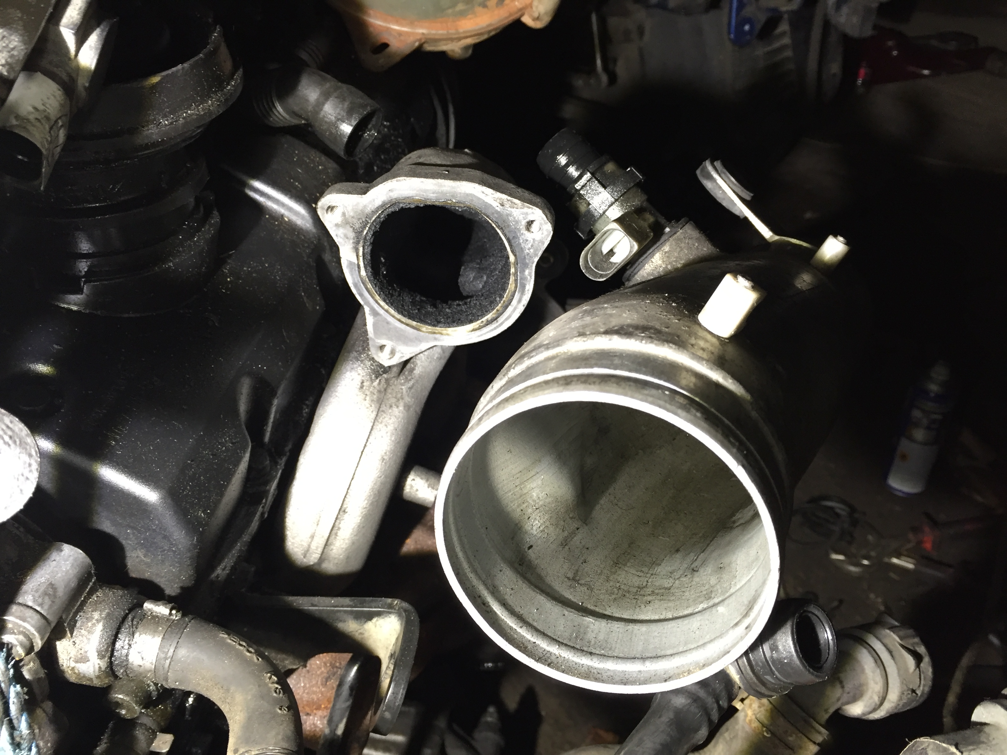

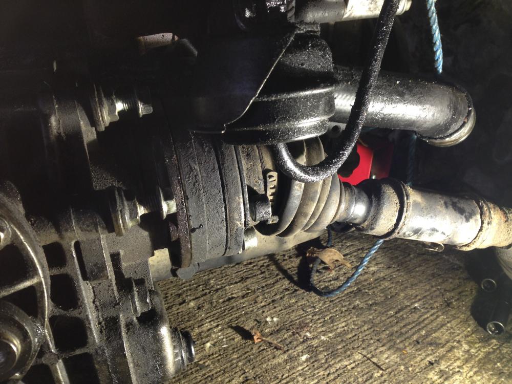

george_seamons Posted February 17, 2016 Report Share Posted February 17, 2016 A little update, not much to show really though. I'm at the mocking up stage for the turbo/inlet/turbo intake. The standard PD130 setup looks like this, with the turbo intake pipe pointing to the right, and the inlet manifold pointing to the left. This then runs down the engine and into the side mounted intercooler in the drivers side of the front bumper, then back into the turbo cold side outlet via the wheel arch (ignore the arrow, its just a random picture stolen off google): Looks ok-ish as stock, but the pipework is a bit restrictive, and the side mount intercooler is rubbish. When the majority of people fit front mount intercoolers to the diesel engines, you end up with a mass of pipework in the engine bay, which looks awful: The plan is to use a Passat PD130 inlet manifold, which faces to the right rather than the left, which should create a much better pipework route, which should look something like this: So, I ordered the inlet manifold, and the alloy turbo intake pipe (the original one for the PD115 engine which the Golf originally came with). Then set about remove the old setup, and fitting the new. Bolted the inlet manifold on, all matches up a treat. Went to bolt the turbo intake pipe on...bugger...it fouls the intake. The PCV take off hits the inlet, and the way the end of the pipe curls round means it will hit the pipe that attaches to the inlet manifold : My plan was to chop the pipe up at the welded join, and adjust it there, like so: So I set about doing that. It turns out with a silicone joiner, the pipe can be twisted and extended by about 2 inches to be in the correct position (shown here with the pipe off the inlet manifold temporarily cable tied in position). Just need to extend the pipework for the PCV valve between the rocker cover in turbo intake pipe: Also bolted up the gearbox to check the clearance between the turbo and the transfer box, its reeeeeally close: Quote Link to comment Share on other sites More sharing options...
