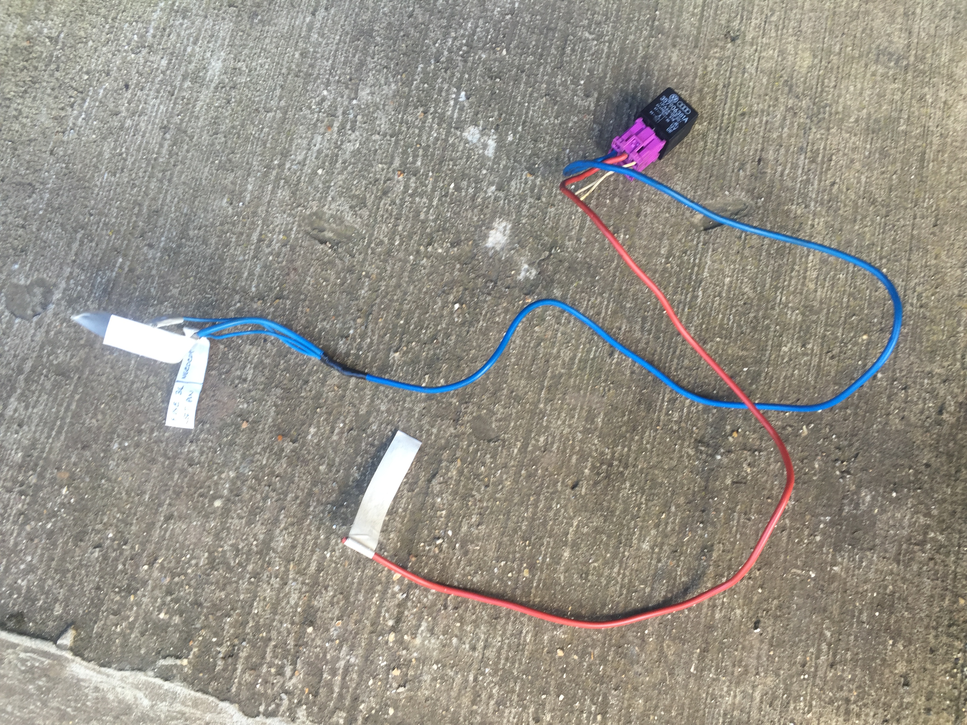

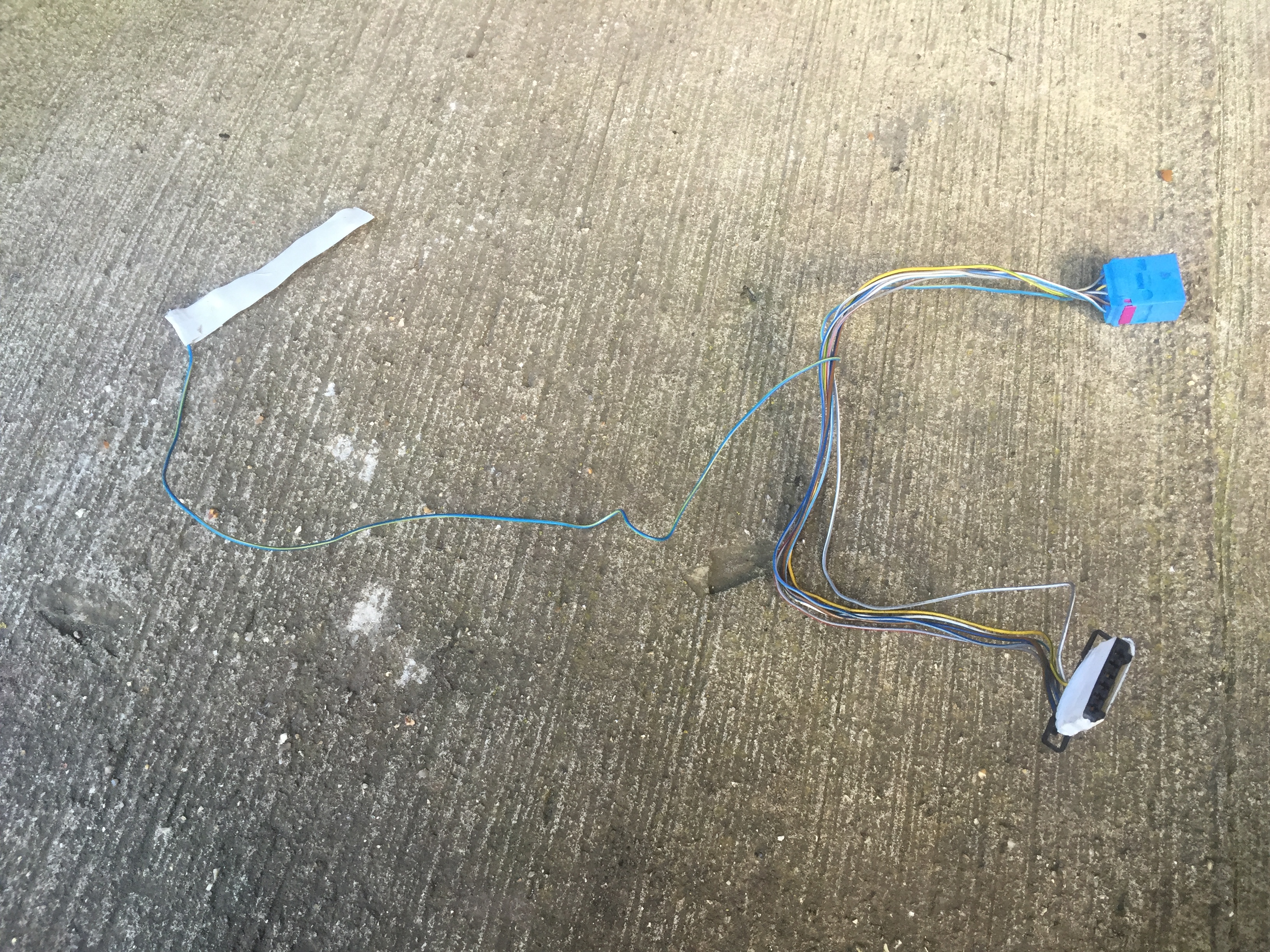

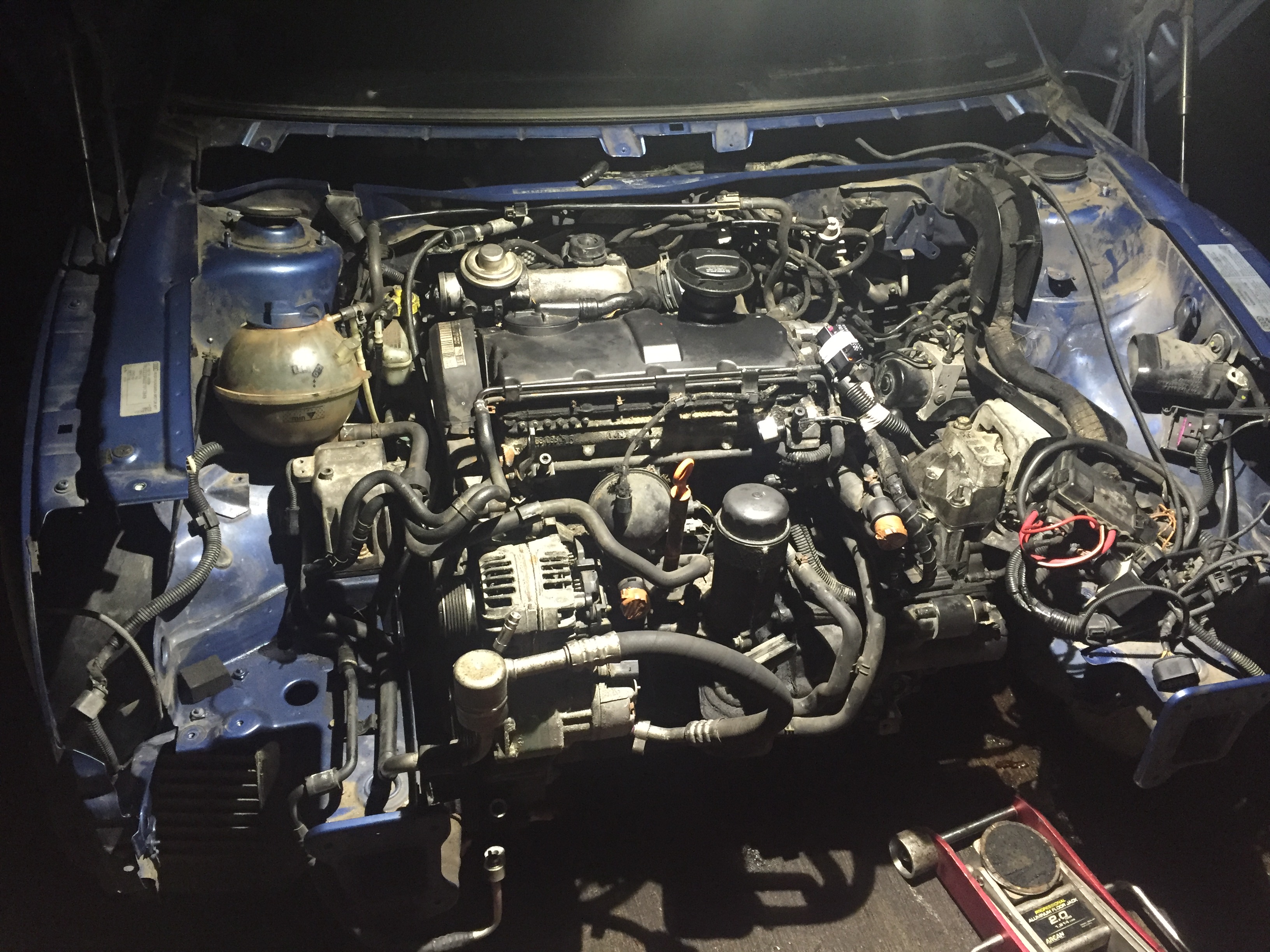

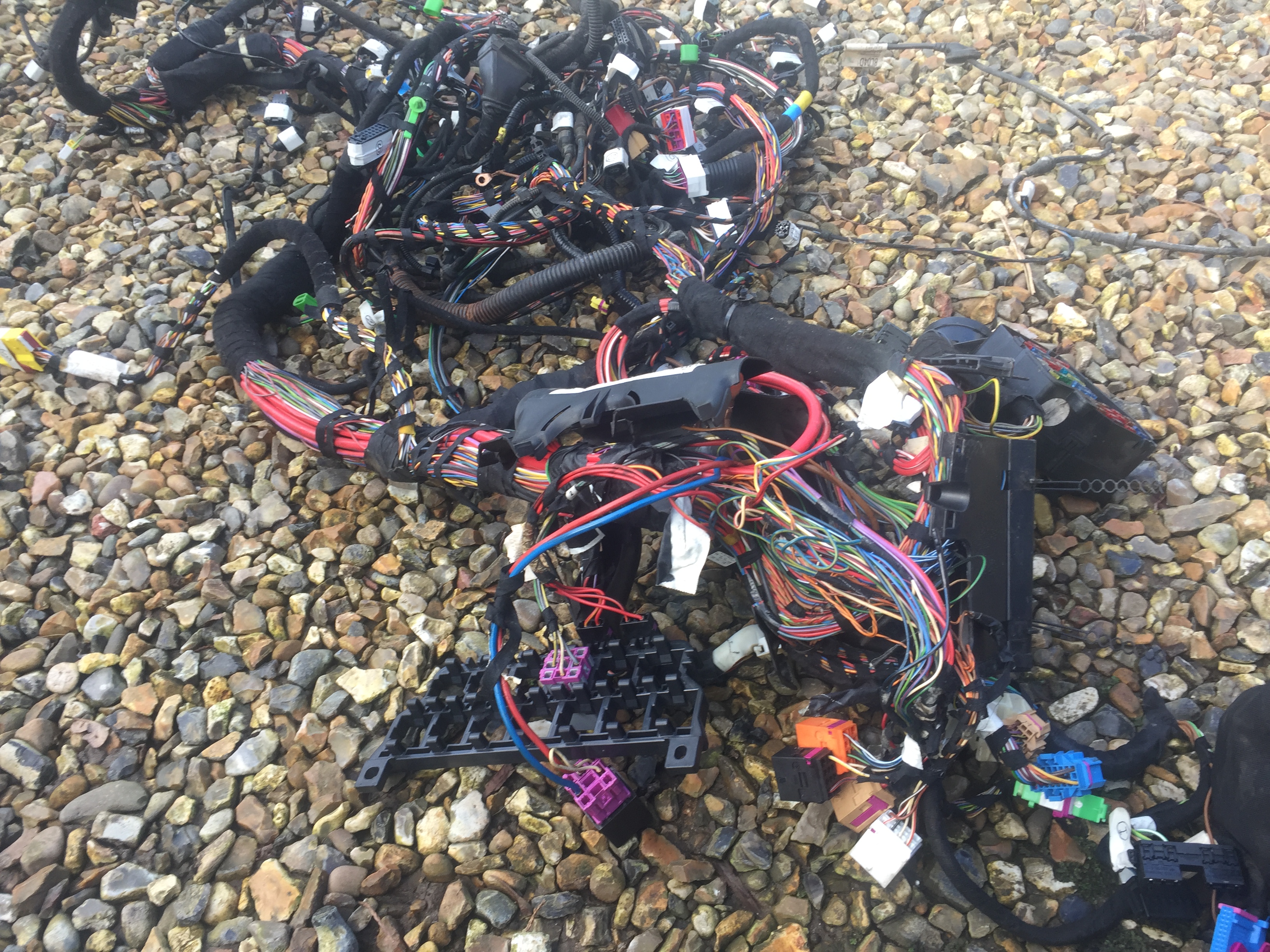

george_seamons Posted February 7, 2016 Report Share Posted February 7, 2016 Todays progress...slightly more successful day! De-pinning parts of the Golf loom for the bits I need to swap over. The OEM loom tape is SOOOOO sticky, horrible stuff!!! Diesel throttle pedal loom split from the loom. 6 wires direct between the pedal and the engine (via the blue plug in the scuttle panel), and 1 goes to relay 109 which supplies ignition power (the taped up one) The aforementioned relay 109. Red wire goes to terminal 30 (permanent power), blue wire goes to the fusebox. All labelled up and ready to be integrated into the TT loom It fits! Only a test for at the minute though, I wanted to see how it sat in the bay, and to get an idea of the downpipe route (which I don't think will be too bad in all honesty, will be similar to the TFSI turbo downpipes). Just need to take one of the heatshields off the bulkhead because the turbo intake pipe catches it. Will pull it back out to change the turbo and inlet (going to use a Passat PD130 inlet, which has a right hand entry rather than the standard left hand...which should mean a far better FMIC route (similar to the K04 charge pipe, but the opposite way around) 4 Quote Link to comment Share on other sites More sharing options...
