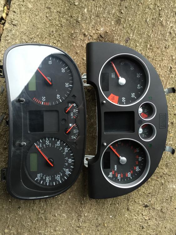

george_seamons Posted February 7, 2016 Report Share Posted February 7, 2016 Nothing but set backs this weekend, stuff I thought would be simple turned out to be a ballache! Started off with the clocks, the plan was to pull the front fascia off the TT clocks and fit it on the Golf clocks (the dash binnacle is a different size/shape: Once I got the clocks from the TT out, I realised they are 3 plug versions, not 2...first problem! All the pinout work I have doesn't mention this third plug on the TT loom, so need to find out what that contains, there's not a lot in it, so hopefully it's something additional (like radio controls etc) rather than something intricate to the loom: Split both the clocks apart, and got ready to swap the fascias...bugger, they aren't interchangeable! The PCB on the Golf clocks is 2mm bigger all round, so it won't fit inside the casing: Managed to get around it by drilling the hole for the 2 buttons on the front of the binnacle (for clock setting and trip reset) slightly bigger so the dials then sit flush against the PCB. I'll need to use a couple of cable ties on the back of the PCB to hold it onto the binnacle, but they are almost perfectly aligned with cutouts on the PCB, so not too concerned about that...and it's all hidden anyway: Next up was swapping the gearbox guts over. The TT is 4WD, but has petrol ratios. The Golf has the correct diesel ratios, but is only FWD. They are both the same 02M box, and people often swap the petrol ratios out on petrol boxes for diesel gears when bigger turbos are used (when longer gears are needed due to boost coming in later). My plan was to put the diesel FWD gears inside the 4WD box. Started off by draining out the oil from the FWD box (engine crane coming in handy again!): Whipped all the bolts etc out, and split the casing off: Then did the same with the 4WD box (one side of the casing is exactly the same, the bell housing side has additional mounting holes for the transfer box, and has oil passage ways to supply the transfer box with oil). The transfer box isn't particularly big, but it makes the box assemble a shed load heavier! Stripped the transfer box off, undid the bolts etc, and split the box open, then laid the 4WD and FWD boxes together: At this point, the only visual difference was the extra length of one of the output shafts on the 4WD diff (to accept the shaft from the transfer box): However, this is where it all went wrong! It turns out the diesel crown wheel gear is ever so slightly bigger than the petrol one. Once the 4WD box with the diesel gears was back together, it wouldn't turn in any gears, only in neutral. Thinking perhaps I had made a cockup with the reassembly, I tried the other box, and I couldn't even get the diff in because it's bigger, so the gears wouldn't allow the shafts to sit inline. Bugger. The only way round it is to drill the rivets out of both diffs, and swap the crown wheels over. Bit of a ballache to do, because the rivets are mega hard, but I did it before on my LCR for the LSD, so know it can be done. It does also mean £100 ARP crown wheel bolts need to be bought, which adds more cost to the project, but needs must! Today's task is to measure the diff rivets PCD to check the spacings are the same, before I get too deep into drilling the rivets out! I ended up putting the boxes back together as they were...wasting about 6 hours of the day, slightly annoying! Just the joys of a bespoke project like this I gues! 2 Quote Link to comment Share on other sites More sharing options...
