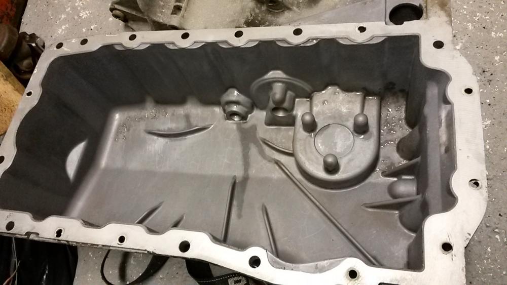

Luke Rainbird Posted February 3, 2016 Report Share Posted February 3, 2016 Got home from work, cleaned my old sump out. Would make sense to baffle it whilst it's off the engine really, need to get the cardboard out and make some templates up. Quote Link to comment Share on other sites More sharing options...

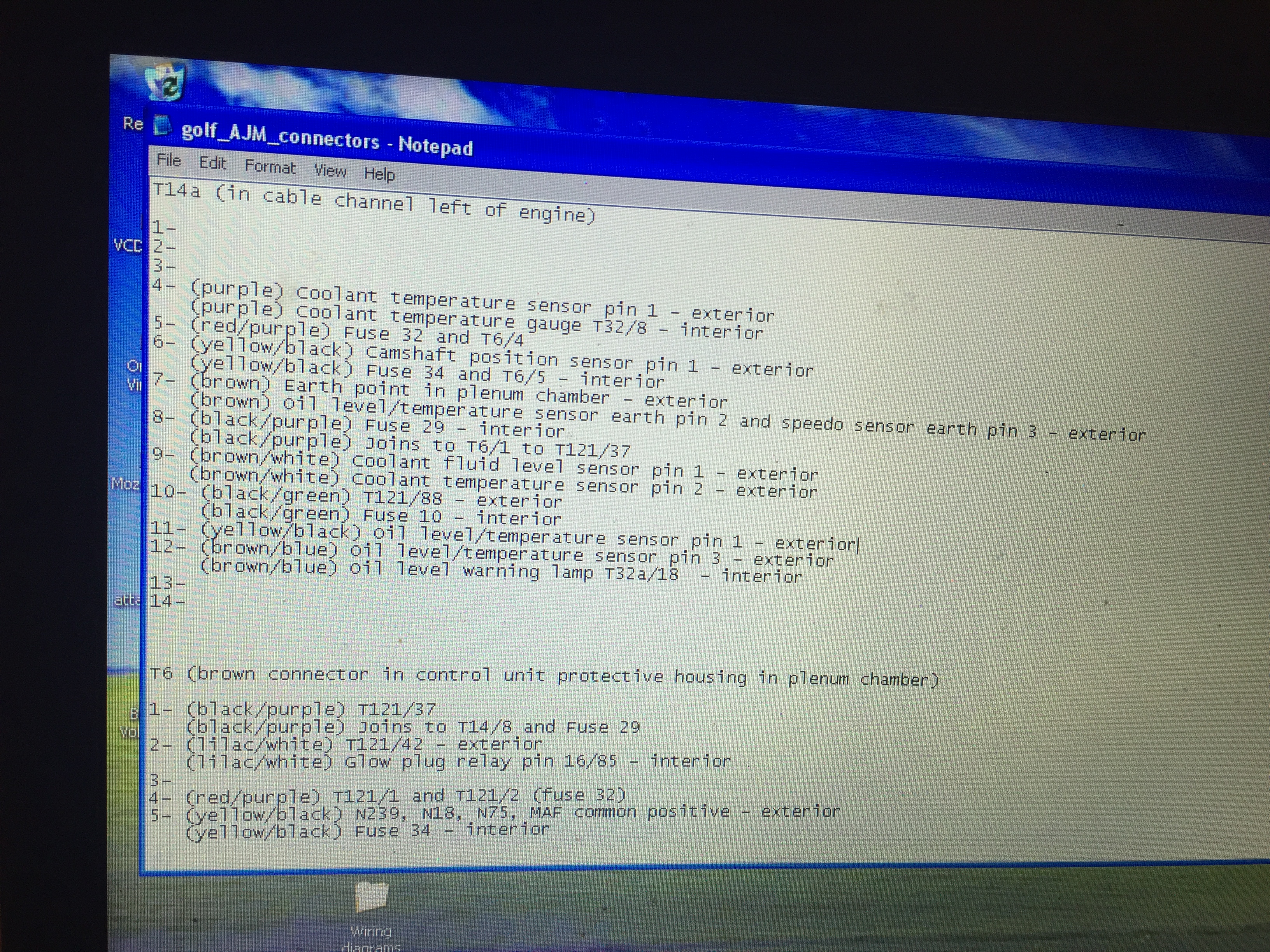

george_seamons Posted February 4, 2016 Report Share Posted February 4, 2016 TTtdi Update: Just finished the pinout of the Golf's ecu and connectors (200+ pins!): However, the car is a PD115 engine, the guy I'm building the car for wants to temporarily put a PD130 turbo on to get it up and running until he saves for a big turbo. The PD115 ecu's aren't very mappable, so he wants to fit a PD130 ecu. Annoyingly, having compared the pinouts between the 2 ecu's, the PD130 has a few extra sensors, and several wires are in different places (the PD130 ecu is a lot more intelligent, and has a lot more map areas, so is more tuneable). The PD115 engine obviously doesn't have these additional sensors, and the PD130 ecu will be looking for them, so a PD130 engine needs to be fitted to get them talking to each other properly. That pretty much means I have wasted the last 3 nights doing a pin out on the PD115 ecu I am trying to convince him to just stick with the PD115 engine and ecu with the PD130 turbo for the short term (the PD115 ecu can be mapped for the PD130 turbo, but not really any higher). Its either that, or he needs to get a complete PD130 engine and loom, which is about £300 ish. Slightly annoying really, we both assumed they were the same engine, just with different turbos and injectors. It's not until you look into it further that these Quote Link to comment Share on other sites More sharing options...
Danny Posted February 4, 2016 Report Share Posted February 4, 2016 Are pin outs not readily available for vag stuff? Quote Link to comment Share on other sites More sharing options...

george_seamons Posted February 4, 2016 Report Share Posted February 4, 2016 34 minutes ago, Danny said: Are pin outs not readily available for vag stuff? They are, but they are on wiring diagrams, so you have to transpose them onto a list like I have done. Bit of a ballache, but saves looking through pages of diagrams when you're sat trying to put pins in plugs! Quote Link to comment Share on other sites More sharing options...

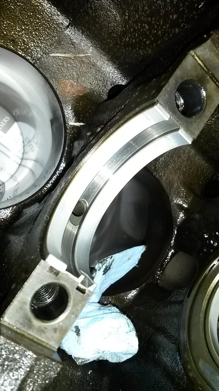

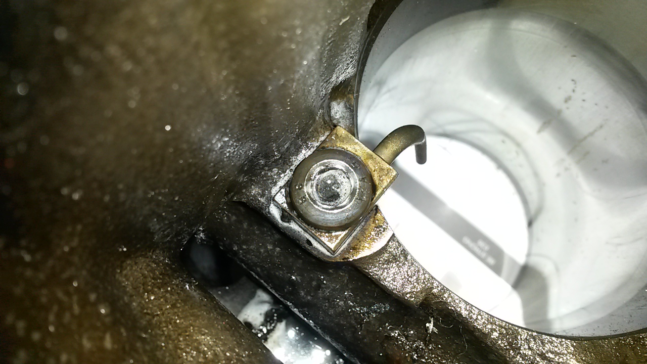

Luke Rainbird Posted February 4, 2016 Report Share Posted February 4, 2016 Good man! I'm doing somewhat random timed shifts at work this week, so just pulled the crank out from my block in the garage. All looks pretty tidy though I've not measured journals etc yet. Some very light wear on a couple of the main bearings but I don't think that's anything to be too concerned about after over 100k miles really. Once I've got new bearings sorted I will plastigauge everything anyway to make sure things are about right. Annoyingly though, when pulling out the last few bits to leave a completely bare block, it seems one of the oil squirter banjo bolts has been done up very tight and is slightly rounded (presumably when being overtightened on installation). Typically the last bolt to come out before I can take the block for a dip in the tank somewhere. Tried the old trick of knocking a slightly larger torx bit in but it's too shallow a head to get enough purchase on there, so going to have to hope some extractors/easy-outs will do the trick. Have PlusGassed it and will try to pick some up before I go to work this afternoon. Bah! Here's hoping it all goes back together a little more smoothly (jinxed it now, haven't I!) Quote Link to comment Share on other sites More sharing options...
forteh Posted February 4, 2016 Report Share Posted February 4, 2016 Is it aluminium or iron block? Lots of heat is your friend but then you knew that already. Chances are they would have been thread locked in and you need to break the glue. Quote Link to comment Share on other sites More sharing options...

Luke Rainbird Posted February 4, 2016 Report Share Posted February 4, 2016 2 hours ago, forteh said: Is it aluminium or iron block? Lots of heat is your friend but then you knew that already. Chances are they would have been thread locked in and you need to break the glue. Iron block, so heat will help. Need to find a spare bolt to replace it but the dealer wants £20 (they'll only sell it with the squirter) so will be trawling forums for a spare from a dead engine or similar. If it comes to it I'll make one. I'd expect thread lock, though none visible on the others. Only meant to be done to 27Nm so this one's definitely been overdone. Quote Link to comment Share on other sites More sharing options...

SamKidney Posted February 4, 2016 Report Share Posted February 4, 2016 Generally as a rule of thumb if the crank looks in good shape with no obvious signs of wear it will be in tolerance. I ordered standard size bearings for my B16 before I'd measured the crank, and when I did the wear was very very minimal, almost non existent, which is as it should be considering in theory the two surfaces never touch. Quote Link to comment Share on other sites More sharing options...
Luke Rainbird Posted February 5, 2016 Report Share Posted February 5, 2016 Yeah visually it's in great shape, but as ever it's nice to check it all out properly. Would be silly not to really for the time and effort it takes; I'm in no mad rush to get it done quickly, just to get it done right. In unrelated news, I got home early from work and figured I'd sort out a little niggly issue. When I gave the front suspension an overhaul a few months back (coils, bushes, ball joints, sensors etc) I accidentally split the pad wear sensor wires. As a result, the ECU sees an open circuit and figures the pads have worn past their warning limit. Nice simple little system when it works but given the pads were fairly recent, I wasn't going to go switching them for fresh ones just to clear a light on the dash. Still, if all it entails is joining the wires again there's no major snag. Unfortunately my initial plan to simply crimp connect the remaining ends of the sensor wiring were scuppered when I took a closer look, as the wire had actually fractured inside the plastic connector. The fact this was flush with the plastic meant I couldn't even add a length of wire very easily as I'd have liked, which would have meant I could keep the stock connector and it'd have looked pretty inconspicuous. So, rather than removing the pins, having to drill out the set wires etc to replace with new I just hit the thing with a mallet to split the core out and was left with this. Stuck a length more wire in. Sealed it all up* and it's now back on the car, no light, no worries. Happy days, nice little 10 minute fix *Yeah, I'm aware it looks gash with the duck tape - will replace with some nicer heatshrink down the line but didn't have any the right size at home... Quote Link to comment Share on other sites More sharing options...
