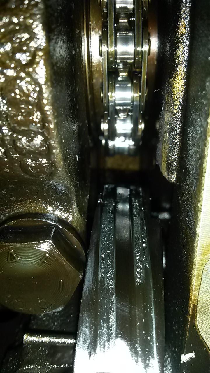

Luke Rainbird Posted January 29, 2016 Report Share Posted January 29, 2016 Pulled the oil pump off the engine I'm rebuilding and although the pump, chain and pickup are in good shape (the pickup pipe has a very small amount of crap in the pickup but nothing I'm too concerned about), the chain tensioner is looking a little worn. The part itself is only a few quid (I already have a new one ready to rock) but to get to the single bolt to replace it I'm going to have to pull the front sealing flange off the block, replace it along with the main crank bolt (effort!) and may as well do the main crank bearings while I'm there. Yay for unwanted cost and effort haha. Related: Pulled one rod/piston out to have a little look at things. New rods haven't arrived yet so I'll leave the others in place until they're here but very happy with how things look on the one I've removed. Edit; Annoyingly Photobucket seem to be messing about with their servers and the one photo not working is the one of the tensioner. Typical! Reupped using TF attachment. Quote Link to comment Share on other sites More sharing options...
AdamR28 Posted January 29, 2016 Report Share Posted January 29, 2016 6 minutes ago, Luke Rainbird said: may as well do the main crank bearings while I'm there. Yay for unwanted cost and effort haha. Just check the clearances with Plastigauge and inspect the surfaces (like you've done for that rod bearing) - no point replacing them if the clearance and condition is good. They never actually touch anything (or shouldn't), that's what oil pressure is for Quote Link to comment Share on other sites More sharing options...
Luke Rainbird Posted January 29, 2016 Report Share Posted January 29, 2016 A good point well made, I guess I'm just covering my ass a little whilst I have the thing in bits. Will have a measure if I get that involved and see how things look Having had a bit of a think about it, I may well be able to leave the crank in place to remove the front flange and get to this tensioner. That'd minimise the extra cost by negating the need for new main bolts etc too which is favourable. As much as I'd love to pull every last part off and do a bare-block rebuild (would make honing etc a little nicer too) I need to draw the line somewhere. This crank bolt is an absolute bitch, may just grind the b*****d off since it'll be replaced anyway. Quote Link to comment Share on other sites More sharing options...

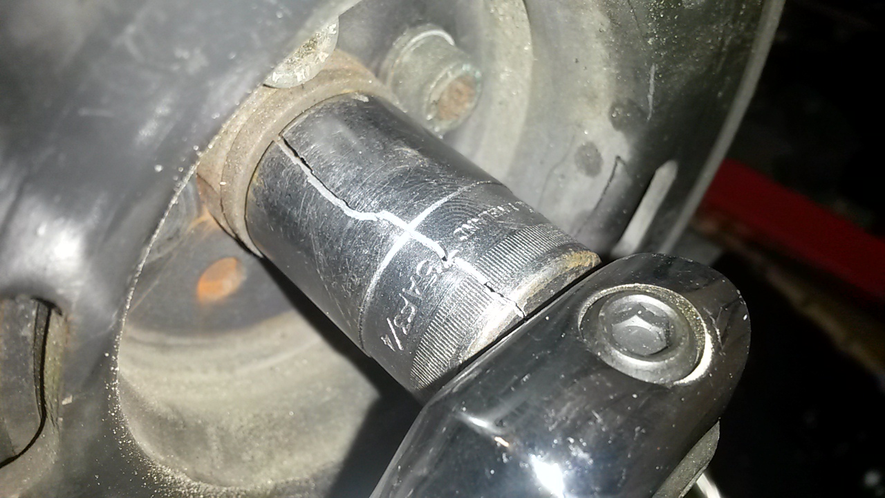

AdamR28 Posted January 29, 2016 Report Share Posted January 29, 2016 If you are honing the bores, the crank 100% needs to come out. You won't get everything clean enough while the crank is in situ. Bugger about that socket! Get a properly sized (can't imagine the Krauts using any imperial bolts?) impact socket on there, it will come... Quote Link to comment Share on other sites More sharing options...
forteh Posted January 29, 2016 Report Share Posted January 29, 2016 (edited) 3/4AF socket on a 19mm AF bolt? Classic Can't say I've not done the same, just not on a high torque application Edited January 29, 2016 by forteh Quote Link to comment Share on other sites More sharing options...
Luke Rainbird Posted January 29, 2016 Report Share Posted January 29, 2016 3/4" = 19.05mm = good enough for government work Only had a 3/8" drive 19mm where as that was 1/2" so gave it a whirl. Clearly not worth it haha. It's just a particularly stubborn b*****d though, as hanging off it with a 3' bar on the 19mm socket hasn't touched it. Most folk seem to say sticking a wooden block between the crank and block to lock it in place as you try to undo the bolt is the way to go, but it's not doing a thing so may just grab the grinder and remove the head of the bolt if it comes to it. Crank out would be nice and easy to hone, but most people leave it in situ and stuff the hell out of the bottom of the bores with rags, shaving foam etc to catch the crud. Whilst I don't agree with that methodology too much, the lack of bottom end here should help keep things relatively easy to clean out in comparison. Just need to go over things repeatedly with surgical precision when checking it all out before building anything back up. That said, looks like I'll be almost there with the crank out at this rate so might be a non-issue! Quote Link to comment Share on other sites More sharing options...

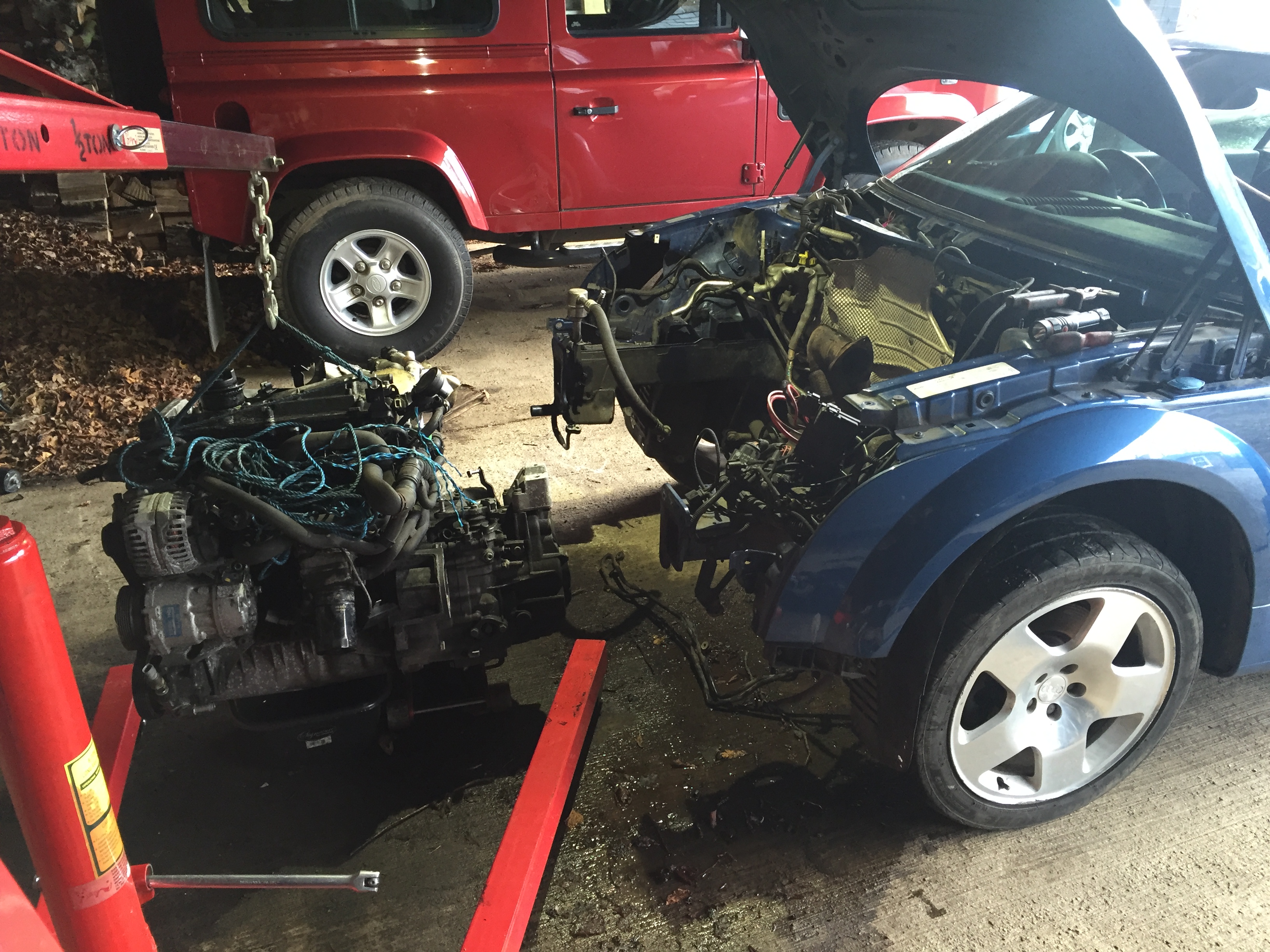

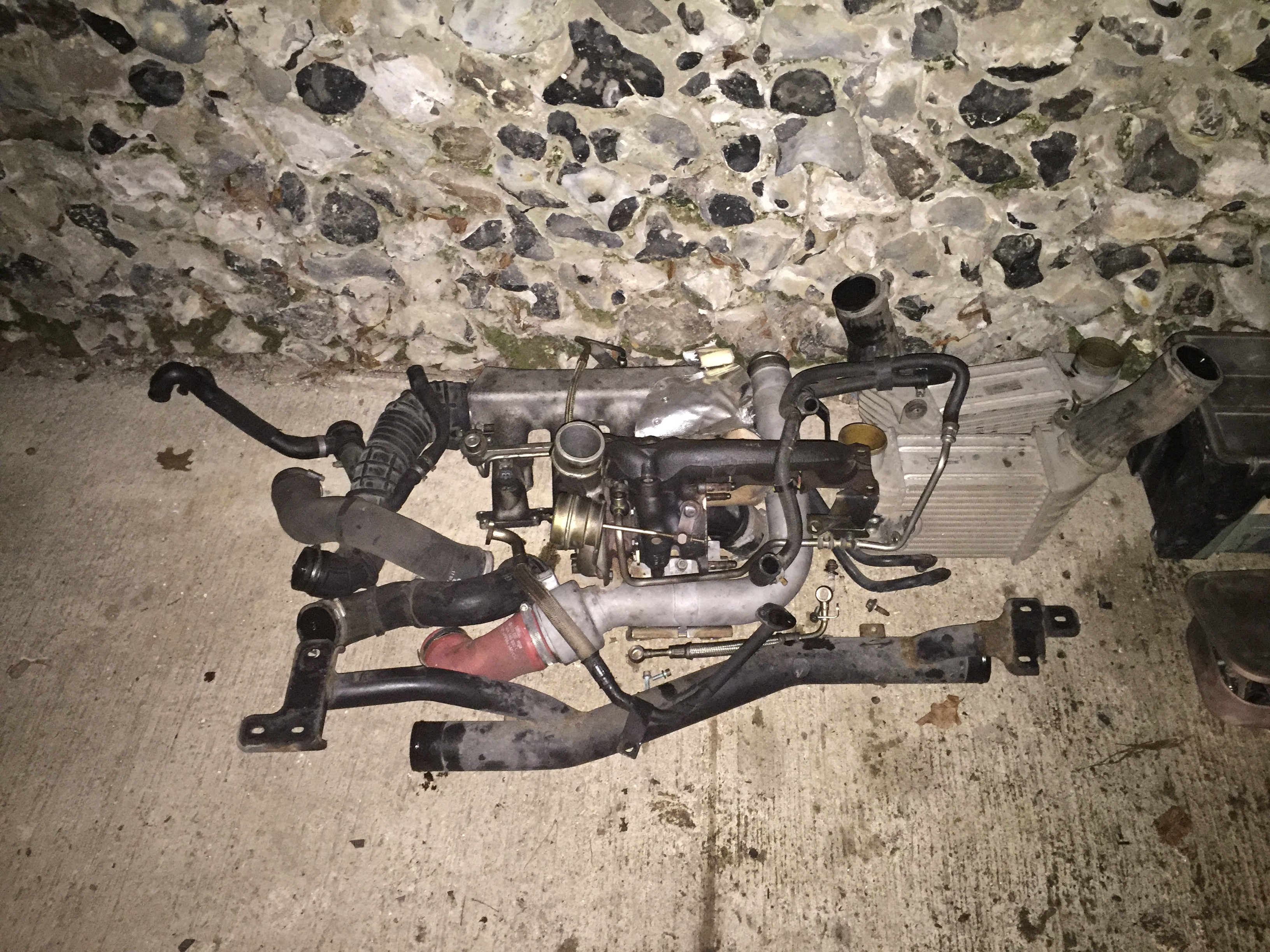

george_seamons Posted January 30, 2016 Report Share Posted January 30, 2016 Engine out of the TT today. A lot more involved than the Golf, the bay is really crammed, and with the 4wd box, access to the turbo and downpipe bolts is a real pain...but got there in the end! Got a nice pile of K04 bits to post out for a 1.8t A3 conversion, should recoup some costs (actually pays for both cars, they were that cheap!): As usual, I forgot to take pictures of the important stages, haha. 2 Quote Link to comment Share on other sites More sharing options...
