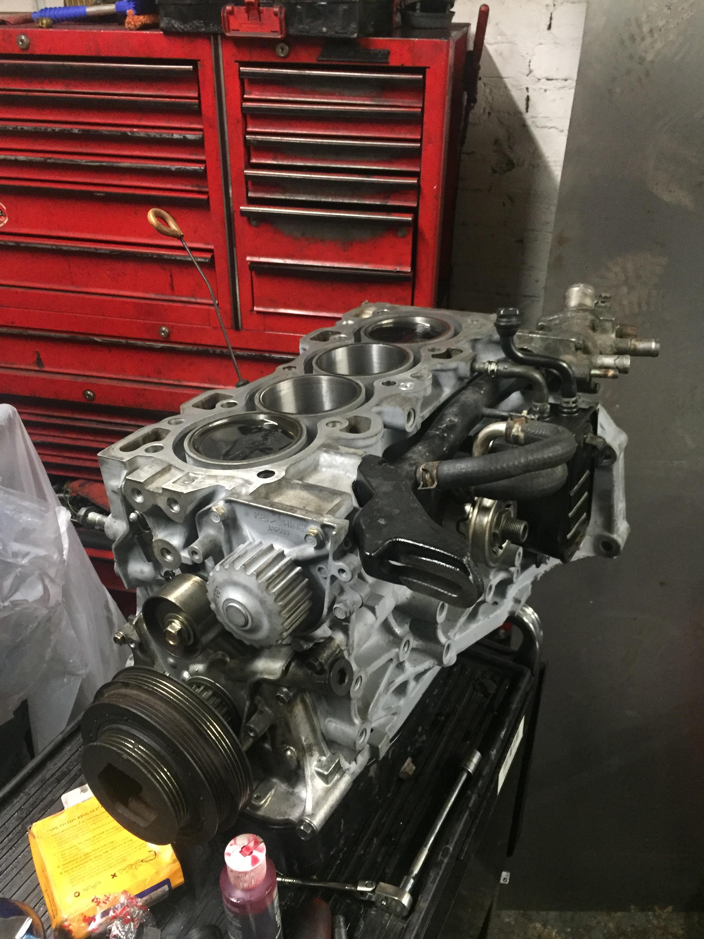

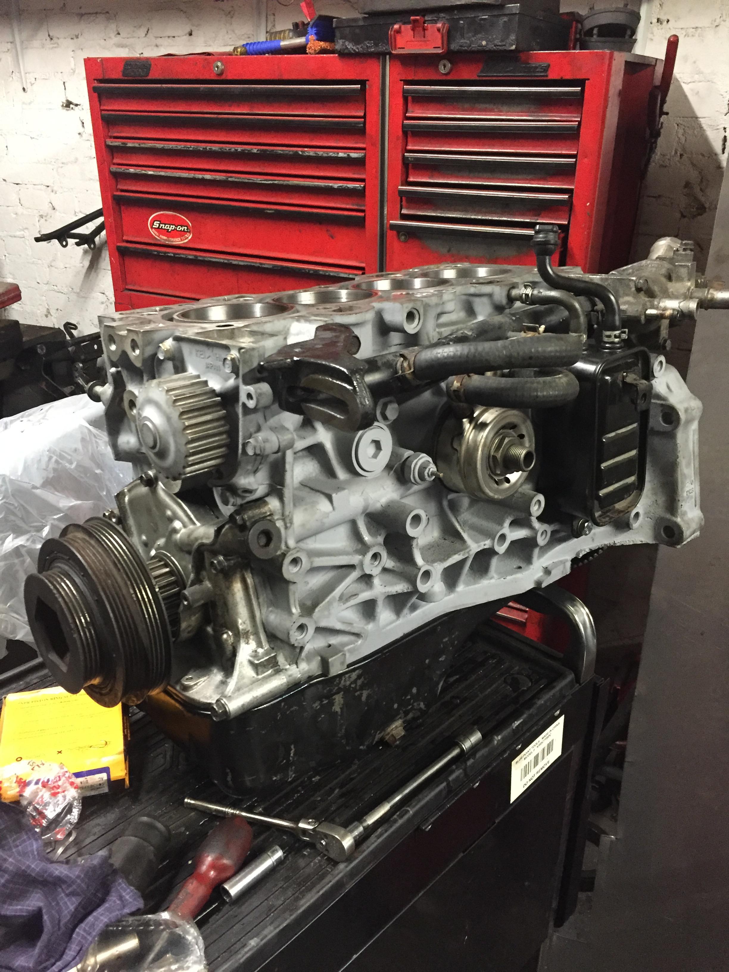

SamKidney Posted January 4, 2016 Report Share Posted January 4, 2016 (edited) Bottom end is now complete, only needs the water pump replacing. New bearings, rings and seals throughout. Edited January 4, 2016 by SamKidney 1 Quote Link to comment Share on other sites More sharing options...
Luke Rainbird Posted January 4, 2016 Report Share Posted January 4, 2016 Nice one Sam. Forgive me if I've missed it, but are you just refreshing a standard engine with new parts, or are you building it up with uprated components/similar? I'm slowly gathering parts for mine. I don't really know exactly what I'll be up to for the next 6 months at the mo but should find out in a fortnight, so until then I'll just continue to stockpile bits in the garage Quote Link to comment Share on other sites More sharing options...
SamKidney Posted January 5, 2016 Report Share Posted January 5, 2016 9 hours ago, Luke Rainbird said: Nice one Sam. Forgive me if I've missed it, but are you just refreshing a standard engine with new parts, or are you building it up with uprated components/similar? I'm slowly gathering parts for mine. I don't really know exactly what I'll be up to for the next 6 months at the mo but should find out in a fortnight, so until then I'll just continue to stockpile bits in the garage Cheers Luke. Yeah this has merely been a bottom end refresh as it was burning oil and had a very faint knock. The head is still in pieces however, and with the standard bottom ends being as good as they are improvements can be made up top, of which I'm still debating. I'm not after a bhp monster just yet, I should be grabbing a B18c6 out of an Integra next month which is being rebuilt fully with aftermarket parts. The purpose of this engine is to give it a little more poke in the mean time. 1 Quote Link to comment Share on other sites More sharing options...
