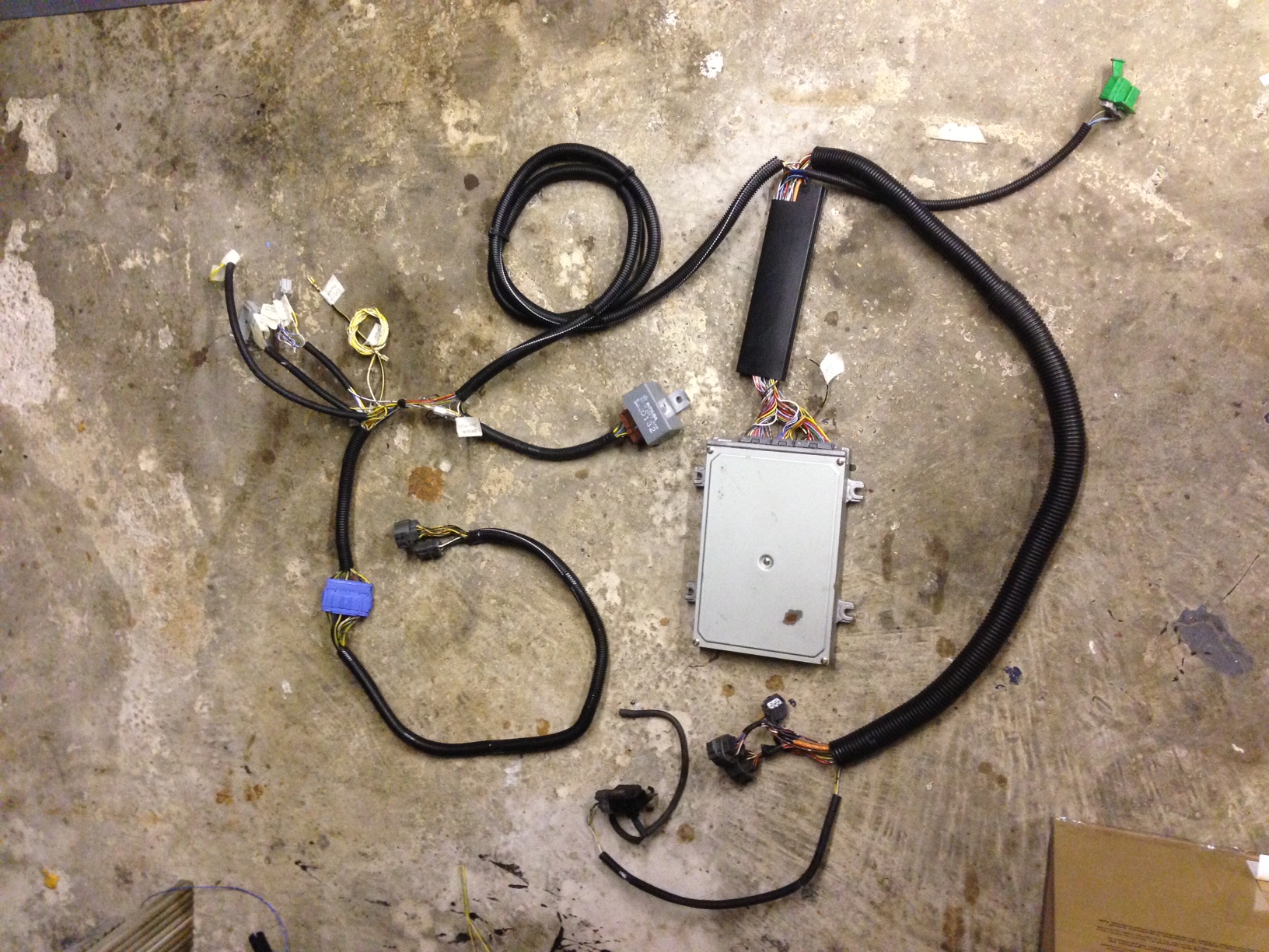

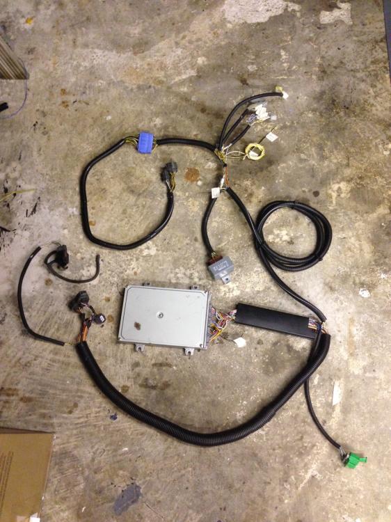

The question stemmed from a loom i'm currently doing in which i have 4 wires to connect.  Currently they are soldered and covered in heat shrink. They are in a big bundle of 10+ wires so shouldn't move much.
At some point i will need to shorten the loom too, but i'm planning on sourcing replacement pins and re-pinning the plugs.

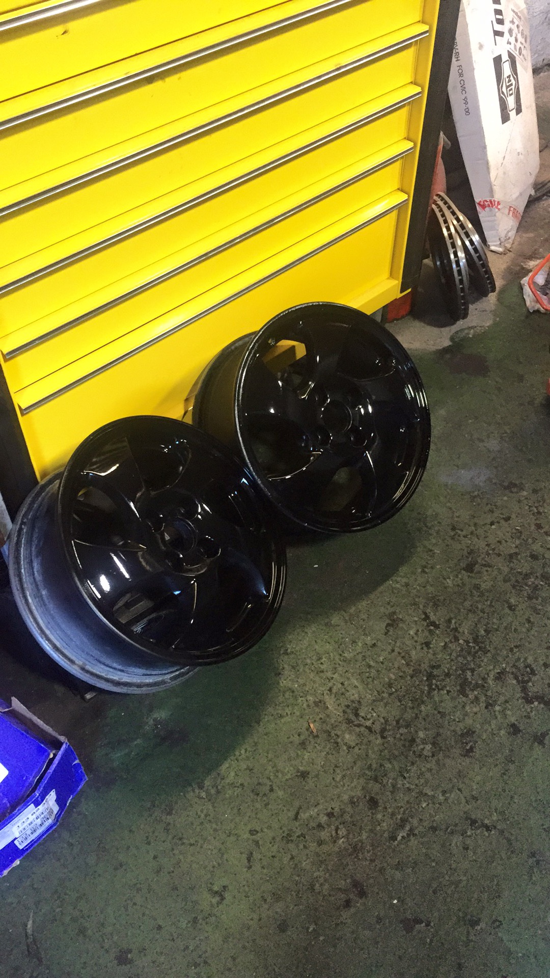

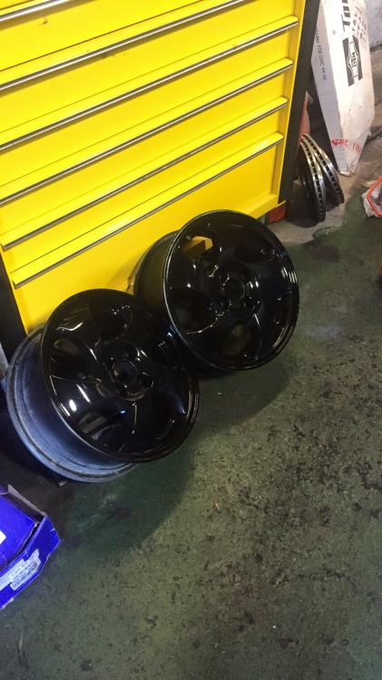

I dont think the photo does them justice, but Im inclined to agree in a sense.
3 of them were already black and one came in primer, so the logical cheap solution before I get them refurbed properly was to go over them again in black to neaten them up.
Id like to do them an anthracite grey next year, or maybe even just revert them back to an OEM silver for originality.
