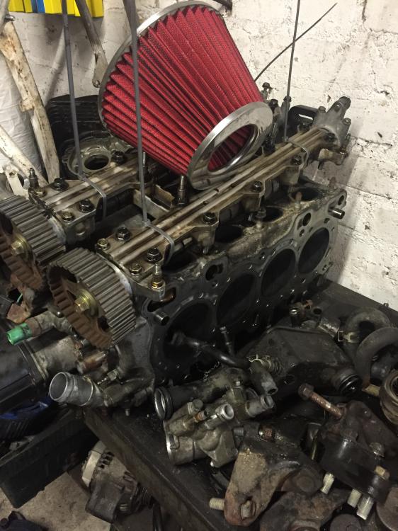

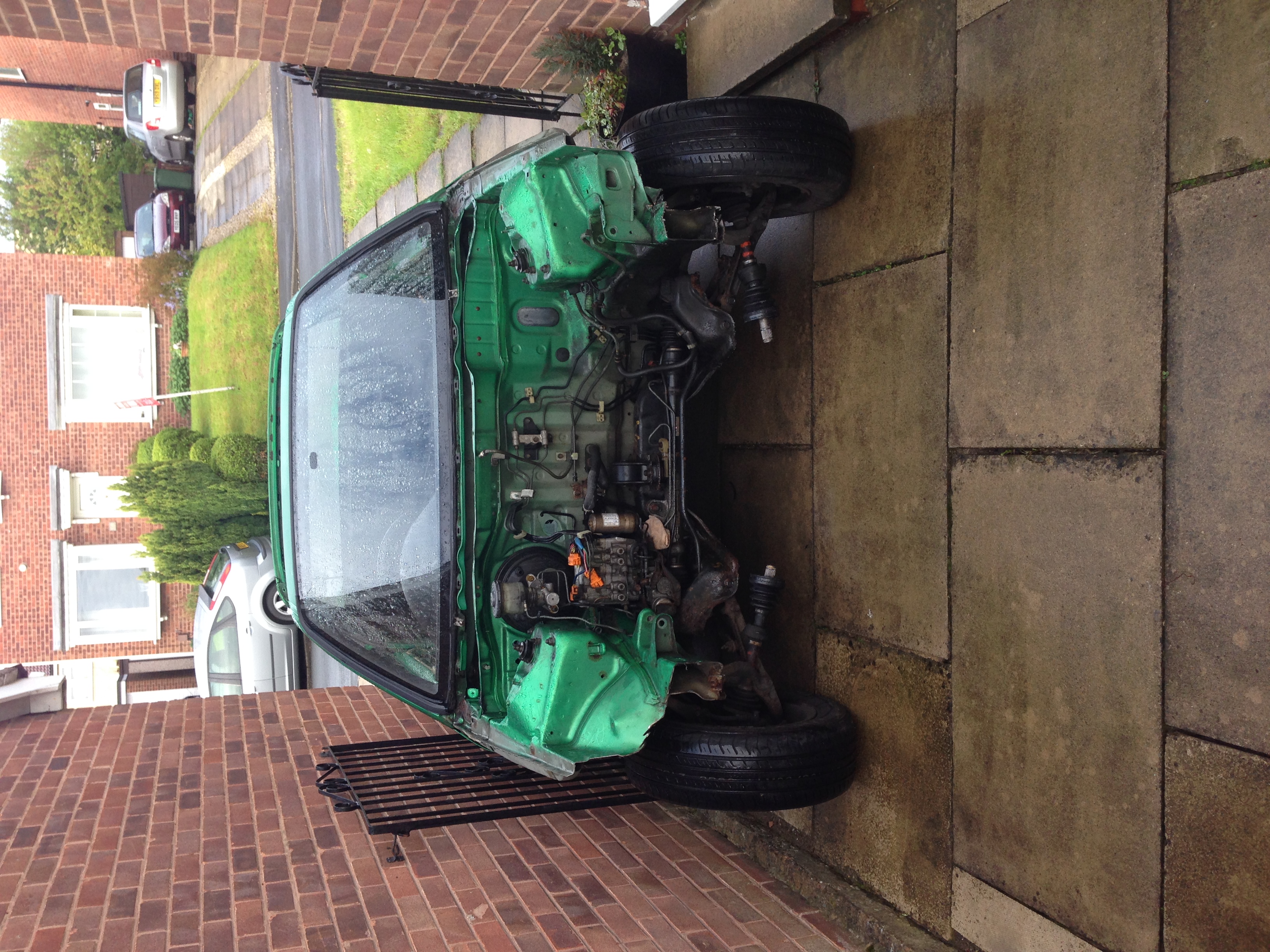

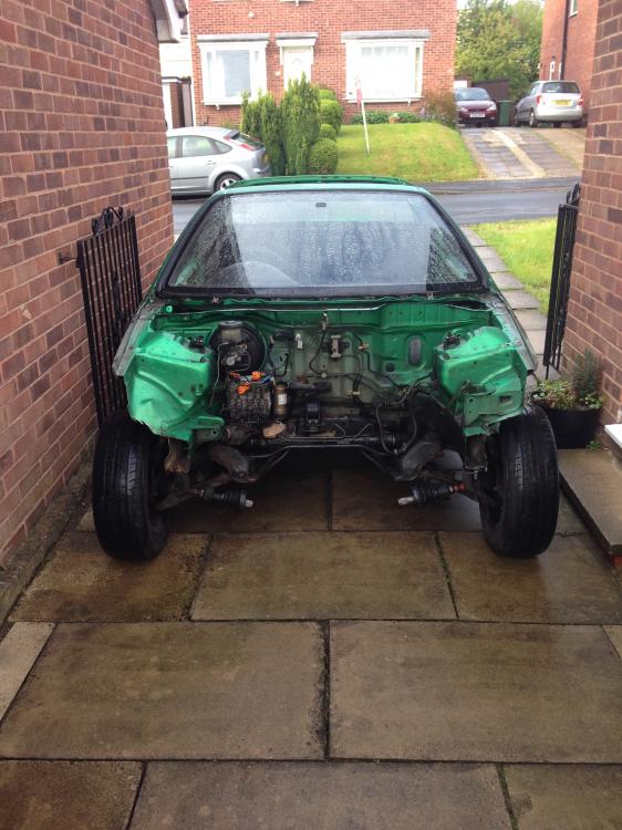

Cracked on with getting the B16 out of the other car today. An hour and a half later and voila: image.thumb.jpeg.fef868cc48c81acd331e8b1image.thumb.jpeg.73ac2e7e806f9fba44fc2f9

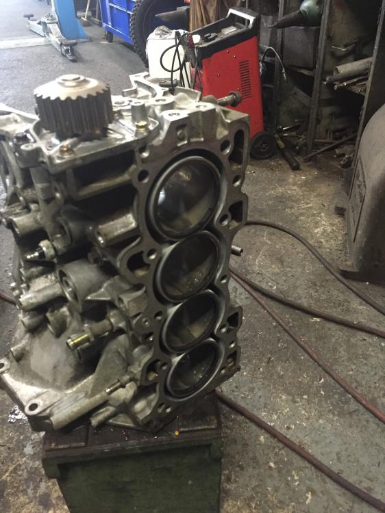

Got the gearbox off, along with the inlet manifold and cylinder head. As i had suspected the bores have been polished slightly due to it overfueling on the ITBs but everything else looks good. Will be seeing what the rings are like tomorrow when I get the rods and Pistons out. Worst case is a new set of rings and a bore hone to go with a new head gasket and some bolts.

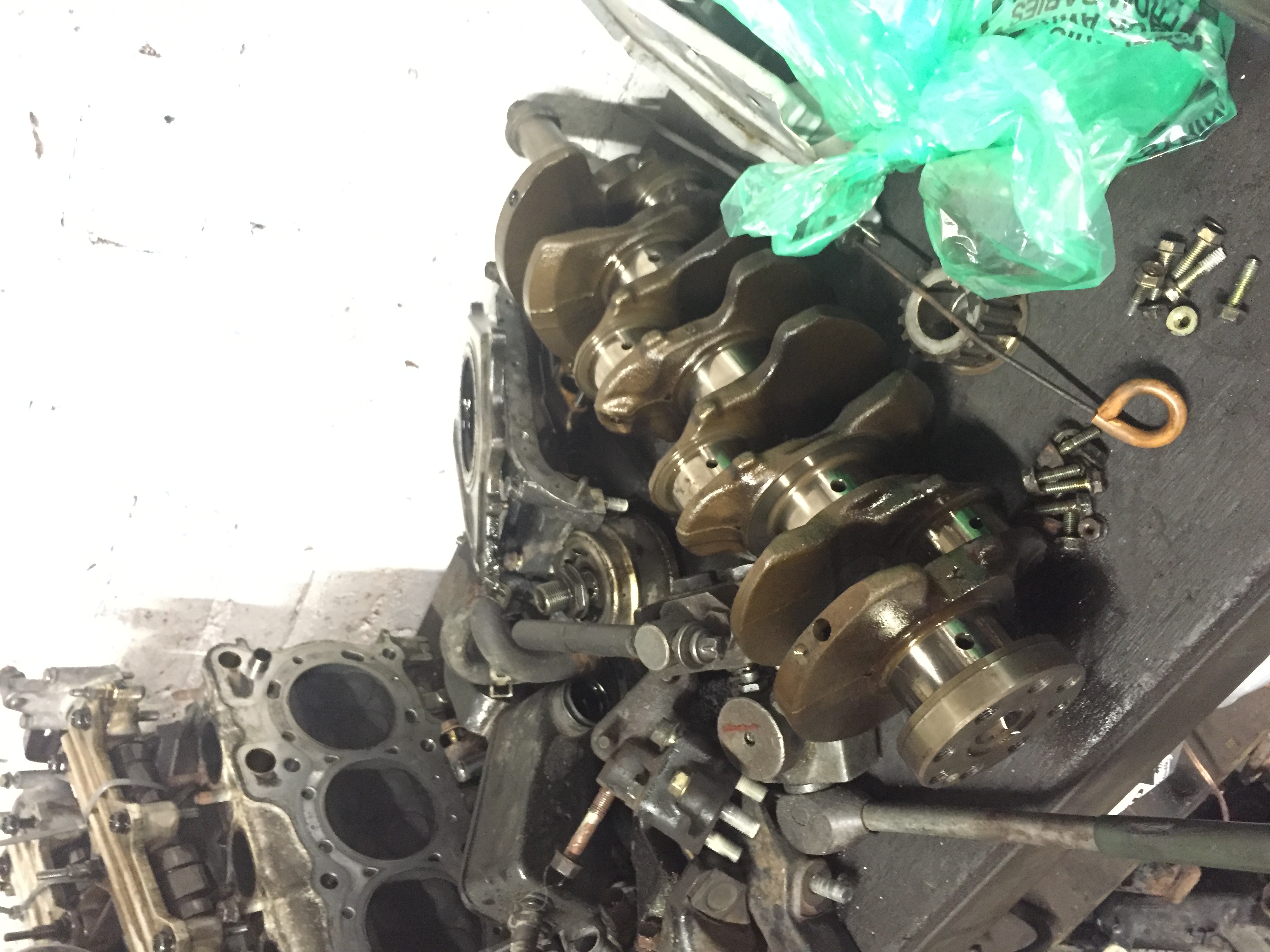

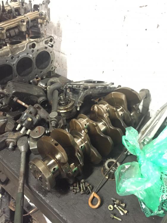

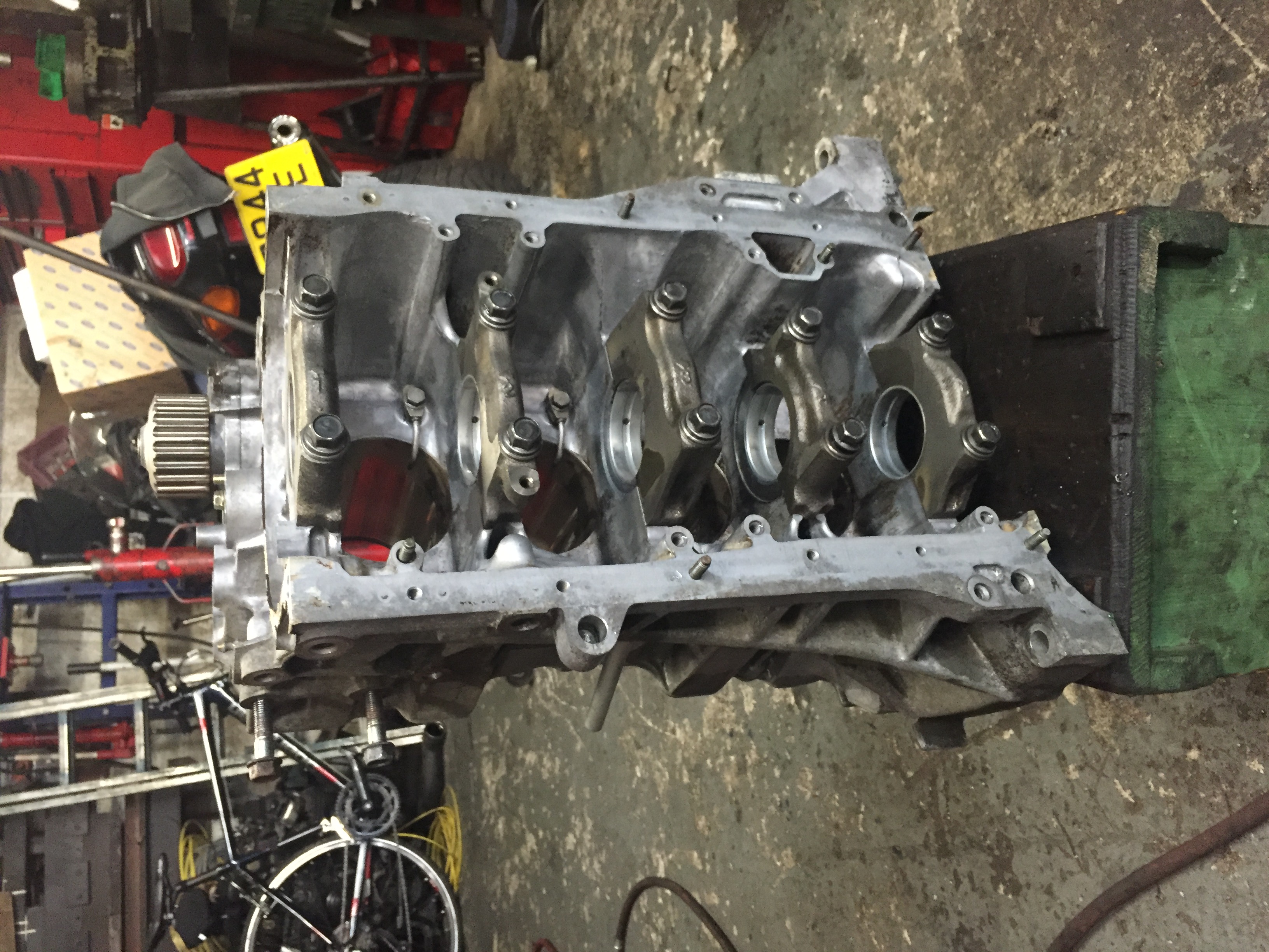

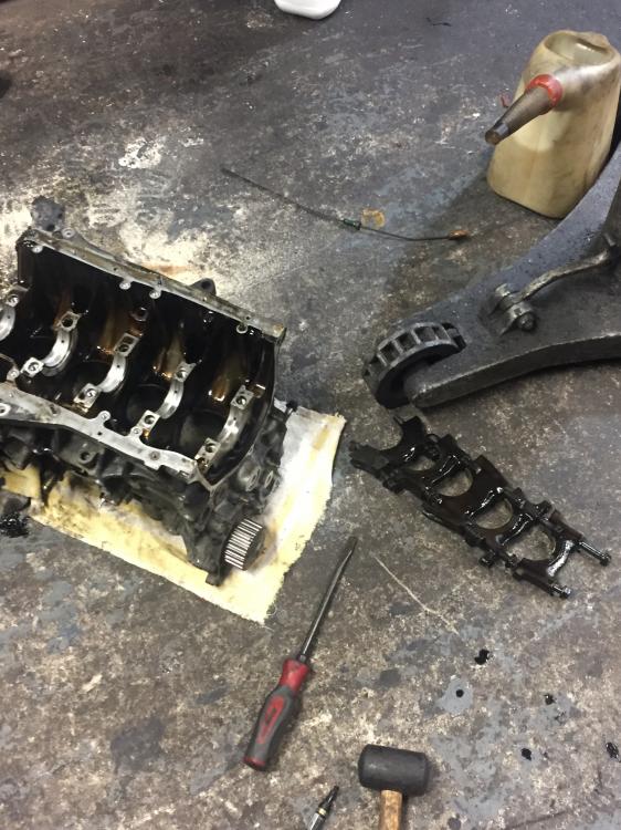

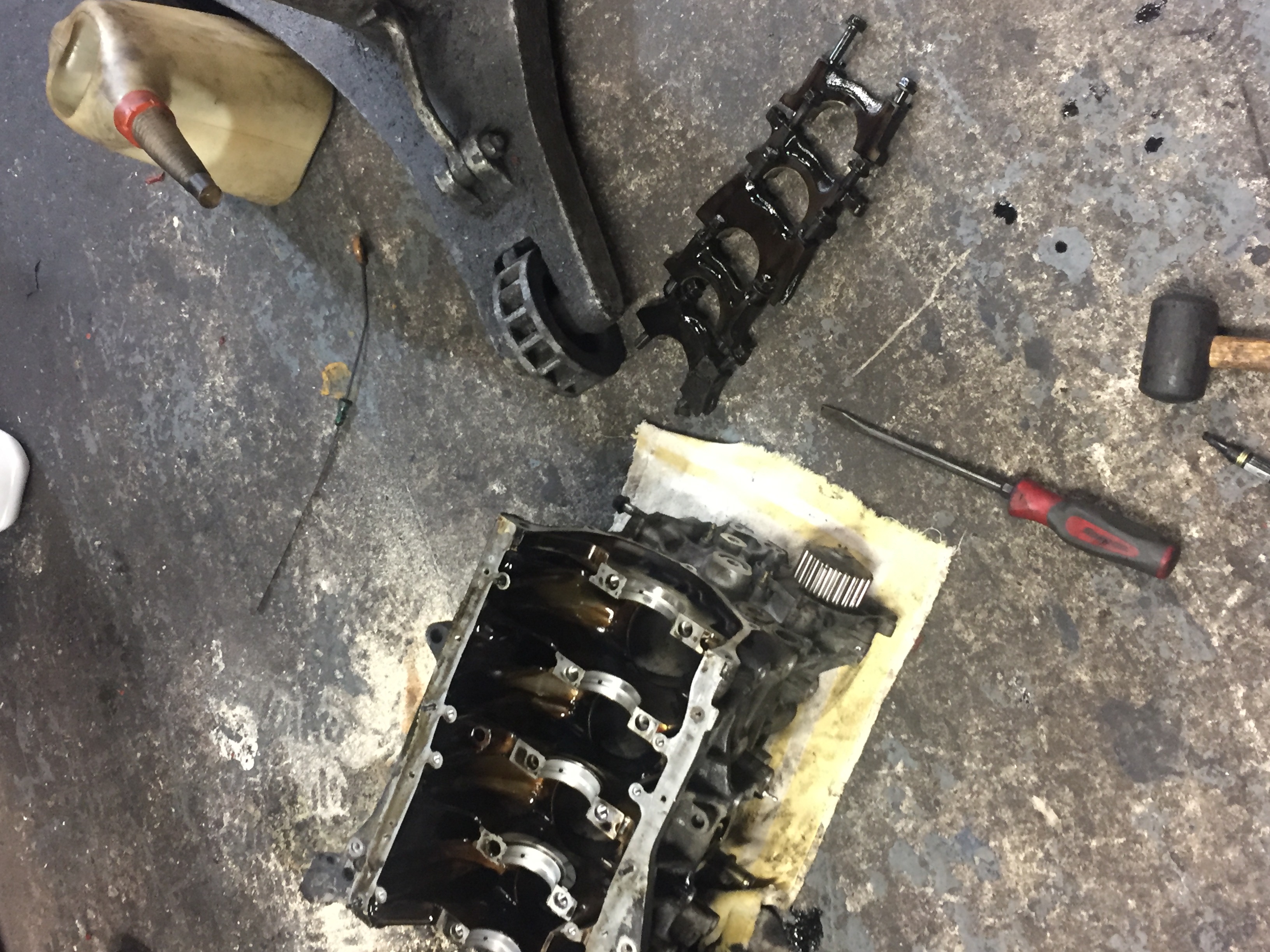

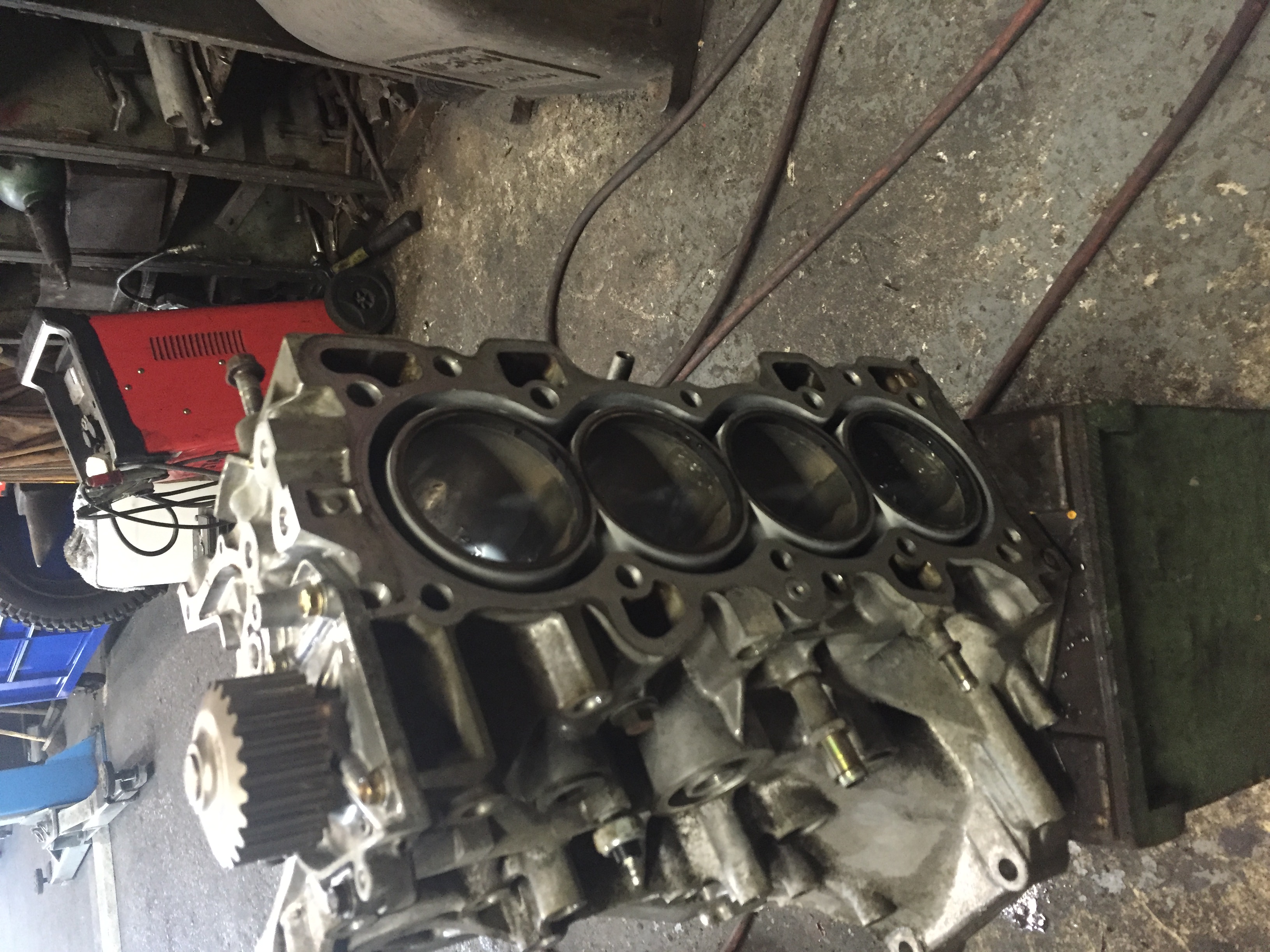

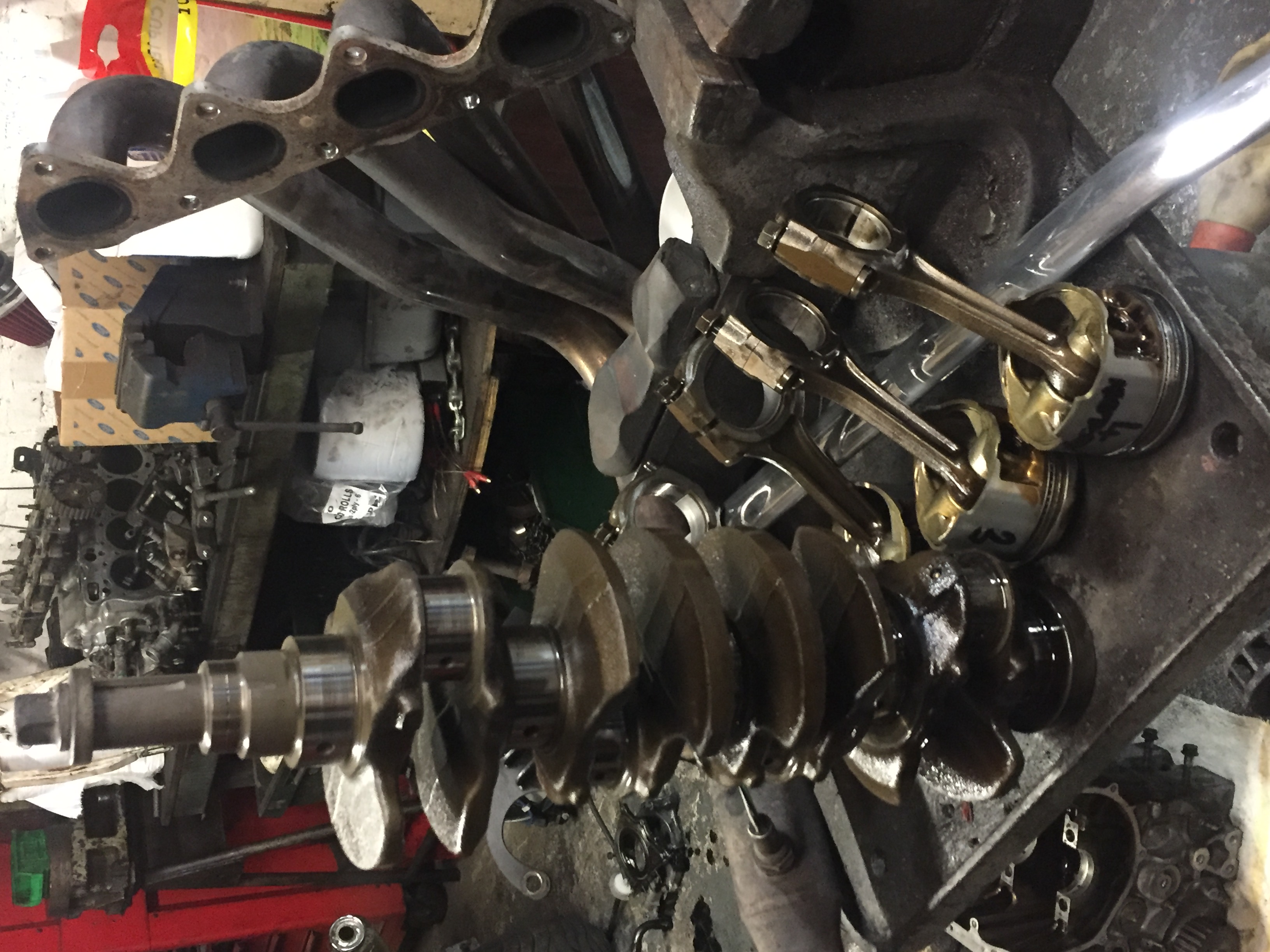

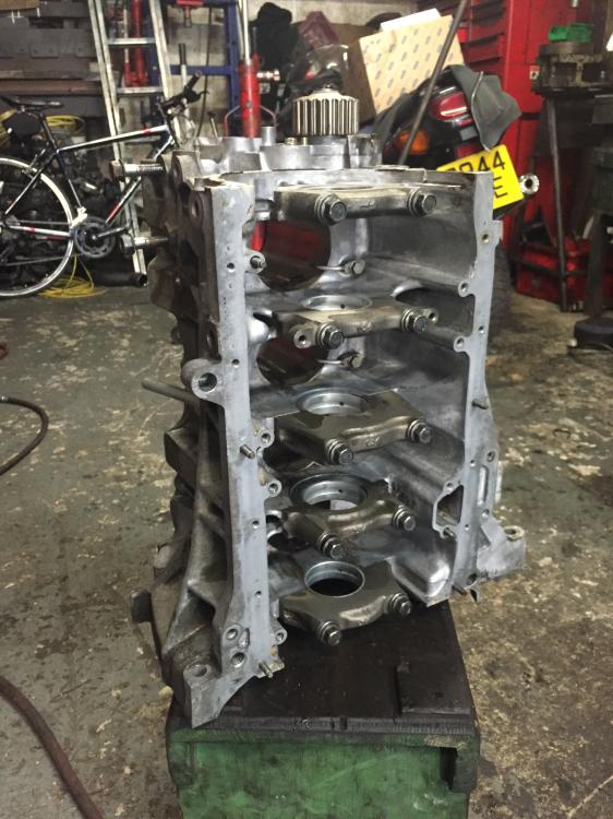

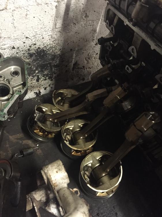

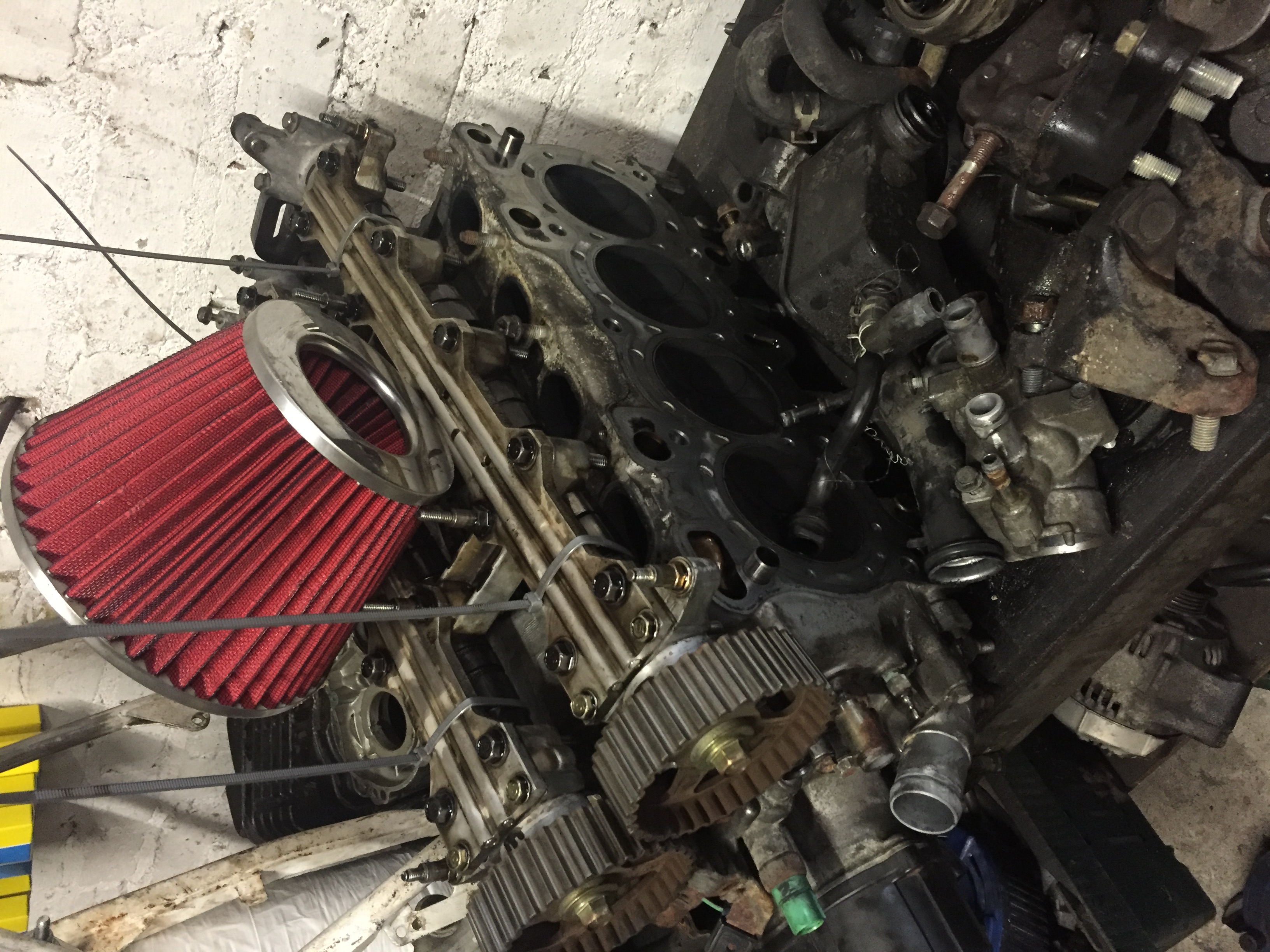

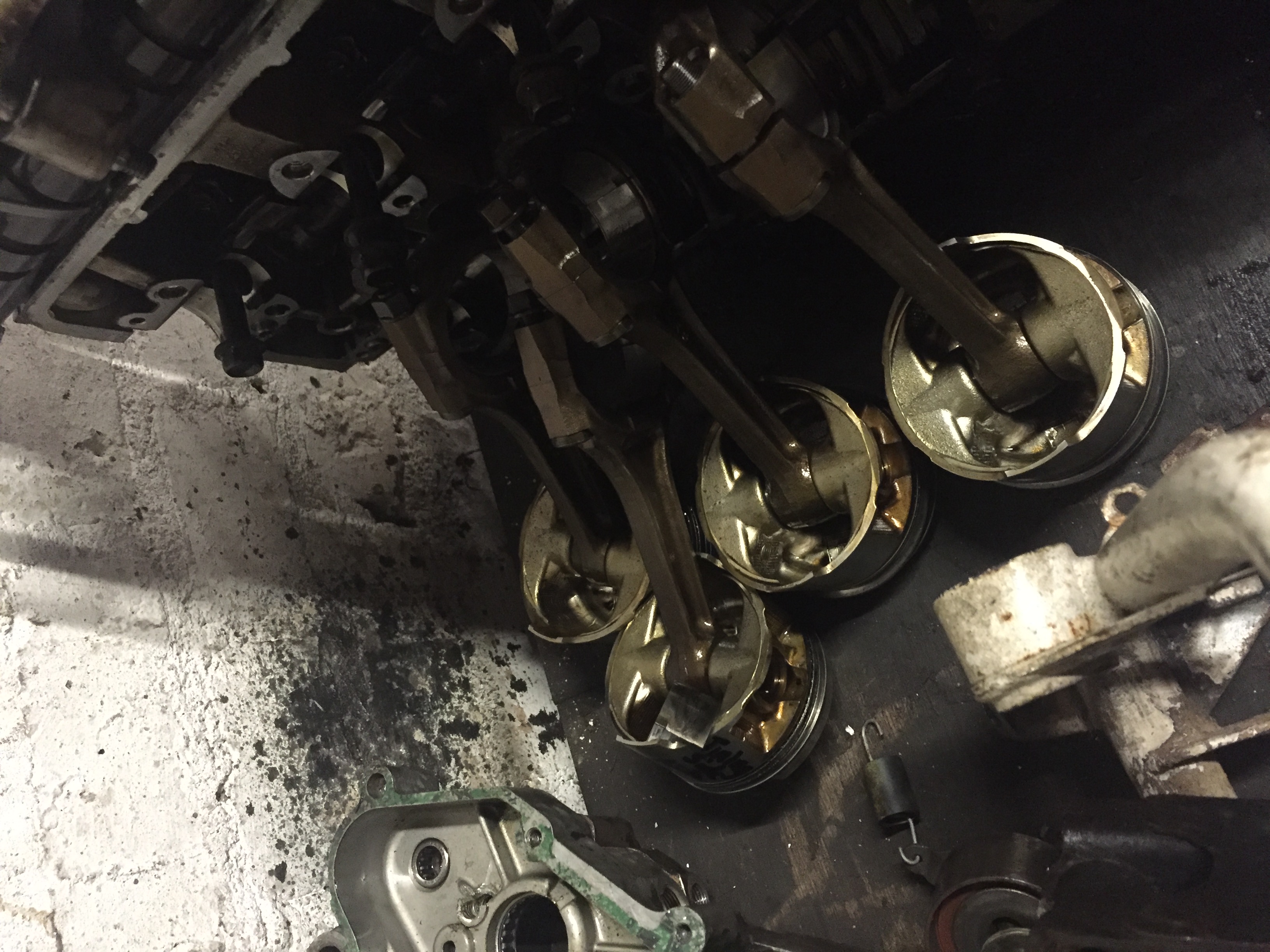

Engines all in bits now. No.1 big end has been very hot! It's the only bearing that's blued out of the lot... Going with a full set of ACL main and big end bearings. Thinking of going for some Weisco pistons and eagle H beam rods. Crank and flywheel are away to be lightened and balanced in the next week or so.
image.thumb.jpeg.457f8904060df851fed5478image.thumb.jpeg.957c6d8e7d7fd795eb79c07image.thumb.jpeg.933f3bd900f672b764e4144image.thumb.jpeg.ce61c8a0ec98493be3b7409image.thumb.jpeg.98d9bf510f76be04622ea59image.thumb.jpeg.1f627255c6c93a432eea9efimage.thumb.jpeg.8d4be9eb9b99017027a8c58
Get the crank journals measured up before you go any further. And buy a new OE oil pump to fit when it all goes back together, even if the current one is within spec. Don't ask me why I'm recommending this...
I've measured the journals and they're all within spec, minimal wear, literally only the no.1 rod bearing has blued slightly but the rest look good. Oem oil pump is in my garage ready to go also, I've been caught by that one too...
