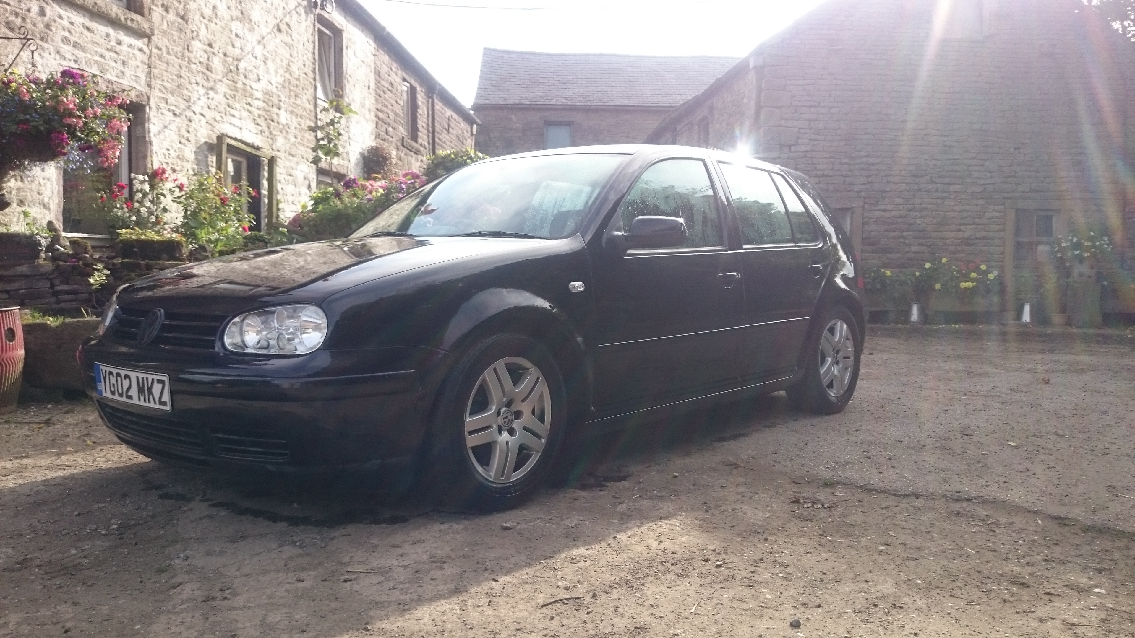

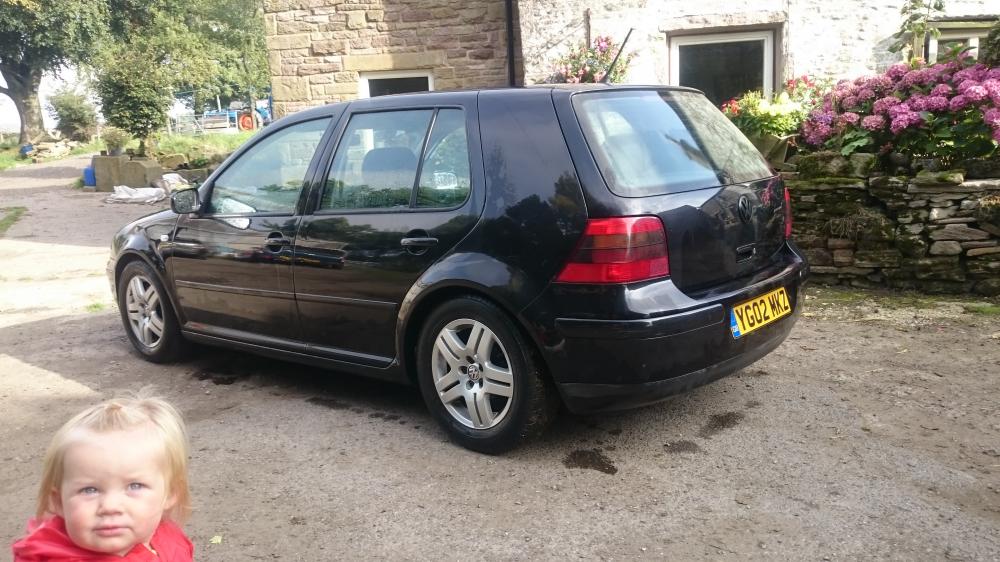

Car is lowered, not entirely sure how much though the front can't be more than 40mm as the ARB would be catching the driveshaft. Rear is quite a lot more as was 30mm lower before I even adjusted it.
Also got chance to wash it farm style, pressure washer plus traffic film remover represent!

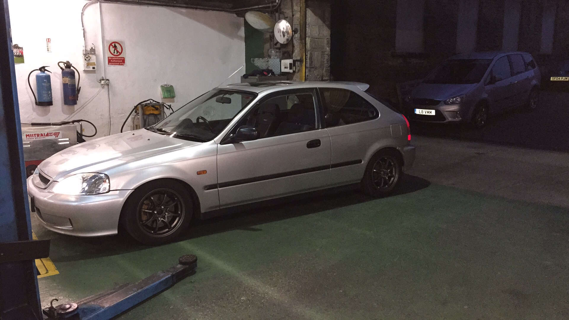

Got my steering tracked tonight, along with my 15"s and dropped a tad lower to suit. It's driving lovely, just need to get my b16 in.
