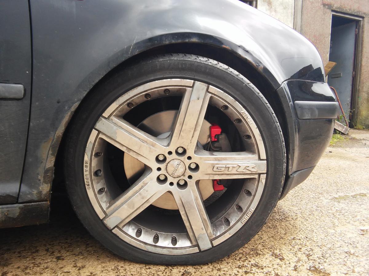

MartMini Posted June 3, 2015 Report Share Posted June 3, 2015 312mm brakes, done! pedal feels a bit shit though, had horrific troubles bleeding them with the abs system Quote Link to comment Share on other sites More sharing options...
Pashley26 Posted June 3, 2015 Report Share Posted June 3, 2015 pedal feels a bit shit though Probably already boiled the fluid. Did you stop more than once? Quote Link to comment Share on other sites More sharing options...
dann2707 Posted June 3, 2015 Report Share Posted June 3, 2015 Heaven forbid you need all that stopping power from your fire-breathing engine 1 Quote Link to comment Share on other sites More sharing options...
MartMini Posted June 3, 2015 Report Share Posted June 3, 2015 Probably already boiled the fluid. Did you stop more than once? new fluid, braking gently to bed the pads/disk in Heaven forbid you need all that stopping power from your fire-breathing engine old 280mm front disks were warped. for the price of 312mm disk/pads/calipers/carriers, made sence to upgrade. You of all people have experienced people driving like knobs. cornwall is twice as bad, it pays to have decent brakes! Quote Link to comment Share on other sites More sharing options...
Pashley26 Posted June 3, 2015 Report Share Posted June 3, 2015 That's not how you bed pads in. Quote Link to comment Share on other sites More sharing options...
MartMini Posted June 3, 2015 Report Share Posted June 3, 2015 it is for standard pads/disks! done less than 100 miles on them. the brake bite feels amazing, its just air in the hydraulic system making the pedal feel shit... Quote Link to comment Share on other sites More sharing options...
dann2707 Posted June 3, 2015 Report Share Posted June 3, 2015 That's fair enough. Yeah you're bedding them in wrong. You need to go on a motorway late at night and get them stupidly hot. Quote Link to comment Share on other sites More sharing options...
Pashley26 Posted June 3, 2015 Report Share Posted June 3, 2015 Best get cycling the pump on VCDS. 03, ABS. 04, Basic Settings. Block 001. Go. Quote Link to comment Share on other sites More sharing options...
MartMini Posted June 3, 2015 Report Share Posted June 3, 2015 That's fair enough. Yeah you're bedding them in wrong. You need to go on a motorway late at night and get them stupidly hot. that wont get air out of the hydraulic system... Quote Link to comment Share on other sites More sharing options...
Pashley26 Posted June 3, 2015 Report Share Posted June 3, 2015 that wont get air out of the hydraulic system... It'll bed the pads in though. Quote Link to comment Share on other sites More sharing options...
MartMini Posted June 3, 2015 Report Share Posted June 3, 2015 Best get cycling the pump on VCDS. 03, ABS. 04, Basic Settings. Block 001. Go. havn't registerd my vcds yet i did cycle the pump using a mates diagnostics system today inbetween bleeds. the thing is i've driven it around for a week with the pedal feeling different each time, so im not sure if theres still air in the system, or it feels the way it does because its meant to be that way Quote Link to comment Share on other sites More sharing options...
