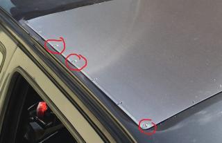

why did you remove the sunroof?
It is not THAT heavy, and if you would be THAT much into the weight saving, you would not have carpets on your car... I do not understand you
How waterproof the roof now?

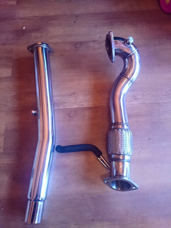

Sam Bryant is currently doing the Pro4 manifold and Relentless 3" DP/decat for a total £475 posted which is pretty tempting at the mo. Only thing that puts me off is the fact it's an S3/TT 4wd style DP so won't sit quite right. George/Nick, what were you guys running on your 2wd K04-023 setups?
May just get involved with the deal as it's a fairly good price, just needs a flange welding on to match the OE catback and could always tweak it to fit a little better if I get really bored I guess!

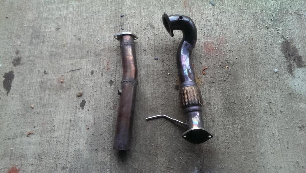

I had to tweak mine ever so slightly to get it to fit. Was very easy, literally just cut a section out and swapped it around. I also had to add a "strategic dent" because it was so close to the bulkhead. Mine went into one of the ebay 3" systems, so the flange bit wasn't an issue. Apparently if you move the engine over on the mounts it clears the bulkhead a bit easier too.
Compare that with the revised downpipe, and you can see the difference:
It is however a very good deal, so if you don't mind a bit of work, its probably worth the price. I really struggle to not recommend the 3" turbo back Cobra system though. £680 for a resonated system, but its worth every penny. Fits like an absolute dream, and the quality is excellent.
Just removed X" from the front end of the decat there, yeah?
