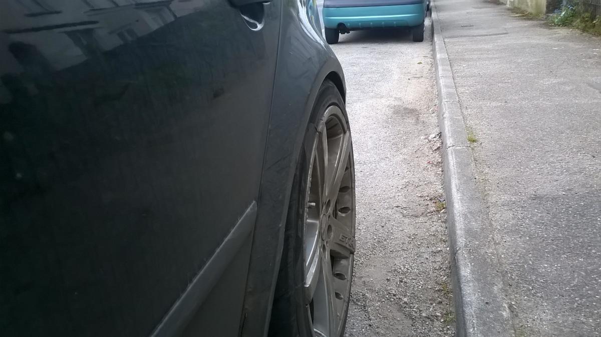

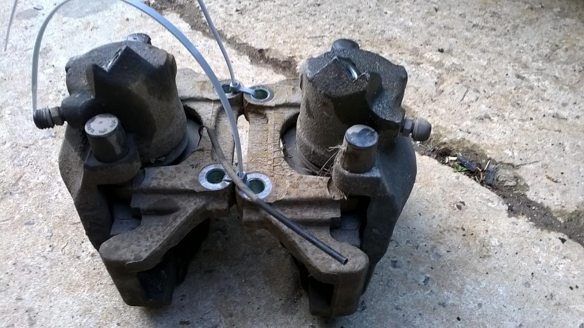

MartMini Posted April 12, 2015 Report Share Posted April 12, 2015 Spaced my rear wheels out a bit, sitting much better in the arches: Also managed to pick up these little beaut's yeaturday. 54mm ATE Calipers with 288mm carriers Best tenner ive spent in a long time! Quote Link to comment Share on other sites More sharing options...

dann2707 Posted April 12, 2015 Report Share Posted April 12, 2015 Spaced my rear wheels out a bit, sitting much better in the arches: WP_20150410_17_08_52_Pro.jpg WP_20150410_17_09_20_Pro.jpg Also managed to pick up these little beaut's yeaturday. 54mm ATE Calipers with 288mm carriers Best tenner ive spent in a long time! WP_20150411_11_00_18_Pro.jpg Fit a Sharan badge Quote Link to comment Share on other sites More sharing options...
