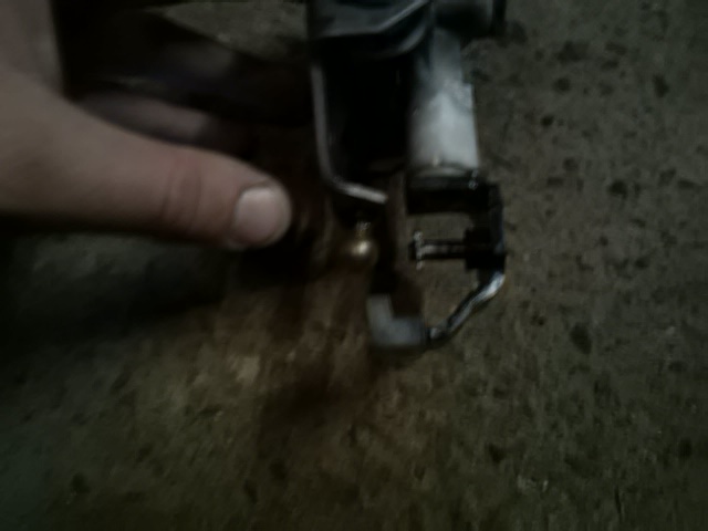

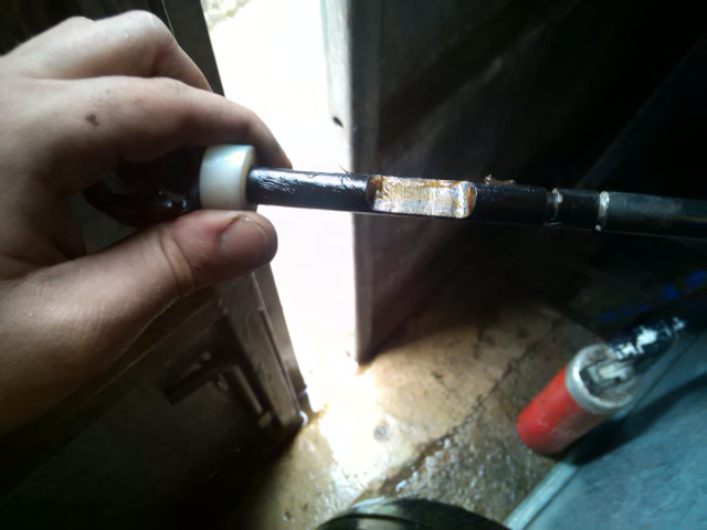

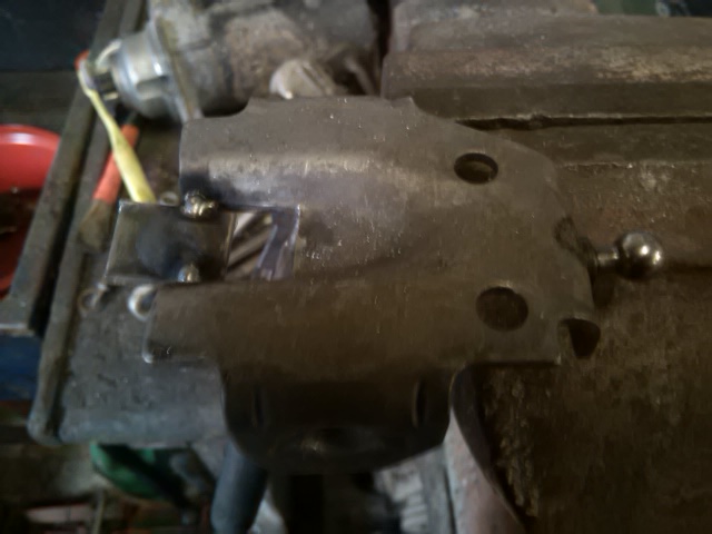

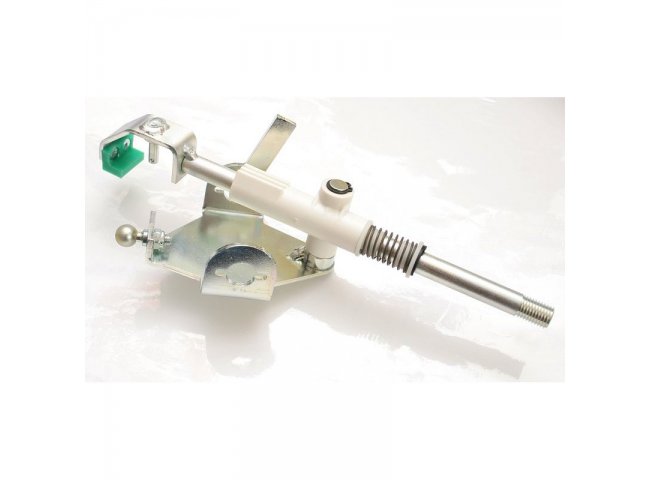

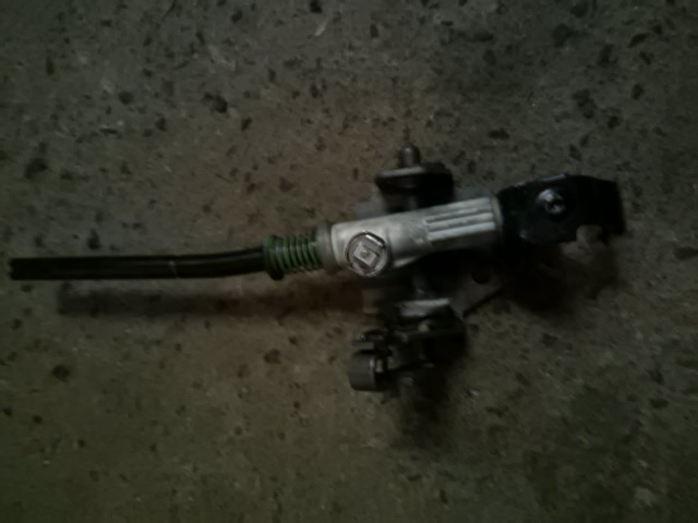

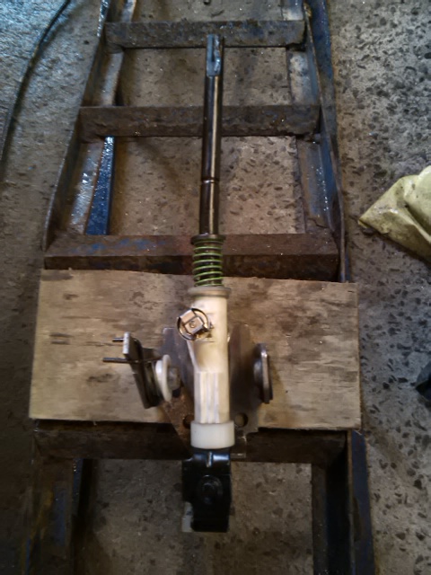

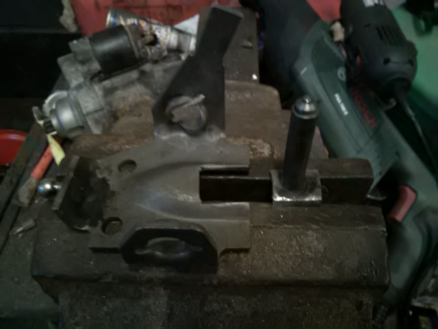

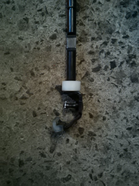

MartMini Posted March 8, 2015 Report Share Posted March 8, 2015 i got bored today and decided to make my quickshift.... well quicker I've hit the limit of front/rear throw modification i can do on the gearbox linkage, so next was to modify the gearlever mech. This is basically the idea im going for: raise the pivot point on the gear lever. They claim that'll give a 50% reduction in throw, and the white plastic part looks like the standard one, so i'd take an educated guess that they raised the pivot point an inch. i didnt want to go that far as i've already reduced the f/r throw already. being the exact person that i am, i reduced it by the size of the nearest spacer i could find! which ended up being 12.5mm Modifying the standard system means doing this: straightning the gear lever. machining out the cut out an extra 12.5mm machining the groove for the top circlip an extra 12.5mm higher cutting and welding the pivot point an extra.... you guessed it, 12.5mm higher! i'm SO glad i did this. The gear lever cost me £2 from scrap yard, and this modification took me about an hour to do. It feels so much better. the front to rear throw is so much shorter (i reckon about 30-40% less than i had), but not too short. theres enough travel to know which gear your in, but not too much to make it feel horrible. its a real nice feel of gear....neutral.... next gear.... Quote Link to comment Share on other sites More sharing options...
