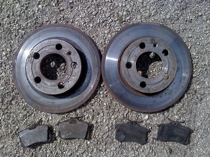

MartMini Posted December 8, 2014 Report Share Posted December 8, 2014 Cheers on the advice chaps, maybe i'm just over worrying! The sooner I can stop spending on the Astra the sooner I can get playing with 1.8T stuff finally found these. Wasn't even marked as an advsary, the bloke just made a comment of 'they might need replacing some time in the near future. Look at the pads on the right Quote Link to comment Share on other sites More sharing options...
