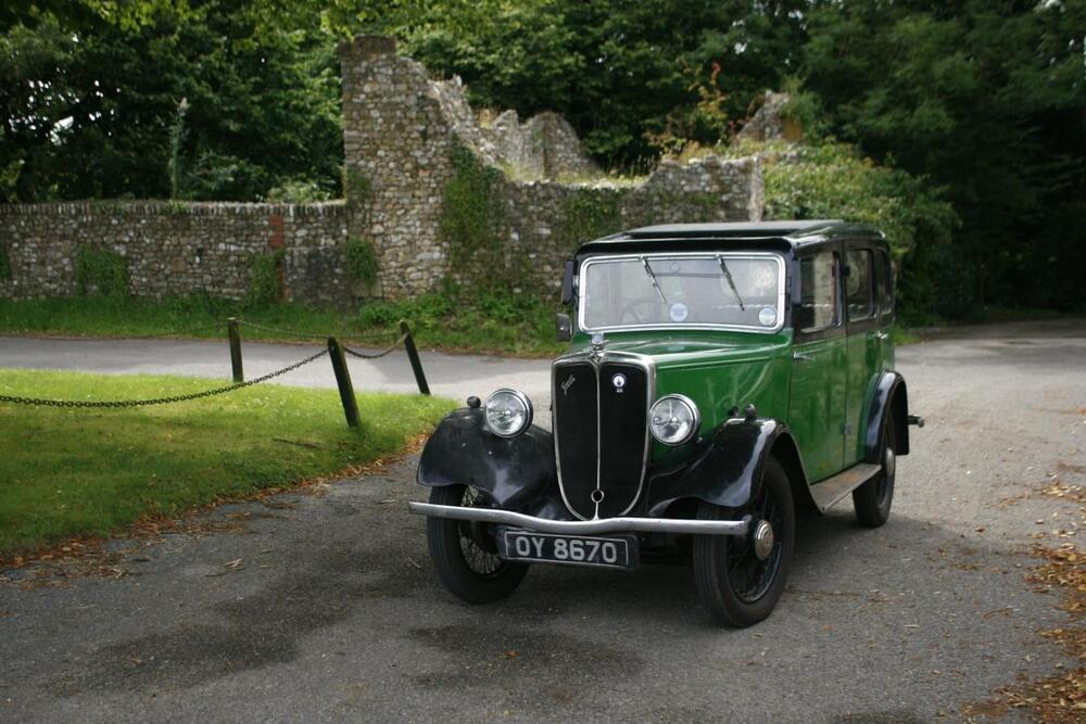

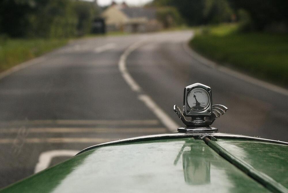

In other news, went for a drive in my friend Alan's 1934 Jowett Long 7 saloon yesterday to run in the new engine, one hell of a lot of fun and smiling for 30mph, the thing's got so much character, grabbed a couple of photos along the way:
