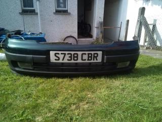

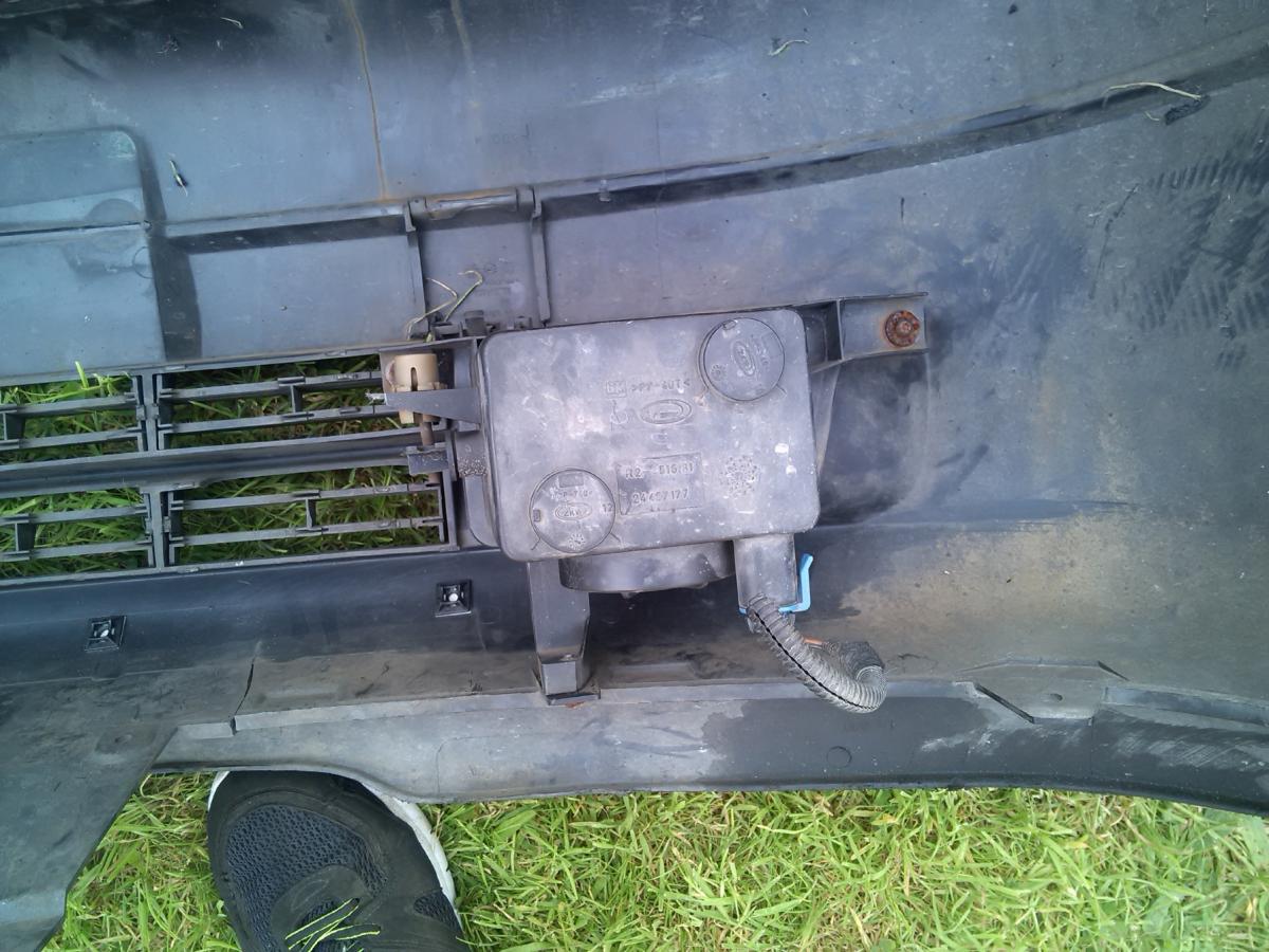

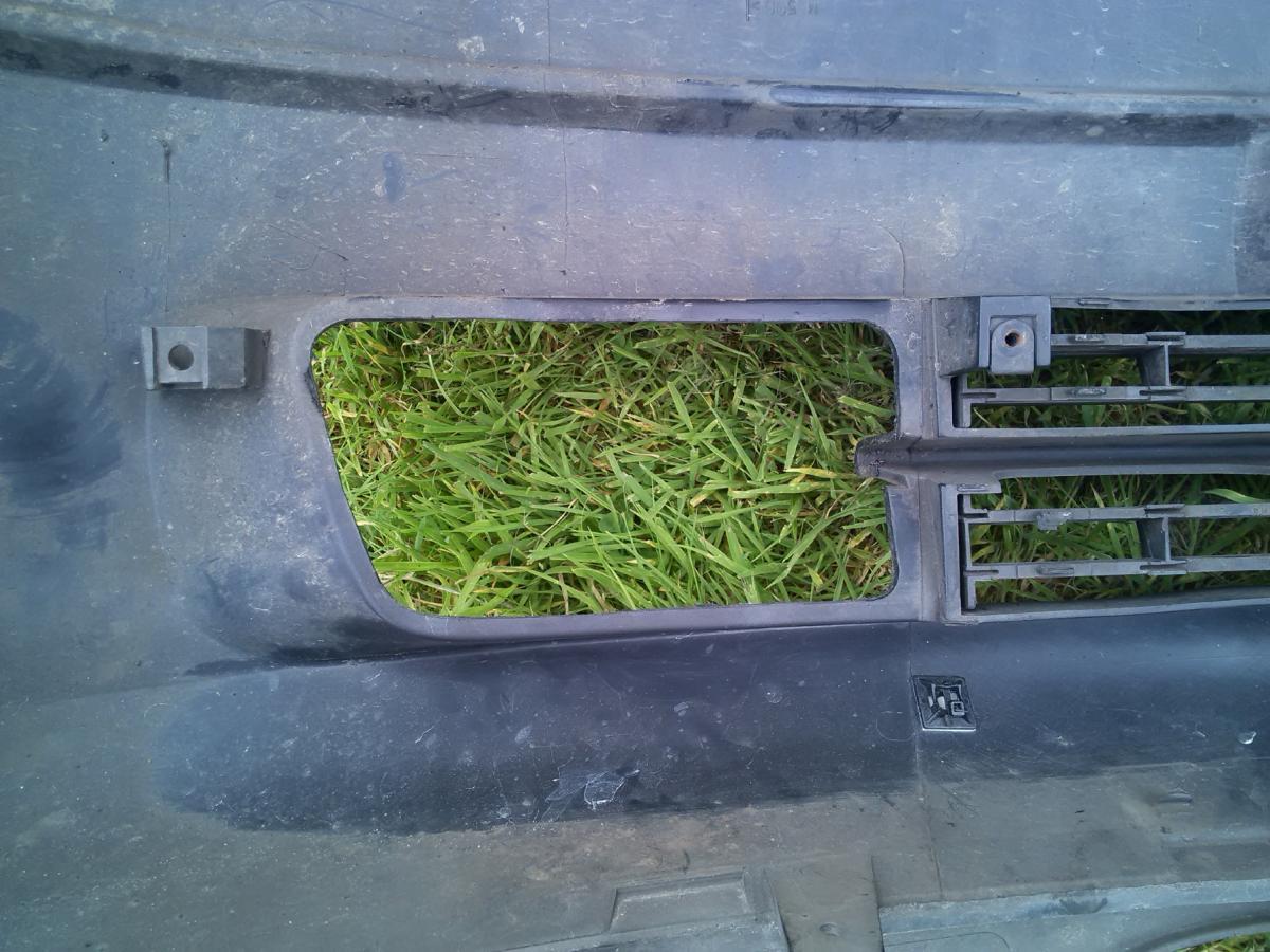

MartMini Posted September 14, 2014 Report Share Posted September 14, 2014 Removed my DRLs yesturday and fitted some fog lights. Thought id have to replace the bumper, but after finding one at scrap yard, saw the standard bumper had all the fog light mounts as standard. The standard bumper even has the guidlines for where you need to cut, one sharp knife and a dremel later: Fog light fitted ( scrap yard ones, will replace with new ones soon): Bumper view: Had a quick mock up with some HID's i had lying around, definatly think i'll be getting the right bulbs for the difference in light output! 1 Quote Link to comment Share on other sites More sharing options...
