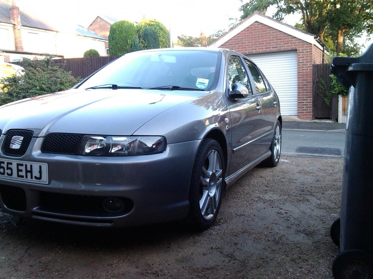

MadManMike Posted September 1, 2014 Author Report Share Posted September 1, 2014 Shameless Facebook copy & paste... Anyone on here have experience with Leon / Golf ARL engines? Or even if not, you may be able to help. I started off with EML on, it mentioned having a shite signal from the glow plugs, which could have been down to the plugs, the harness or the relay. I've replaced all three now. I'm still getting the EML but now with four codes, basically all four cylinders, to do with the plugs. In addition, my battery light stays on if I plug the glow plug harness in. Thinking my battery may have been knackered I replaced it, but still get the problem. If I unplug the glow plug harness the battery light goes away but obviously the EML stays on. Today I tested the alternator using a multimeter. Here's the results: Car off: 12.57 volts Car on: 11.8 volts Car on with glow plug harness plugged in: 12.4 volts I also tested the alternator by removing the negative from the battery and testing the main cable that comes out, that measured 0.5A which I believe is correct? Am I right in saying that when the car is running the voltage should be up around the 14 mark? Any help appreciated! Quote Link to comment Share on other sites More sharing options...
David Posted September 1, 2014 Report Share Posted September 1, 2014 (edited) Mike, will read your post properly in a second but have you checked your alternator clutch pulley? I recently had to replace mine (you can hear a funny cracking/knackered bearing noise at idle/certain speeds).If its broken then the alternator won't spin correctly/at all and hence won't charge the battery (I first noticed it when my battery light came on every so often). Could be worth checking? https://www.youtube.com/watch?v=qTtvn6LTi04&list=FLk1mrB145nV-UNK1h-rBr7Q&index=23 Edited September 1, 2014 by David Quote Link to comment Share on other sites More sharing options...
