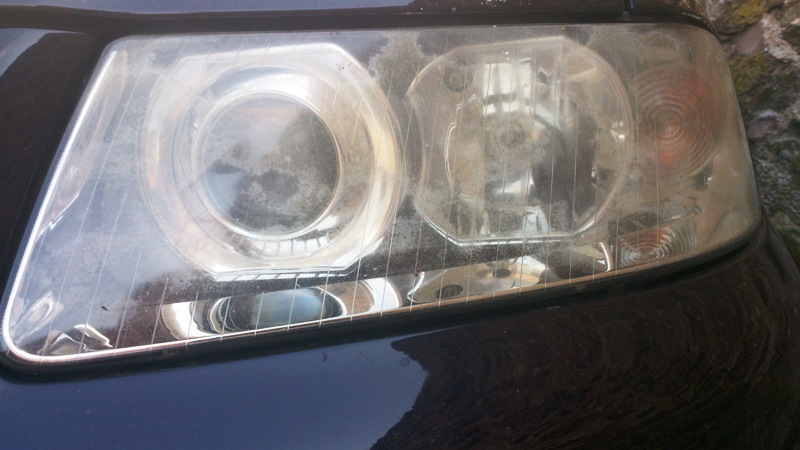

For mine I started with 800, and got all the crap off, then moved to 1500, then finally 2500 wet and dry until the lenses were completely cloudy.
Then I got some Meguiars #105 cutting compound and put that on a machine polisher with a medium cutting pad and went over the lens for around 5 minutes each lens ensuring the machine polisher is moving at all times as with plastic it's so easy for it to melt with the heat.
Then I applied 3 coats of wax afterwards and they've been spot on since.
