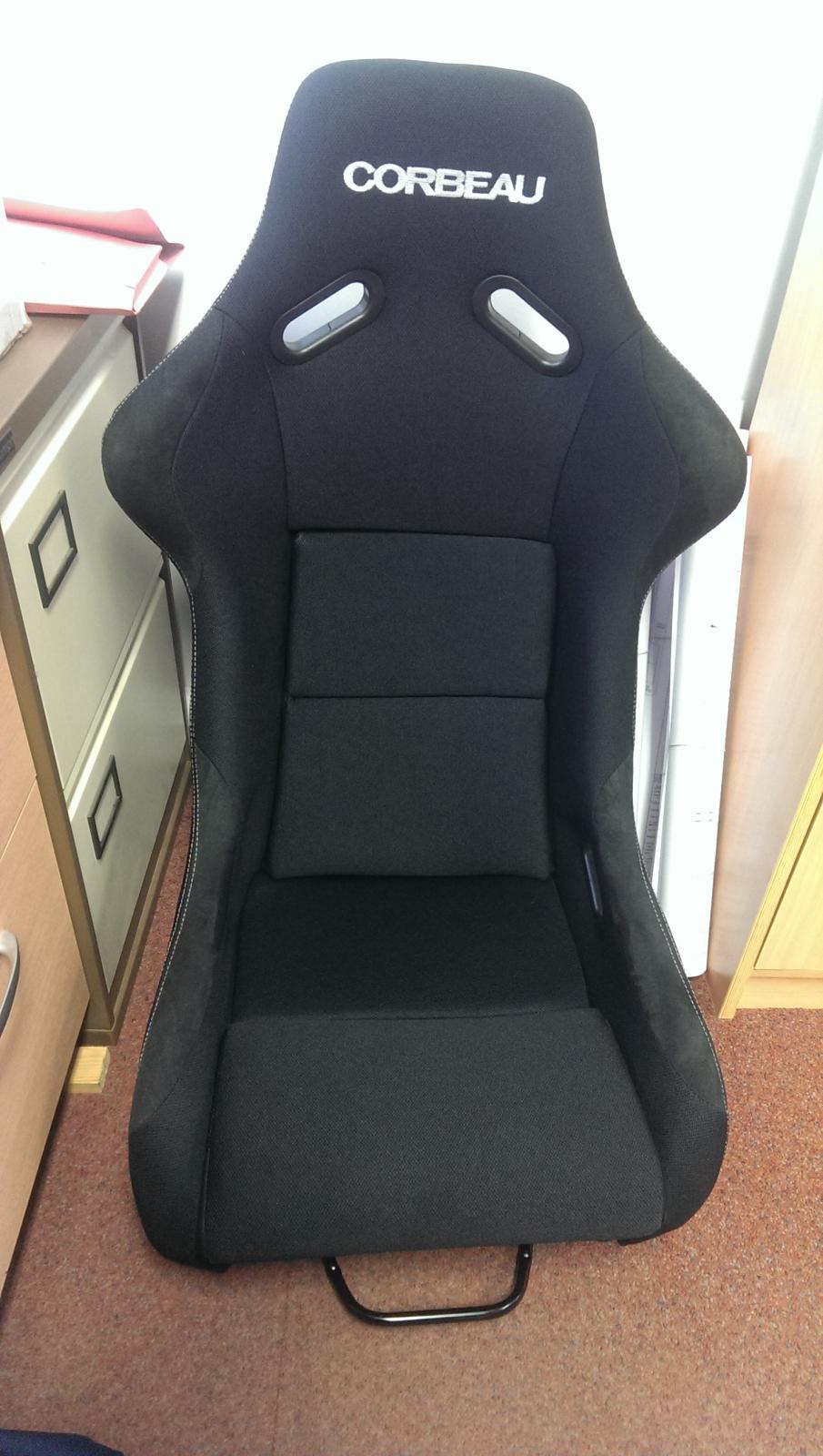

Today I had to sit through 9 hours of ridiculously dull lectures on British Maritime Doctrine in which I failed to maintain concentration for longer than around 19.6 seconds at a time.
As an almost direct result of this, I'm off to pick this up on Saturday:
1908005_10100551263177902_72081979140628
Few niggles but managed to get the price down to reflect that. Boom. Does mean I'll potentially have a spare set of CHs though... Nick, George etc ;)
