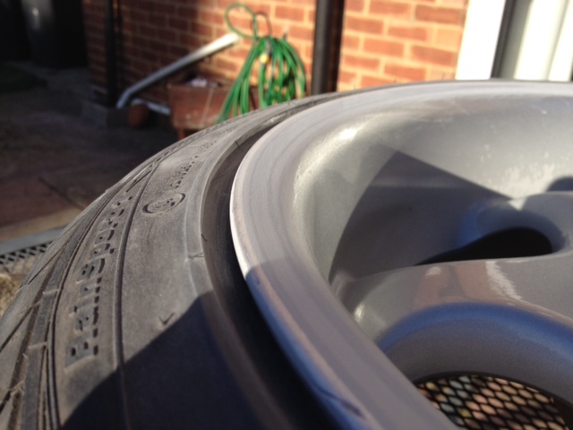

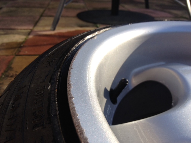

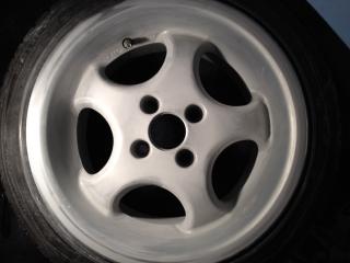

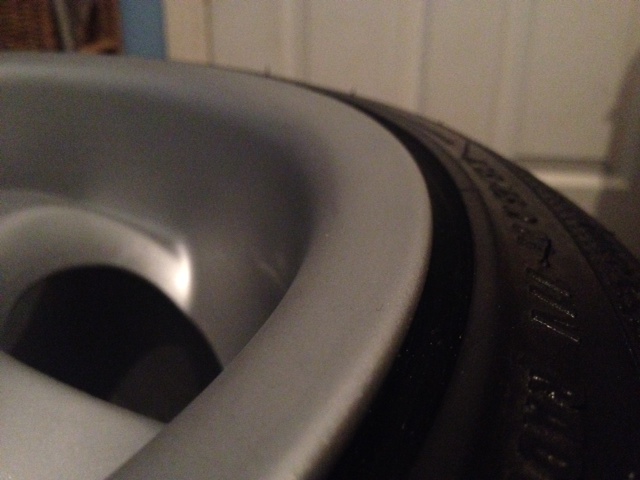

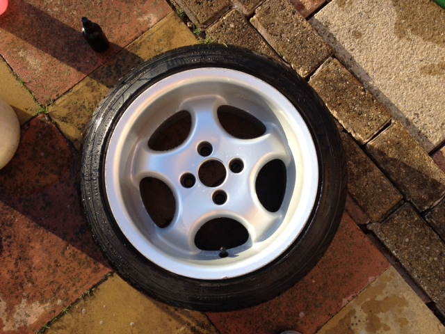

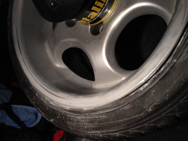

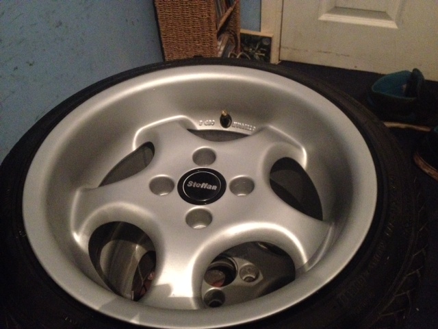

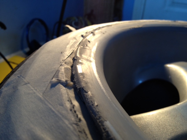

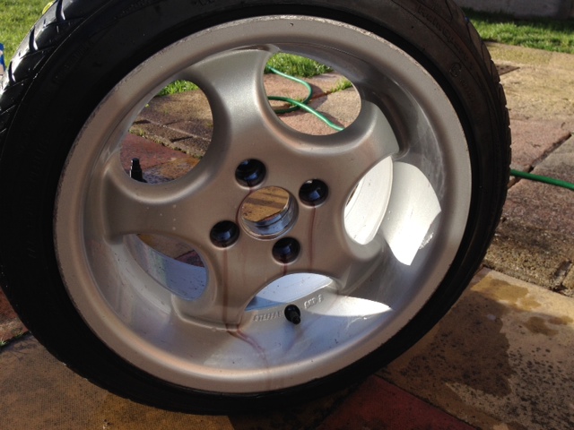

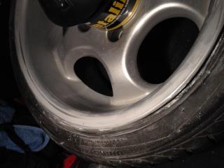

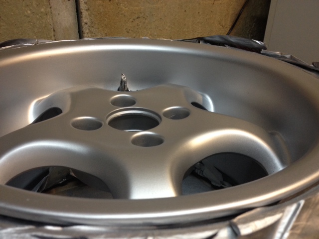

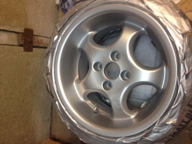

Sam T Posted January 3, 2014 Report Share Posted January 3, 2014 Decided to refurbish my wheels seeing as though they're off for winter. They all have a bit of curb rash and one has/ had a chunk missing from inside the dish. Anyway ill let the photos do the talking. I really enjoyed doing it and am happy with the results seeing as though its my first time Gave the wheel a full wash to remove any previous wax/ sealant that i'd put on using a multi purpose degreaser. Iron X pulling out any other contaminants i missed: Sanding the curb rash flat ready for filler Bought Metalik from Halfrauds, which is a filler with iron particles in it. 'Its like replacing metal with metal" When on really easy and is not to bad to sand down Some advice, dont do it in your room like i did, its really messy and has quite a strong scent Started with 120 wet and dry and ended up with 1200 using all in between. Keyed the old paint ready for primer. Forgot to take photos of putting the primer on.. Put 3 coats on wet and drying in between coats Applied around 4 coats of paint, again wet and drying between coats Put roughly 4 coats of Lacquer on it without wet and drying and im really happy with how it turned out: Only 3 more to do 2 Quote Link to comment Share on other sites More sharing options...
Tom Booth Posted January 3, 2014 Report Share Posted January 3, 2014 I wouldn't bother going any further then 600grit to be honest with you, by hand it's more then sufficient and the gains are so tiny. Look good thou man. Edit, just re-read your post. If your wet and drying between coats don't after your final base of silver. Sanding a metallic cuts the 'fleck' in the metallic so you get all sorts of weird sparkles. If your confident enough and at a ideal working temperature once your primer work is finished apply your first base of silver, leave 20ish minutes, 2nd coat of silver (no sanding needed, your coat will still be soft enough to use as a tack coat). Apply a 3rd if required then start with your clear coat repeating the same pattern up to 2/3 coats. Job jobbed, time halved Quote Link to comment Share on other sites More sharing options...
Sam T Posted January 3, 2014 Report Share Posted January 3, 2014 I wouldn't bother going any further then 600grit to be honest with you, by hand it's more then sufficient and the gains are so tiny. Look good thou man. Edit, just re-read your post. If your wet and drying between coats don't after your final base of silver. Sanding a metallic cuts the 'fleck' in the metallic so you get all sorts of weird sparkles. If your confident enough and at a ideal working temperature once your primer work is finished apply your first base of silver, leave 20ish minutes, 2nd coat of silver. Apply a 3rd if required then start with your clear coat repeating the same pattern up to 2/3 coats. Job jobbed, time halved Yeah i did start to think to myself about no seeing any gains past 600grit. Didn't know that about the wet drying when doing the silver. I'm not sure if its my technique or the can but i found the rattle can spitting quite a lot, which left the freshly painted surface quite rough? Will keep that in mind doing the others! Thanks Quote Link to comment Share on other sites More sharing options...
Tom Booth Posted January 3, 2014 Report Share Posted January 3, 2014 As your getting down the aerosol the thinners will be separating from the paint (plus your fingers going dead ) therefor thicker paint through a tiny nozzle, gives a spluttery spray from the can. Put your aerosol in some warm/hot water for a few minutes before you paint too. It'll thin the paint a little for you so it flows nicely, too hot thou and it'll dry on landing so you'll get no flow or nicely settled metallics. The only other advantage of roasting hot aerosols is you can pretty much bollock it on. By orbital sander you'll see no gains really passed 4-500 grit, by hand with paper 6-800 is about right. 1 Quote Link to comment Share on other sites More sharing options...
dann2707 Posted January 3, 2014 Report Share Posted January 3, 2014 Look epic mr T!! One massive piece of advice I can give to you and wish I would have known it from the start is to chuck your aerosol in a bucket of hot water for 10 mins prior to spraying, it increases the pressure of the propellant inside the can and makes the paint come out sooooo much better / uniform in thickness and completely prevents spluttering! You might already be doing that though but just incase it proper helped me 1 Quote Link to comment Share on other sites More sharing options...

Sam T Posted January 4, 2014 Report Share Posted January 4, 2014 Look epic mr T!! One massive piece of advice I can give to you and wish I would have known it from the start is to chuck your aerosol in a bucket of hot water for 10 mins prior to spraying, it increases the pressure of the propellant inside the can and makes the paint come out sooooo much better / uniform in thickness and completely prevents spluttering! You might already be doing that though but just incase it proper helped me Took your advice here Dan, 10 minutes in boiling water, and then heated with a hair dryer and it went on so much better with little to no splatter! Thanks Arb is looking good. Noticeable difference straight away from the first drive? 1 Quote Link to comment Share on other sites More sharing options...
