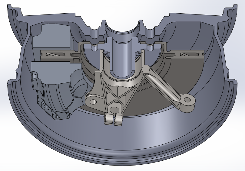

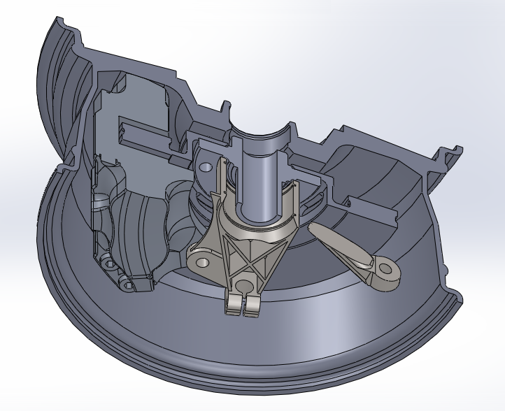

RobinJI Posted November 19, 2013 Report Share Posted November 19, 2013 Why is fitting big brakes in small wheels so hard? Stupid basic laws of physics. I've got some brembo calipers for cheap, and I want to modify some spare uprights to take them and correct some geometry issues (correct the bump steer and roll center for my ride height). Been seeing what I can get under my 15" wheels, and I think I can JUST get a 294mm disc from a new mini under there, but I'll need 15mm spacers whatever diameter discs I use. Quote Link to comment Share on other sites More sharing options...
CurtisRider Posted November 19, 2013 Report Share Posted November 19, 2013 I have a similar issue with my Commer (although its 300mm discs in 15" steels), I need to run 20mm of spacers so the caliper clears although that means it'll scrub the front step as it is such a silly design starting to think I should have stuck to drums... Quote Link to comment Share on other sites More sharing options...
RobinJI Posted November 19, 2013 Report Share Posted November 19, 2013 Why such big discs on the camper? Massive PCD? I guess you might be able to get the centers moved in the steels, to give more clearance, but make the offset after spacers the same as original? Just re-modeled mine with my current 280mm VW discs instead of the 294mm Mini ones, as I think the bigger discs will limit wheel choice too much, which has given more clearance to the wheels barrel, but less to the back of the spokes. (Also, it means less cost as my current discs are virtually new.) Mini's also have the option of a 280mm disc, with a 4mm deeper bell, so I'm thinking of making the uprights to take them, but spacing the calipers 4mm to work with my current discs for now. This is with an e30 BMW 15" BBS wheel, which has less clearance to the spokes than my current wheels: Quote Link to comment Share on other sites More sharing options...
