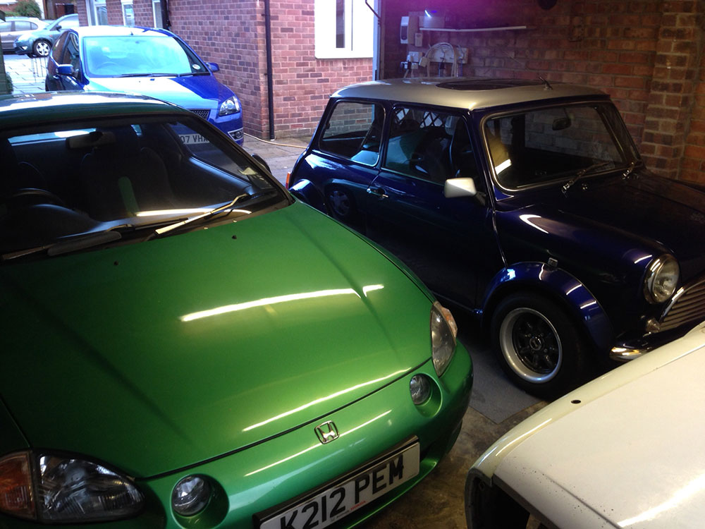

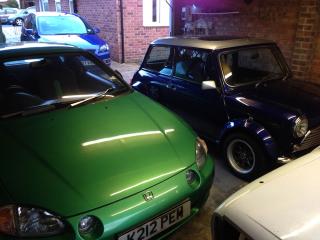

Danny Posted November 10, 2013 Report Share Posted November 10, 2013 The current fleet... Hopefully the sol will be gone soon to regain some room in my garage. I'm in the process of breaking it now so if anyone wants any bits... Quote Link to comment Share on other sites More sharing options...
