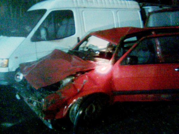

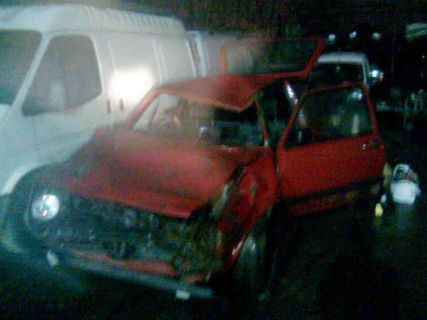

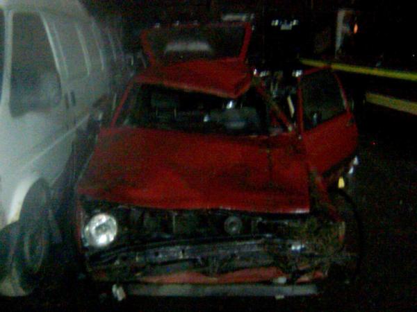

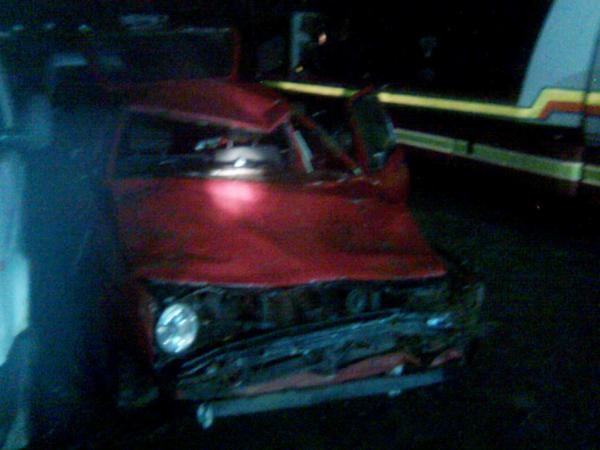

Slight? Haha, I guess rick Waller is slightly fat, and you put a slight dent in that old red golf :lol:

Also, I don't know what you're taking about with the golf, 'twas but a scratch! :blink:
