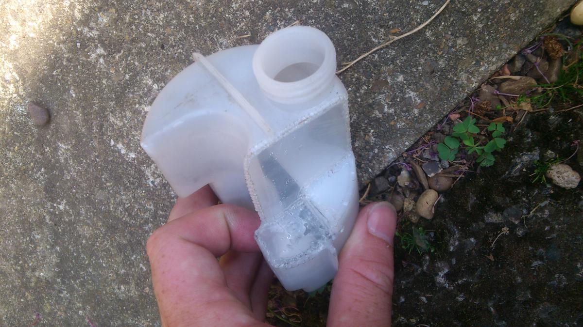

Just been and sorted my clutch fluid reservoir. It was leaking because when I'd fitted it I'd misjudged the clearance to the wiper mechanism, so had to modify it. First time around I cut a section out and epoxied some plastic in the gap to give room, as I figured epoxy's fairly chemical resistant and it'd get me buy for a while. It lasted about 6 months but then the epoxy gave out. So I took it off again and had a go at plastic welding in the modified bit instead of gluing it, which seems to have worked perfectly:

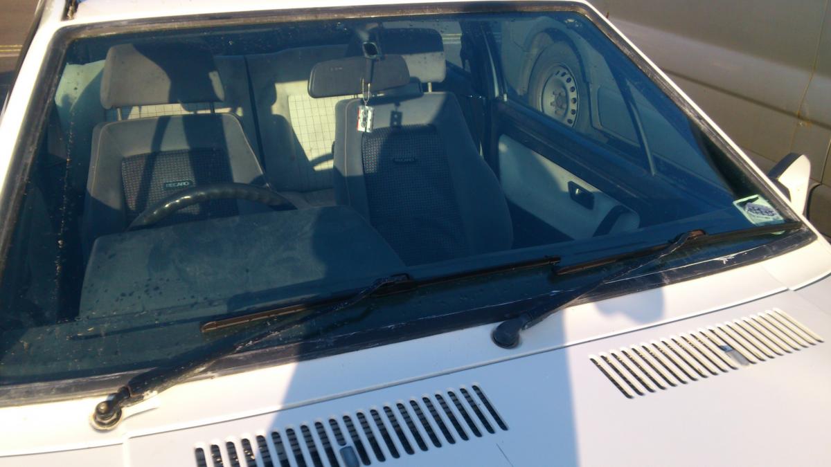

I also fitted some Aero wipers the other day. They're 21" instead of the standard 19" that Scirocco ones are, but it had always bugged me that there was clearly room for longer arms, all I had to do was turn the drives side arm around one spline so they sit slightly stagered at the bottom:

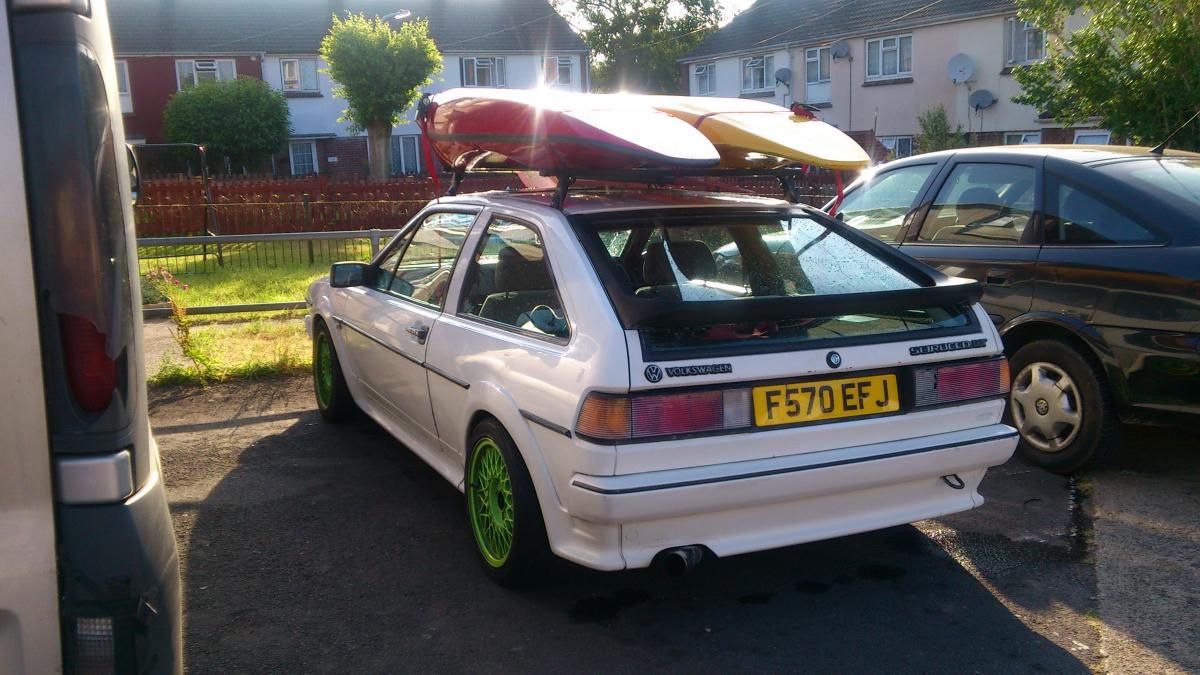

And a random shot of my car being surprisingly practical:

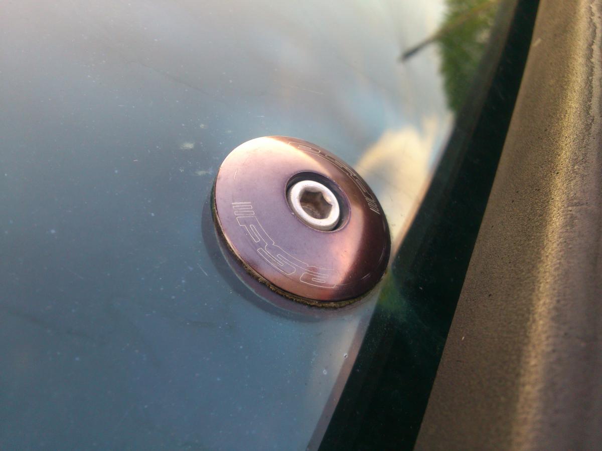

Oh, also Paul, I did this years ago :P great minds think alike (the crap around it was cleaned off as soon as I noticed it!):

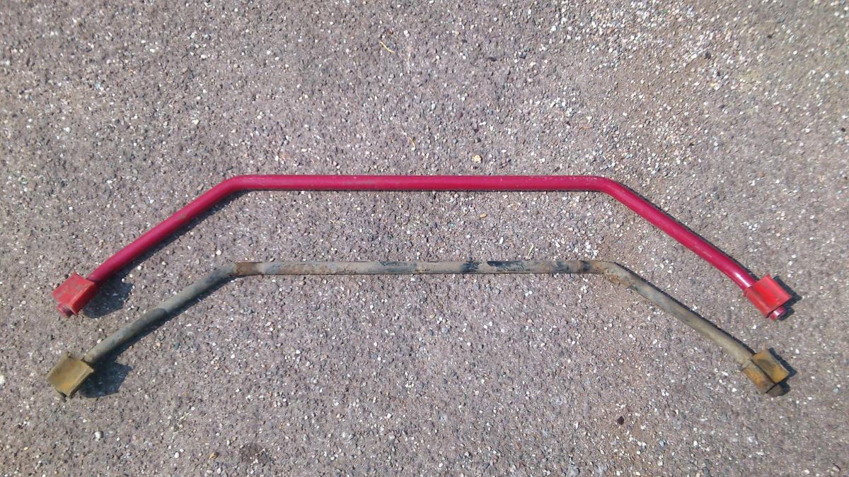

Well, after a lot of swearing, hammering and sweating the rear ARB's fitted. The outer brackets are a weird and quite silly design that doesn't really like being removed, let alone re-fitted. They're a band of steel that goes around the axle with the very ends bent around 180deg, then there's a little C shapped bracket that pushes over these returns to pull the end closed and make it a complete loop. Not sure if that makes sense, but I forgot to take a picture!
A comparison of the old and new:
post-4312-0-17141200-1374427366_thumb.jp

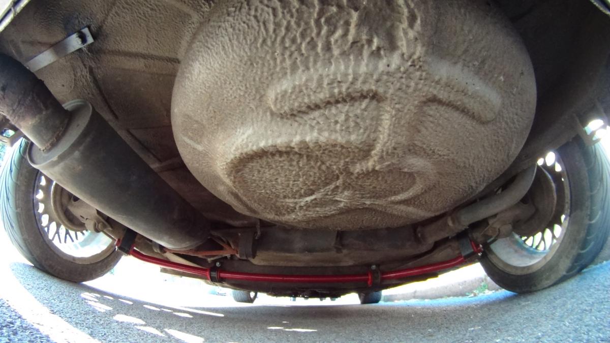

And fitted (yes, there's an obscene amount of under-seal on there):
post-4312-0-79396700-1374427424_thumb.jp
Just been for a quick spin to see if it's silly without the matching front one and it's simply awesome. I'll have to see what it's like properly when there's a little less traffic, but initial impressions are brilliant, the turn in's noticeably sharper and there's more traction coming out of bends (in fact the traction seems improved in most situations), so pretty much what you'd expect/hope really! I've got a feeling the front one may end up never being fitted.
