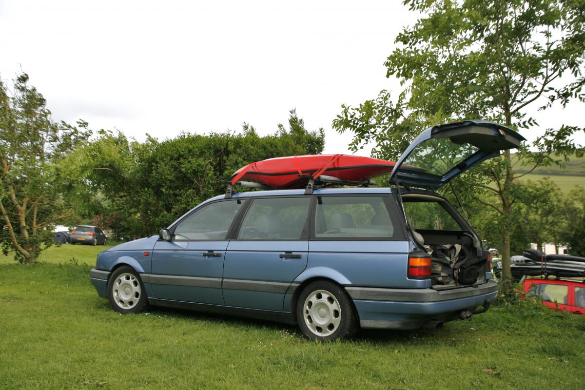

I'm pretty happy with my Passat at the moment, the cheap coilovers (TA-Technix) have really settled in well and feel a lot more supple now, I'd still like to get slightly softer springs up front sometime, but they're a lot better than when I first fitted them. Only things to do now are:
Spray the plastics all satin black as they're ridiculously faded.
Fit remote central locking.
Find some cheap half decent wheels.
Keep an eye out for some B-4 door cards so I can have proper rear door speakers.
Fit 3 door mk3 golf GTI front seats so I can fold them forwards for even more practicality (because sometimes a 6'5" load bay's just not enough haha).
Oh, and It'll soon get stickered up with "RJI Performance Fabrication" and "Telos Sports Cars" logos/advertisements, which will probably look shite, but oh well, needs must!

Nice, that'll look awesome with the front down too! For now it just looks like you're transporting a few too many deceased ladies of the night ;). I've always found that rear coilovers have much more adjustment in them than fronts. My front's will run out of thread with still about 40/50mm left on the back on both the Scirocco and Passat, and lots of other cars I've seen have been the same.
I'm trying to decide a similar thing with passat wheels, not sure whether to do with something shiny or something OEM+ Either way I'll be going for fairly narrow tucked wheels, so I can still have travel to load the car up without it scrubbing. Plus wide tyres will hurt my fuel economy, and I don't want any more road-noise.
