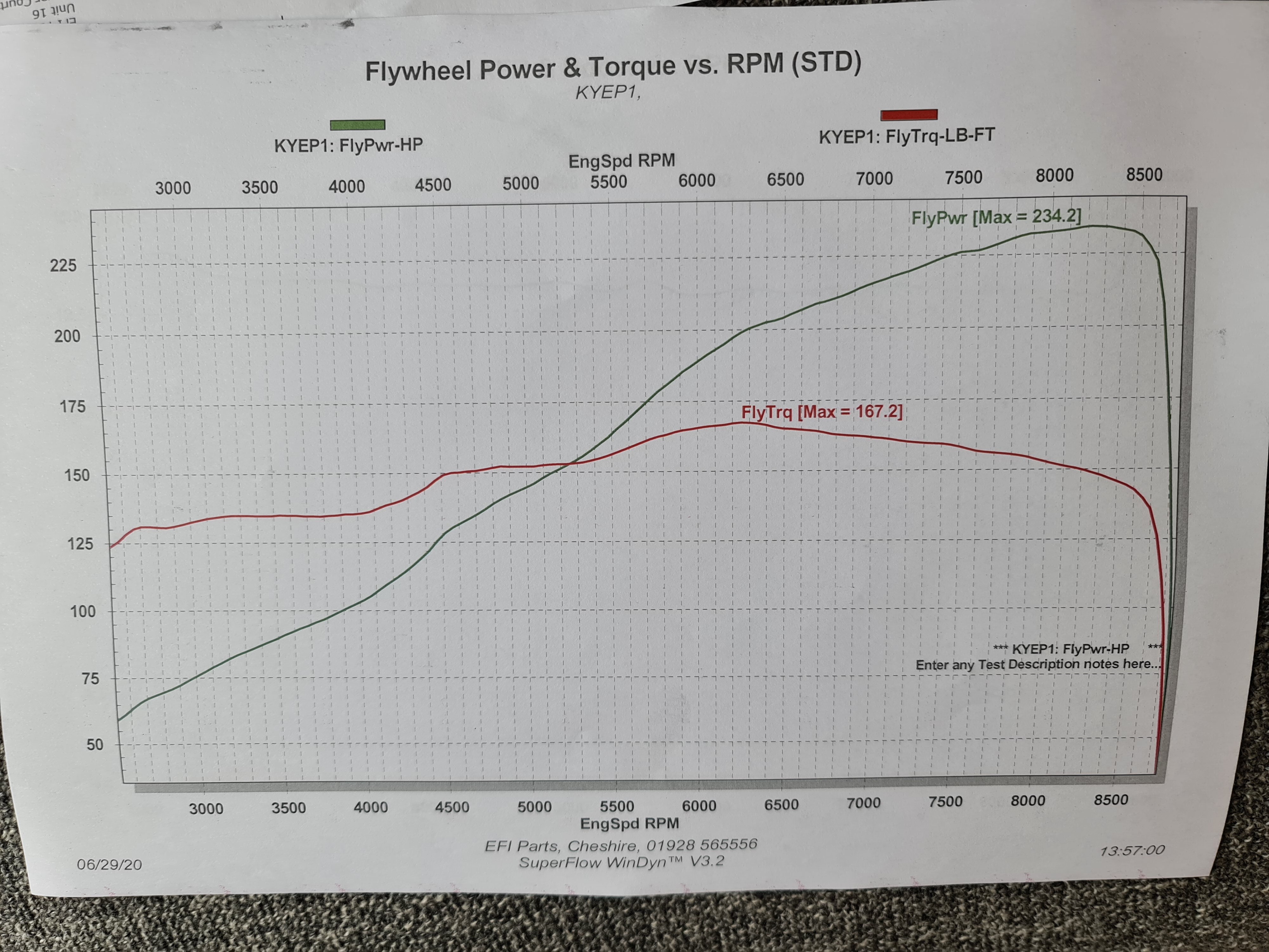

dann2707 Posted June 29, 2020 Report Share Posted June 29, 2020 Great success. Happy with those figures from a 2.0 na 5 Quote Link to comment Share on other sites More sharing options...
AdamR28 Posted June 29, 2020 Report Share Posted June 29, 2020 Pfft. I got 211 on that dyno from a 1.0L Seriously man that looks awesome, both the car and the curves! Top work on the DIY exhaust too, very easy to make a mess of that area but you did a mega job. You must be super chuffed! 1 Quote Link to comment Share on other sites More sharing options...
dann2707 Posted June 29, 2020 Report Share Posted June 29, 2020 Haha cheers Ads! Really appreciate that. Vtec now engages at 4200rpm which is just mega. Can't wait to get it on track 1 Quote Link to comment Share on other sites More sharing options...

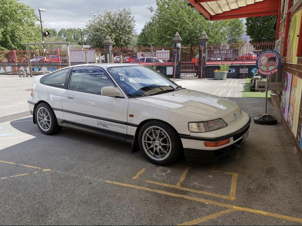

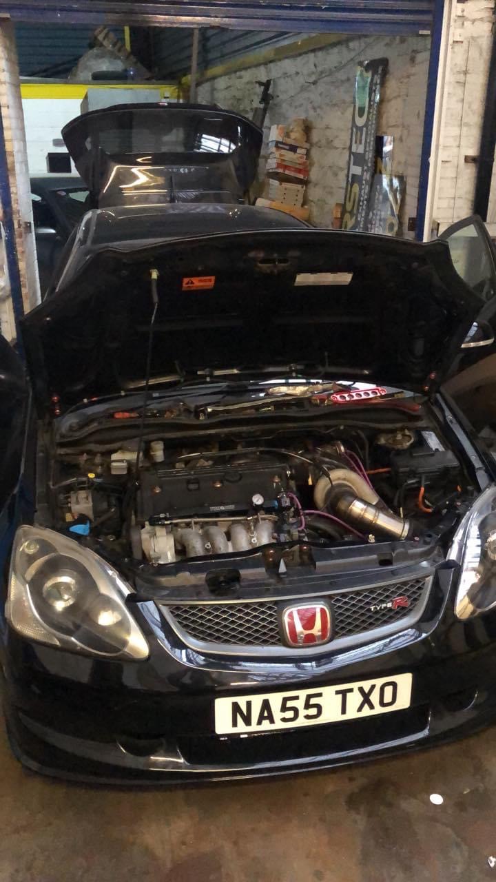

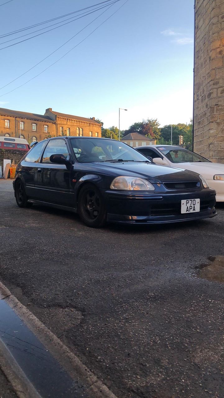

SamKidney Posted July 15, 2020 Report Share Posted July 15, 2020 On 7/8/2020 at 3:30 PM, Wrayvon said: Car is up and running!! Expand Would you recommend DanST? Only discovered recently he’s very local and could be very handy in providing me a local tuning solution for customers cars if he knows his way round a Honda. Mammoth task EP3 re-shell I’ve been on with is all but complete as of last night. Brakes to bleed, boost and AFR gauges to wire and install tonight and I can take it for a test drive and see just how useless 440whp is in a Civic. Really getting quite busy now. Lovely Civic EK4 VTI in for gearbox bearings and some wiring gremlins to sort: And another stunner of a CRX VT for a shorter final drive and LSD fitting: 1 Quote Link to comment Share on other sites More sharing options...

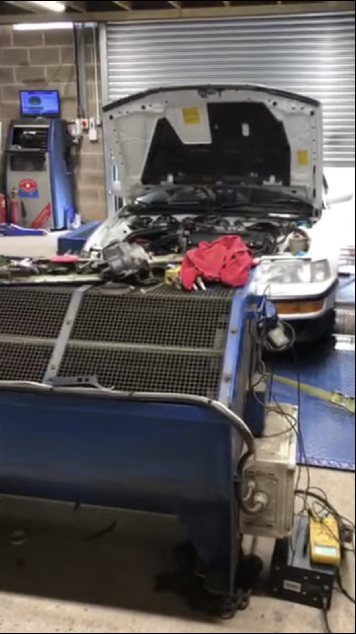

SamKidney Posted July 29, 2020 Report Share Posted July 29, 2020 CRX went through its map session on Monday with no issues whatsoever and made bang on the numbers the lad was after. 262bhp 231nm. He’s promised me a drive when it comes back sometime. 2 Quote Link to comment Share on other sites More sharing options...

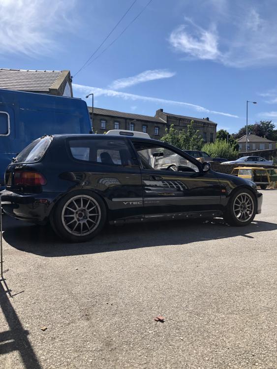

SamKidney Posted August 8, 2020 Report Share Posted August 8, 2020 Spent a little time on the EG6 today for the first time in what seems like forever.. test fitting my impulse deal/buy that was too good to turn down. Quote Link to comment Share on other sites More sharing options...
CC12345678910 Posted August 9, 2020 Report Share Posted August 9, 2020 sooo.... ~350 wheel k EG??? 30-76? 35-82? What's the rest of the setup/plan? Quote Link to comment Share on other sites More sharing options...
SamKidney Posted August 10, 2020 Report Share Posted August 10, 2020 On 8/9/2020 at 10:48 PM, CC12345678910 said: sooo.... ~350 wheel k EG??? 30-76? 35-82? What's the rest of the setup/plan? Expand It’s a first gen GT3582R, a bit large and agricultural for what I need really. The car the kit came off was running around 430 at the wheels. Looking to drop down to a newer GTX3076R, power goal somewhere around 400whp as it’ll be on a standard engine. Oem K20A2 with the only modification being a new headgasket and ARP headstud/nut kit. Oem ratio gearbox with an M Factory plated LSD, Stage 5 paddle clutch, LA Fabrications sidewinder exhaust manifold and 3” exhaust from the turbo back. Bosch 1000cc injectors, GFB 48mm wastegate plumbed back into the down pipe. 4 Quote Link to comment Share on other sites More sharing options...
