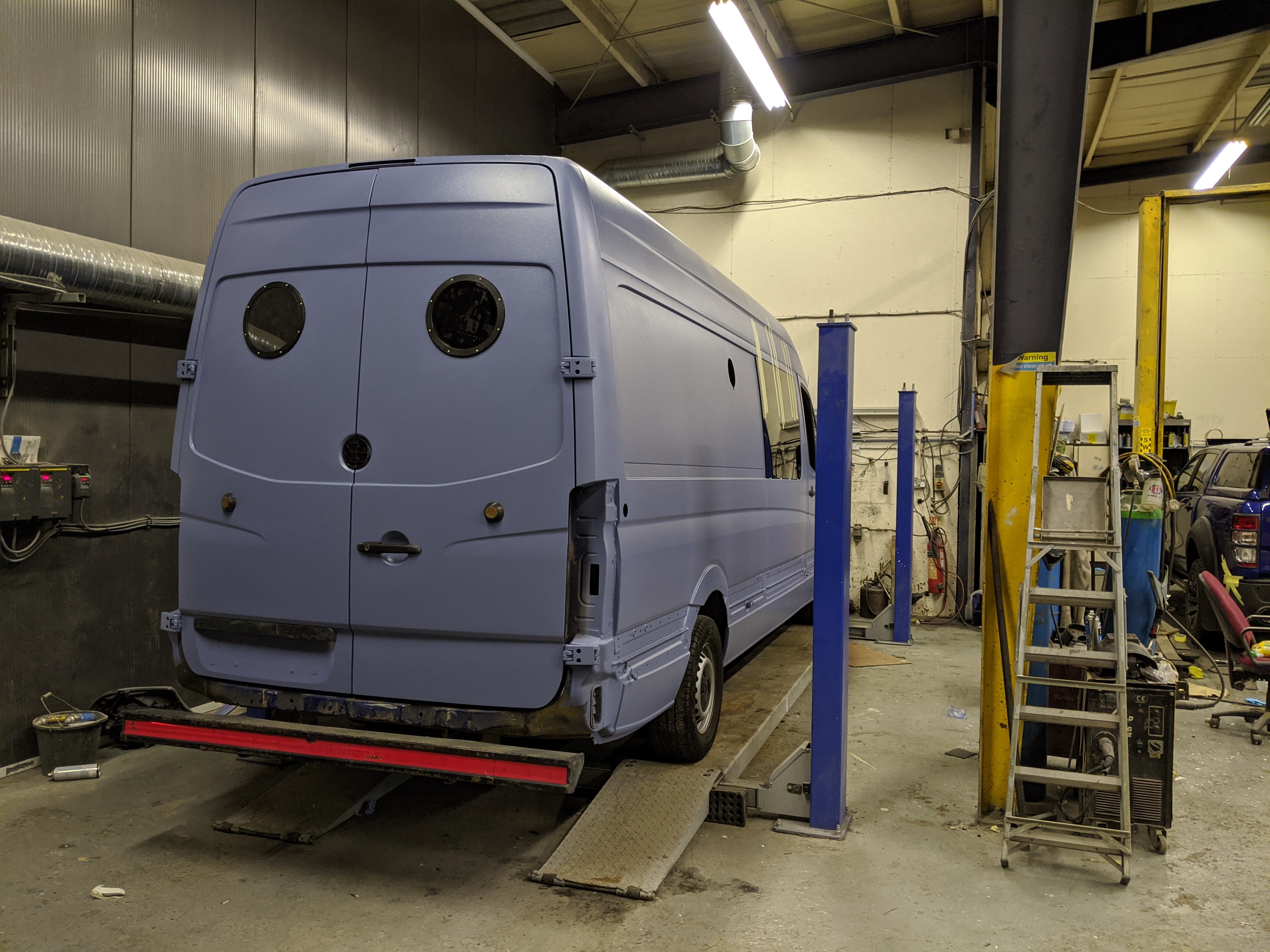

forteh Posted December 13, 2019 Report Share Posted December 13, 2019 More work on the van today Quote Link to comment Share on other sites More sharing options...
Robq7653 Posted December 14, 2019 Report Share Posted December 14, 2019 That looks awesome LOVE the colour and finish Quote Link to comment Share on other sites More sharing options...
forteh Posted December 16, 2019 Report Share Posted December 16, 2019 Van exterior done for now, Christmas holidays to start laying out and building the interior 2 Quote Link to comment Share on other sites More sharing options...

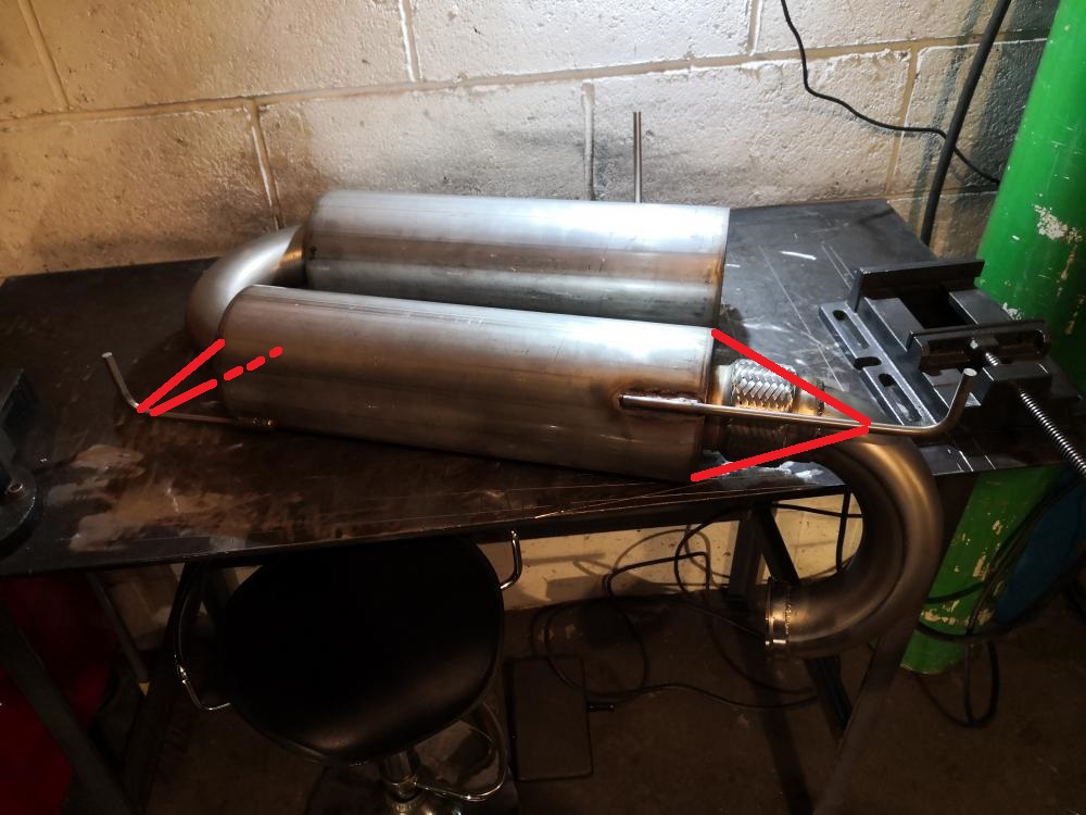

dann2707 Posted December 17, 2019 Report Share Posted December 17, 2019 Done the hangers today on the exhaust The next part is the tailpipe which I'm going to have as a v banded piece so I can add another small resonator or silencer if it's too loud as it is. Very happy! 1 Quote Link to comment Share on other sites More sharing options...

forteh Posted December 17, 2019 Report Share Posted December 17, 2019 (edited) Looking good dann33828166781m, but that looks like rather a larger cantilevered load on the hangers, I would take a diagonal tie from lower down on the silencer end cap to nearer the rubbers to take the tension and alleviate the stress risers you've welded into the silencer body Don't forget that stainless has a pretty shit fatigue life and that weld is taking a huge beating, for the sake of another 100g of stainless bar it would stiffen the design massively. Also worth bracing front to back as well? edit: a bit like my awesome paint creation (with hidden line!) Edited December 17, 2019 by forteh 1 Quote Link to comment Share on other sites More sharing options...
dann2707 Posted December 17, 2019 Report Share Posted December 17, 2019 Thanks for that dude, appreciate it! It's a really good point, I'll add some more. There's another cheeky one at the top of that pic you drew, where the wall is. My intention was to do another one there also (mount is on the way) Quote Link to comment Share on other sites More sharing options...

dann2707 Posted December 21, 2019 Report Share Posted December 21, 2019 @forteh is th is what you mean? I hope so.... Hahaha Done more hangers today, and made some additional supports to them. It now hangs nicely by itself on 4 hangers. Quote Link to comment Share on other sites More sharing options...
forteh Posted December 21, 2019 Report Share Posted December 21, 2019 Exactly 1 Quote Link to comment Share on other sites More sharing options...
