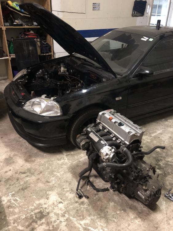

SamKidney Posted November 20, 2019 Report Share Posted November 20, 2019 (edited) Stripped and inspected another K24 that I collected the other weekend. Head gasket failure was the reason for removal from the Accord it originated from but happily the deck of the block is still true/flat. Crank is immaculate also, a great base to build the replacement power plant for my old Civic Coupe. I nicked 99% of the running gear from it to get the Integra going, I’m hoping to have it back together in time for summer track days and the Nurburgring next year Edited November 20, 2019 by SamKidney 1 Quote Link to comment Share on other sites More sharing options...

SamKidney Posted November 21, 2019 Report Share Posted November 21, 2019 (edited) Interior mostly out. K24 mocked up with inlet/ancillaries and box to mount next week so I can work out which radiator I’ll need to use and how I’ll mount it. The Skunk2 inlet protrudes a fair bit further than the RBC I had used previously. The position this manifold leaves the throttle body in is exactly where the outlet for the top rad hose sits so an alternative is needed. Edited November 21, 2019 by SamKidney 1 Quote Link to comment Share on other sites More sharing options...
